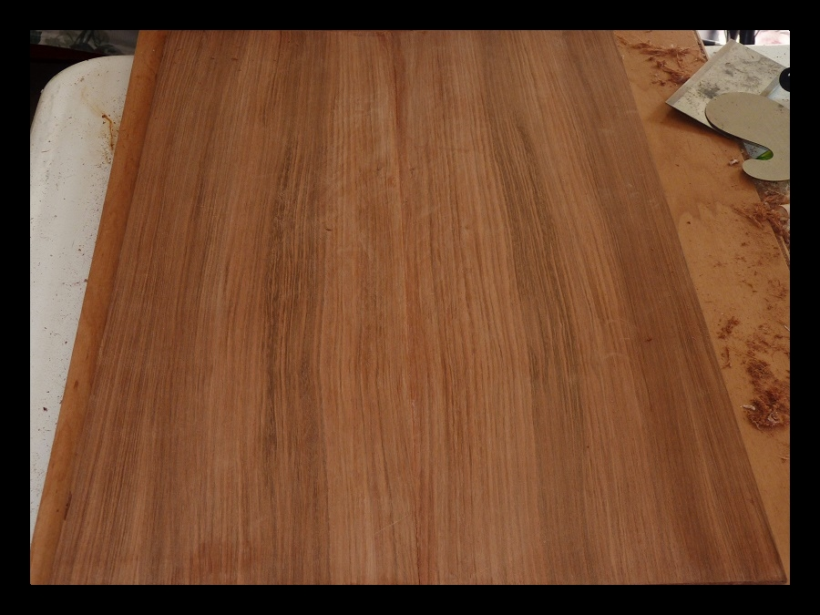

So far, so good. The back plates jointed well and I think I have a good glue seam. No problems with glue adhesion using titebond. I'd prefer to use hide glue but I haven't yet learned how to manage it. The time will come though.
One side is a bit thicker than the other and both are way too thick to build with. So there'll be some planing, sanding, scraping to be done. This is maritime rosewood, a/k/a rose de bois. It has a clear tap tone and is tough stuff - takes forever to thickness the plates. It tends to dull tools but finishes exceptionally well. I've never worked with it before, so this will be interesting.

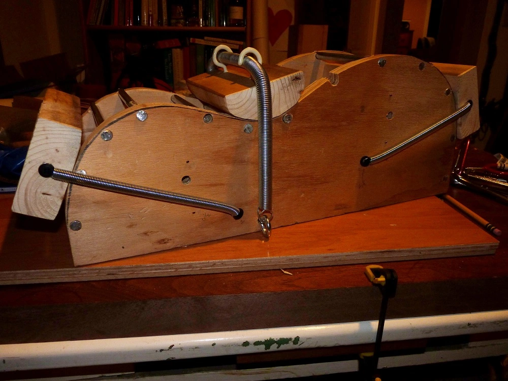

I've been making slow progress on the guitar; life keeps intervening. But here's a shot of the side bending form with a set of spring loaded cauls to hold the side tight against the form as it cools in place. Still need to install a steel mesh over the curves to combat kinks and so forth.
