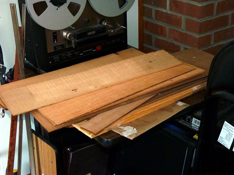

Here's a few pics of stuff.

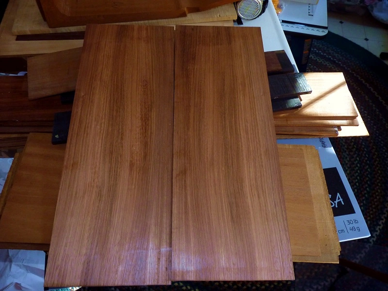

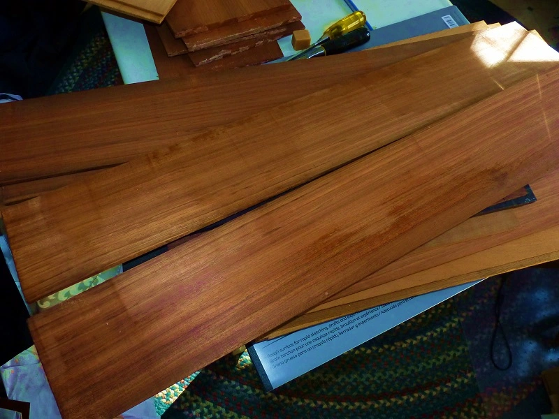

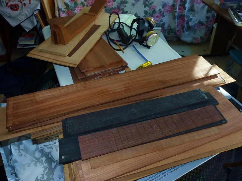

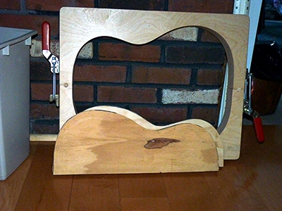

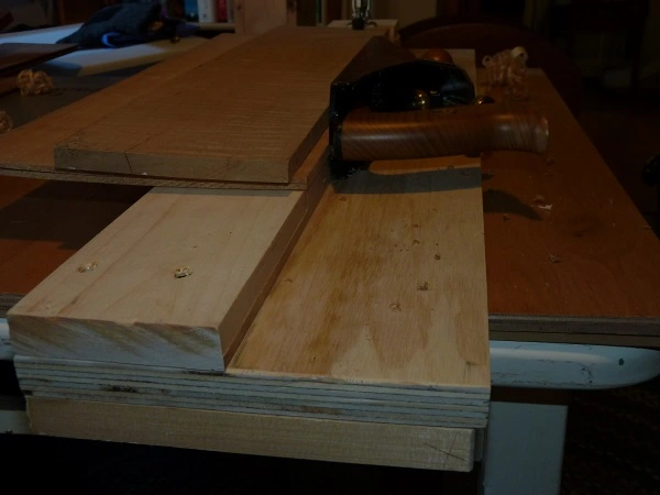

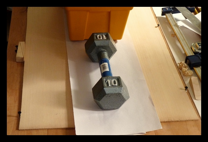

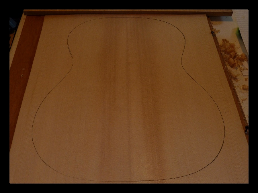

Had some fun with this project so far. Here are some pics - I built a shooting board, which is like a bench hook with some more stuff happening. Basically you use it as a guide for your plane as it slides on its side and planes a piece you put in its way. This is a great way to plane a perfect gluing edge for the pieces that form a guitar top or back. So I jointed some top wood and got a pretty good line. This morning I glued up the top and cleaned it up. Wow - it came out pretty nice. Great medullary ray action happening. This is an aged sitka spruce top; I bought it about 40 years ago (about 1975) along with a big pile of mahogany, rosewood and so forth from Michael Gurian, and it was well aged back then. Still have all that wood and more that I've collected over the years, all stickered and seasoning quietly. Now its time to do something with it.
