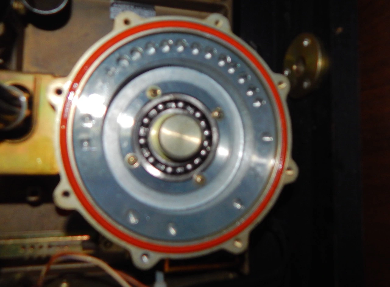

So, these are the only screws I am able to find. 4 on the inside of the flywheel. But these don't sound like what you're talking about. Is this a job that necessarily requires removal of the control box?

Omg you took the cover off the viscous-damped flywheel. So there was no fluid inside I take it?
No you don’t disassemble the flywheel.
The two set screws are at the top of the flywheel.
Use an Allen wrench like I said in my last post. I think the set screws are hex socket type.
Okay, thanks. I got the flywheel off and indeed there were holes to reposition the idler roller and tensionor about 90 degrees clockwise for the middle roller modification. All assembled and back together and it's pulling tape nicely now, with the idler tensioner in the right position. Just need to invistigate the tape lifter weakness in ff/rw, and I can call the transport okay (for now)
There was a bit of fluid on the lid and a few drops came out, but not much. Still plenty of lube in it. What a beautiful piece of engineering.
It’s not lubricant. It’s Dow Corning 200 silicon fluid. It’s supposed to be full. The fluid provides a coupling between the shell and the inner flywheel.

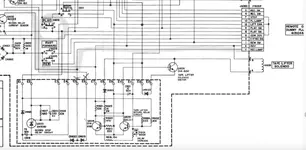

In regard to the tape lifters, I measured the voltage across the solenoid coil while operating the machine. At first it seemed like I wasn't getting any voltage, but after I'd given up, I noticed it was slowly ramping up, over 15 minutes to get up to 18V and the tape lifters work fine after that. Cap in the control box?

I think it’s supposed to be 30V. But if your brakes and pinch roller solenoids are working fine, I wouldn’t suspect the power supply because they all reference the same supply. The voltage slowly ramping up could indicate a high resistance joint lowering in resistance as it heats up. So check the wiring and connections. Another thing to do maybe first, and I can’t remember how the lifter solenoid connects to the transport control box, but I think it’s two scissor-type connectors, is to disconnect the solenoid, and measure voltage across the leads from the transport control box. Report back on that. Also measure the resistance across the coil leads.

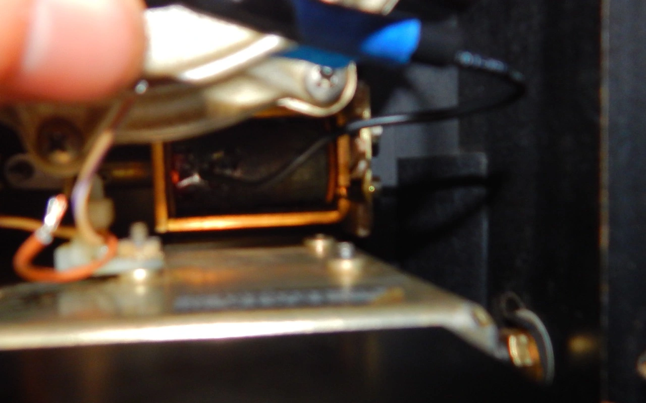

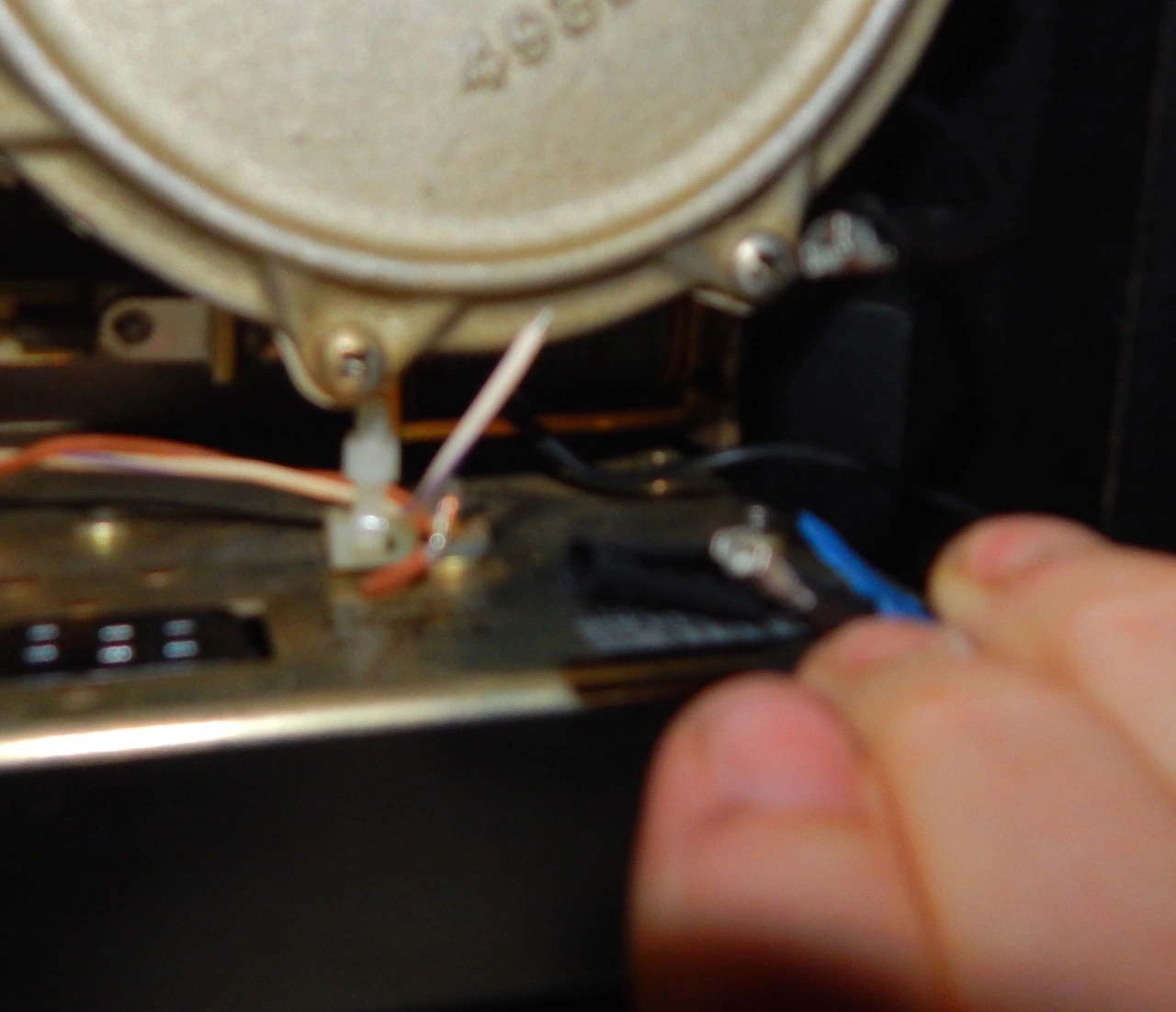

Not such great pics, but the first one shows the crimp connectors on the right, poking out of the heat shrink. On the left the orange and violet/white wires go to the control box. In pic two, I'm trying to zoom in on the black wire connected to the coil. Anyway, these black wires are confirmed 20 awg, and the wires from the control box (orange and violet/white) look to be 22awg.
About what gauge do you remember? Tried to find reference in the manual . . . but no luck.

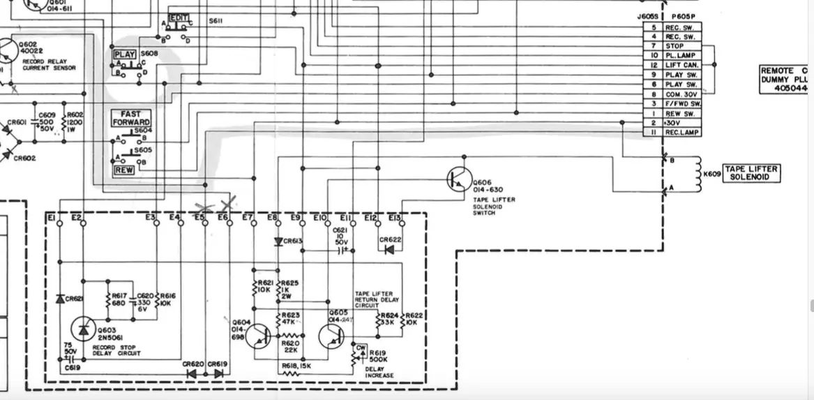

Take the button escutcheon off, jet some DeoxIT D5 down the collar of the EDIT switch and bap it with your finger 50 times. Also *verify* your remote jumper is correct and in good service. Wiring diagram is I. The AG-440B-8 supplement manual. The jumper straps the STOP, LIFTER CANCEL and ground together. They should be a dead short.
Disconnect the pinch roller solenoid leads. Measure the resistance across the coil. What is it? Is it similar to the 14R of the lifter solenoid coil? What happens if y or strap a 14R load across the leads for the lifter solenoid from the control box? Does it cause the voltage to ramp up slowly like when the lifter solenoid is connected? Use a larger resistor as close in value to 14R as you can find…maybe a 2W or 5W resistor to be safe. If the power pops up to something around +30V then I’d say your lifter solenoid is the problem.

With a 20 ohm resistor (no solenoid) connected to the tape lifter solenoid's power, I'm getting the same slow ramping up. No resistor, it's solid 34V. Resistor gets very hot too.
Also, I disconnected the pinch roller solenoid power, and am getting 1.5K ohm across it's coil. Very different. I then checked the power to the pinch roller (with the solenoid disconnected) and I was getting 139VDC. That can't be right. But I messed something up, and now instead of 139V, it's only putting out 1.5VDC and the pinch roller won't engage. The solenoid coil still measures 1.5K but I must have done something to the pinch roller power by inserting the 20 ohm resistor across it's power leads as well. Shouldn't have done that . . . or maybe I accidentally grounded power without noticing.
Well depending on the power rating of the resistor it certainly could and would get hot, and hot resistors are not uncommon. What did you use? 2W? 5W?
Because it did the ramp-up with the dummy load I suspect your power supply needs work. And the fact the no-load output is 1.5VDC affirms this. What happens if you switch to AC bolts and measure the output?
Bottom line I think your power supply is toast and it was already failed and now it’s really failed. Time to pull the transport control box, or actually I think you can just remove a cover at the front and get to pretty much everything.
