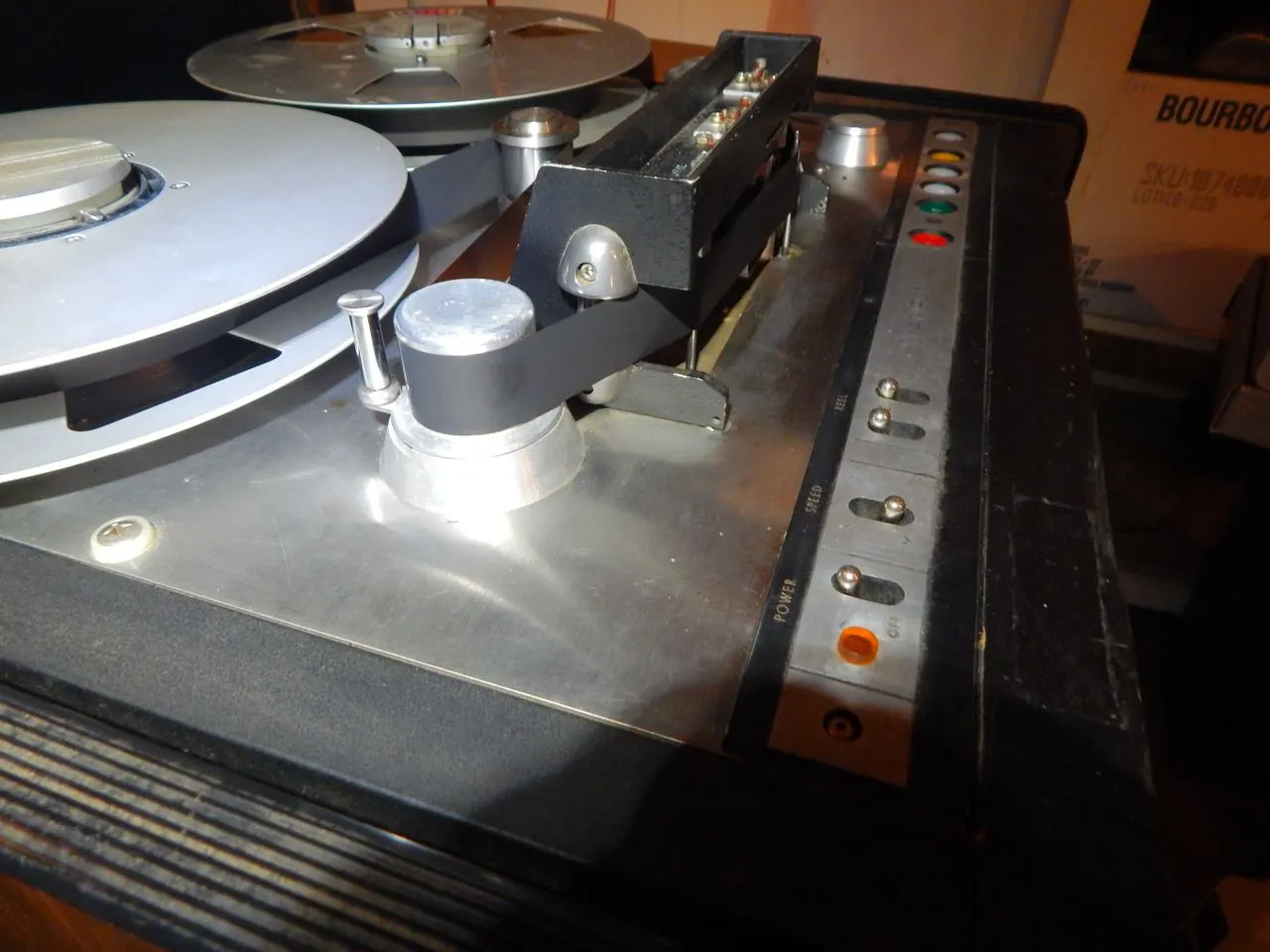

I'm finally getting back into working on this 440-8 and thought I'd post here, revive this epic thread and ask a few questions.

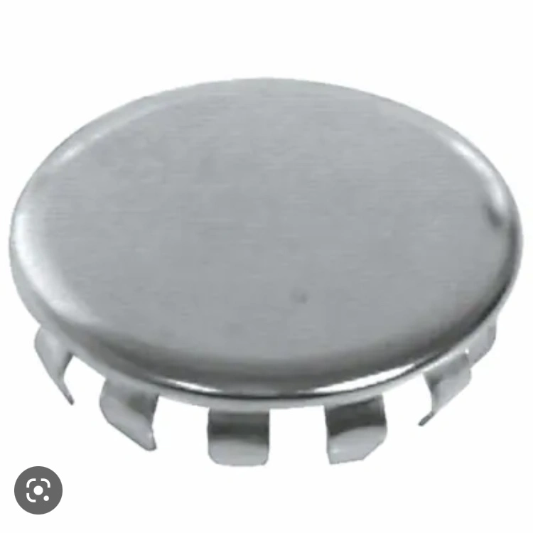

For the middle roller guide, how do I take the cap off? Rubber pliers? Or do I remove it from the bottom? (hex screw) It needs to be shimmed up a tiny bit so my tape doesn't scrape the bottom of the guide right before the erase head. The supply reel needs to be shimmed up a tiny bit too. Is there a source for some ultra thin cork shims?
Also, my tape lifters are lazy, in FF and RW. From the manual, I gather this is the Solenoid perhaps. What is the voltage that I should read at the Solenoid associated with the lifters. Maybe it just needs to be cleaned. I haven't investigated that yet.

So I *think* I understand what you mean by “middle roller guide”…so from the supply reel the first thing the tape hits is the “rotary tape guide” right above the center of the head nest…is that what you’re talking about?
After the rotary tape guide tape wraps around the reel idler roller and tensioner, and then it hits the stationary tape guide at the entrance of the head nest, then the erase head etc.
If you’re talking about how you get the cap off the rotary tape guide, I’ll tell you, but then I’m going to caution you not to jump to shimming or messing with that. The cap is just a steel hole plug like this:
I always use a dull putty knife, spudger or similar to go around and lever the cap off…it is just a spring-loaded friction-fit.
There are socket-head set screws on the bottom of the guide in the base for adjustment, but please don’t jump in and mess with that. All of these components were set at the factory for proper tape handling. I bet you dollars to doughnuts the root-cause of your problem is worn and compressed reel table corks. You need to get new ones. It is a special thickness cork with a specific type and thickness fabric backing. You can buy them from David Dintenfass at Full Track Productions:

Regarding the lifters, you have the service manual, right?
Looks like the lifter solenoid is energized by +30V. You definitely want to measure the voltage when the solenoid is energized to measure for voltage drop. And you can remove the lifter assembly and make sure it’s not bound up…clean, lubricate….
And while that’s out also check and make sure the solenoid plunger can freely move. You shouldn’t need to lubricate that. So if it’s bound up at all I’d make sure the plunger and plunger bore are nice and clean.

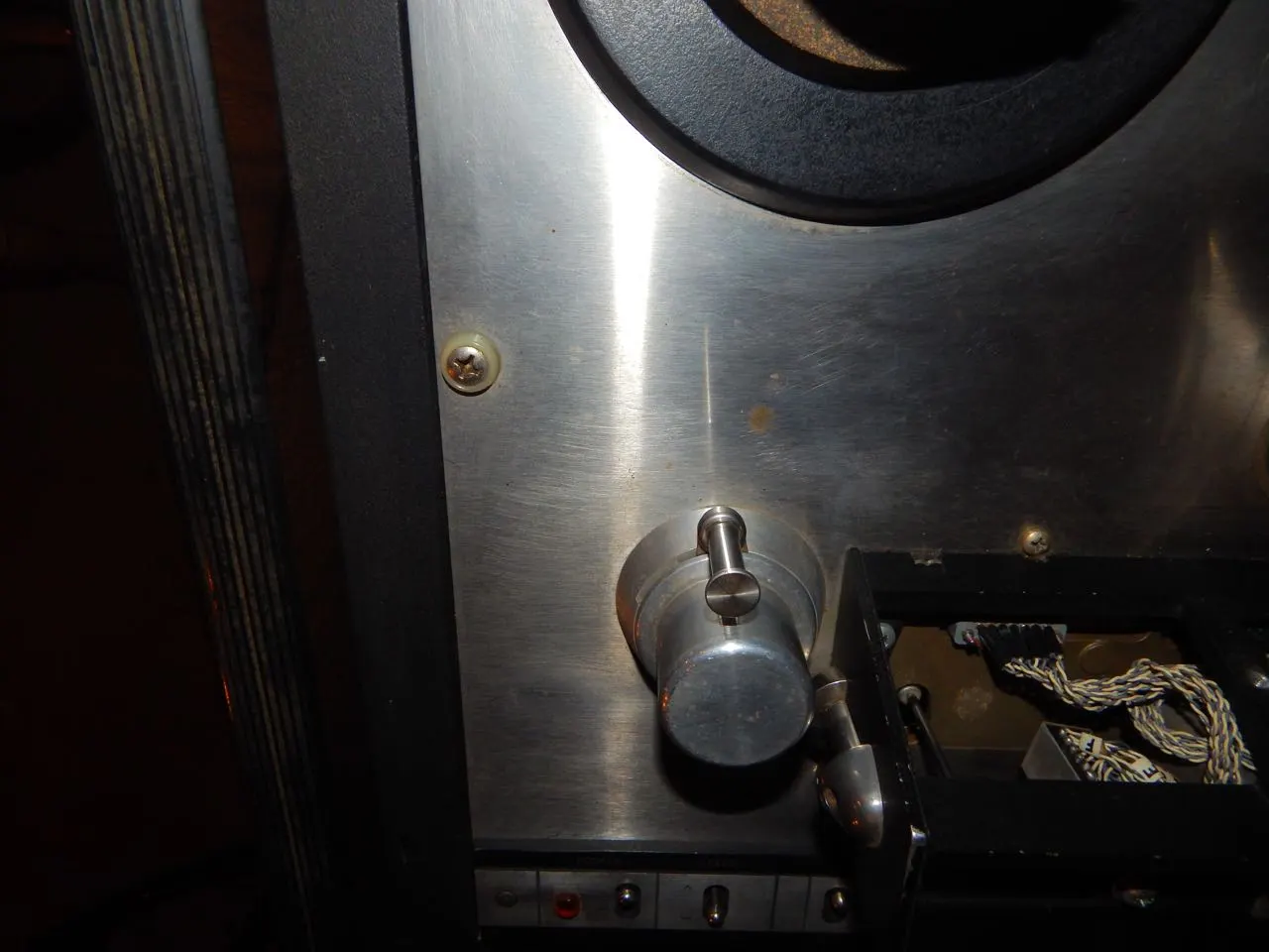

Can you post a pic of your reel idler assembly? I want to see what you’re talking about. And does your machine have the servo capstan then? Or a sleeve on the capstan shaft? Post pics of your capstan shaft and the back of the console behind the transport if you can. Presumably if your machine is factory 15/30 then the EQ daughter boards on your amp cards are fitted with the correct components for correct EQ at those speeds. You can cross reference with the ‘C’ manual for that to see what’s what. If it is NOT factory 15/30 then who’s to say the EQ boards are correct. But it’s pretty easy to check. The daughter boards have a part number suffix…a two-digit revision number that correspond with the machine specs (7.5/15…15/30, etc).

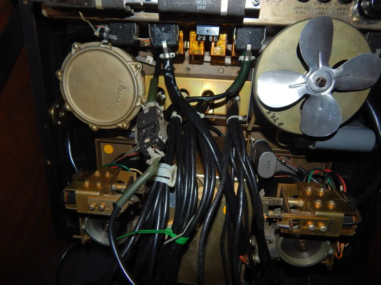

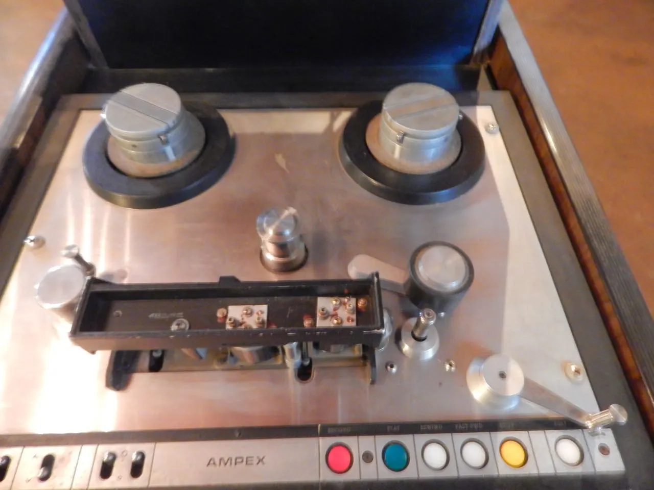

Attached some more pics. The capstan is AC. This is a 440B.
I have 7.5/15ips repro daughter cards (-01 suffix) so I guess I'm actually stuck at 15 anyway, if I wanna align properly. I'm guessing this means the speed on the transport is set to low, but the "high" pots are the ones I'm aligning with, and I can forget about both 7.5 and 30ips.
When I bought this machine, it was from a guy named Phil (can't remember last name) in Oakland, claimed to have worked with Foreigner, had fallen on his head off of a ladder, had a near death experience, and afterward, had a craving for dairy products. He was drinking Yoo-hoos a lot when I was picking it up. Anyway, he had to clear a whole ton of gear in a storage area and everything took forever. During the process I think he had asked me something like 'do you want the 7.5/15ips or the 15/30 motor?' and made a last minute swap when I said, hell 15/30ips with stars in my eyes. I didn't know enough at the time but were it these days, I would have picked the other one.

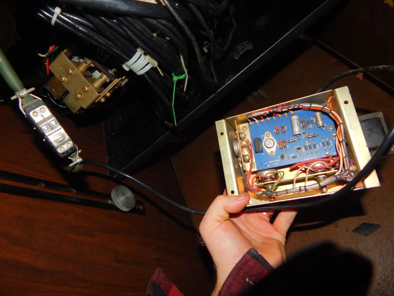

I attached a pic of the (booster? circuit)

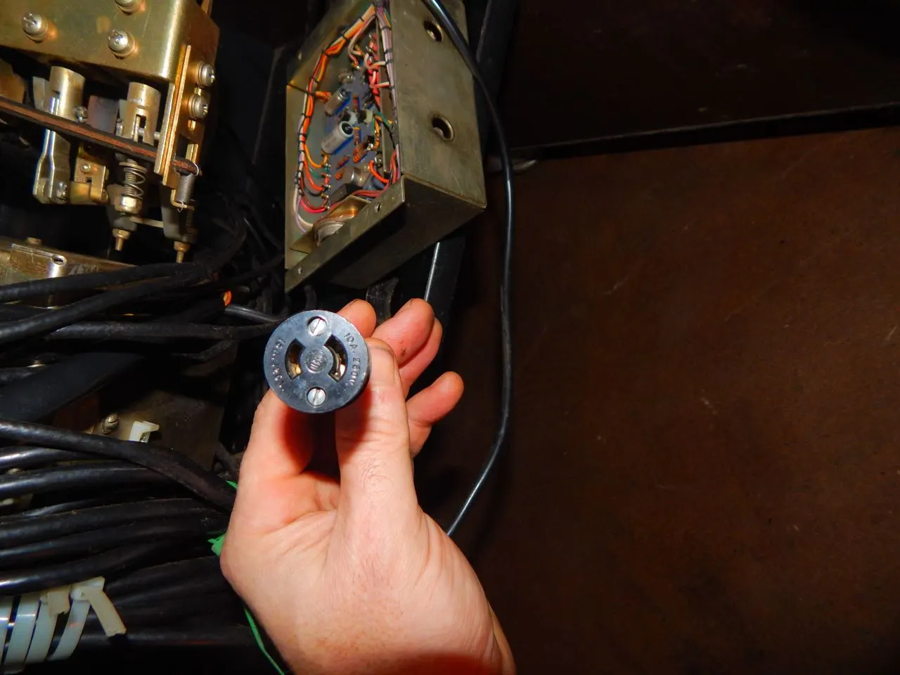

Another pic shows the only cable that I can't figure where it would plug in. (I'm guessing the missing remote)

So, the slot that the idler tensioner moves in. Should that be at around 10:00 to 2:00, or more like 12:00 to 3:00? Mine is between 9:00 and 12:00 which doesn't seem right.
Okay. I’ll ask again, you have the manual right? It’s a well-written manual, and essential if you have an Ampex. For the AG-440B-8 there are actually two manuals…the standard 1/4”~1/2” manual, and the 36-page AG-440B-8 supplement to the standard manual. If you don’t have them, you can find them at the link below. I believe my scans are the best and most complete…tabloid pages scanned in one shot…not broken up, etc.:
I can’t really tell what all I’m looking at in some of your pics because they don’t show enough of the context of what’s outside the picture frame. The 440-8 has a power boost assembly mounted on the underside of the transport where the signal electronics power supply sits on a standard 1/4”~1/2” AG-440. It plugs into the transport control box at J604S. Then there is also a torque delay module mounted on the rear of the console above the signal electronics power supplies. The schematic in the AG-440B-8 indicates it plugs into the transport control box at J608S. Now, I can’t see in the manual where that connector is physically located…haven’t had my hands on an AG-440-8 in 15 years. So I don’t know if it is a panel-mount connector or maybe cable-mount…but it appears to be a 6-pin Cinch Jones connector like the other ones on the transport control box.
If you’re talking about the pic where you’re holding the cable with the round twist-lock connector, isn’t that just the mains power cord? Plugs into the round socket on the transport control box?
The transport remote control plugs into the transport control box at J605S. It is a 12-pin Cinch Jones connector. In absence of the remote there is a jumper plug that must be installed for the controls on the transport to function. I *think* yours is in place? Hard to tell from the pics. But the jumper plug straps pins 7, 8 & 12 together which are the STOP control, +30V ground and lifter cancel control respectively.
Your reel idler tensioner…so in the picture is the tensioner arm as far clockwise as it will go? Is the spring in place? Like is it spring-loaded? The AG-440B-8 supplement goes into good detail about transport component checks and adjustments.
As per the idler tensioner, yes it's spring loaded and it is as far clockwise in it's slot as it will go. Thanks for the supplement manual. I already had the two track manual, but downloaded yours as well, as it does look like a better scan.

The supplement manual also makes obvious what the extra box I have is. It's a torque delay box.
That extra power plug is not the AC to the control box. It's a bit smaller than that.
I do have the Cinch Jones remote dummy plug with the correct pins shorted.
