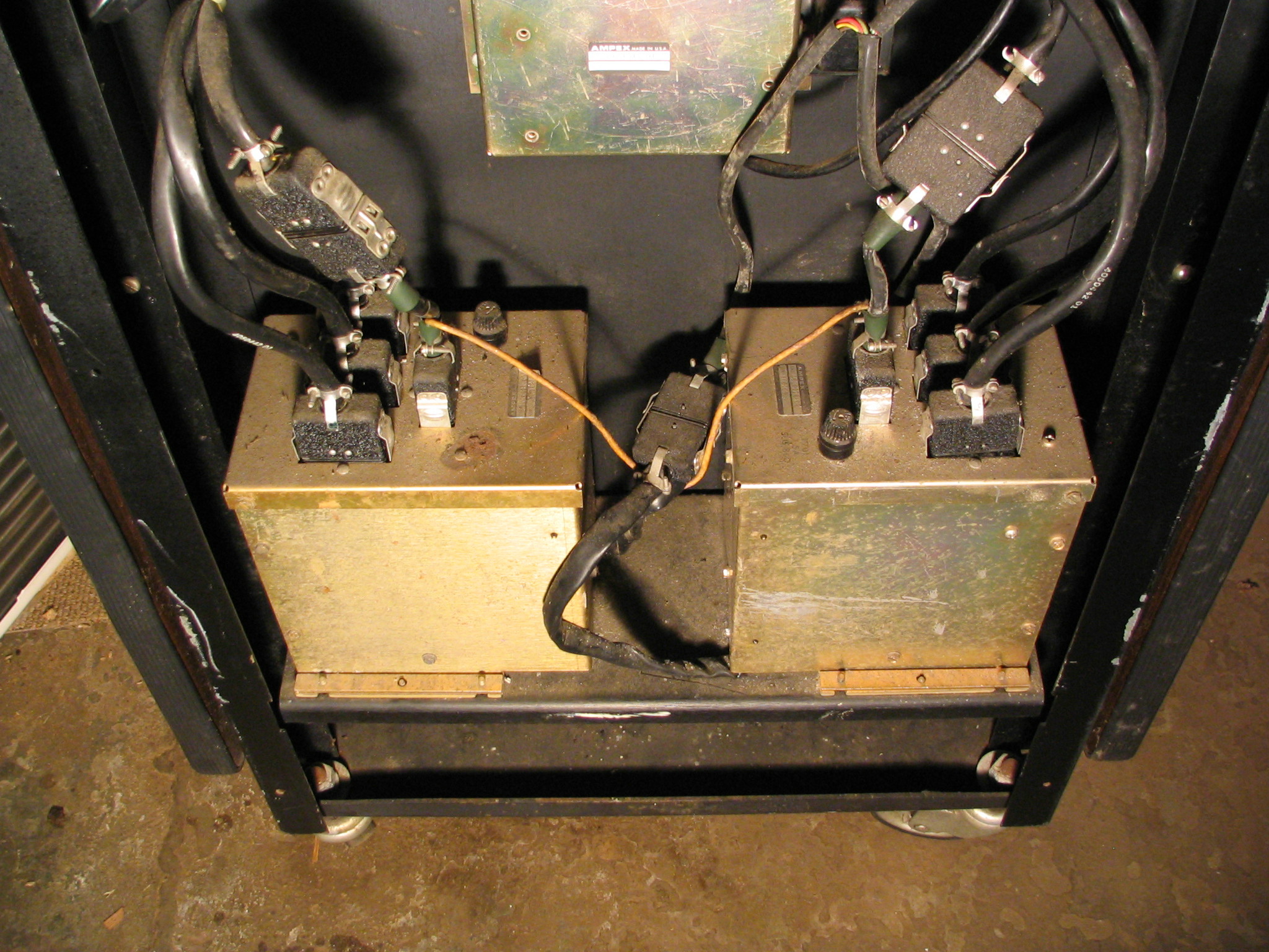

Power supply unitswoo-hoo:

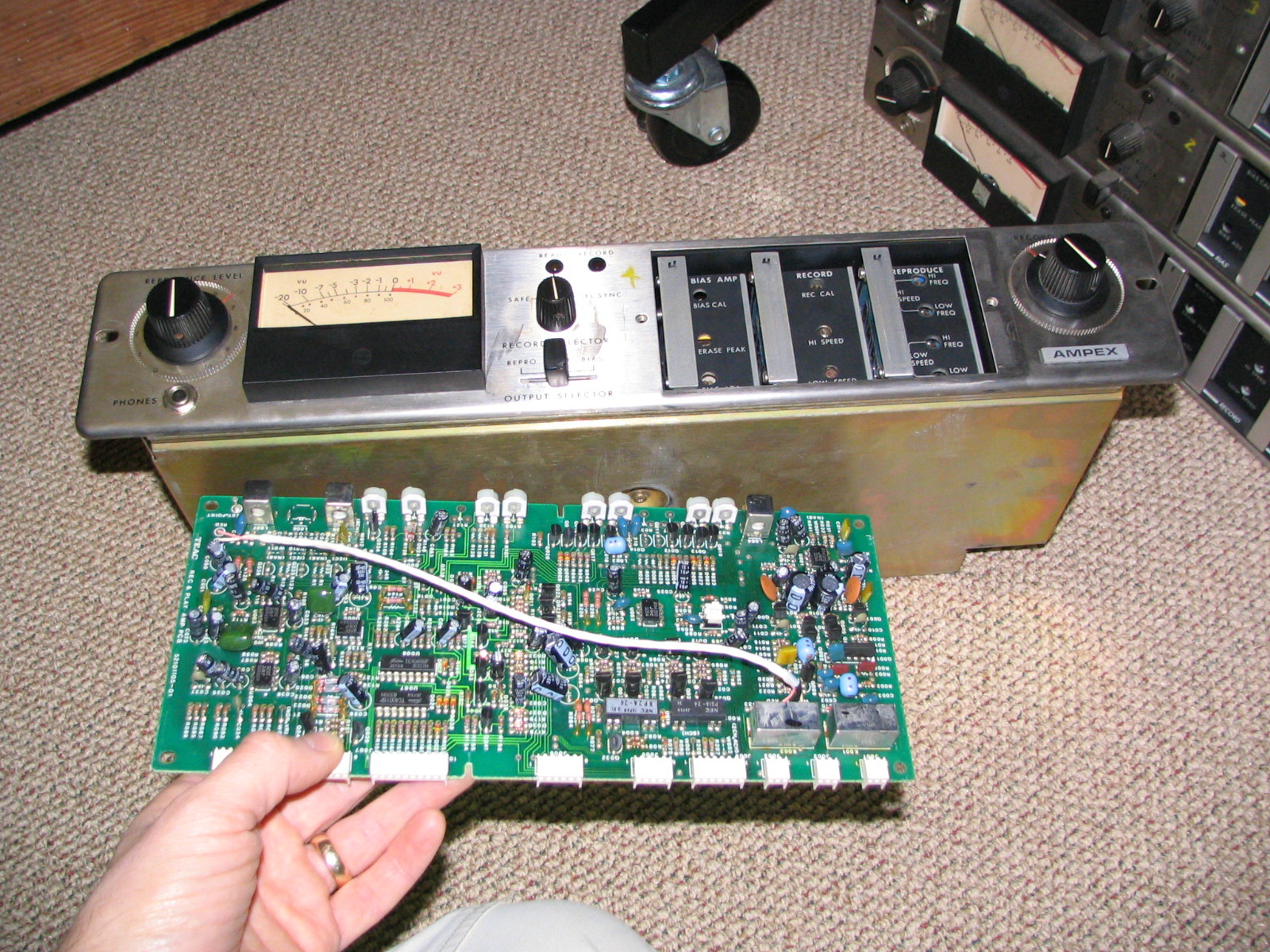

A bias card...I'm so used to the PCB's in my Teac/Tascam gear...these are so different. Really hefty...thick...and there is so much solder on them; on the traces:
And last but not least I thought this would be fun...here is a Tascam 48 amp card with the equivalent of the "amp card" of the 440, the electronics module:
