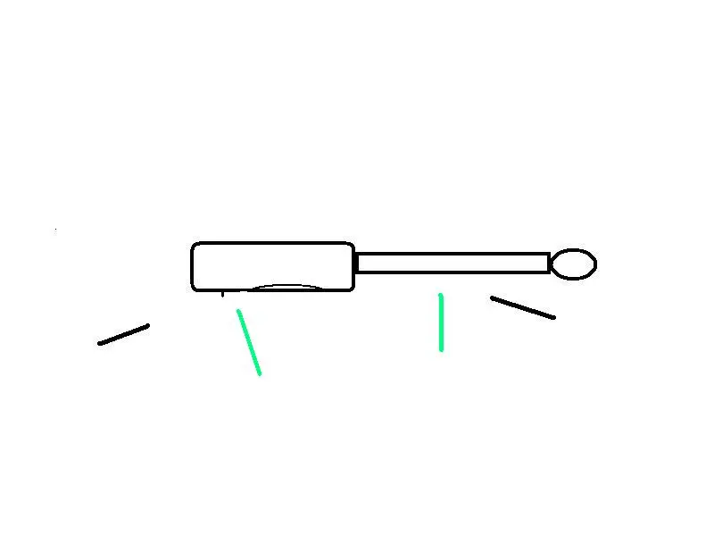

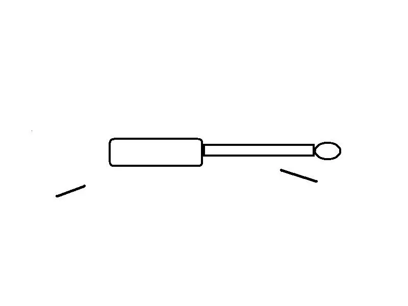

I don't think it was a dreadnaught. Just a regular acoustic. I usually do stereo mic's by taking one at the twelth fret or a bit closer to the headstock and pointing it at a 45 degree angle towards the sound hole (I put it as close to the fretboard as the guitarist can handle). I take the other mic and put it about a foot back from the end of the guitar and about 6 inches out pointed at the bridge. Hopefully that makes sense. As far as the mixing, I don't do much at all really. There is a slight rolloff in the bridge mic because we got a bit of boom in that mic, and a tad bit of reverb. That's about it. Oh, and the mic's are cardoid SDC's.
Here is an awesome pic I made with paint -
Here is how i did it in green. I'm gonna try your method for sure next time, I see how it would sound better. Do you think that your placement would work well with the mics I'm using? I'm still a little ignorant to how the different kind of mics work.
Why do get the feeling this will turn into one of those pictures that gets altered by everyone until it looks like we're mapping the human genome?
It sounds a lot different than how you have it shown. Hmmmm. I would have thought the mic at the soundhole would have been super deep and boomy. Also, it sounded like the track was mono hard panned left with a delay hard panned right. It was stereo? Maybe the tracks got slightly off time somehow?

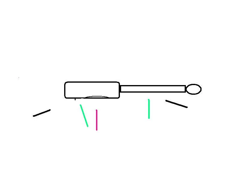

Ok sorry, I've confused myself, let me fix this.
On "Sweet Imperfection" I had the AKG LDC set a foot or so from the soundhole pointed right in there. (below in red)
On "Giving up on singing" and "Everything we think about" which were recorded a couple of days ago i used the green placement.
Do those tracks sound good? Neither of them sound boomy. The latter two sound crisp and clearer but they dont sound big like yours.
Sorry about that.
I know i didnt need to diagram the red one, but its crackin me up.:D
