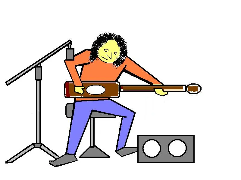

Does this help? I added colour, your friend, a monitor and an LDC!
