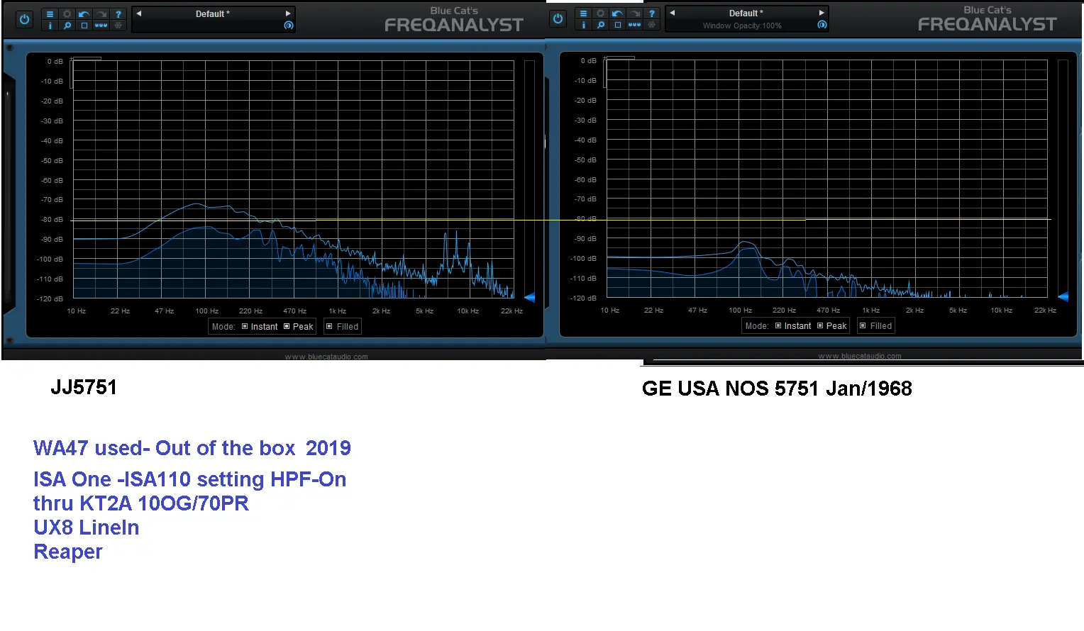

at first there was so much noise, I thought "this doesnt work for me". then I thought, its Tube , let it warm up...so left and came back and still it was so noisy just idle. I spoke and sang into it and it sounded ok....but the noise was too much.
I captured it on the BlueCat noise oscope plugin.
having a NOS 5751 sitting within arms reach I popped it in and took a magnifying glass over the internals to look for a bad solder or something. Nothing bad found. I popped in the tube I happened to have left over from the LA610's I test drove awhile back.
GE USA 5751 jan1968, green label with faint gray decal lettering..
Retried it thinking if this aint it, ,,,,,powersupply?
But no worrys...the BlueCat showed what my ears heard , a huge noise floor drop.
sang a little McCartney line or two, very very nice, through the KT2A with 3db and smooth. ...and quiet noise floor.
mp3 is 10second, 0-3 JJ5751, 4sec-9 other tube

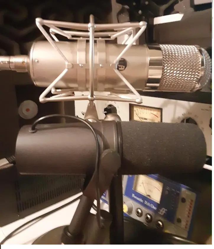

I had the exact same thing happen with the brand new one I got from Sweetwater.
The tubes they bought in bulk had a high failure rate that sometimes even happened after being demoed at Warm Audio.. and became bad along the way in transit.
I ended up getting a Sylvania 5751 and that low end rumble went mostly away.

I do like the MXL shockmount better, it has the pinch mechanism to spread the mount on and off and a larger contact surface, while the other uses small bands for contact and the "clip approach". I got the larger MXL Metal Vintage pop filter for the WA47, as its a fat-boy diameter...

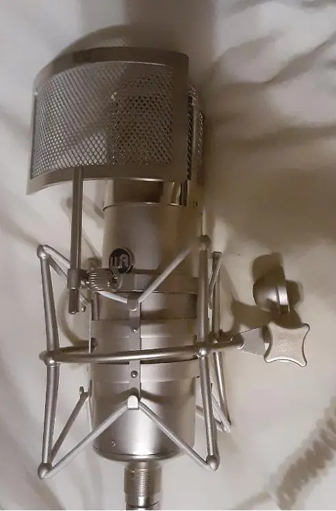

I dropped some cash on a the Metal Vintage filter , WA47. Not only does it look cool like EMI's, its so much more attached than my floppy gooseneck popfilter...it was expensive though but fits on all 2" type diameter mics.
The MXL V67G heritage series comes with one that fits smaller diameter mics like V67G and WA JR....
