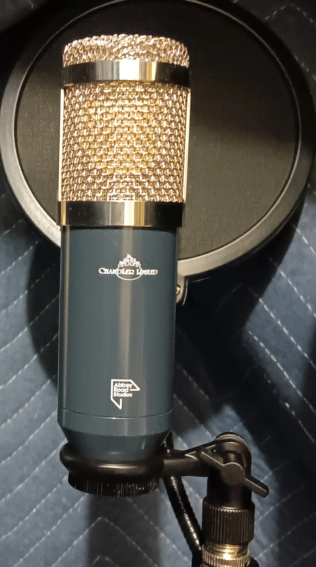

A Chandler Limited TG- type L showed up. The "hand built, no IC chips, all discrete, with transformers, and the larger TG capsule, Cardiod pattern" got my interest.
It came in a nice box, and a hard mount, went on my desktop small mic stand. The other mics I had in arms reach were the KSM 32 original, a MXL V67G, Shure SM7.
Reading the literature it recommends pop filter, and allowing time for the phantom power to be on and off, etc.
It was free of hassle, all I needed was a mic cable and 48v phantom power.... the TG-L. The standard Pad of 10db, worked. Then came the A sound vs B sound, Id read about.

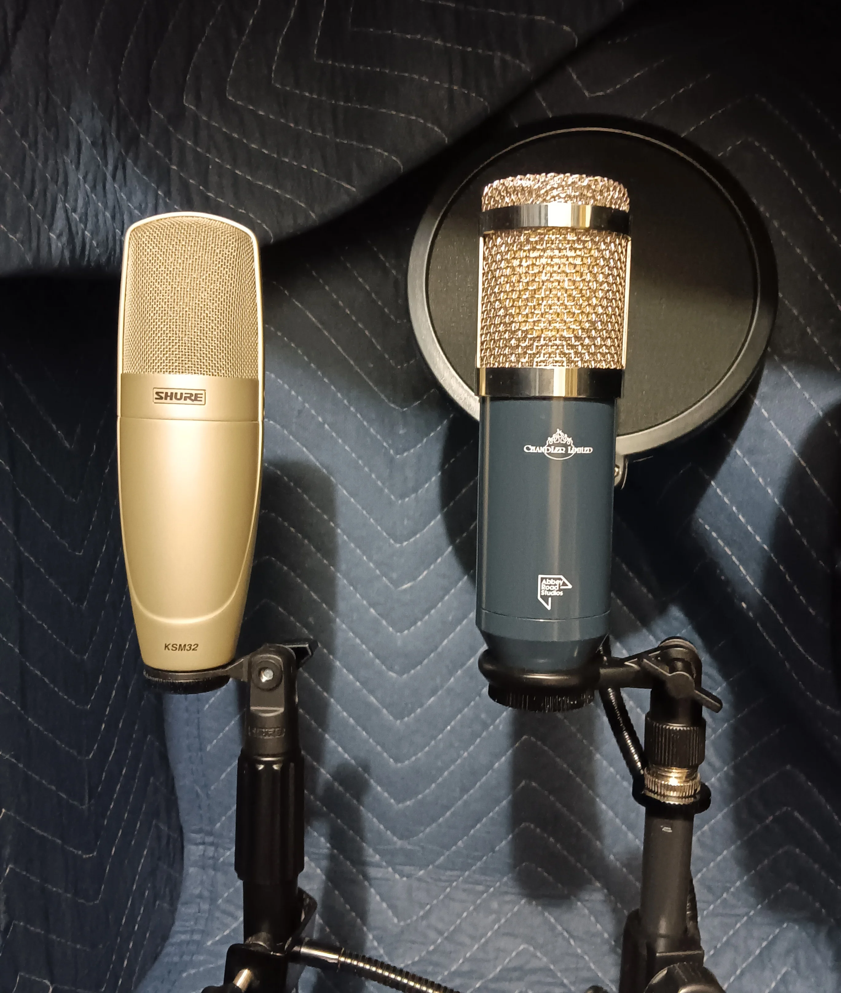

Of course my neutral mic is the KSM 32, original , means it has the version with the tightweaved Headbasket. Its a neutral mic, MDC capsule, quiet, clear, IC chips and no transformer vibe.
I added a picture to compare the sizes.

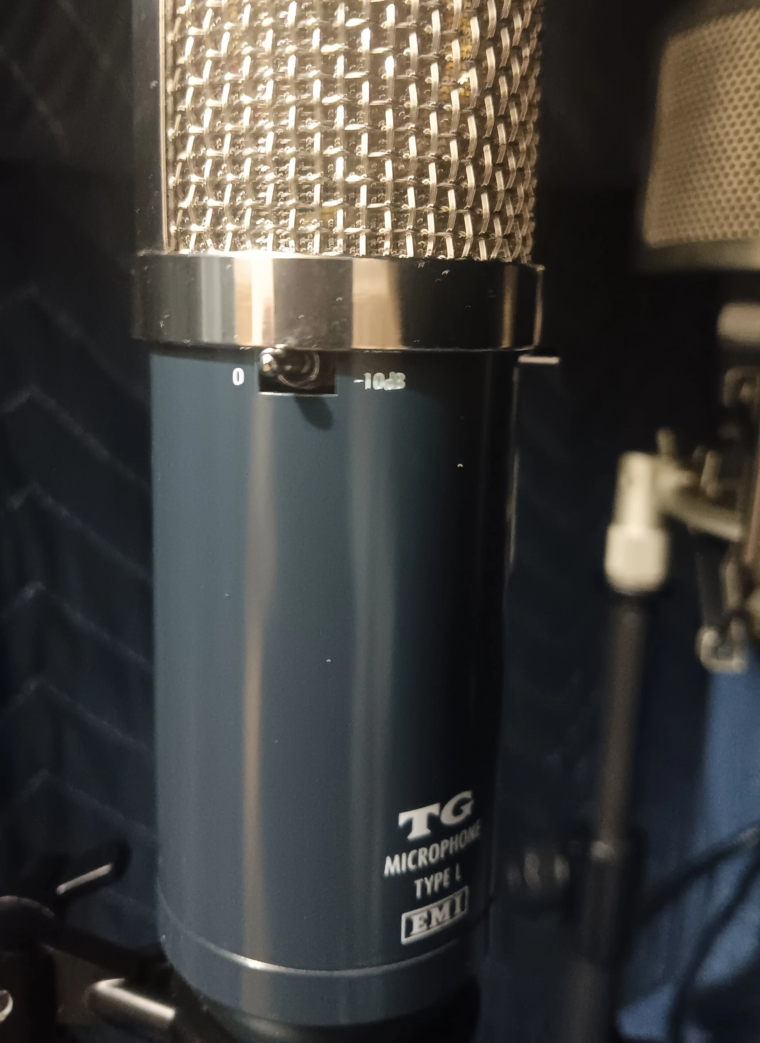

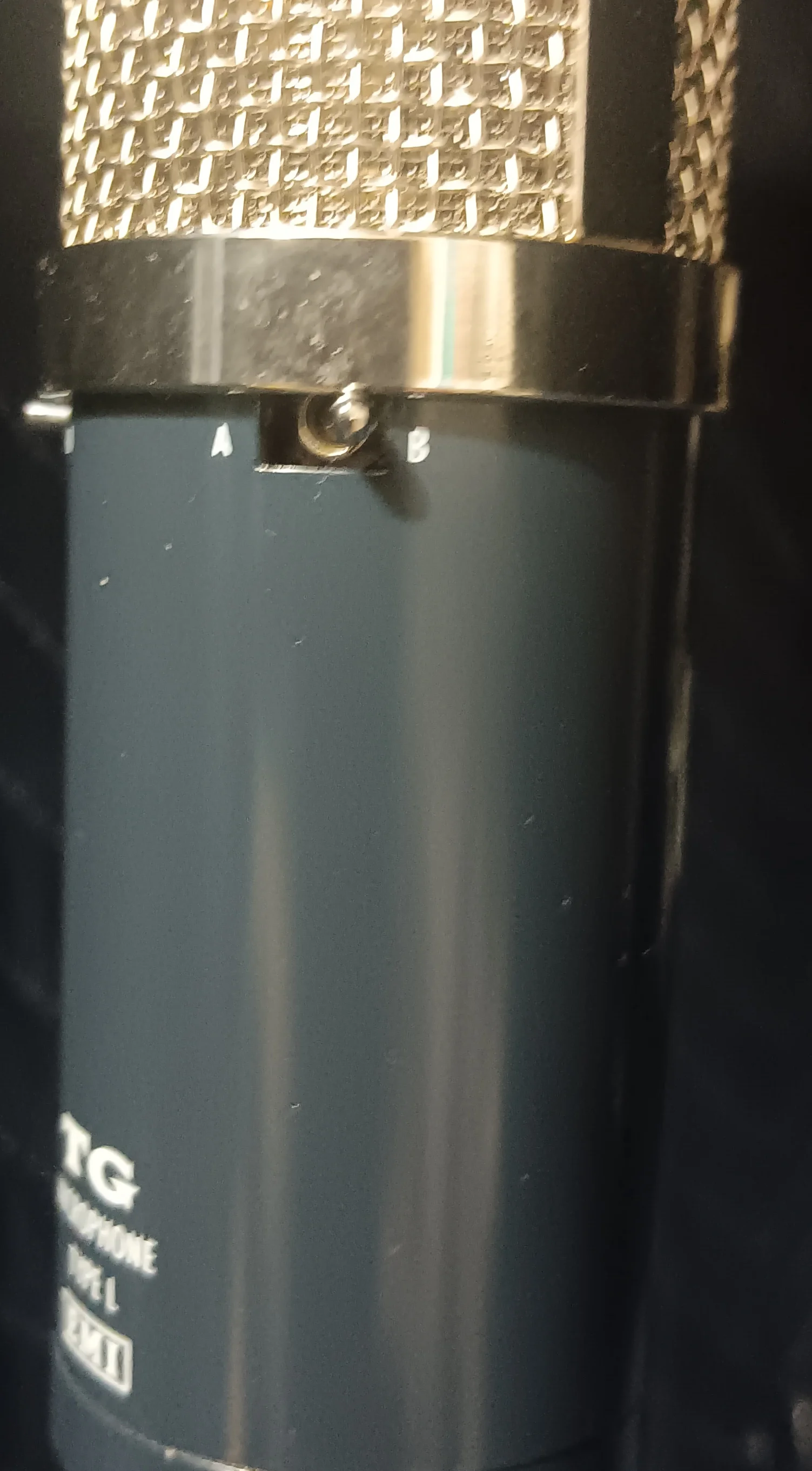

The A is louder and the B setting on the TG-L is even less sensitive, which is great imo.
I also tested the A&B switch and there is no "popping" at all as some said. This is well thought out.

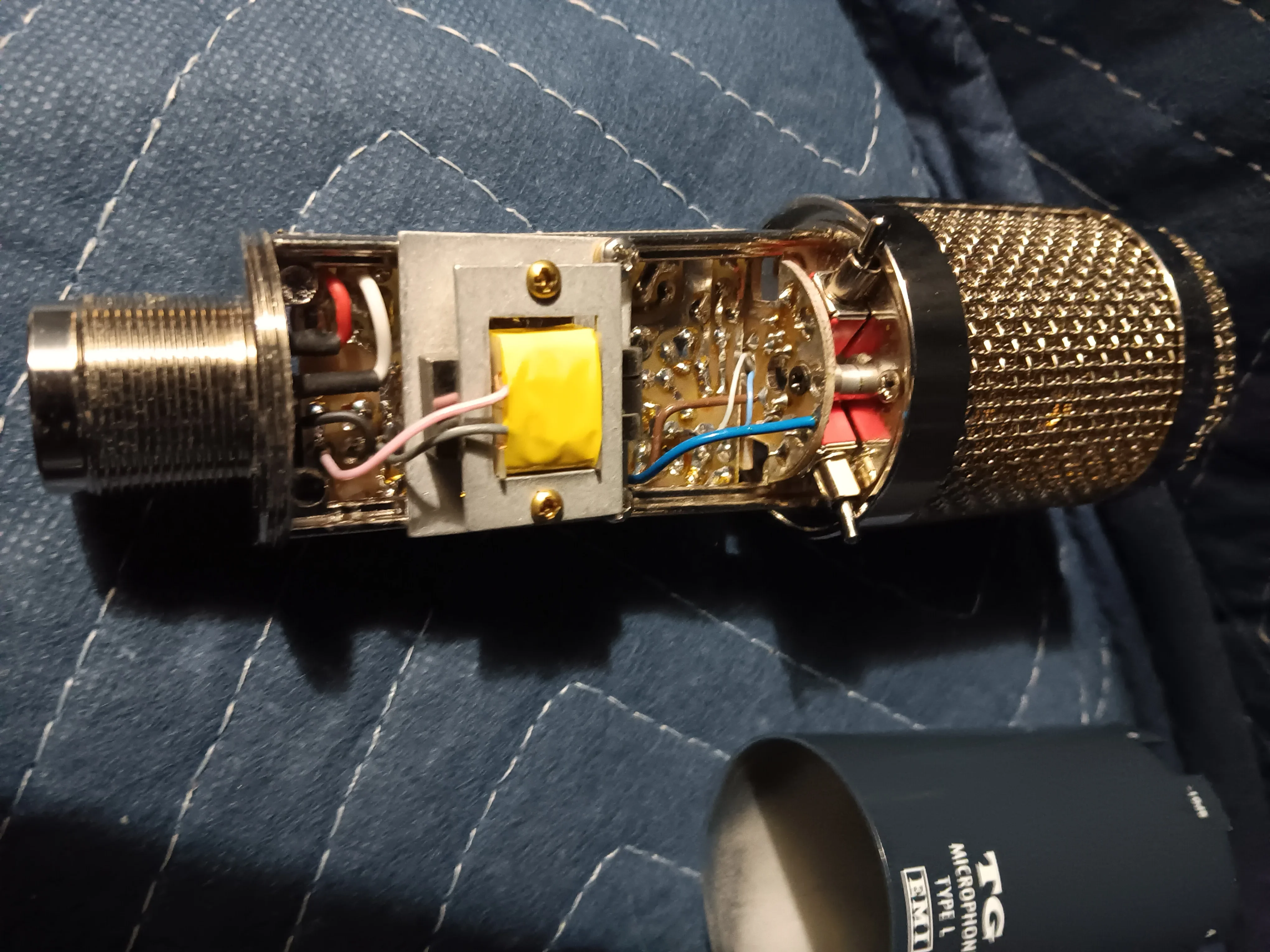

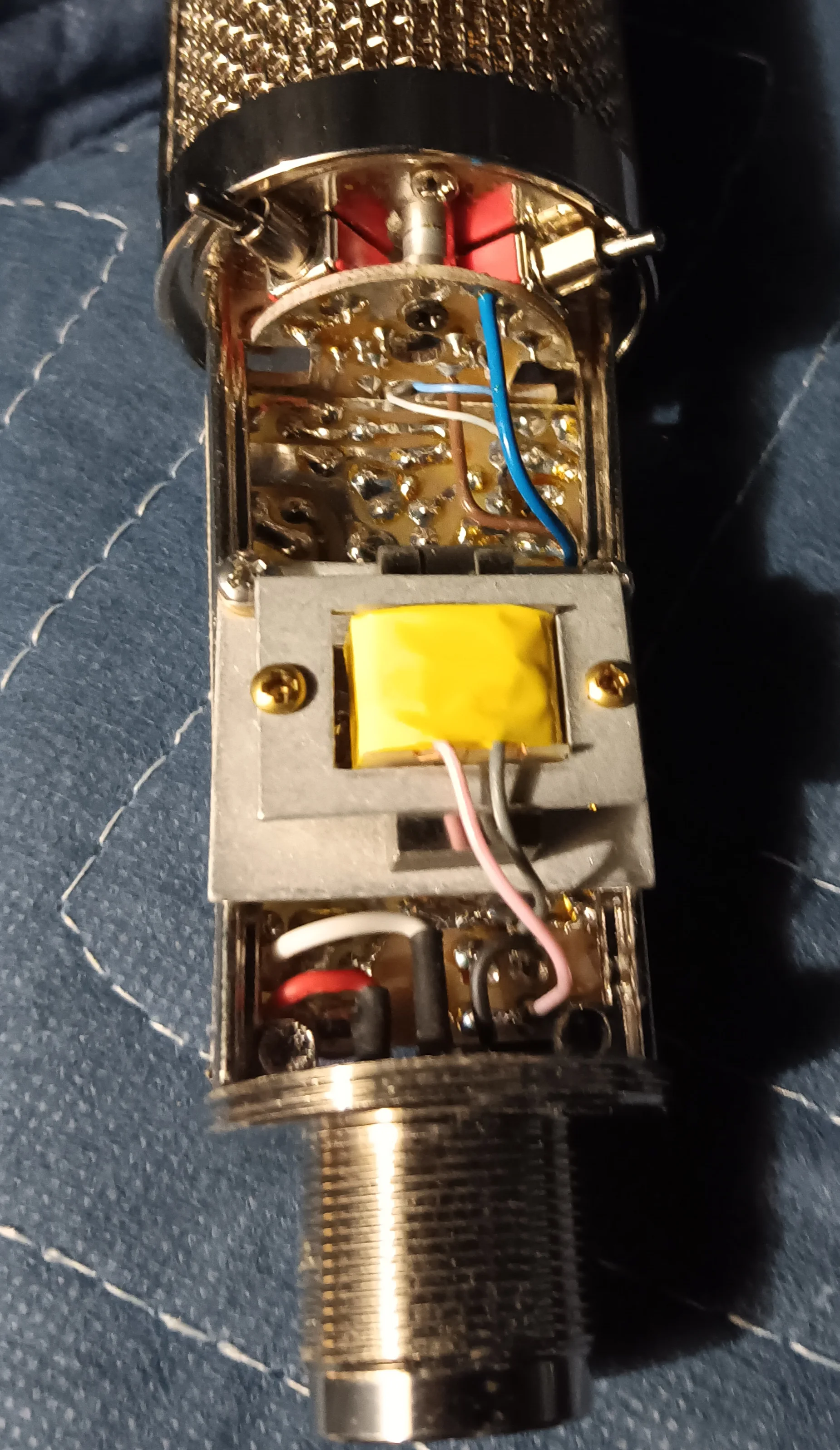

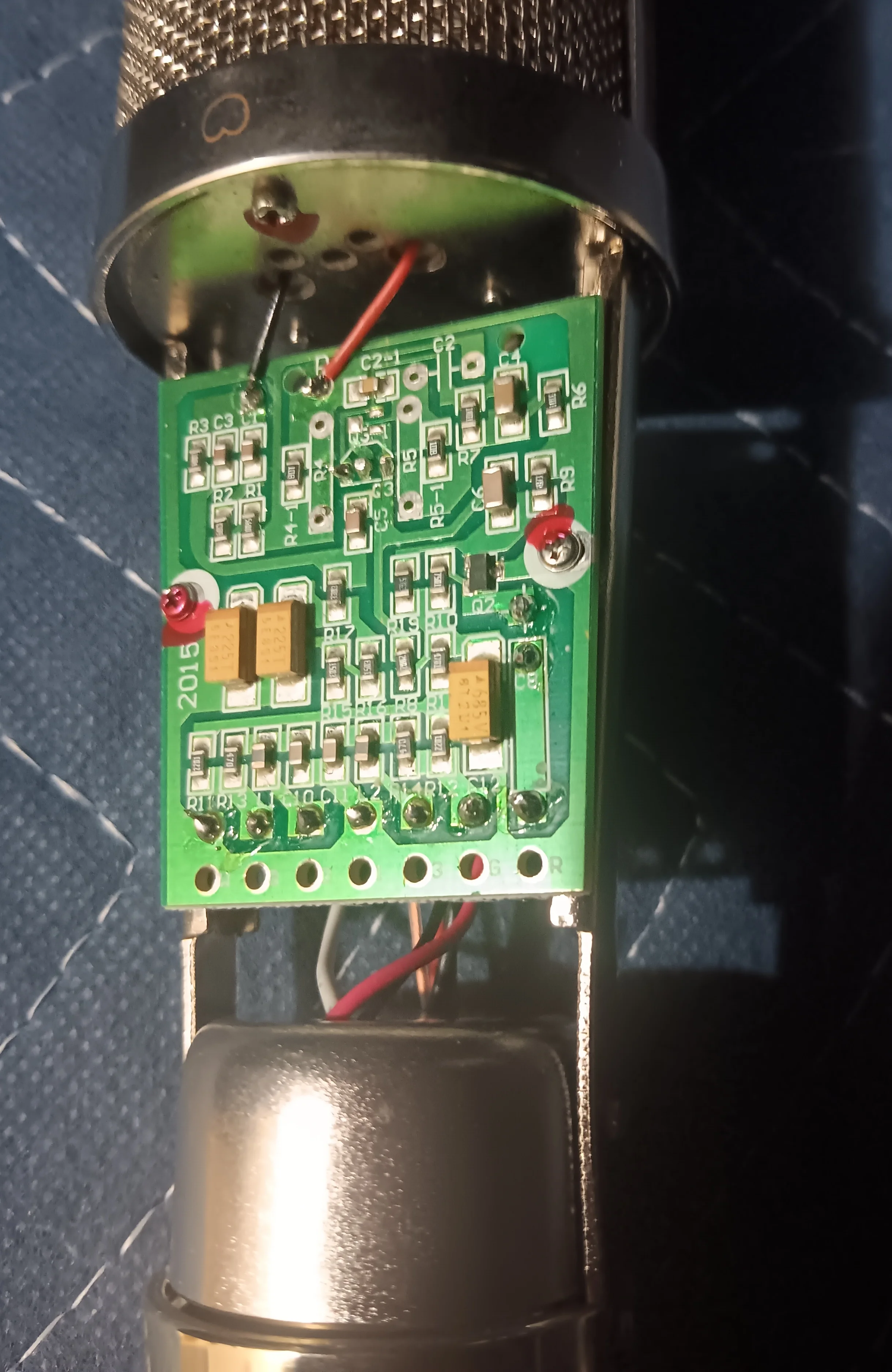

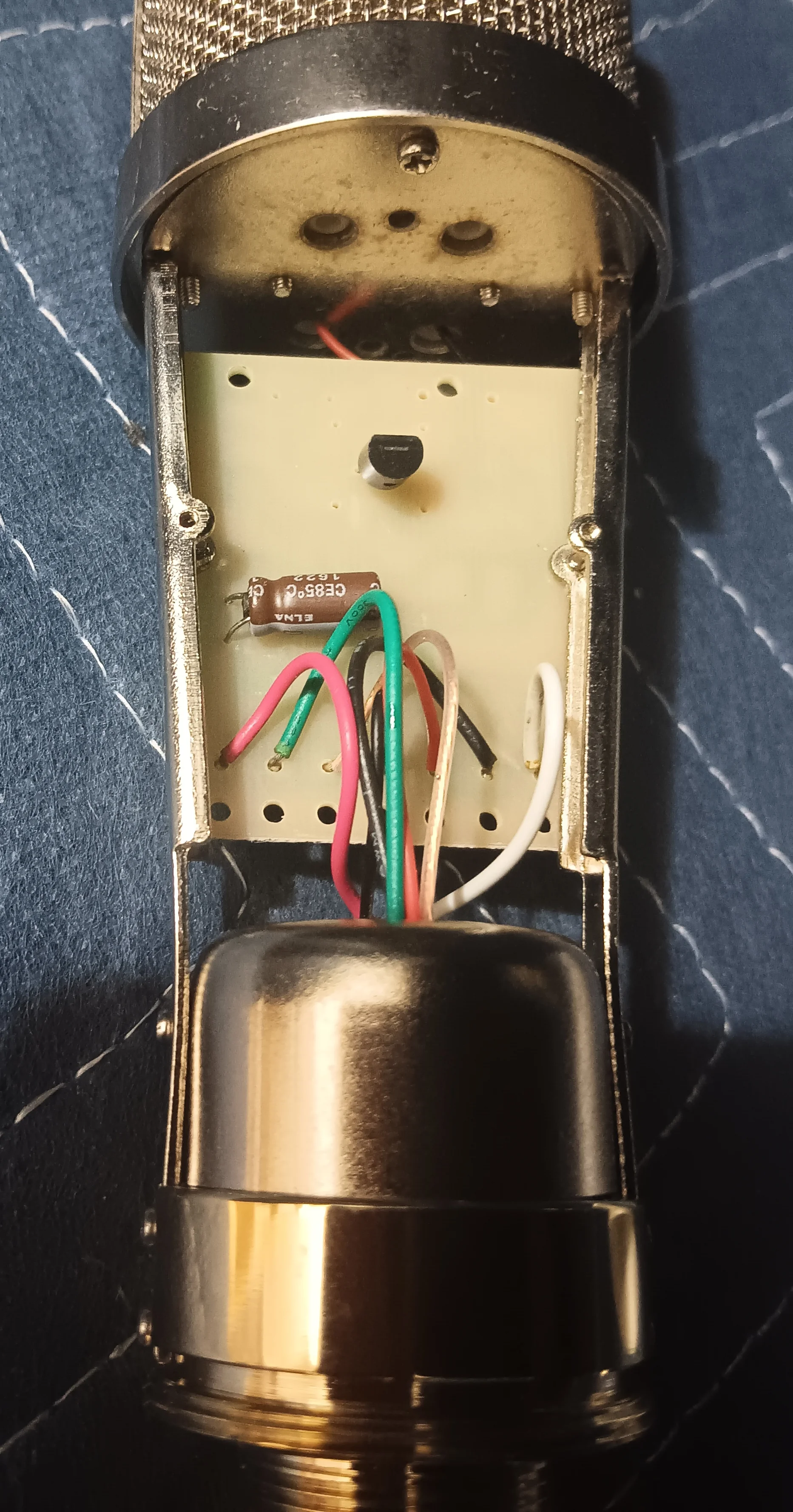

Heres some pictures.

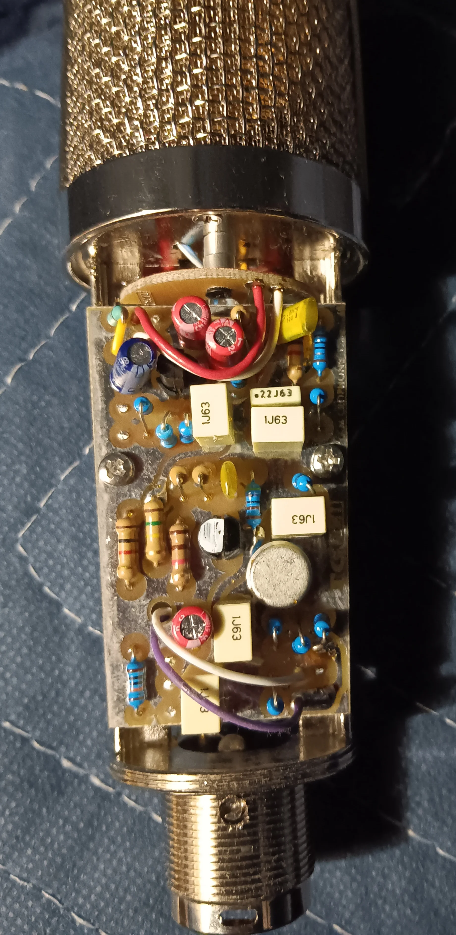

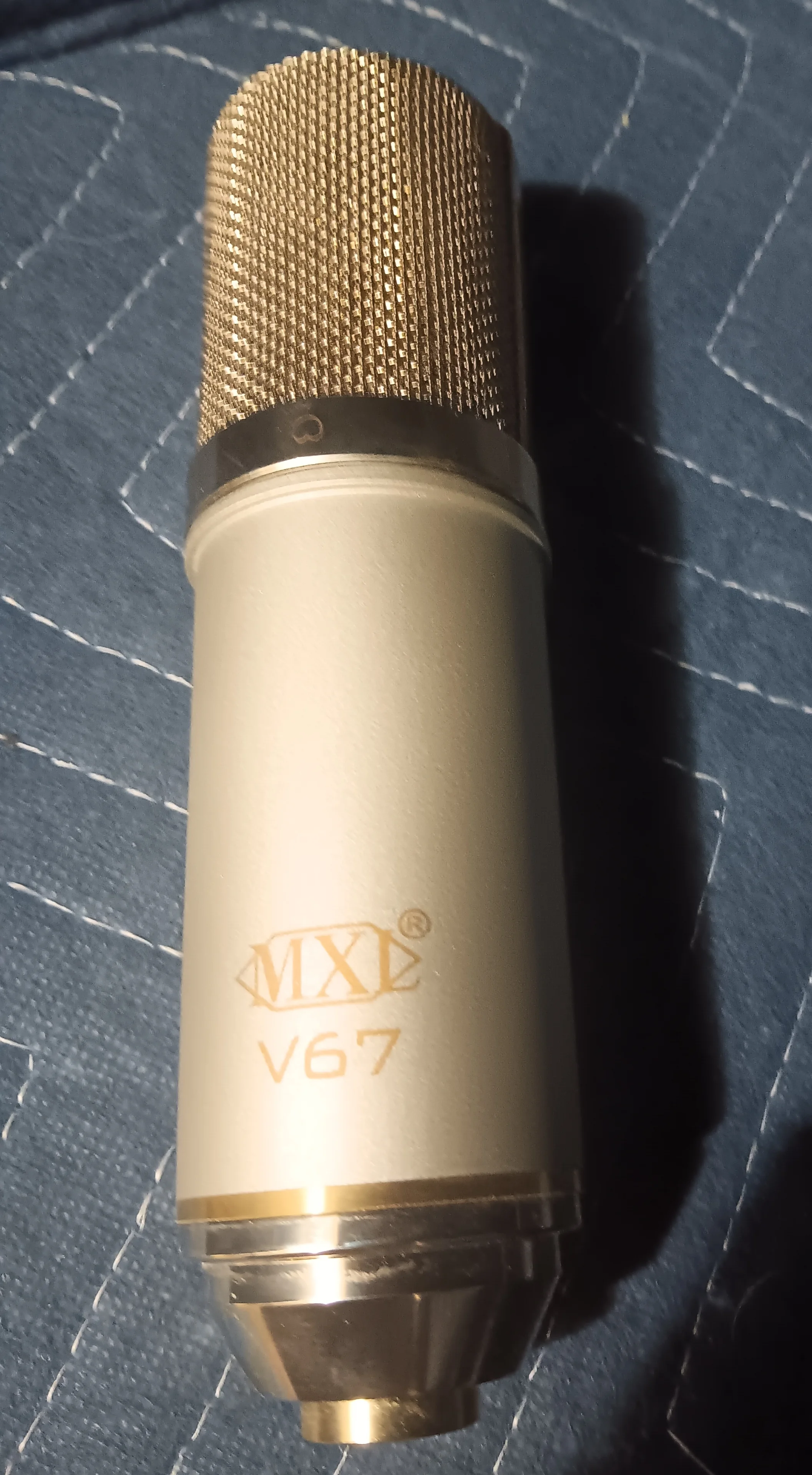

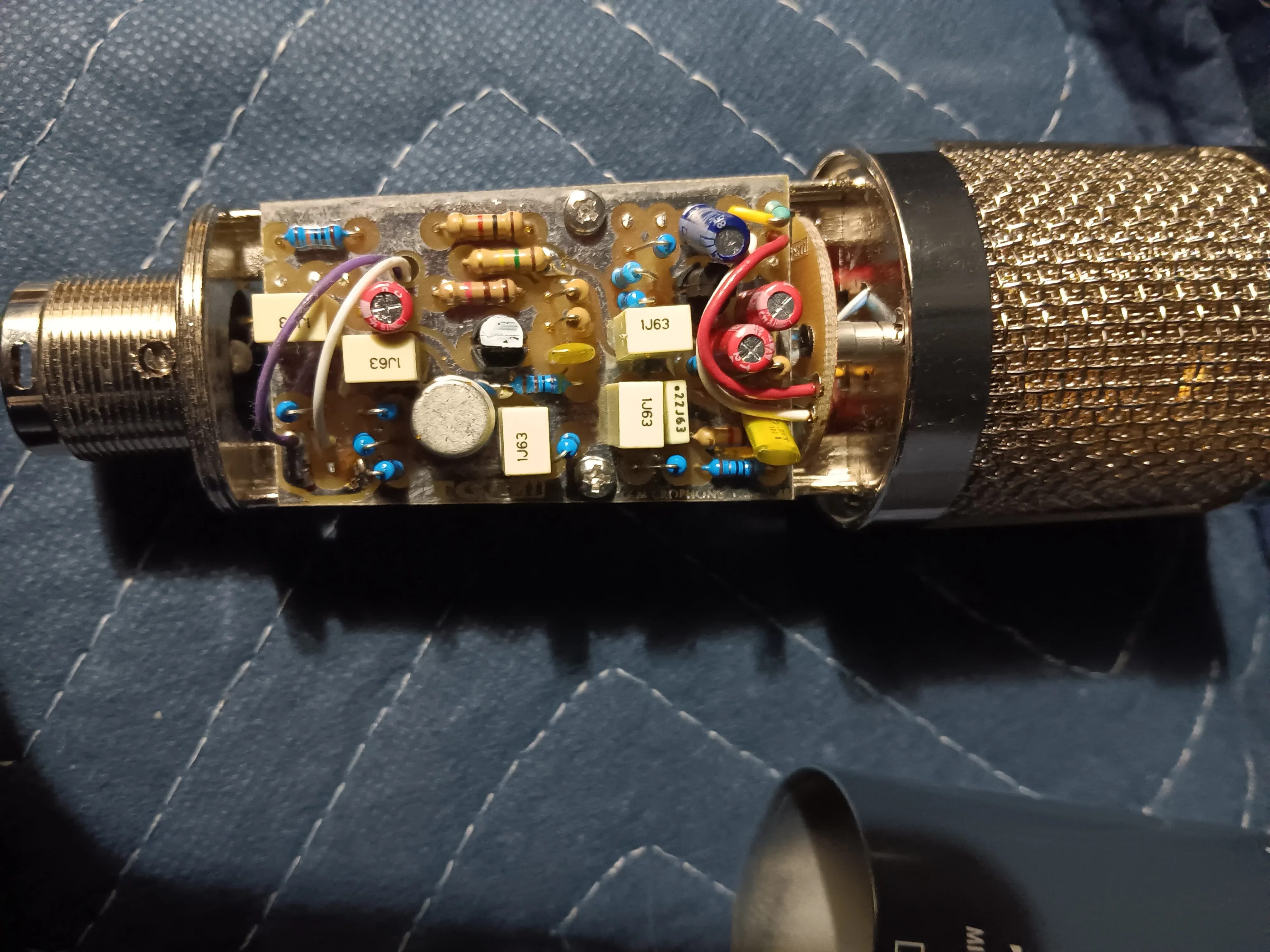

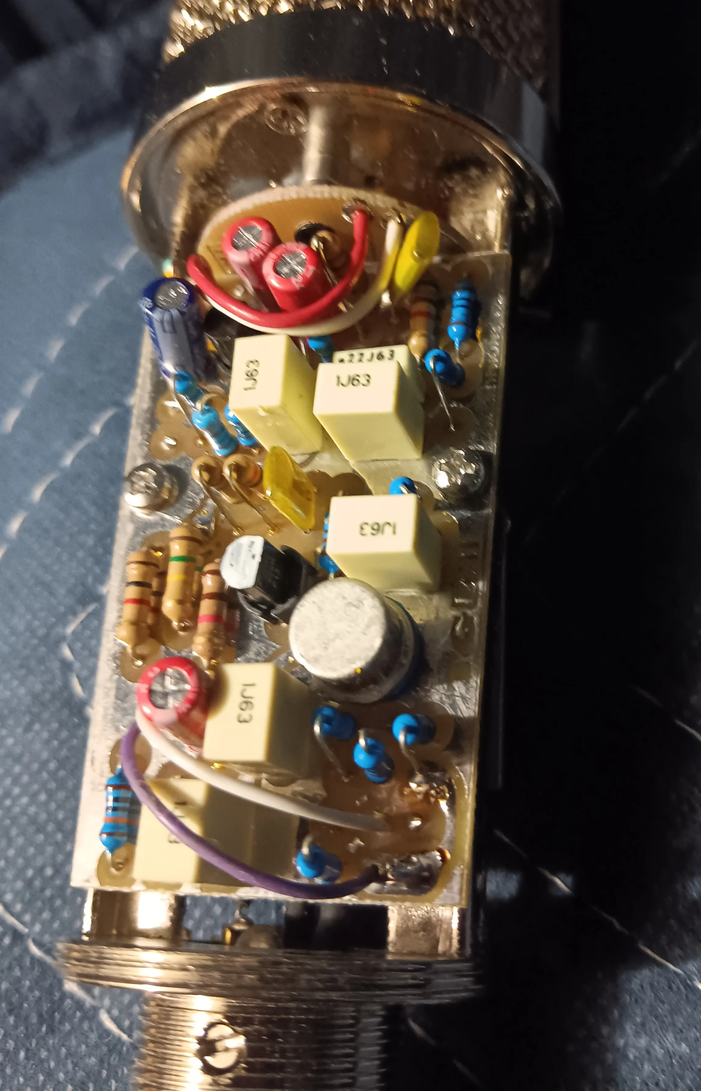

Heres some MXL pics V67G, showing more, chips and transformer, with some internals but nothing like the TG-L all discrete and its larger transformer.
Still both are great mics imo and more "crispy, transformer, design LDC " we like on some things. ..some call it color, or vibey gear and as Chandler doesn't

Getting into Transformers, Discrete, handbuilt, and a nice capsule, in addition to two settings, $700 is understandable. I guess.
With a basic Jensen transformer costing $175ish +/- $80 or more, adding transformers is expensive, and other parts of quality a bit more. The Sales&Marketing guys push the Non Transformer Mics as better specs....and its true..but not everyone is all about being "Julian clean", imo.

I have a MXL V67G - I wouldn’t say it’s colored - I would say it’s hyped in the High end - with a steady rise and then drop from 1.5 Khz to about 15 Khz -
- without EQ the V67G will never sound close to the U87ai and nothing like the ELA M 251 - The Chandler Limited TG L as you know doesn’t have published specs -
but Mic to Mic I think it’s very close the Telefunken ELA M 251 - I think you would need some EQ to get it to sound like the U87ai.
