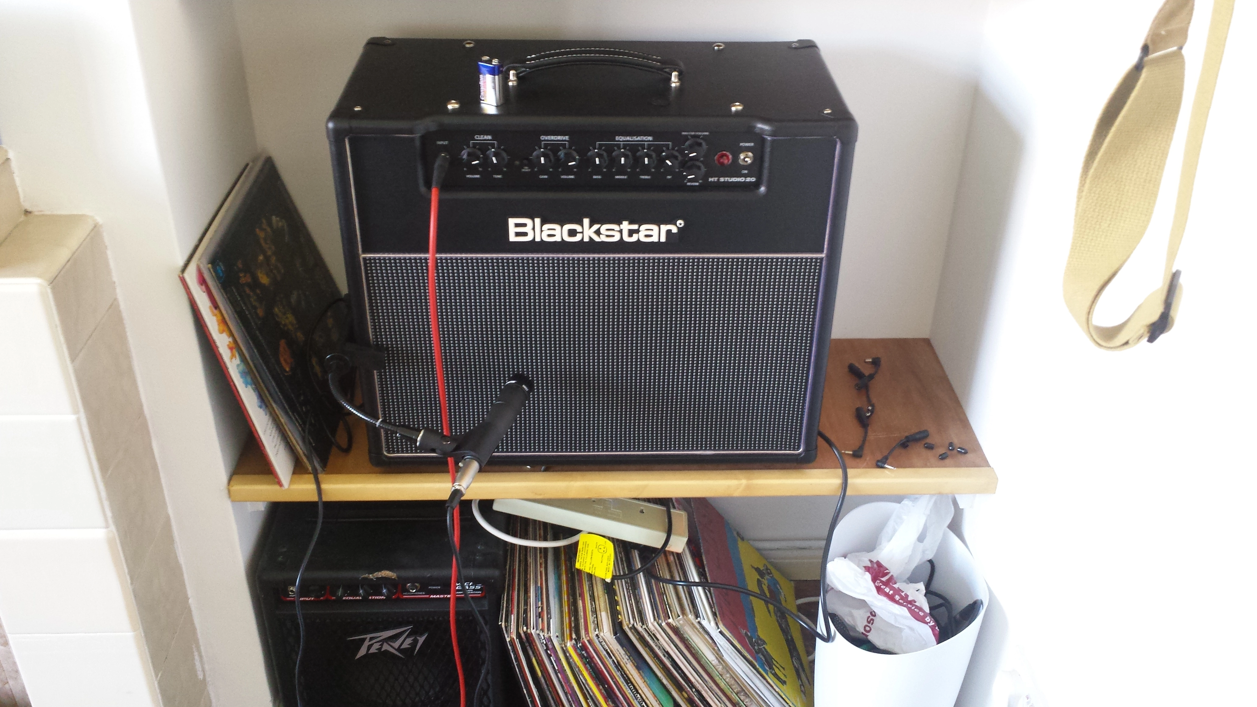

I don't really need to monitor my guitar in real time: I'm standing next to the amp afterall! Would just be handy to have my headphones on when I am working on my mic placement so I don't just do loads of iterations of trial and error
On the default skin, it's just below the FX button. You need to expand the track to see it. Otherwise, on the mixer window, it's below the solo button.
Cheers, will have a look next weekend - my cab clamp doesn't seem to have an arm quite long enough to reach where I normally like it. Annoying.
Get a mic stand. Those cab clamps are okay for live use when you're just sticking a mic and the soundguy is gonna EQ the shit out of it anyway, but for recording, a regular ol mic stand is better. Those cab grabber things are limited and they will sag and droop and get weak and they're just a pain overall.
For monitoring, if you can't direct monitor through the interface, set your latency as low as you can if you can and use Reaper's monitoring function as jonny suggested. If there is latency, it can be distracting.
Cheers Greg, great idea. Might look at finding a straight stand without the boom. Actually - I think I can botch one together out of my normal mic stand and a couple of bricks or something.Is that amp staying on that shelf? Is that it's home? You could use a low profile stand, like a kick drum mic stand. They have a heavy base and a small footprint. I use them on my own cabs pretty much exclusively. They take up no space.
Cheers, Mate. I'm really happy with it. Never owned a valve amp and can't believe how dynamic the sound is. I've very rarely used the gain knob on it so far - just the volume on the crunch channel. Goes from a really nice punky distortion on the bridge pickup to almost clean when I switch to the neck and single coil tap it.Oh and congrats on the new amp.
I see that Give Em Enough Rope album on your shelf too. Great album.
Cool, I'll keep that in mind if any odd noises crop up. I was pretty surprised by the sound those screws made that I left on the shelf under the amp - they sounded like a snare buzzing.
