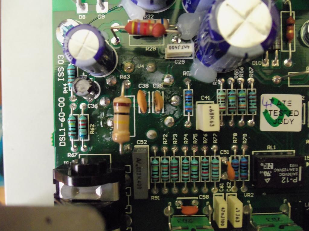

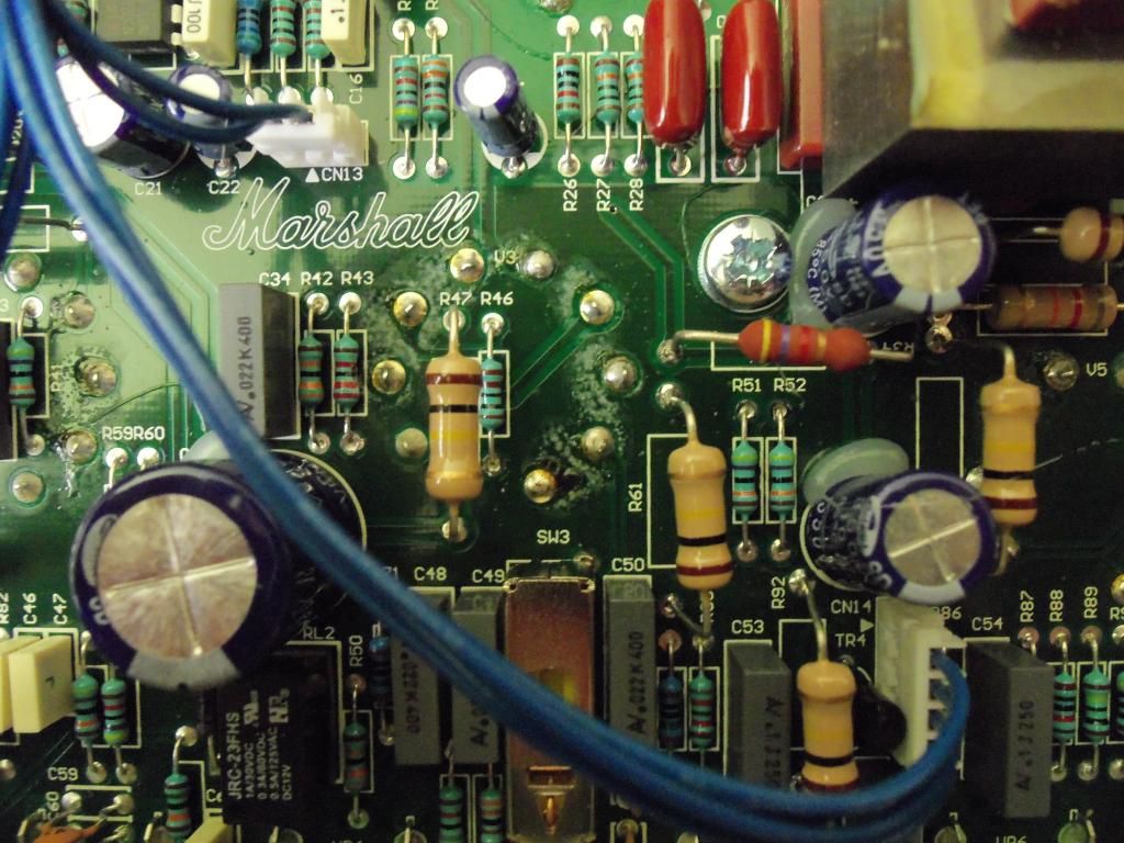

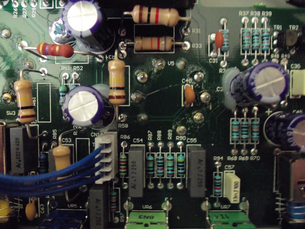

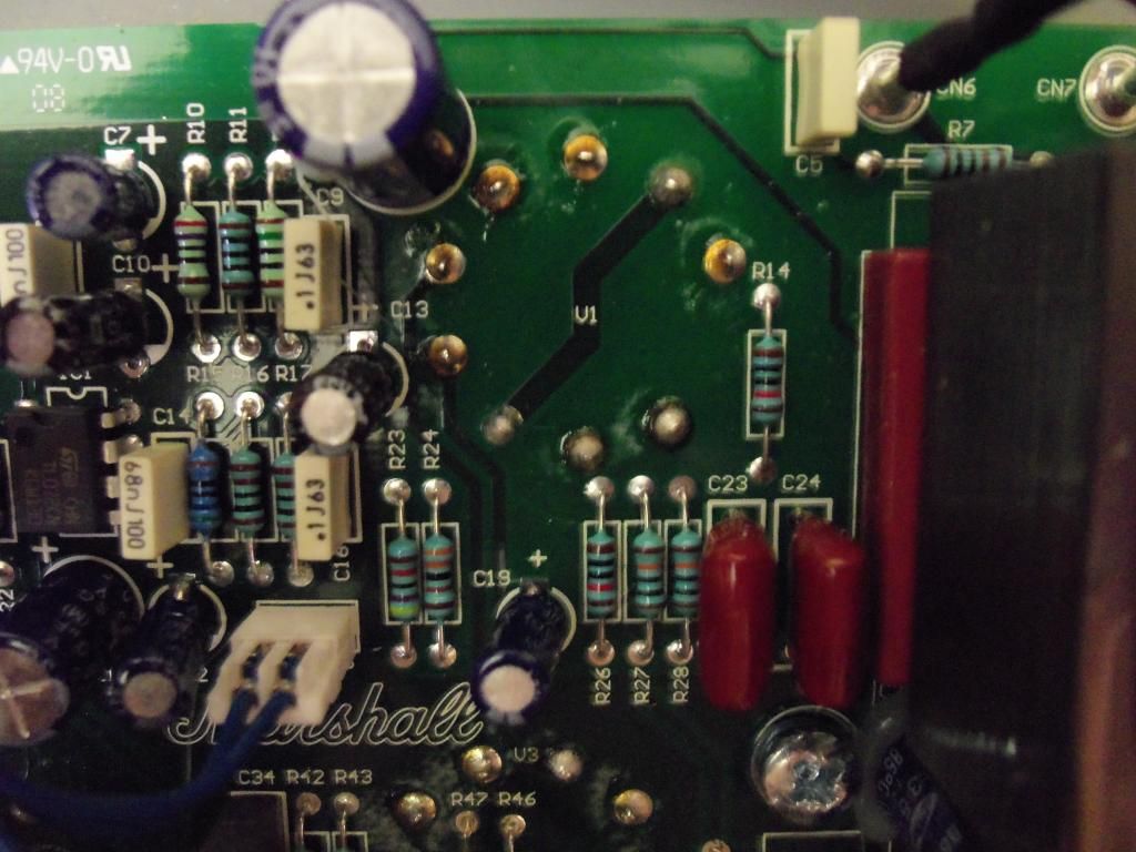

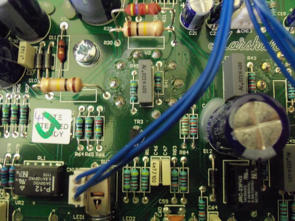

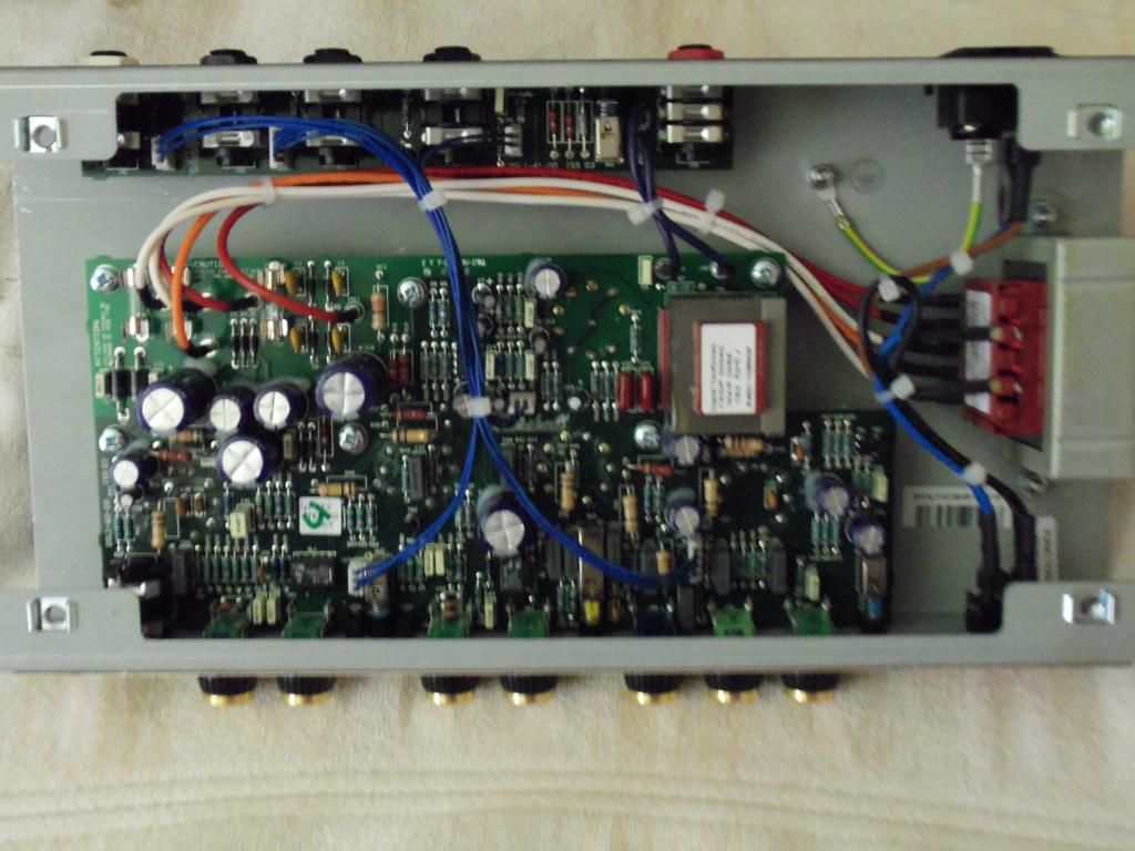

Ok guys, here are some pics of my amp, I don't know if they'll be useful or not, I may have to zoom in or have other parts of the board in 'em, but here they are anyway...
Looks like I did have the tube layout wrong according to their #'s on the board, & looks like V4 is the first gain stage (closest to the input jack), but please correct me if I'm wrong....I was calling V4 (closest to the input jack), V1....
V1: (12AU7 tube/power section)
V2: (12AX7 tube 2nd stage in the pre-amp I'm assuming...)
V3: (12AU7 tube)
V4: (12AX7 tube 1st stage in the pre-amp I'm assuming...)
V5: (12AX7 tube)
In the JVM-1 thread I posted, the only mod was adding/piggy-backing a resitor to the plate resistor, & it lowered the gain, giving him a more useable sweep on the gain knob....I started a thread over at the Marshall forum, & uploaded the pics...Maybe somebody will be able to compare my amp to the "big" DSL's, & figure something out...

Big transformers, ain't they??? It's unreal these amps retail for $800, there's literally nothing inside 'em at all....I didn't pay $800 for mine, got it for $600 & some change, but still...
If there's anyone here that knows anything about the big DSL's lemme know, maybe between a couple/few forums & a few different people, I can mod this thing where I'll like it even more than I do now.....

Try to look at one though and compare it to what you have. For example, look at the input jack in the schematic and see where it goes. Then compare that to what yours shows you in person.
You can use this to decipher all those resistors:
4 Band Resistor Color Code Calculator and Chart ? Online Conversion Calculators | DigiKey
You might also need to pull the board to see where the traces actually go. A trace on a PCB is essentially a wire.

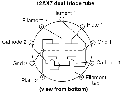

And every 12ax7 follows this layout:
Regardless of what kind of amp you have, if you're using 12ax7s, that's their layout. You just need to find out which half of which tube you need to modify.
Thanks dude, I've figured that part out with the info in the JVM-1 thread mod, pins 1 & 6 on go to the resistors in question, if I'm correct....And I'm pretty sure that it's V4 (the tube that's closest to the input jack) that I need to mod/change resistor values, but other than that, I'm just guessing without someone that actually knows this shit, with enough experience to tell me what I need to do...
But, all this is assuming that V4 is the first gain stage like the JVM-1 too, again, I'm just guessing here, so I'm just gonna wait until I hear from someone who actually knows....
