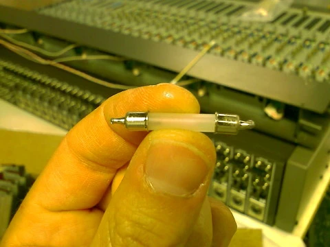

The meters I have (like on the 38) have soldered in bulbs. What do these look like? Being a bulb with a socket base they should have a number on them and perhaps be available fromm souurces other than Tascam.
-E
Those...
Those meters would typically have an 8V fuse-type incandescant bulb. Clips in on either end like a fuse & is roughly the same size. Pretty specialized and not a typical off-the-shelf item.:eek:;)
The bulb
The VU bulbs in the M520 do indeed sit in a pseudo-fuse-kinda-lookin'-holder-thingy. The bulbs look like this (I was too lazy to pull the meter bridge off again to get the VU out and post a picture of the holder :o):
