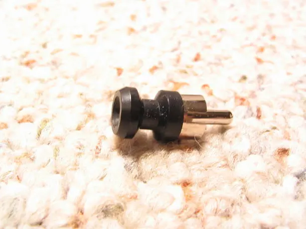

Look at the picture below...
It is a Tascam shorting pin that comes with the M500 mixers (others as well I assume). This goes somewhere on the mixer. This is not the bridge type shorting pins that go in the SEND/RCV jacks...
Anybody know how many the mixer should have? I think they are used in the phono input jacks on channels 3 and 4, and/or in the INST input RCA jacks on channels 1 and 2, or both. The manual is not clear.

I'll take...
I'll take Phono In on 3 & 4 for 500, Alex!:eek:;)

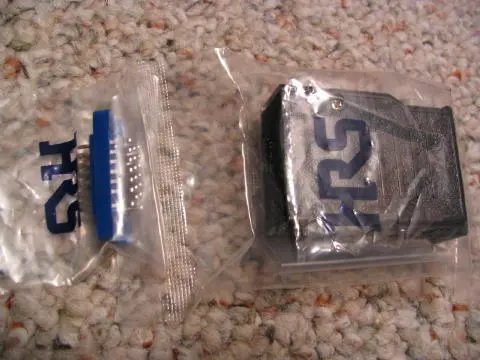

One down, one to go...
Still haven't heard from Tascam on the connector for the other end of the umbilical, but I got one end and the other is officially back-ordered. I'm hoping that means it is not discontinued. I will be contact Tascam tomorrow as I had intended to do earlier.

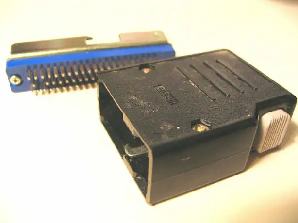

Check out what I found in the boneyard at my local favorite elctronics shop... :eek: I spotted it in a basket of miscellaneous stuff...couldn't believe my eyes...its a hood for the power umbilical.
The hood is a little dirty but there is absolutely no corrosion. Unfortunately there were no 20-pin female sockets, just 60-pin male sockets (I picked up one to practice soldering on) and just one hood...I picked up the pair for $1...If I can get the 20-pin female socket side and hood from Tascam (still waiting for word) I'll do so and keep the hood I found today as a spare. If I can't get the socket end, then I'll keep looking for the socket to complete the hood I found. I've found that the connectors and hoods are manufactured by HRS, a.k.a. Hirose. They closely (at least for what I can see) match the 1300-series which were designed for telco equipment.

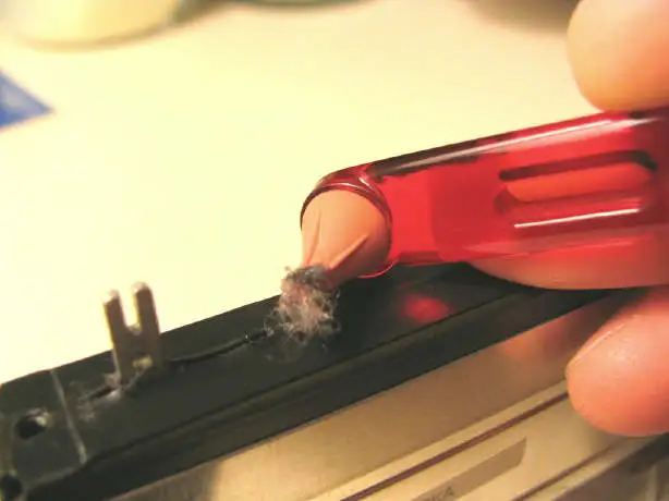

A new obsessive cleaning trick...
If yer not anal-retentive with cleaning up gear, walk on...
I stumbled on this last night trying to clean up the faders for the M520...maybe its a bad idea as it pulls some of the fader grease out, but I was using the rubber pick end of an old toothbrush to pull a piece of fuzz out of the end of a fader gasket...a big puff of fuzz ended up coming out, so I ran the pick under both sides of the gasket and pulled out several gobs of linty fuzz. The picture below shows what I pulled out of one fader after only running it down part of one side of the gasket.
