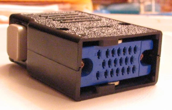

The Hirose connectors came from the UK...
They are all there...hood, connector, latching plate, all hardware...about $0.60 each plus shipping. :eek:

Those connectors are cool.
Could you hook me up with the purchase info of those connectors, or were those the last ones? You're the man.:eek:;)
Dave,
Actually, the reason I bought two of the female connectors from the place in the UK was to give one to you.
Right now I have one male (from Tascam) and two female connectors (from the UK) with hoods for all.
I am in the midst of correspondence with the folks in the UK and it looks as though they don't have in stock but have located the male connectors and can get them at about $10 my cost each. I'm going to order 3 with hoods and one more female connector with a hood. In total with shipping that will be about $50. I'm then going to return the one male connector and hood to Tascam which cost $35. :)
If all works out I'll have a set for me, one for you, and a spare. I've located the proper cable locally here...22AWG 20-conductor stranded non-shielded cable. I'm going to buy enough to build 3 cables. The wire is relatively cheap.
so I'll know more probably Monday and I'll keep you posted. ;)
