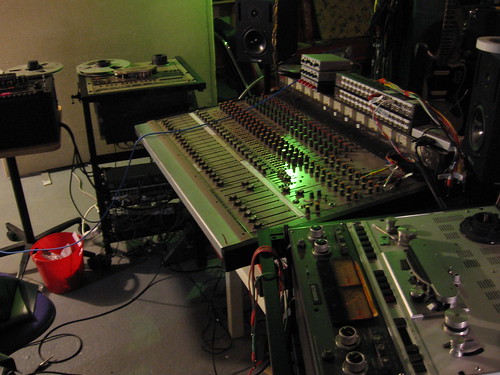

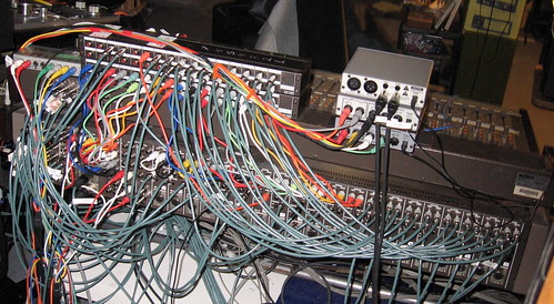

here's how i've set up my stuff:
(excuse the rat's nest)

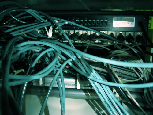

those tascam RCA-to-TS patchbays don't tend to go for much (i paid $25 for one, and the other got tossed in with my m1b). I found putting a couple on the meter bridge really sped up recording for me:
it's a terrible photo, but the 5030 line amp uses RCAs and XLR jacks (pin 3 hot), it converts 8 channels balanced-to-unbalanced and 8 vice-versa. unlike the ebtech model, it's an active design (i'm not sure what would work better).

So cool to see your setup!
Thanks for putting up the pictures! That is a working studio! I love it! :p
So in the first picture, that's the 58 in the middle, your new-to-you B67 on the right...what's on the left? Is that a Fostex E2 or E22?

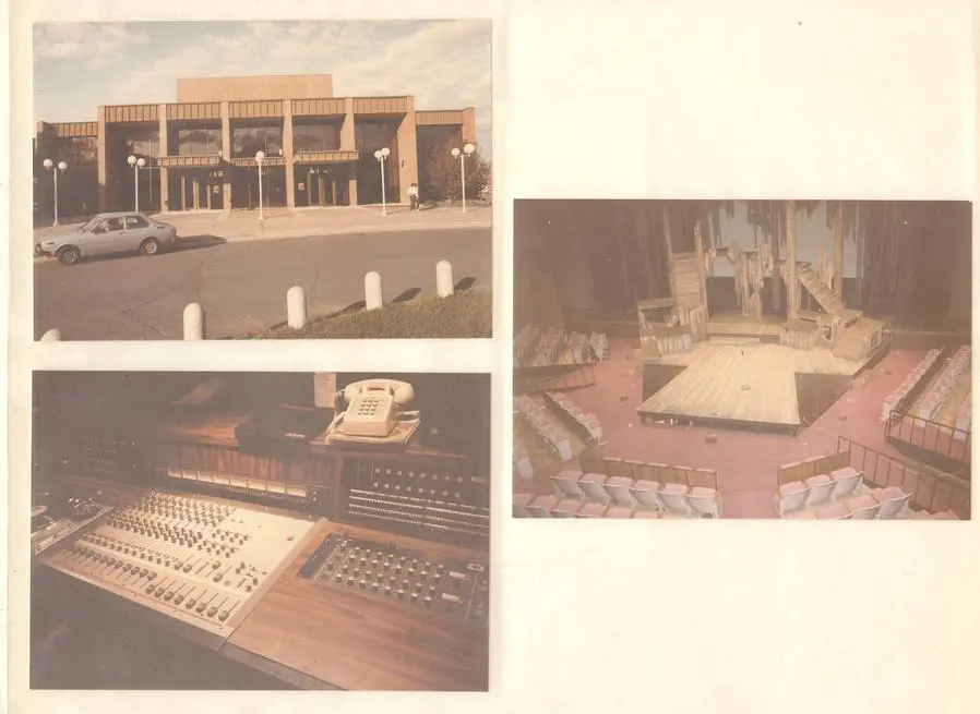

Here's a 512 that I designed a theater system around MANY years ago. The patchbays in the picture (right side of the system picture) are 2 ADC 96 point TT patchbays. The Model 1's were used as matrix mixers to feed the various speaker locations throughout the theater. Thought you might be interested in what patchbays were used at the time. We got lots of signal density as each 96 point bay was only one rack space.

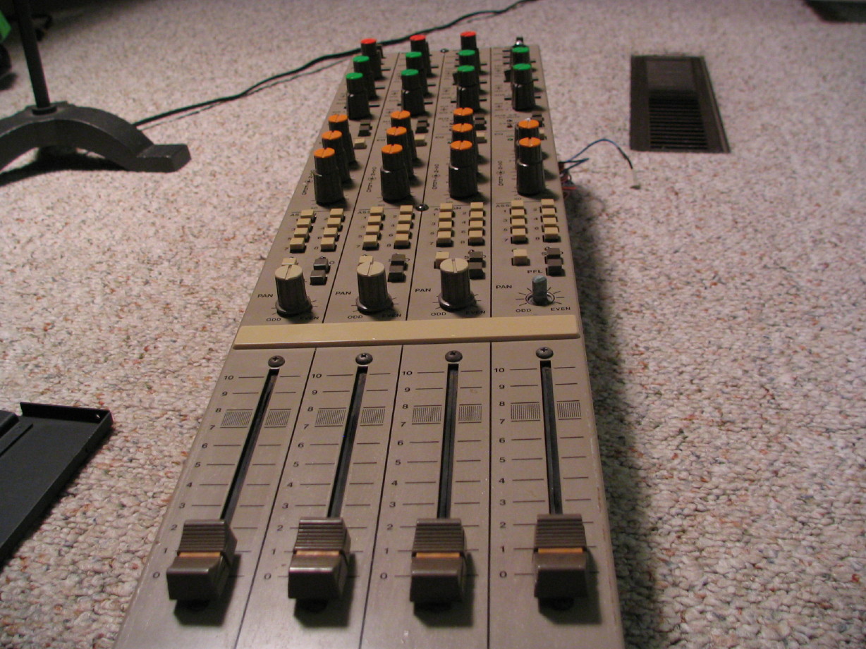

I got some spares today...
I got some spare parts for the M520 today for a paltry sum...
Tracked down a guy over at the TapeOp Message Board who had parted out his M520. Turned out he had some scrapings left.
The scrapings turned out to be a 4-channel input block. He said there was stuff missing, no knobs etc. I was interested anyway for the pots and switches and having some spare input channel PCB's was a nice idea.
Well, see the pictures below. It is almost totally complete, and it even came with a bunch of shorting jumpers which is great because I'm...uh...short a few.
Here's what I pulled out of the box...
Here it is put together...
Another view...Reminds me of a scene from Star Wars...
The underpinnings...
It is a suprisingly clean set...
Anyway, just thought I'd share. Definitely the way to purchase parts unless new is absolutely needed. :p
What is up with the faders on the M520??
This is really wierd...lookit the differences in the faders between the M520 I bought, and the faders on the parts block I received:
My M520 came with the nice really smooth and quiet ALPS faders. The parts block has these standard basic units. Did the M520 come have option choices when new or something? The difference is just so drastic...

Alps made a variety of faders at the time. Both are probably Alps faders, just a different model. The smaller one looks like the ones that were used in the model 5's, 3's, 35's, etc. in that time period, of course yours has the longer throw.
Yep, those new faders look very much like the Alps that are in my S/craft console.

Re the faders. If I recall correctly, the larger faders have their track(s) on the side of the module while the smaller one has the track(s) on the bottom of the module. The larger ones, because of this were less susceptible to spill problems. This is, of course, if that memory cell in my brain is still activated.
Richard,
you've got at least one good brain cell (many more I reckon)! :)
You are absolutely right...the larger ALPS faders, in addition to having the tracks vertical, have open bottoms so spills will also run straight thru as well as fare a better chance at missing the tracks altogether...HEY! GET THAT BEER OFF THE BOARD! ;)
The smaller bodied faders are also physically much less smooth and are physically noisier. The ALPS fades are liquid smooth.

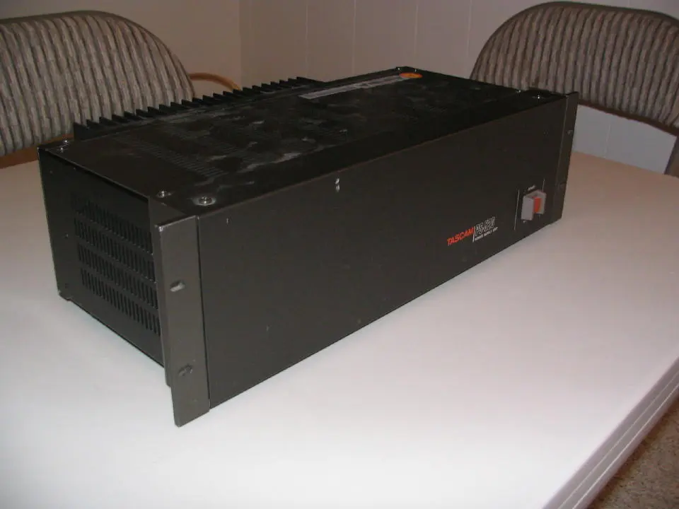

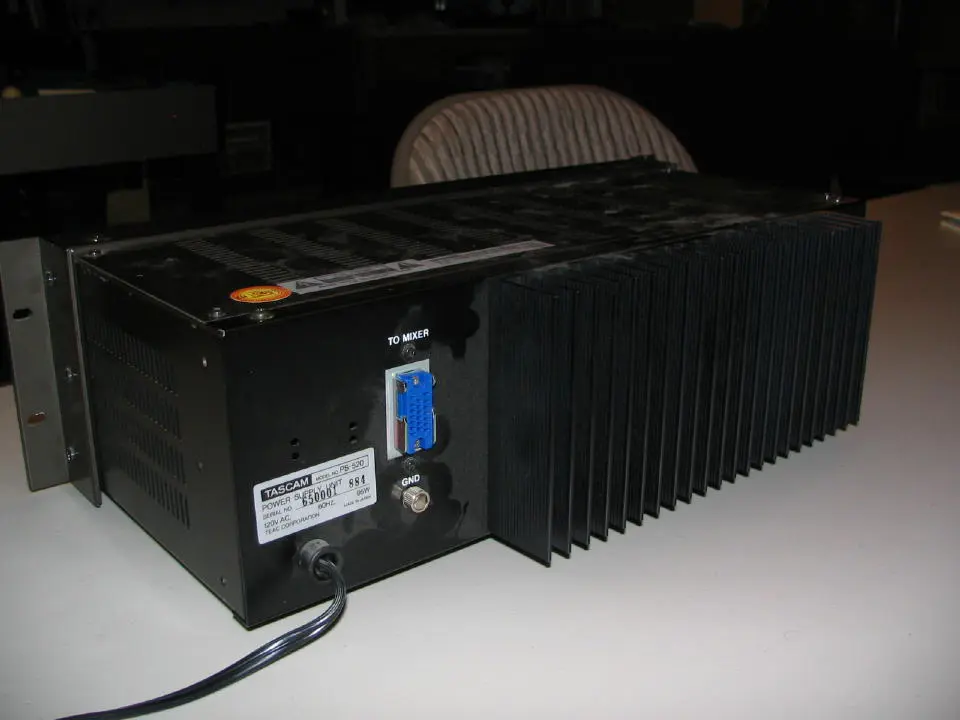

Pulled it out of its well-packed caccoon tonight.
It is in suprisingly good shape...even still has the feet on the bottom. The upper screw-holes on the ears have never seen a screw.
Took a couple pictures, posted below. I have not touched it as far as cleanup. Its really straight and clean under the dust and a couple goobers.
Might do Ethan's smoke and kill tests later tonight.

Man, minor dust aside, it's in really good, clean condition. It's dated 1988.:)
