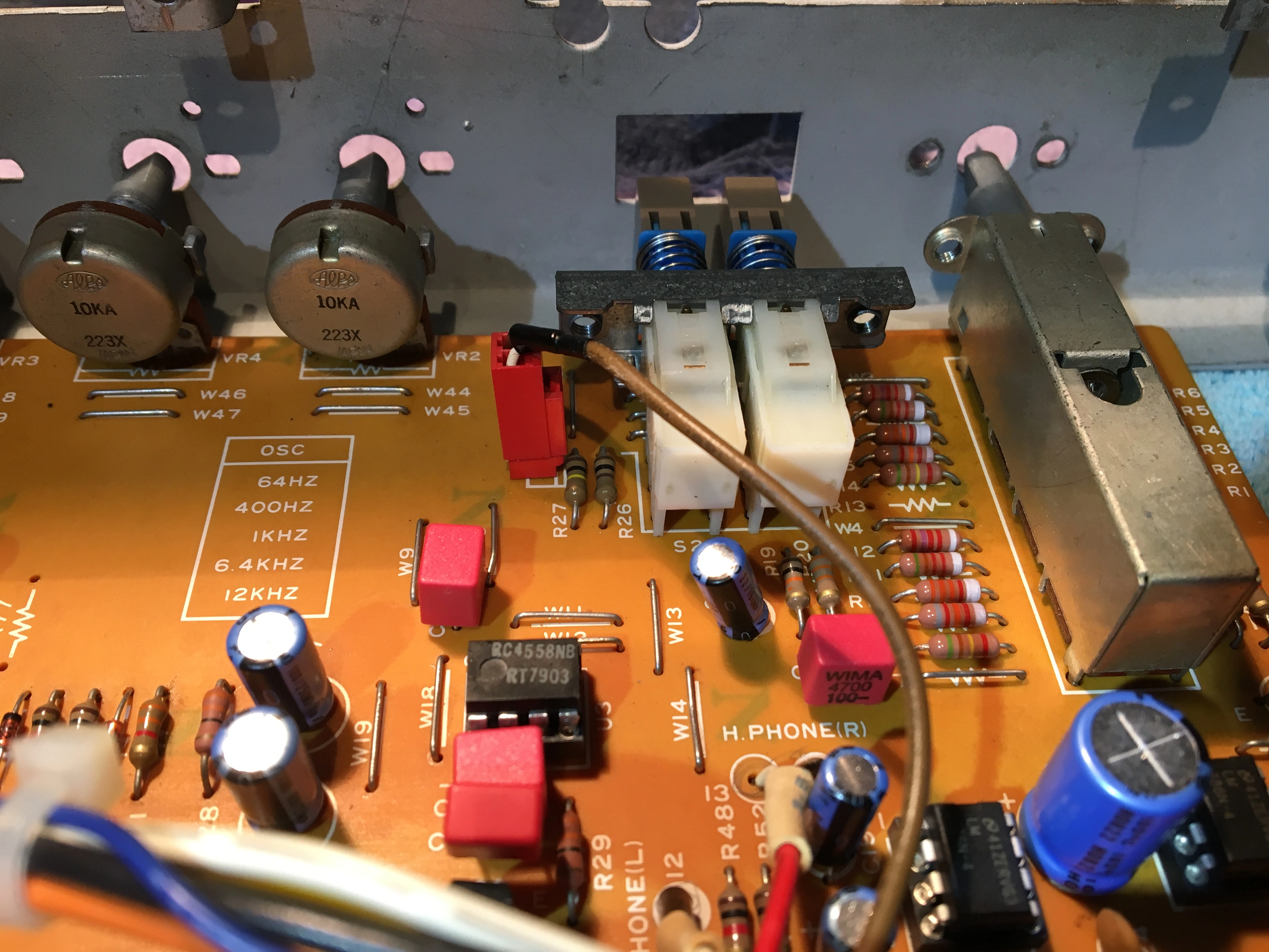

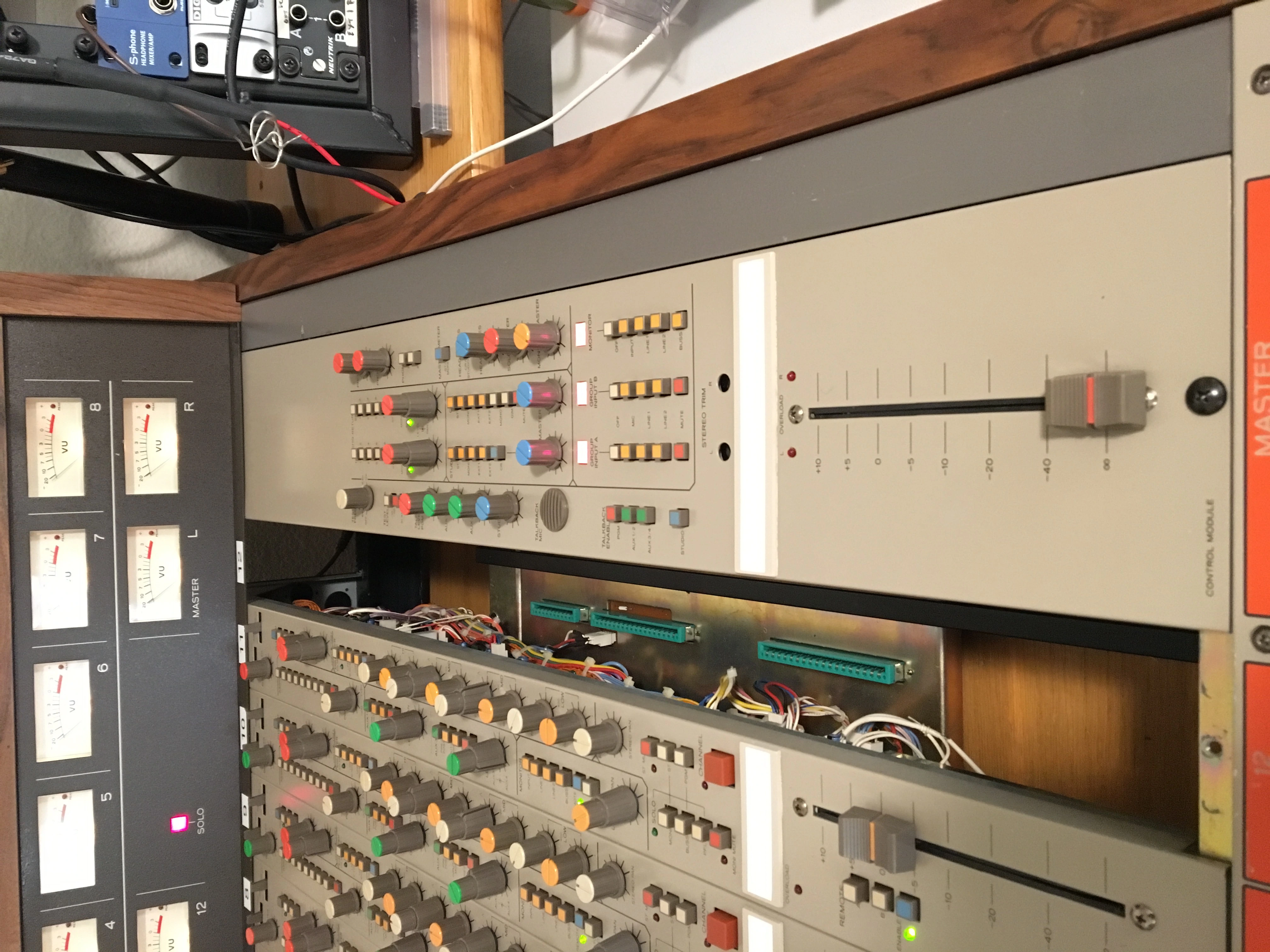

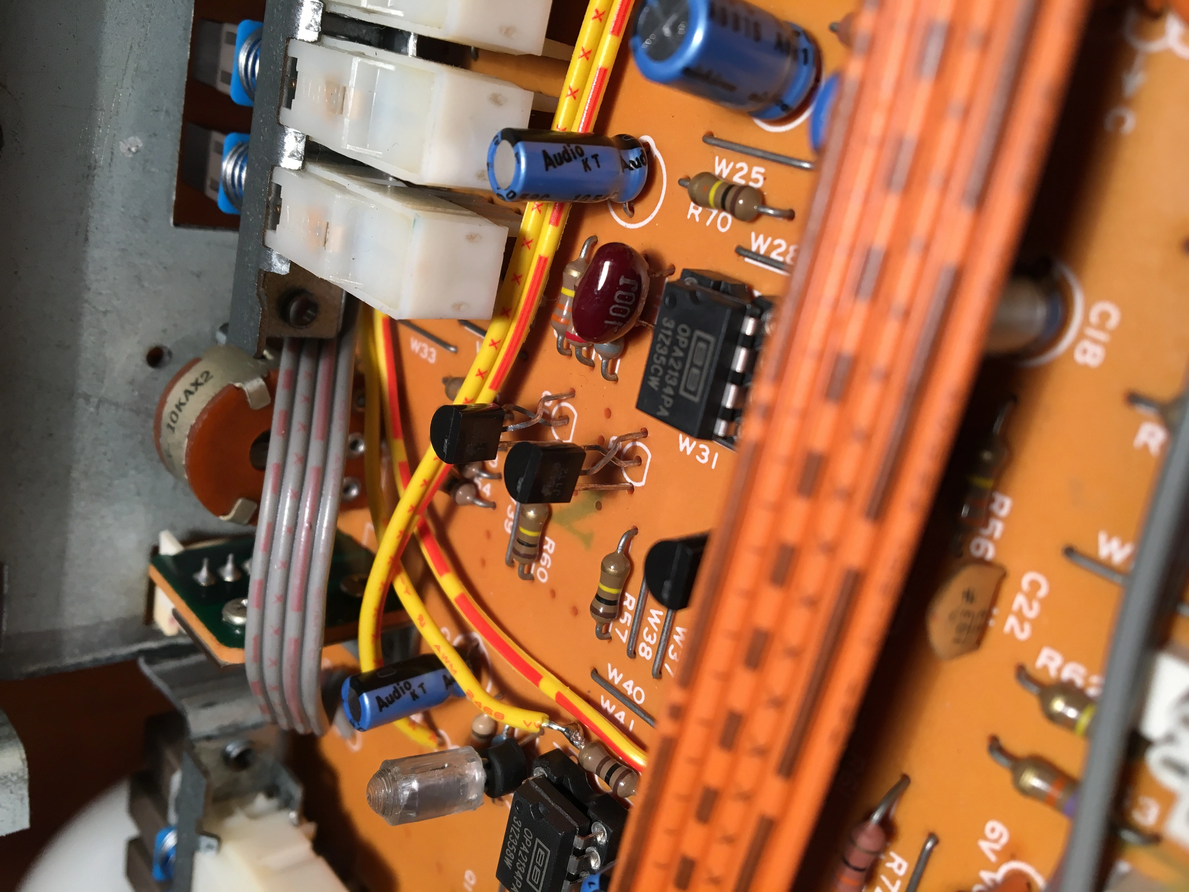

		 ), swapped in the parts and I am now checking the oscillator repair off the to-do list! There are a couple other parts I want to replace as preventative maintenance in the Control Module, but then I’m going to run one more comprehensive function test, put the cosmetics back on and call it “done”...100%. I’ve had the Control Module apart so many times I lost count long ago. Hoping that’s coming to an end for now.
 So I think I’ve demanded a lot of patience from my helpers, and it doesn’t make it any easier this project has dragged on for over 9 years now. It would have taken a lot less time if my life wasn’t so full, and if I could leave well enough alone and settle for “good enough”, but my “good enough” is pretty ridiculous sometimes...most of the time I guess. But I have learned A TON through this project, and am getting pretty damn capable of troubleshooting and fixing at least this device, which enhances its practicability, which is is huge to me. I’m thankful for what I’ve learned. It’s nice not being intimidated so much by complicated puzzles. Like I know, as of today, I’ve got one I’ll need to sort out with I/O module #12.
