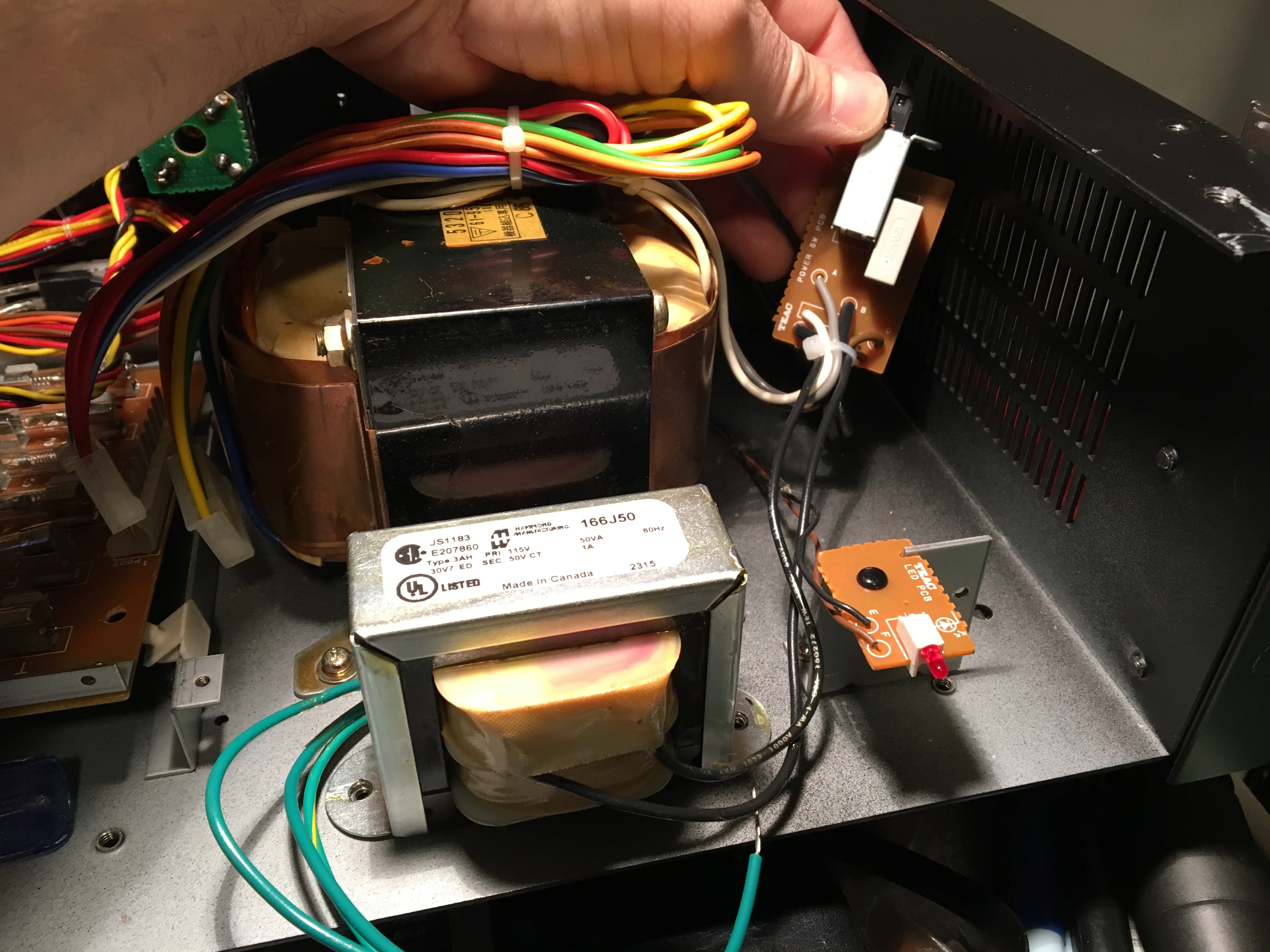

Is this the answer to my power supply needs? This Hammond power transformer?
We will know soon. In the meantime, I can tell you it indeed fits perfect. It's the smaller one setting there in front of the larger stock main transformer.

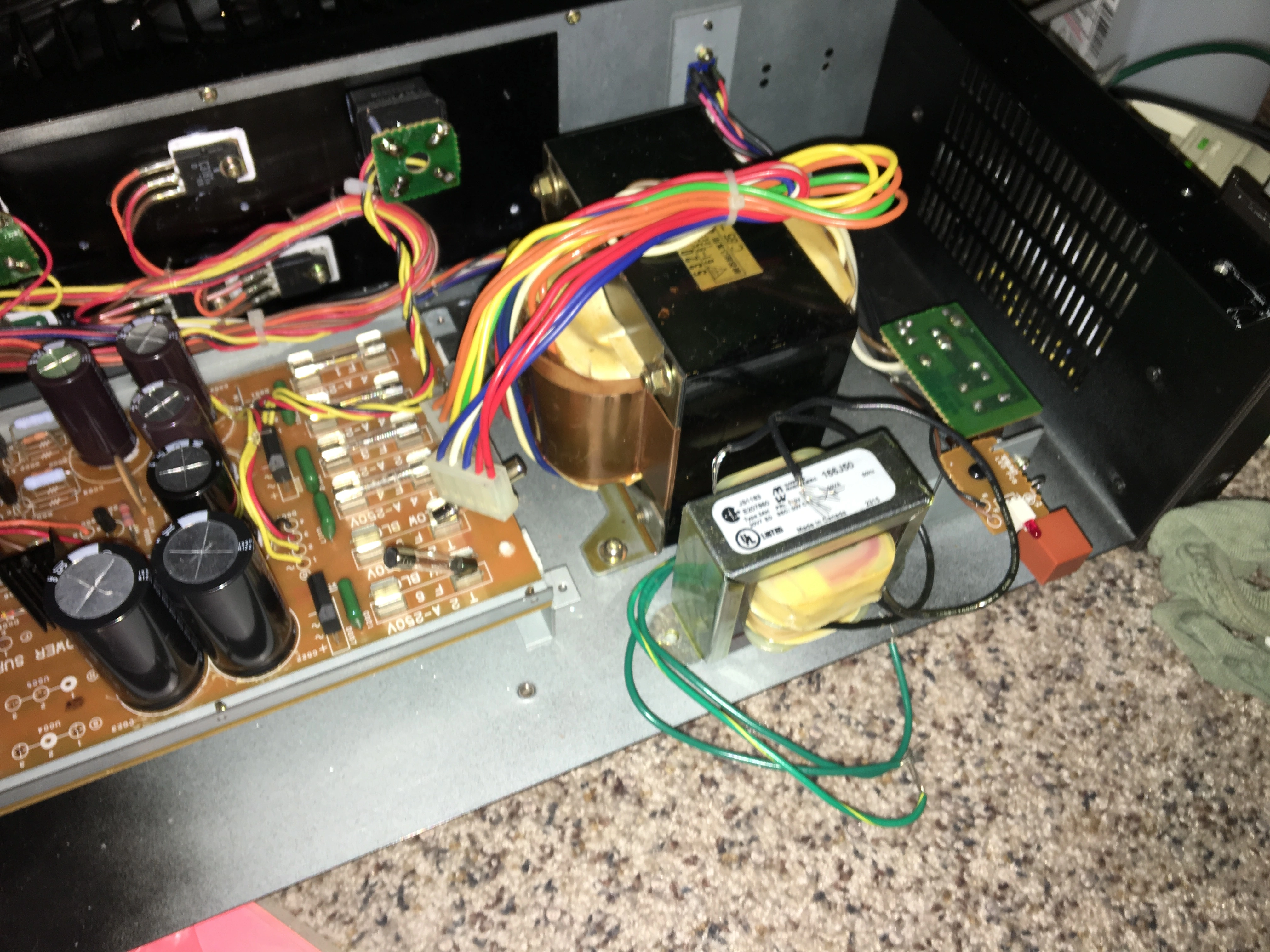

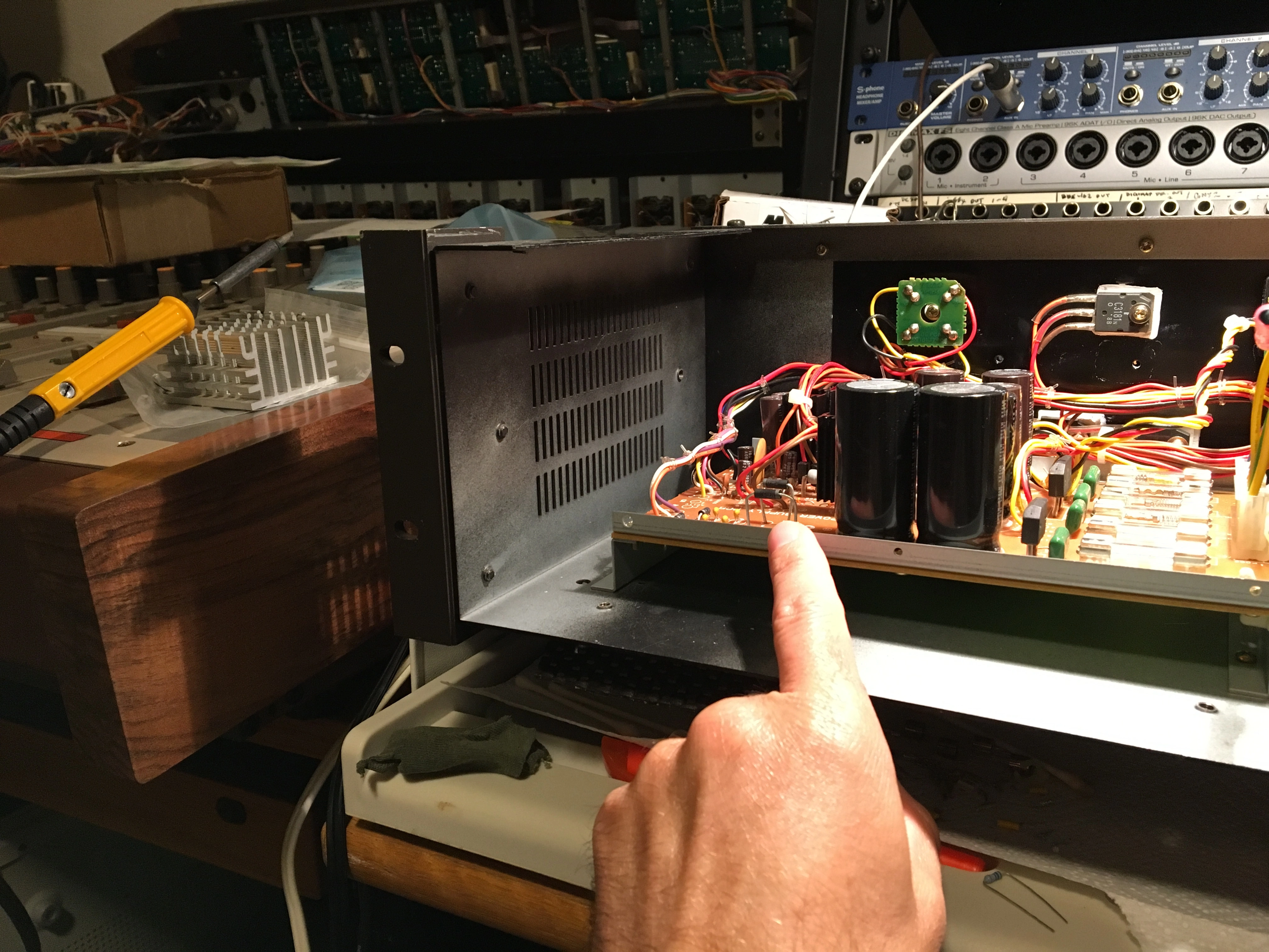

Got the mounting holes drilled and prepped for the add-on power transformer, and got its inputs connected to the mains power. It is convenient there were two vacant solder lands on the power switch PCB. The vacant lands were labeled as being for a capacitor. I think the role of that cap is fulfilled by multiple caps on the power supply PCB, so I used 'em to elegantly tie the new transformer in. The new transformer is in the foreground, dwarfed by the factory main transformer in the background. I'm holding the power switch PCB tipped back so you can see where the new power transformer input leads tie in:

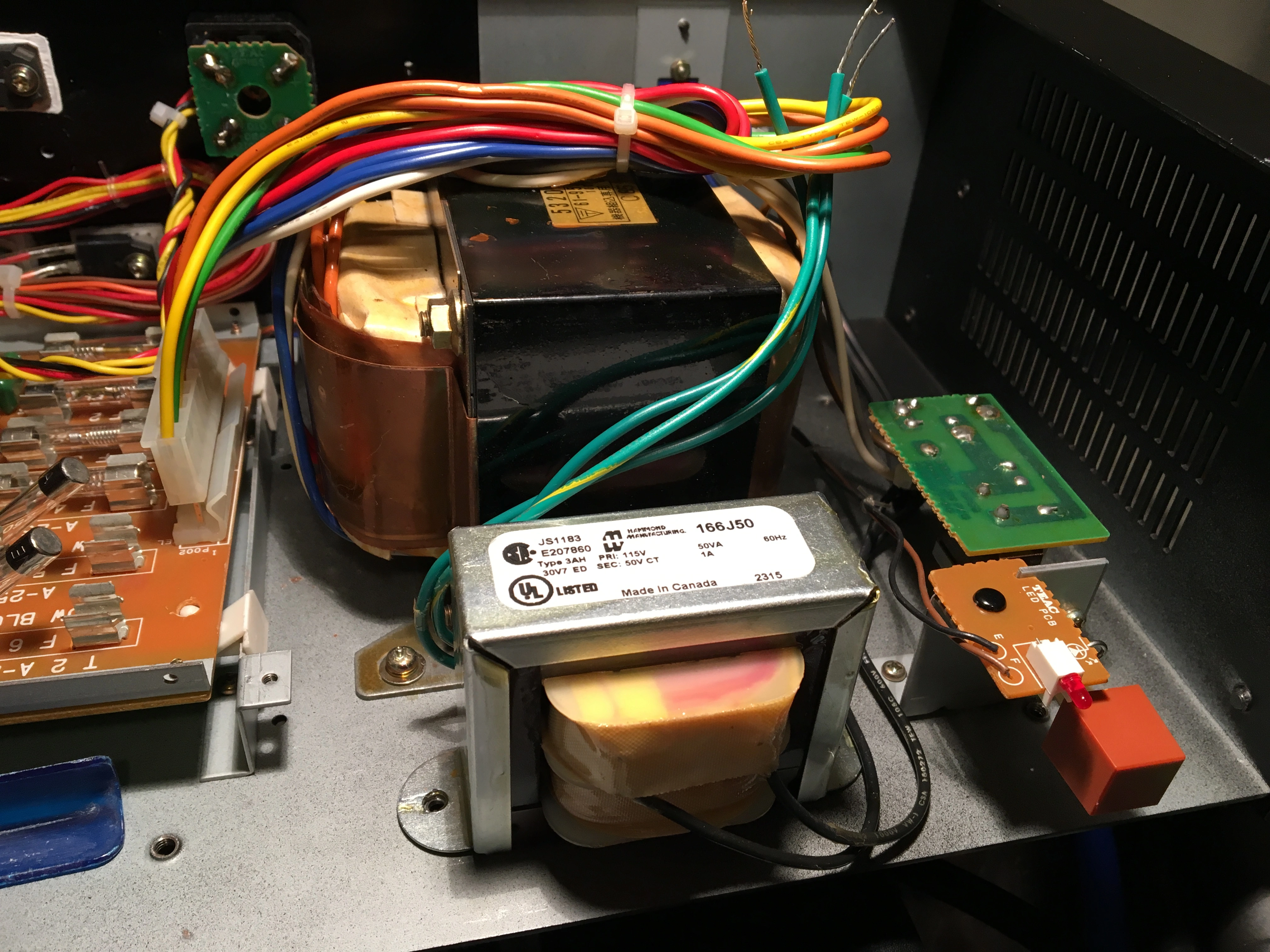

With the power switch PCB reinstalled, I'm ready to snip some wires and patch in the new add-on transformer outputs to the power supply PCB.

You would expect a 50V transformer rated at 50V RMS output to be...what...50V RMS right?
Well, it's about 58.4V RMS which means the output of the DC supply is about +/-40V...it's supposed to be +/-35V and if the 50V transformer output what it was specified to output the output of the DC supply would be just about dead on +/-35V. I think +/-40V is too high.

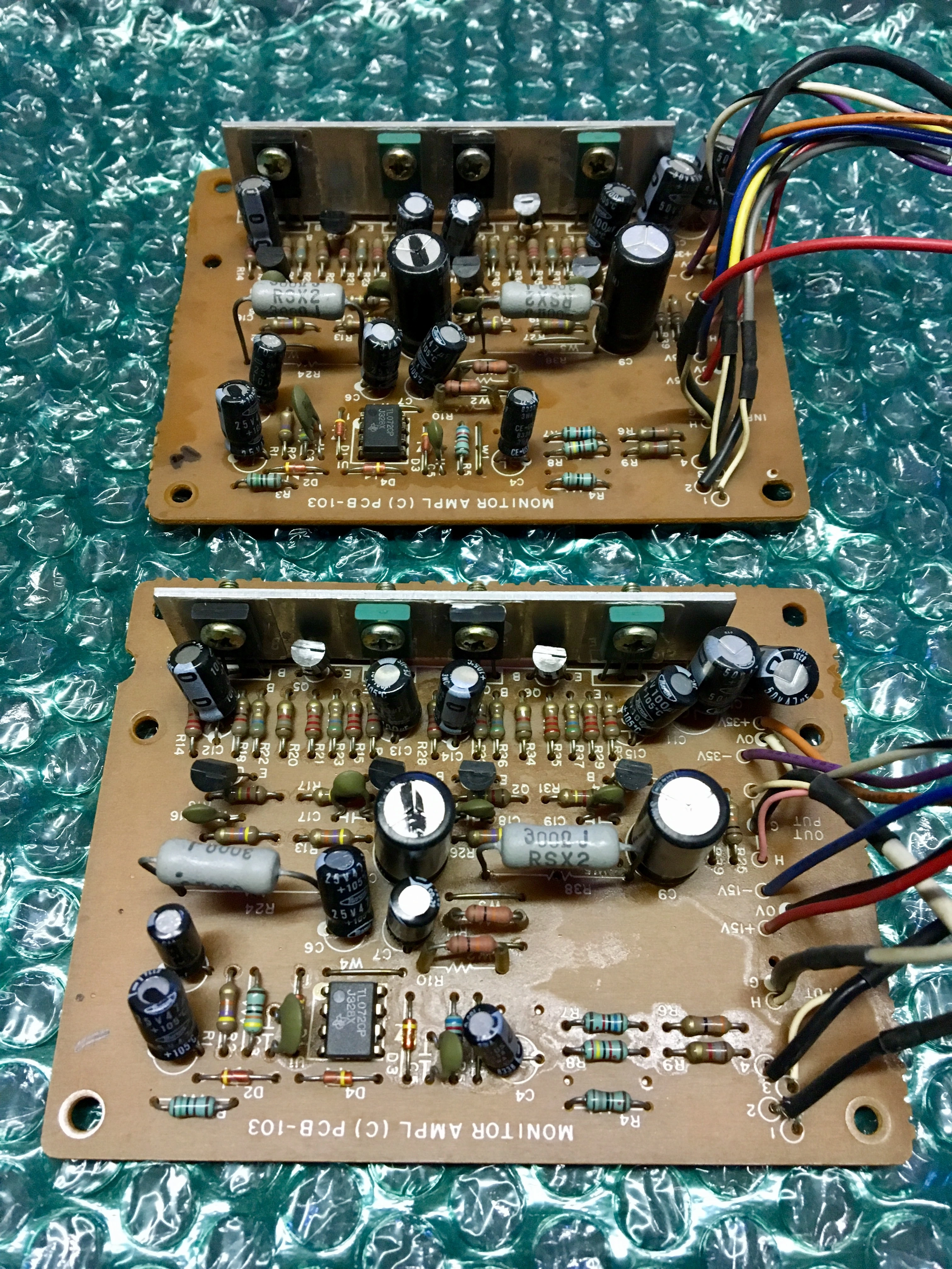

Anyway, being one who likes having spares on-hand, and seeing as spares are a relatively unobtanium commodity with the M-__ being one-of-a-kind, I've been watching a couple auctions for these M-50 PCB assemblies on eBay that match the M-__...been watching for months. I finally made an offer on them. $24 for the pair shipped. I dunno...silly I suppose. But I got them today and probably will never do anything with them, but I just like having them...I don't expect I will ever do anything with them, but I guess it satisfies something in my brain to have the parts because the M-__ was designed with the capability to have balanced group and aux outs...there are lands on the PGM group PCB for another set of these ultra-high headroom line amps, and punch-outs on the backplane for the XLR output jacks. Anyway...I got them today. They look like this:

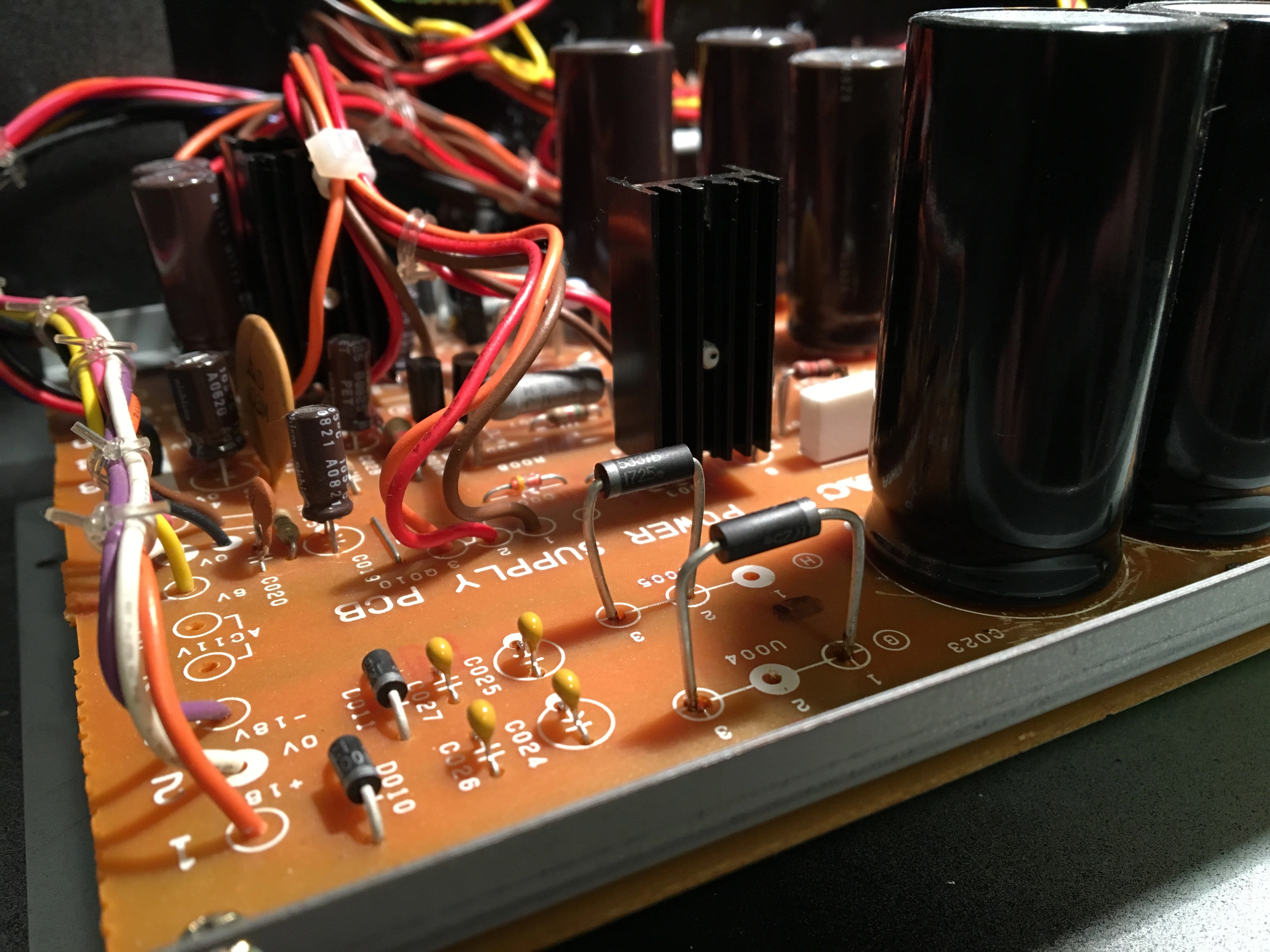

I got the zener diodes installed on the power supply PCB with the intent of dropping the ultra high headroom line amp power supply from the +/-40V power being produced with the add-on power transformer down to something closer to the specified +/-35V power.
Here are the zeners...the little guys sticking up:
I got them installed along with the new slo-blo fuses and powered it up without a load to make sure nothing blew up or otherwise caught on fire, and then from there to check and make sure the voltage was correct and clean.
No *BANG* or smoke...The voltage was running at around +/-39V. Grr. And my Fluke meter was reading about 20mV AC on each rail. Grr again.

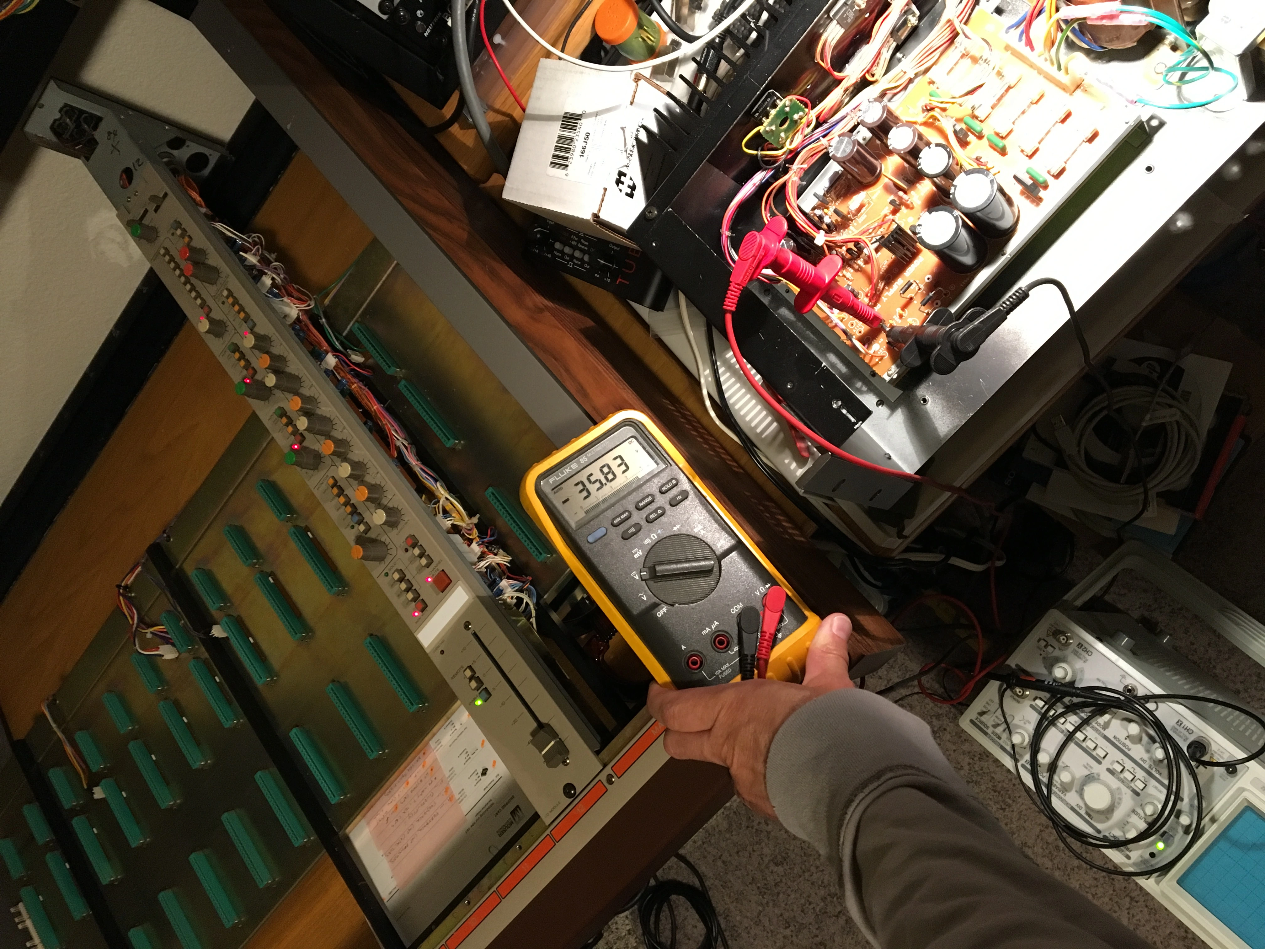

Then something flashed in my memory...power supplies have the tendency to run a little wild without a load. So I pulled all the modules from the frame except for one, hooked up the umbilical, crossed my fingers and hit the power switch. No smoke...no drama. And the DC voltage settled nicely at about +/-36V with the load, and AC voltage dropped to something less than 2mV. Much better. And when I looked at the supply outputs with scope again all I could see when AC coupled was environmental RF noise, and very little amplitude even when zoomed all the way in.

It came time to load the Control (master) Module...did that...same thing, no drama...Supply output voltage now down to just under +/-35V and that's with 6 of 16 of the line amps powered. So I'll see where it sits with all of them loaded and maybe swap in some lower voltage zeners to maintain something closer to +/-35V with the full load if there's much more voltage drop...maybe not. Anyway, Control Module works like it should as well, except I had a little setback...I'm only getting the left channel in the headphones when monitoring the the Control Room buss...it took me about 15 minutes, but with all the controls and features on this thing I was able to pretty quickly narrow down the issue to something in between the output of the Control Room buss source select switchrack and the input of the headphone amp. The Studio buss works fine in the headphones and there is proper signal at the output jacks of the Control Module. So, I didn't yet fix it, but it should be fairly easy to find the specific problem. I know my way around the Control Module guts pretty well.
