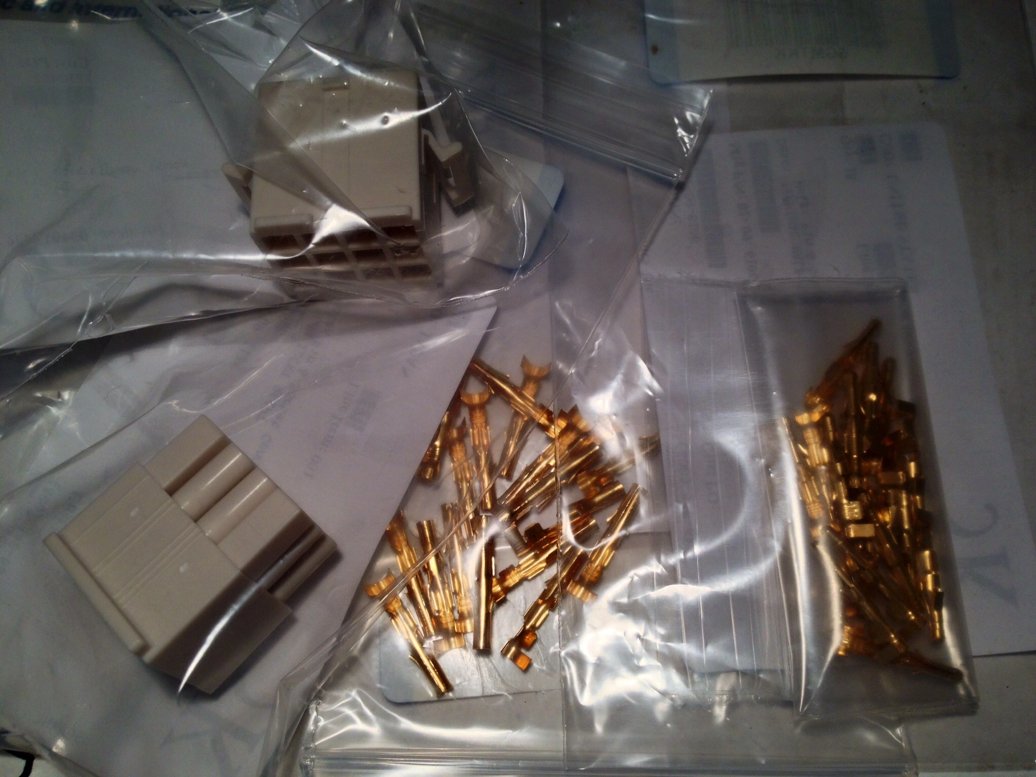

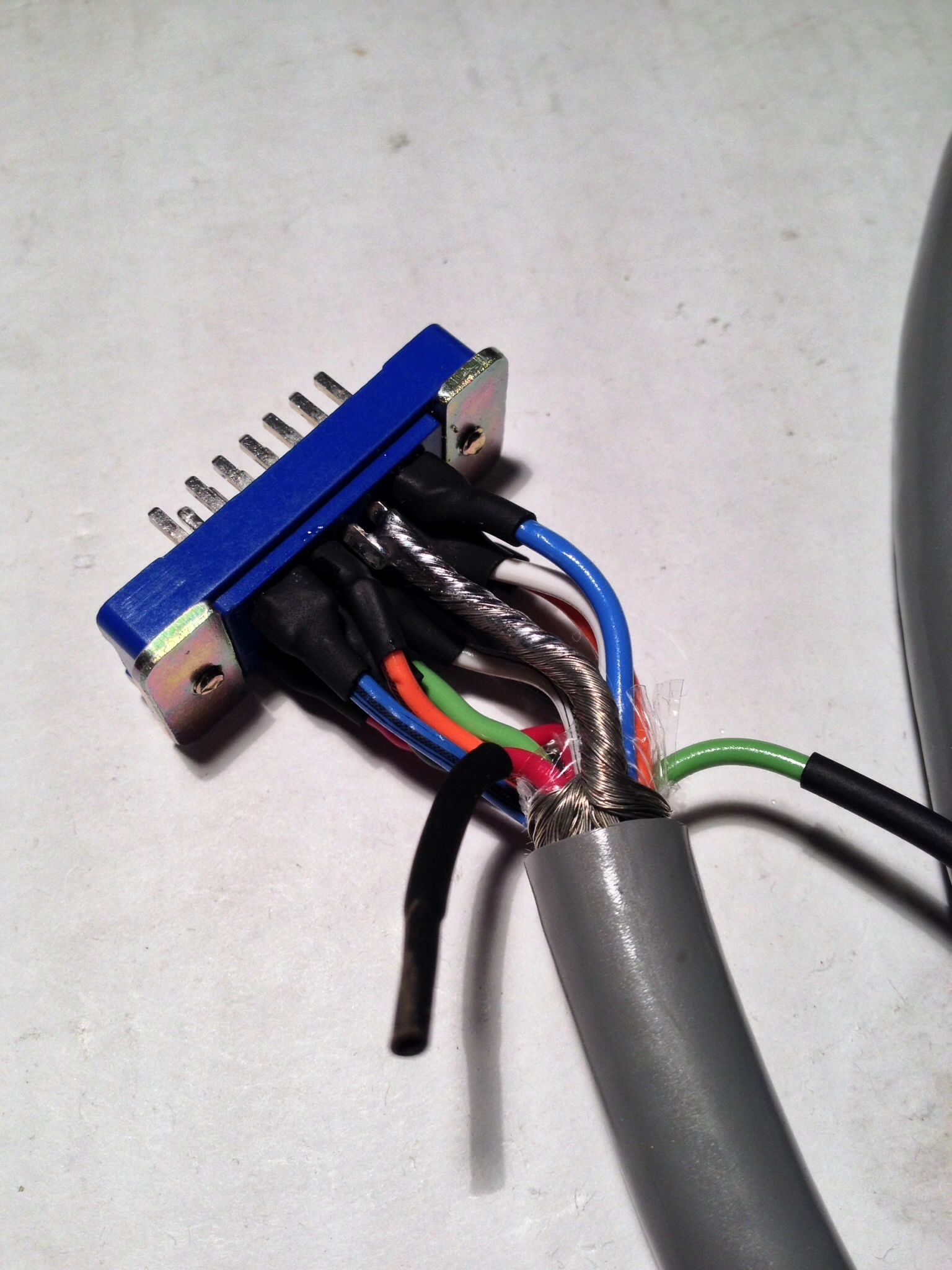

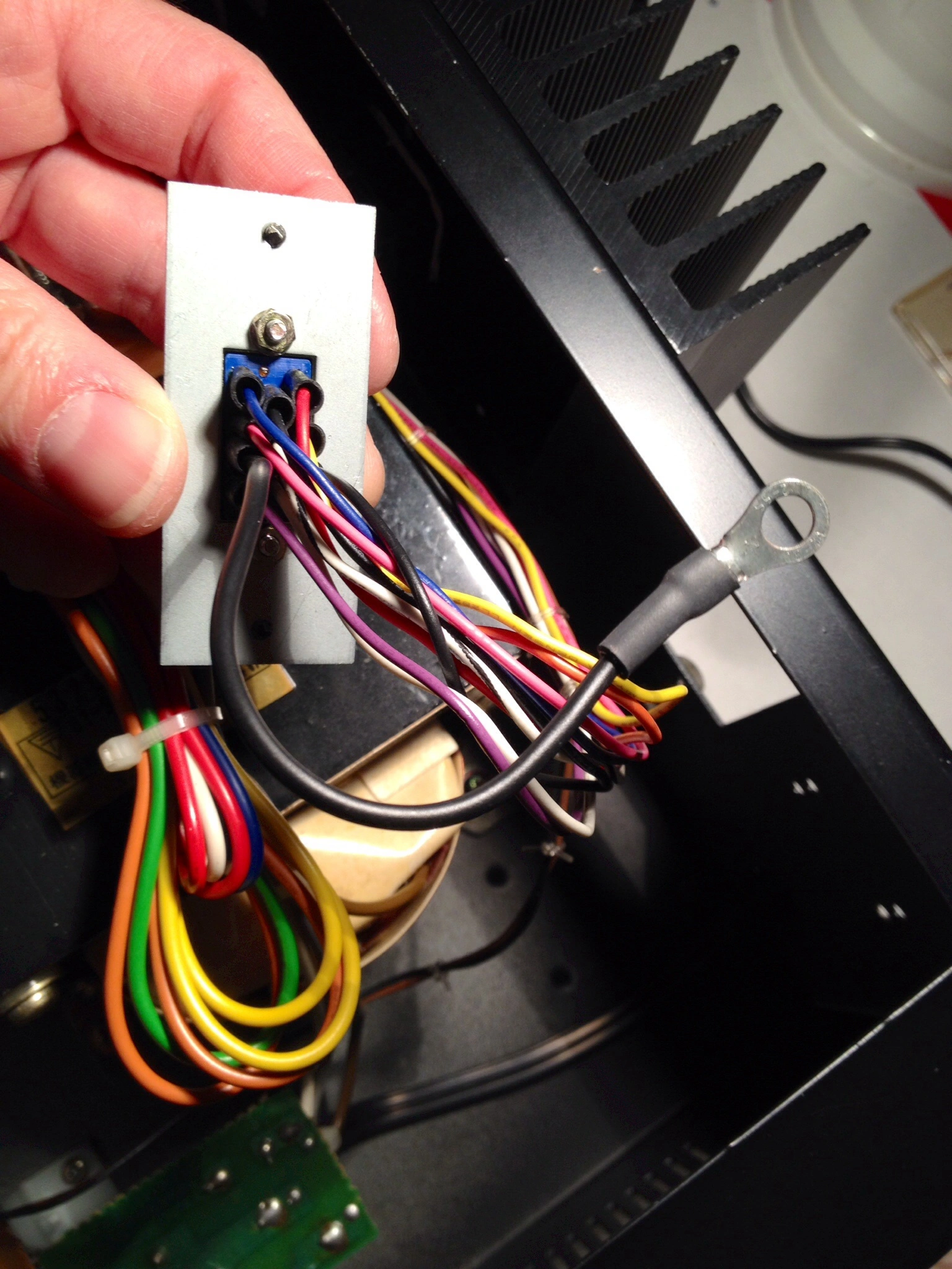

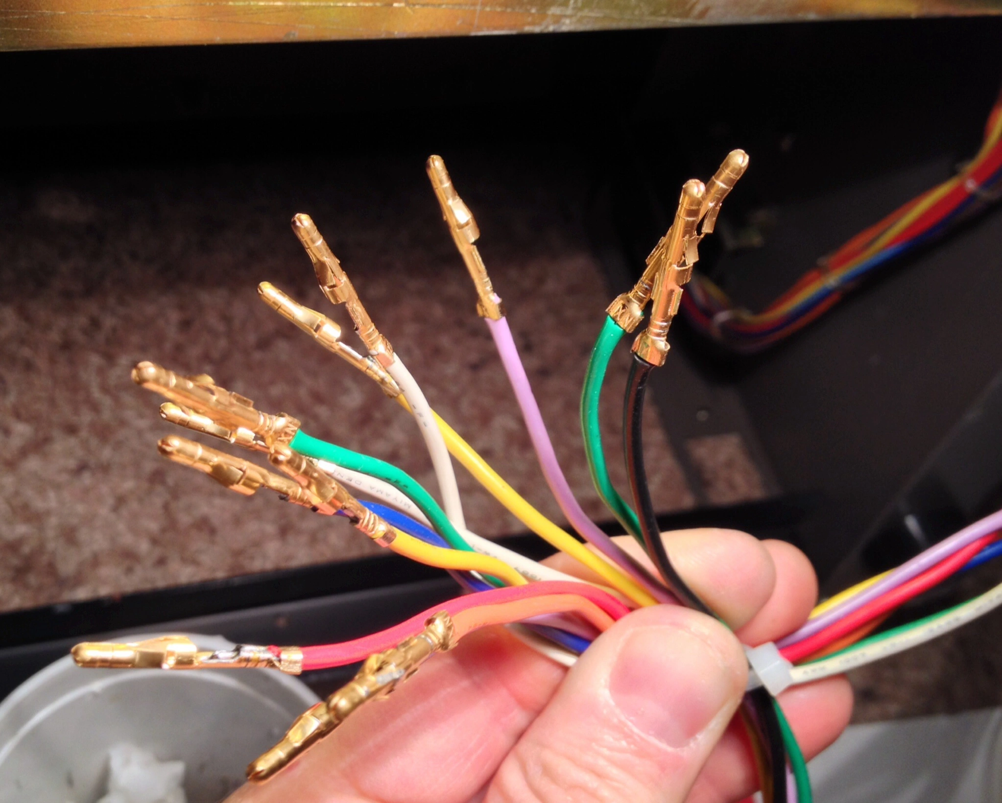

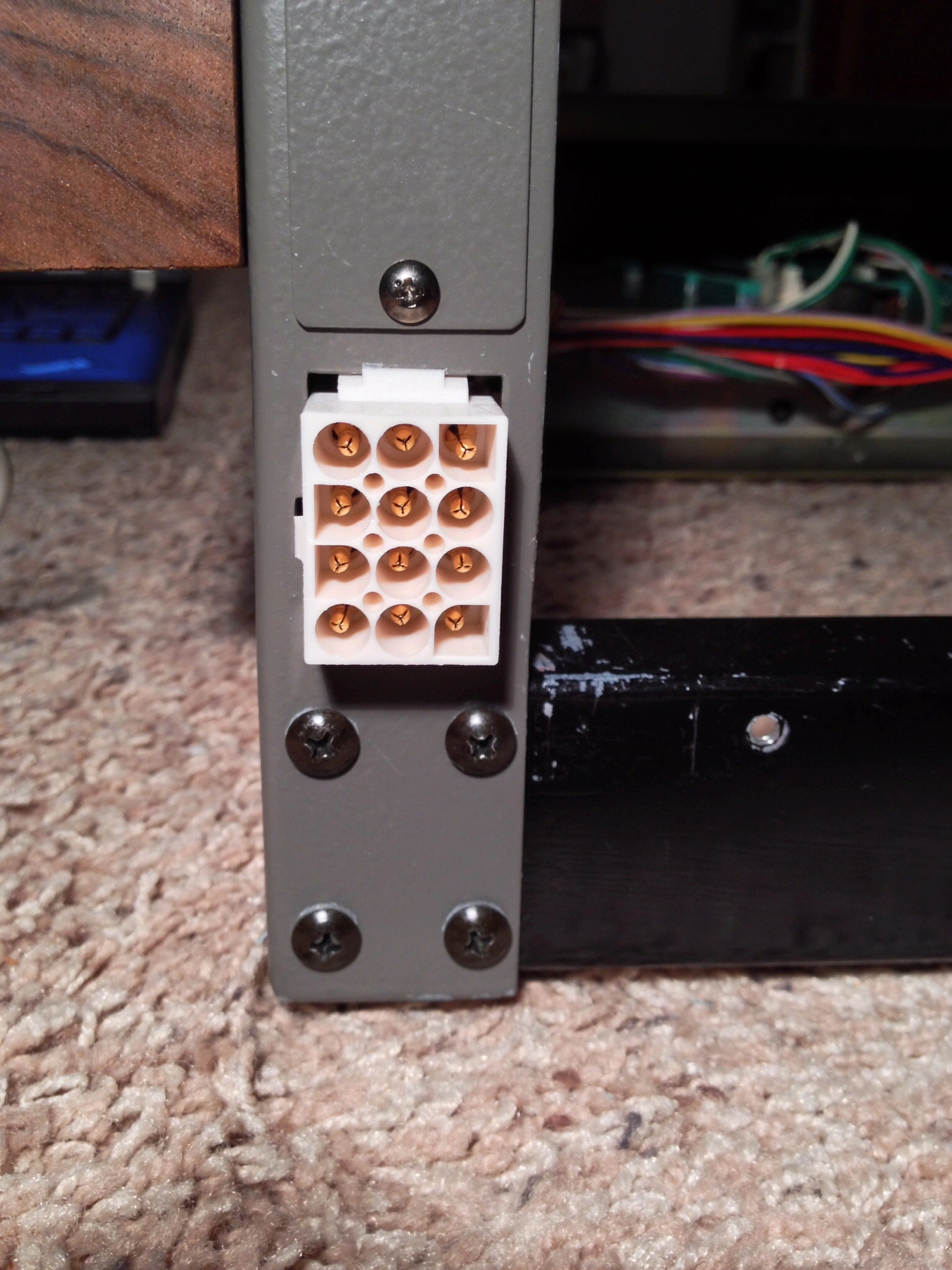

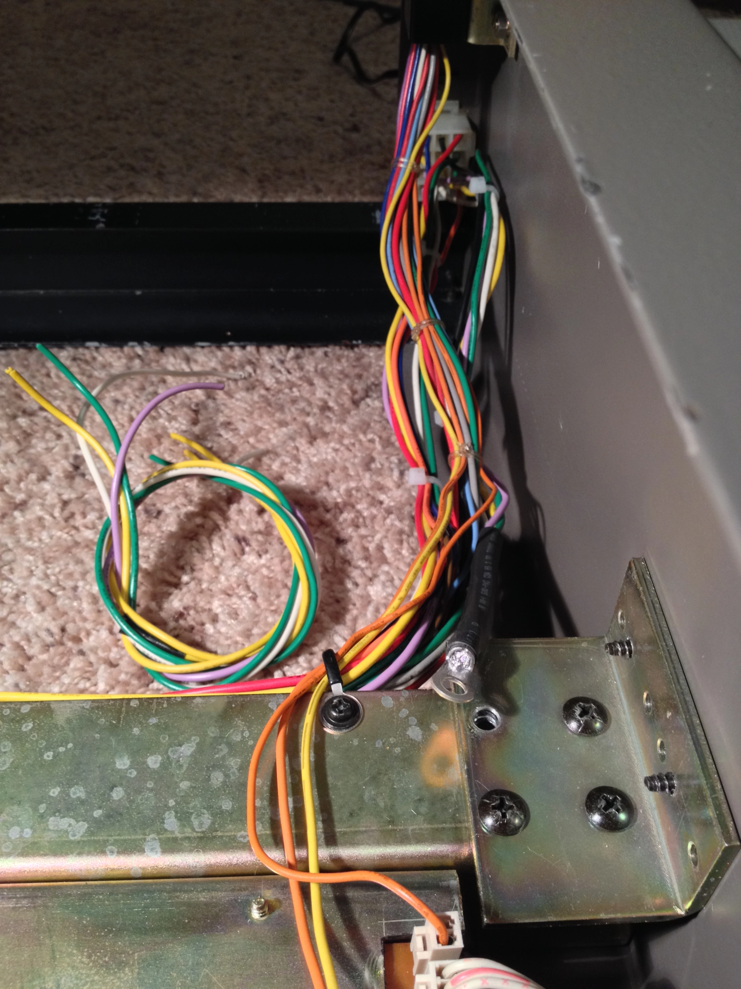

So when I looked at the ground wires in the mixer frame my memory was refreshed that the wires go from the back side of the umbilical connector to central points on the main motherboard.  After re-pinning the connector to align with the pin assignment in the power supply (in preparation for the new cable), I simply picked a good mounting point, clipped those wires, and then put on some heat shrink and crimped and soldered on a ring connector...remove an existing sheet metal screw, drill the hole out and then go get some hardware including star washers to make sure there's a good conductive bite between the ground conductor and the frame...I like to use conductive grease too.  Still need to bolt it up but here is where it stands at present:

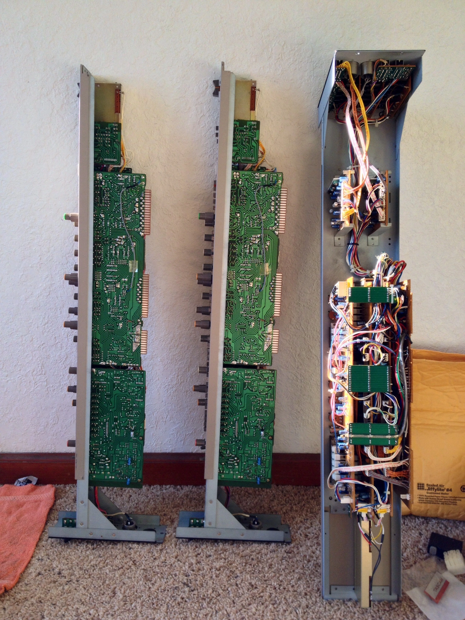

So then I tipped up the M-__ and lovingly gave the unnecessarily long ground runs for the +/-15V rails a haircut.

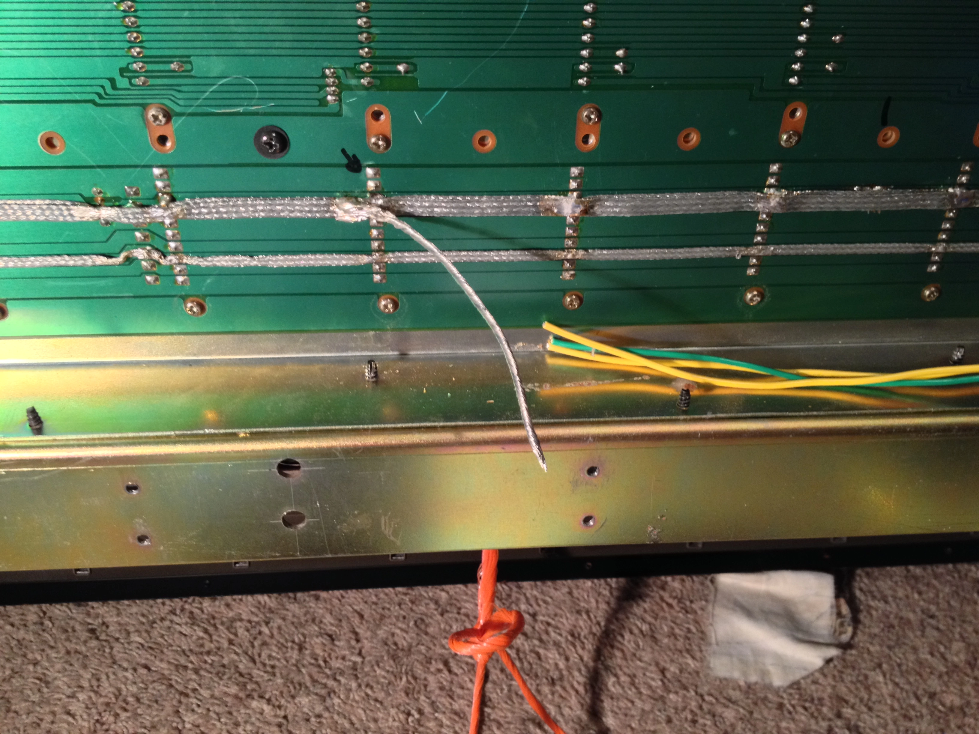

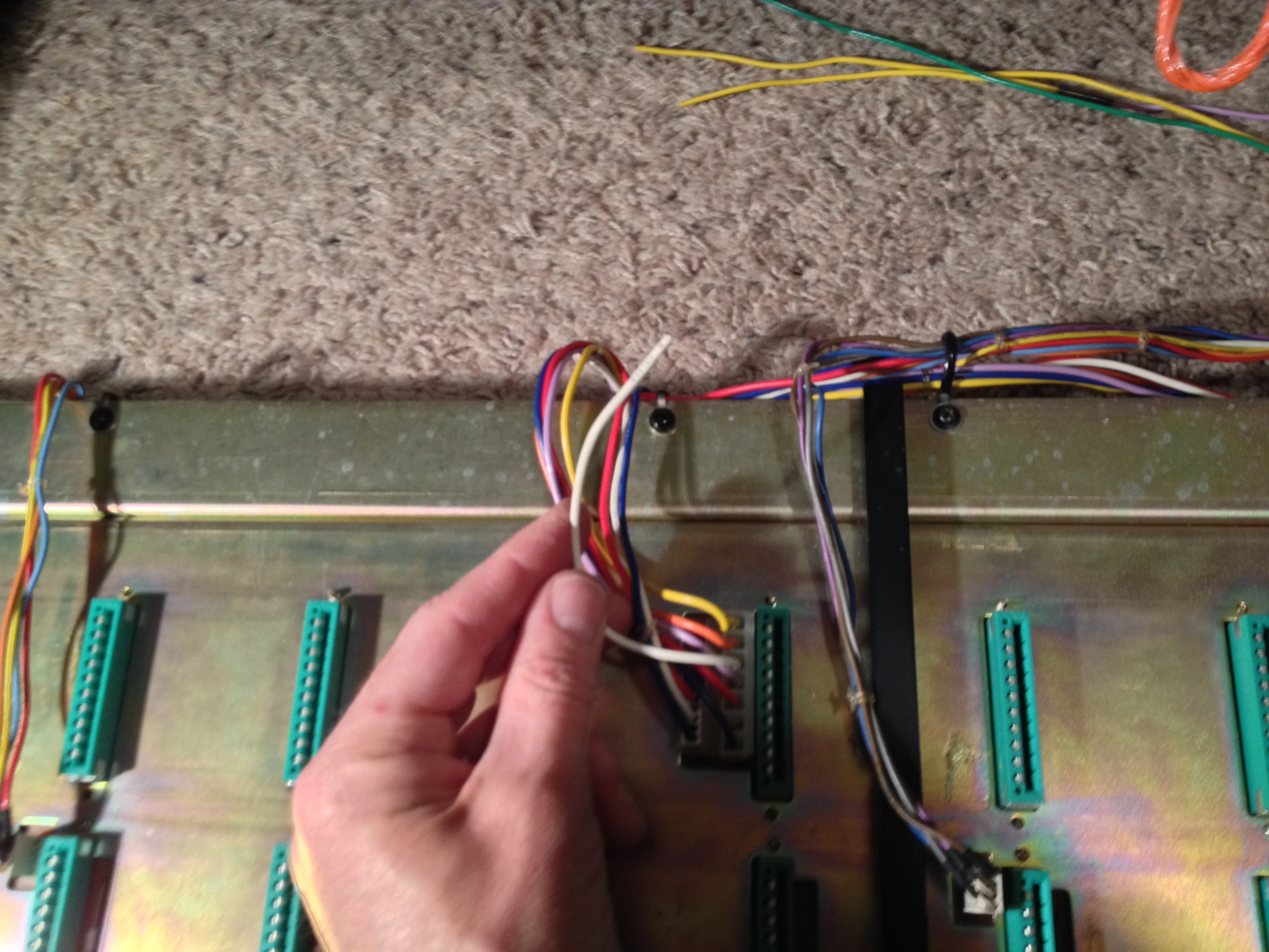

Here is the underside of the frame.  I'm holding on to three wires that used to carry the 0V reference for the +/-15V rails...the wires traveled a couple feet from the back of the frame where the umbilical connects:

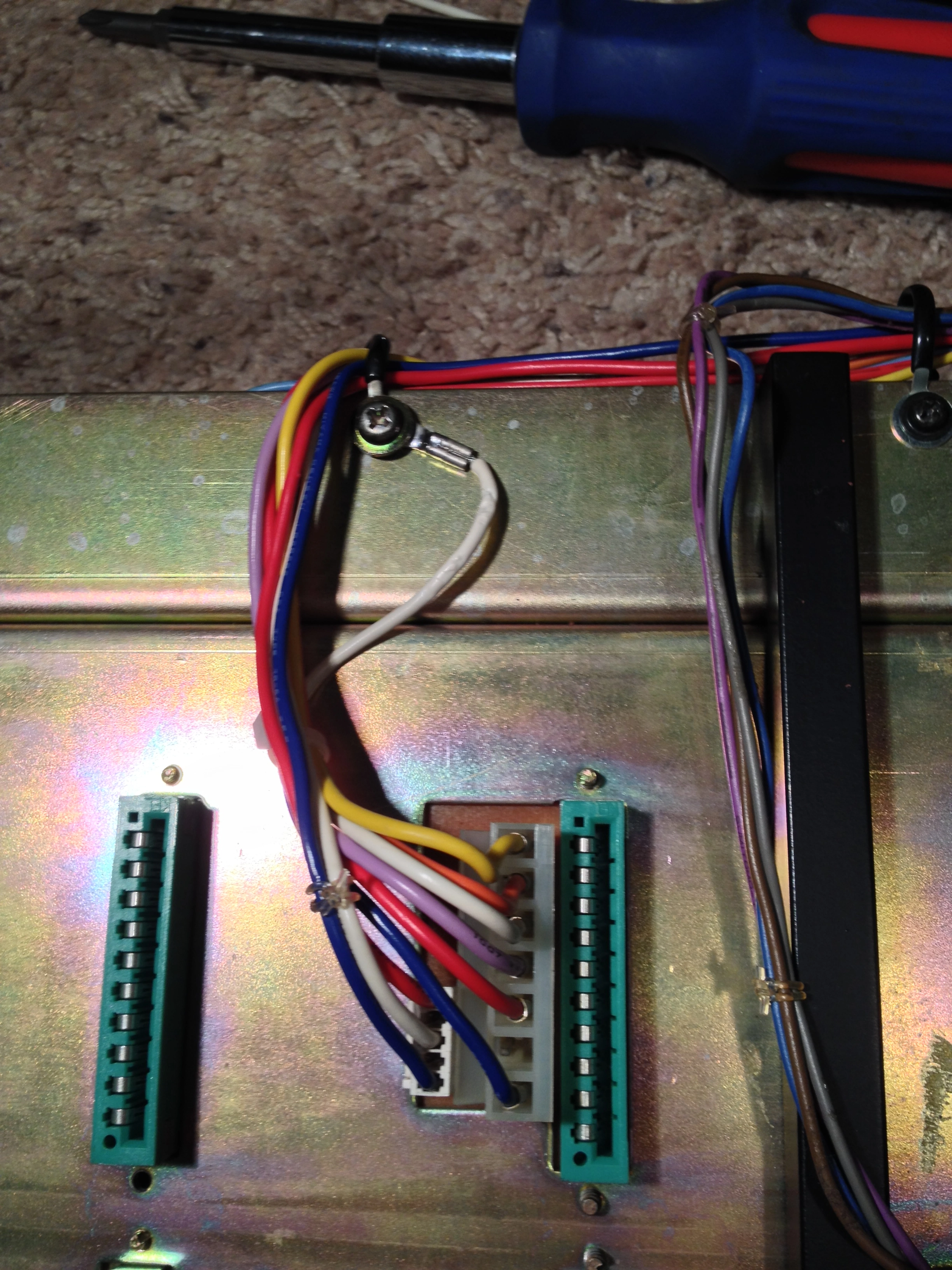

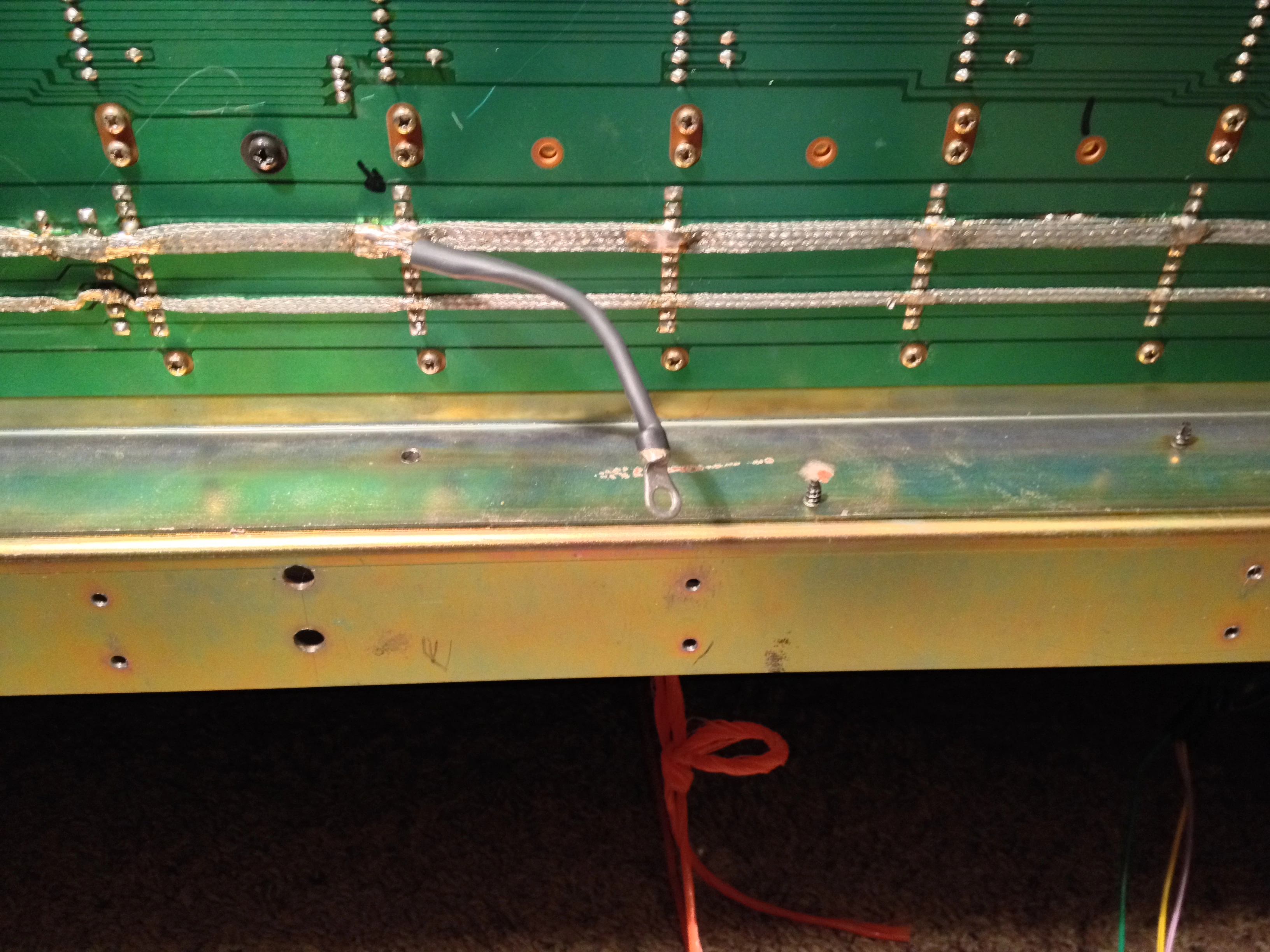

Clip those wires off, pull the insulation off them to twist them into a fat wire...
And then as with the ground wires coming out of the back side of the power connector I  put on some heat shrink and crimped and soldered on a ring connector...removed an existing sheet metal screw, drilled the hole out, yada-yada.  Again, still need to bolt it up but here is where it stands at present:
Same thing with 0V conductor for the +/-35V rails...white wire that traveled all the way from the back of the mixer.  Clip it and bond it to the chassis.  And remember the whole chassis is now an effective ground reference for everything because that white wire and the three wires from underneath for the +/-15V ground are now bonded to the chassis near the entry point into the mixer frame:

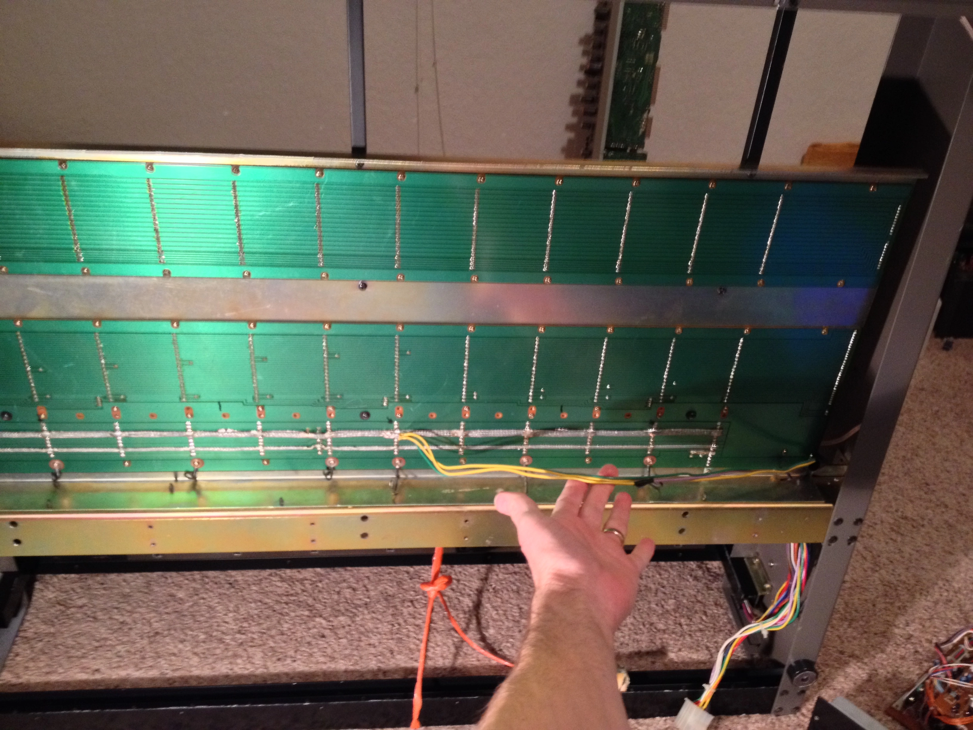

I also found 12 screws missing that attach the card edge connectors to the plate for the motherboards...I don't know why they left them off.  I got some screws to fill those mounting points.
