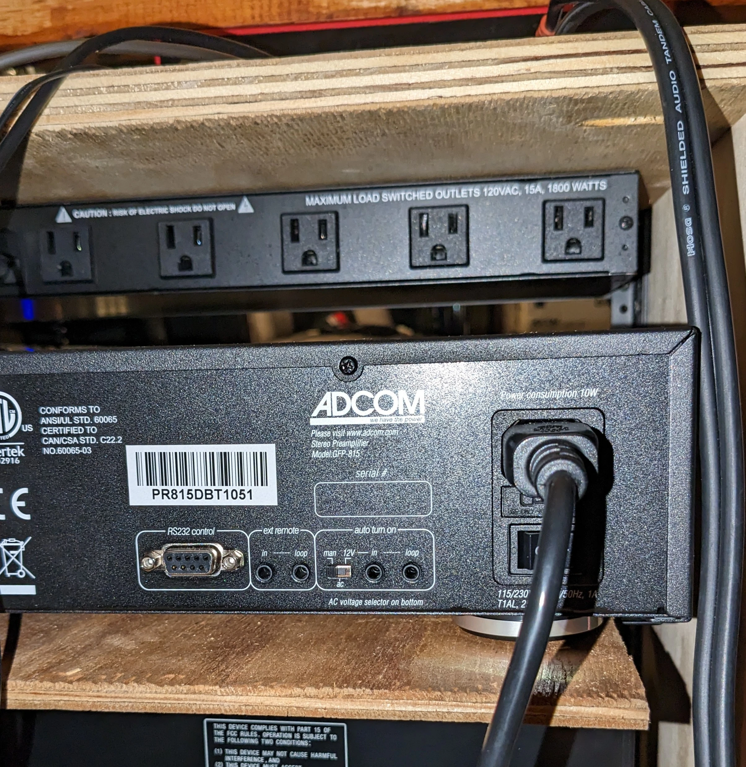

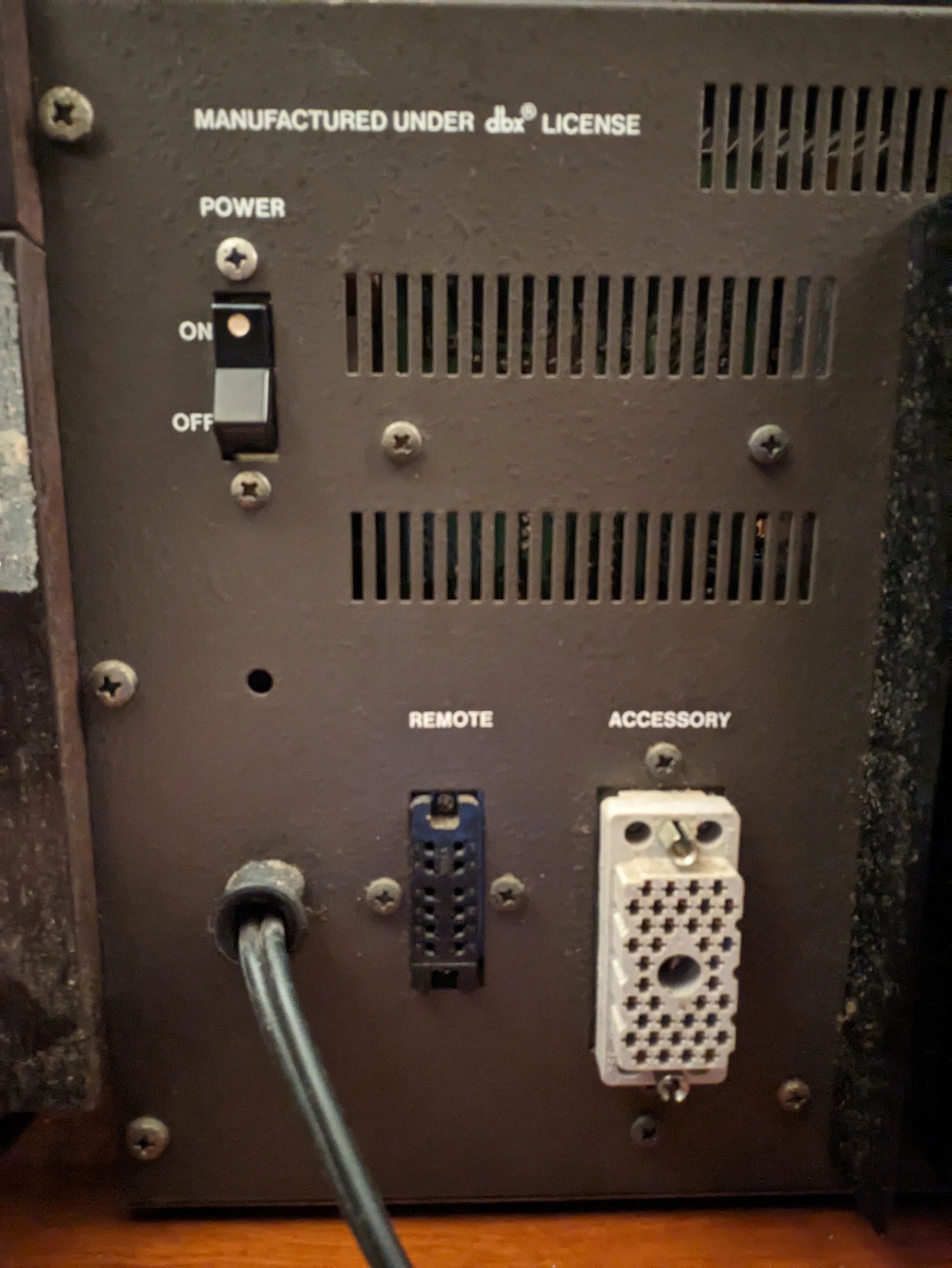

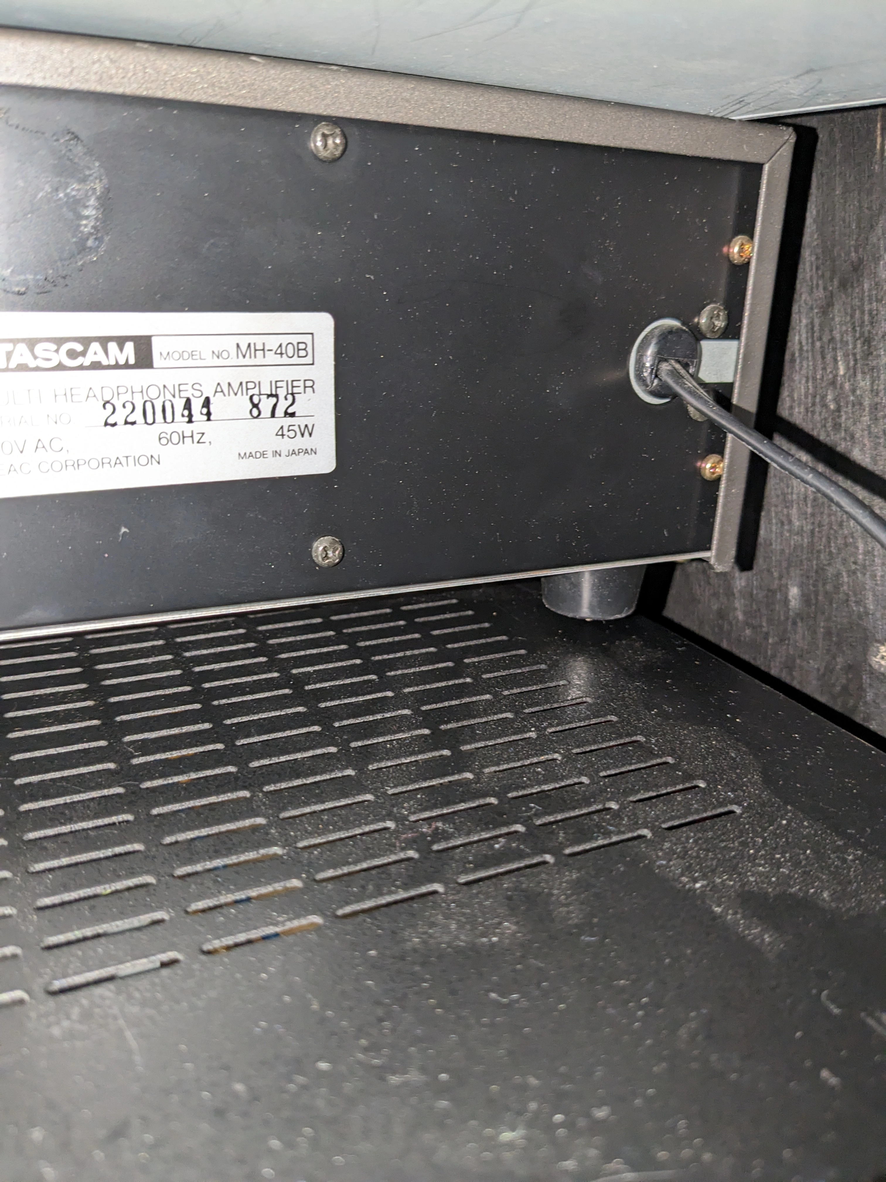

Does the Adcom, 388 or MH-40 have ground lugs next to where the power cord enters the chassis?
Thanks Sweetbeats, not that I see. Are are pics of the back of all three:

Sorry those pics are so big! I just find it odd that the noise/hum is only when the main stereo outs (either RCA or XLR) are connected to the preamp. The instant I unplug those from the 388, the monitor feed to the headphone amp is silent. With the mains plugged in I hear the hum/noise through the headphone amp as well as the main room monitors.
For what it's worth, I'm running this through an Adcom GFA 545ii amp.
