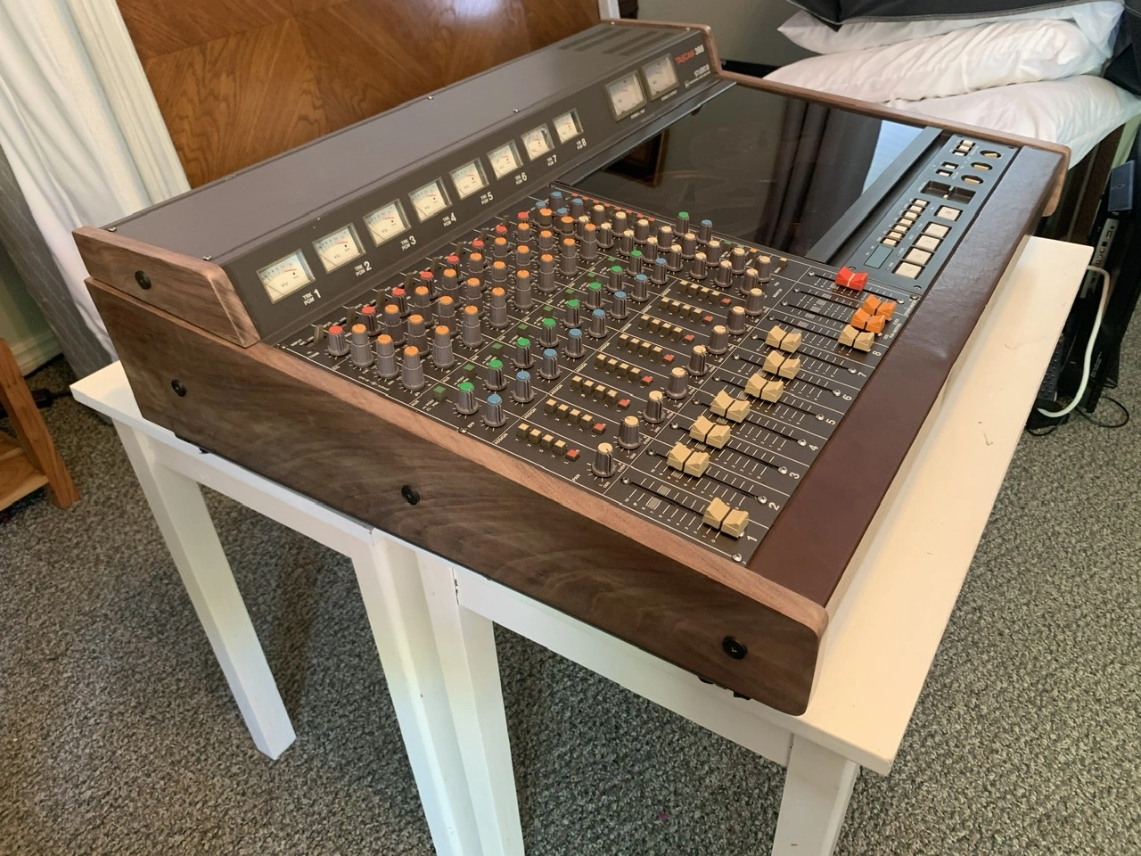

Hey!
So I have ordered and replaced the chip. And… it works!
All thanks to you. I really appreciate it!

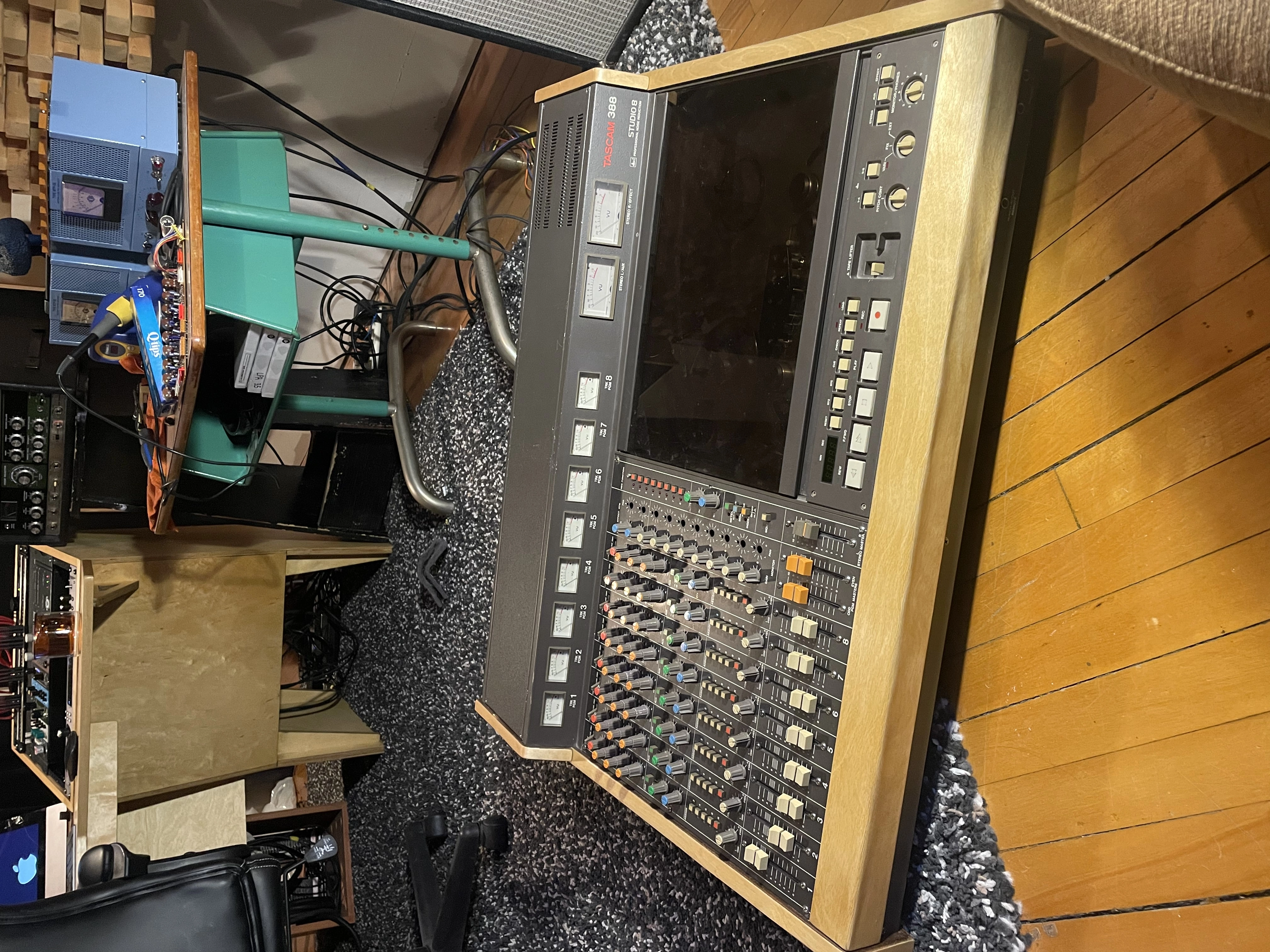

Here is a picture of my tascam.. I did custom pannels with cherry tree so it can match my studio desk in my studio.
I recorded a couple of stuffs alrwady on it, it’s amazing how good it sounds.. gotta be careful with the peak and distortion though. I noticed that as soon as I hit it too hard the deck will distort in the low end but not in a good way. Just need to gain stage properly.
My calibration helps a lot. It’s crazy how the fidelity have improved since the first time I used it. I was used to make it peak all the time.. it was the only way to get a proper volume wothout too much hiss. Ot wouldnt distort so much. but now when the tascam says peak, it actually peaks for real. lol.
There is a strange thing that happens though when I lean on the edge of the deck with too much weight.. it kind of shut down for a second or the power kind of drops, the intensity of the leds jn the vu meter drops a little bit, I also notice peak leds flashing red, the information on the counter display disappears and reappears.. really strange. But it comes back as soon as I release the weight. I noticed that as I was working on a recording.
Do you think it might be the control pcb which is right underneath the "elbow seat" touching some metal because of the weight and creating some kind of short circuit..?
Fantastic. I love that. Doesn’t that feel good? Good job.
Oh that looks good. Yeah I like the fact a lot of the vintage Teac consoles have relatively simple panels to reproduce if you want to upgrade to hardwood. I did that with my prototype “M-__” console, which was pretty trashed when I acquired it…I used hybrid black/English walnut harvested from a dead tree we had to fell where I used to live…had the log chunks rough cut and I planed planks and cut to size. Here’s before and after pics:
Right. Yeah that’s a good observation…that was my experience too. I know there’s a whole lot of lore about either something like the 388 being “lo-fi” and/or people thinking it’s awesome to “slam the tape”, but if it’s setup right and you’re using the dbx the noise floor is really well-managed, if you slam it you throw the dbx tracking off, if you turn that off to avoid that and hit it hard you’re probably distorting the amplifier electronics and not the tape…set it up correctly and you get a surprisingly smooth gluey and low noise analog recording. But the setup is critical to that and bias in particular since the tape that’s available new is not from the Ampex/Quantegy lineage and the bias requirements are significantly different, and the 388 service manual assumes you are using 457.
Are you talking about if you lean on the wrist rest? And if that’s what you mean does it happen if you press down anywhere on the wrist rest or is it only toward the right side?
Yeah I’m thinking you may have a pinched wire are something is making contact that shouldn’t be when there’s that pressure. Clarify for me though where you can press to make it happen. And have you removed or ever done any disassembly of the guts that are under the transport and monitor control panels there between the transport and the wrist rest? You’re correct the control PCB is there and also the monitor amp assembly…wires…guts…

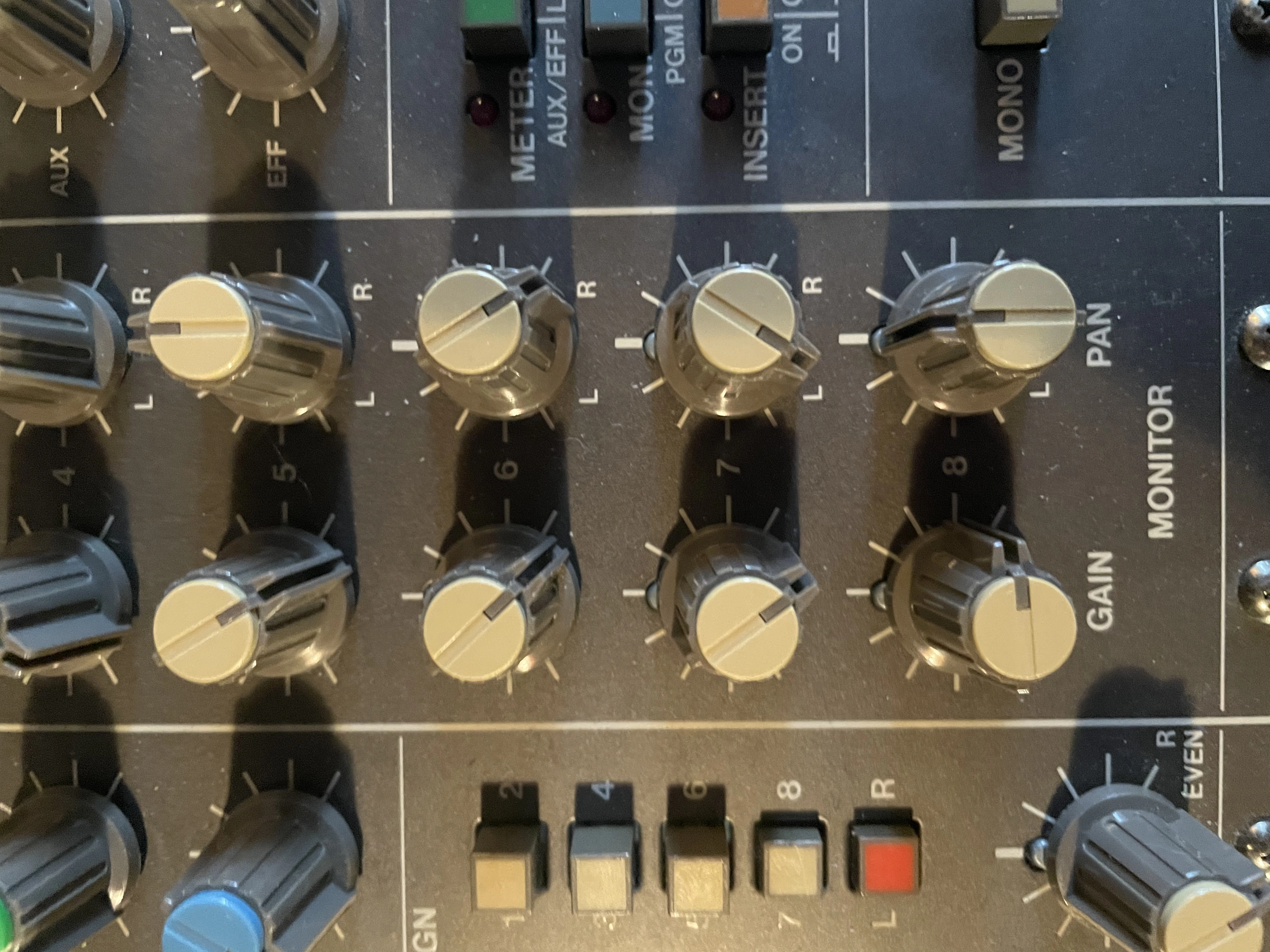

I also noticed another issue.
The gain knob of channel 7 on the buss section is intermittent, it’ll only work if the gain is pushed all the way. Otherwise there is no sound on channel 7. And the gain knob of channel 8 behaves badly too, the volume will not shut down when I shut it down. Maybe a connector cable? I messed around a lot in that area lately with the past issue.
Are you talking about the level controls for channels 7 and 8 in the monitor section? The 8 channels of pan and level knobs above the PGM MASTER faders?

Yes I am talking about the volume knobs above the pgm master faders! The section on the photo I attached. I use it a lot during tracking as monitoring and I record my clic on track 8 and it’s inconvenient to not be able to turn up or down the volume of that clic.

On the monitor mixer channel 7 & 8 issue, am I correct it doesn’t matter if the monitor mixer source is tape tracks 7 & 8 or PGM groups 7 & 8 right? Identical performance problem with either source?
