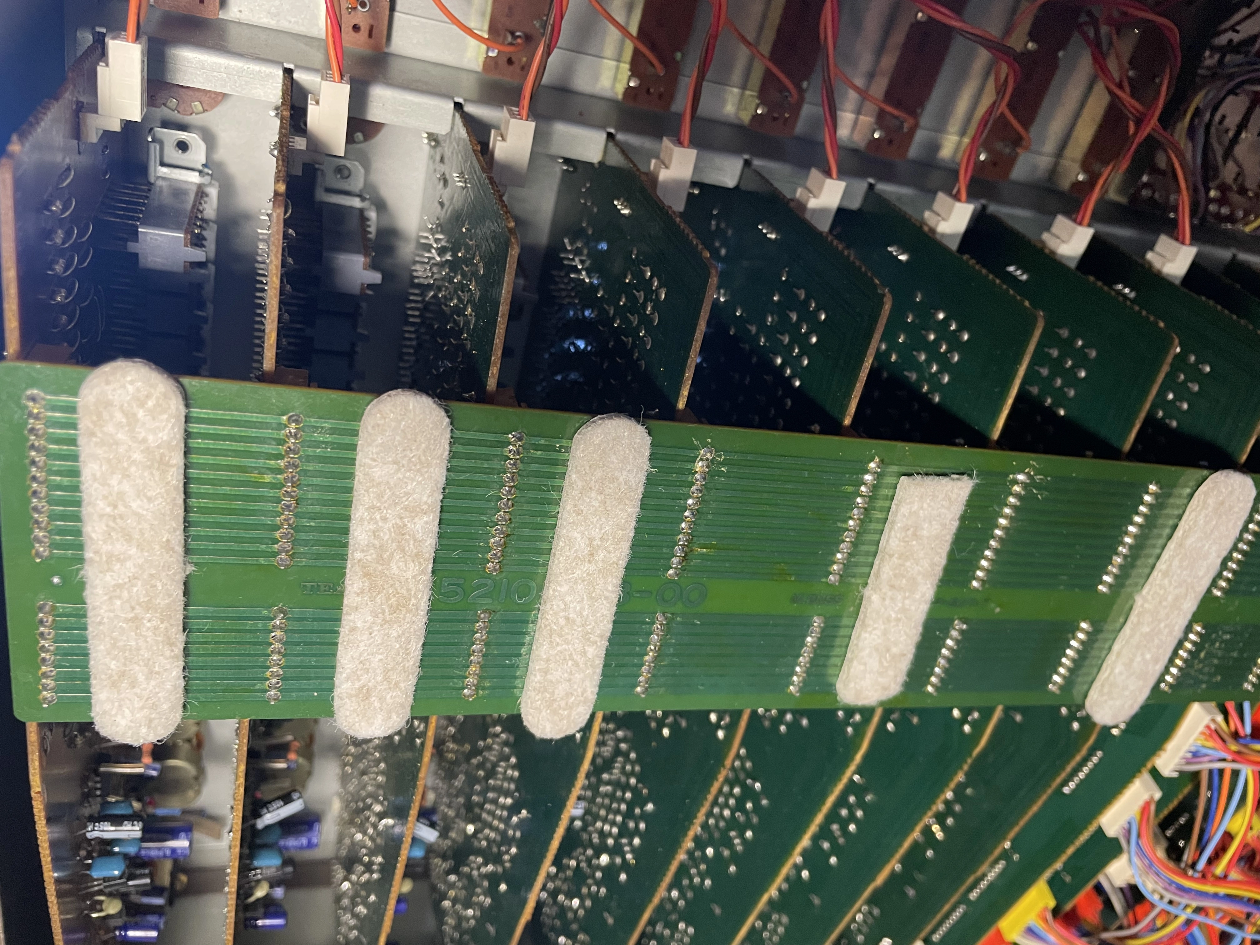

Something did happen while I was troubleshooting. I gave a little jiggle to the buss b pcb and some crazy distorted sound happened but did not stay for long. Also, and this is the odd thing, randomly at some point after shaking the buss pcb the sound signal of the channel 3 and 7 (which where the only channels turned on with signal going through) started to sound crazy loud and distorted. I panicked and pushed stop but when I pushed play again it was gone.
As for the bottom pannel problem, I noticed there was some foams missing on the M BUSS pcb.
I also noticed that as the tascam was laying on its side there was a lot less heat emanating from the grids over the power supply pcb. Like none at all.
I am going to the store to purchase some foams that you glue underneath furniture. I’ll put that on the m buss pcb.

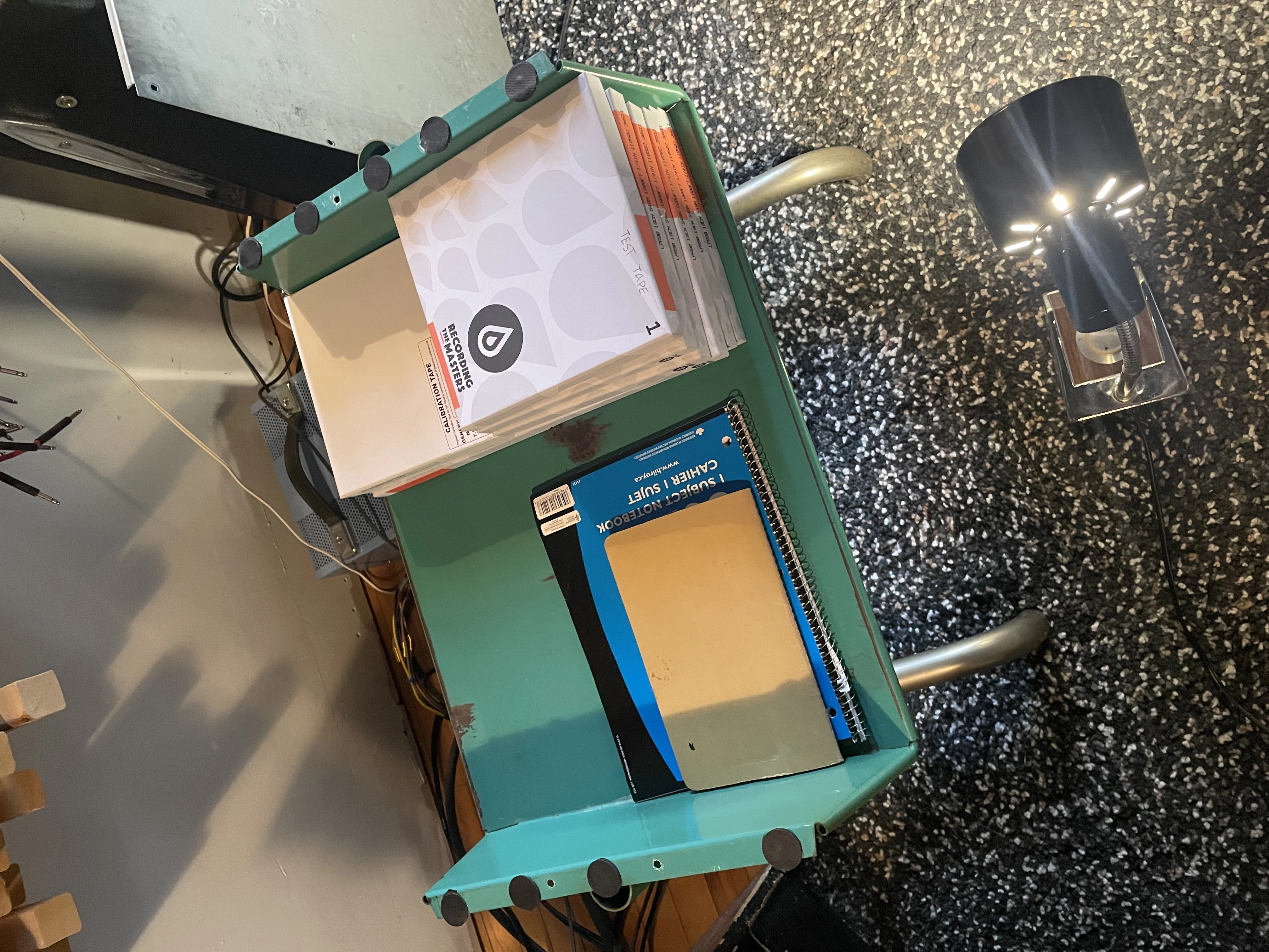

I think that my DIY console stand is pushing against the bottom pannel which makes it touch the M Buss pcb. Here is a picture of it, you’ll notice that the way its made makes the weight focused on some areas that can probably bend the bottom pannel a little bit, just enough to touch the m buss pcb. I’ll try to think of a solution to divide the weight proportionally.
EDIT: okay so I did placed some felt protectors all along the M BUSS pcb and gave it a test (so stressful) and it worked. Nothing goes wrong anymore when I push against the bottom pannel. However I would feel safer if you could give me your approbation in doing so and tell me that there is no danger of overheat or any kind of current issue into doing such a treatment. I’m leaving a photo of what I did.
Good observation and idea with the missing foam. What you did looks fine, but are those pads the same thickness as the factory pads? I would just make sure the bottom panel isn’t now pressing on the M BUSS PCB all the time. Under normal conditions the M BUSS PCB and it’s foam pads should not be touching the bottom panel. Those foam pads are there just in case there is an unfortunate temporary deflection of the bottom panel and to avoid short circuiting. So…you don’t need a whole bunch of them. Look at where the factory pads are placed and follow Teac’s example. Remember, you just stuck sticky things all over the PCB and if you ever have to repair the PCB you’ll have to remove them.

How wide is your stand? The 388 should ONLY be sitting on its feet on the bottom. That bottom panel is not designed to bear the weight of the machine. It’s a cover, not a load-bearing surface. The 388 can be in a stand as long as the surfaces of the stand align with either the extreme front and rear surfaces of the bottom, or the extreme right and left surfaces; basically where the feet are located.
The felt protectors are a little bit thicker than the original pads, but They are not pushing against the pcbs or if they are, it’s probably very minimal
I came to the conclusion that my stand, which is a fifties scholar desk with the top removed, is not wide enough to support the weight of the tascam and yes the weight was supported by the bottom pannel which is a silly mistake on my side. The tascam bottom dimension is about 23 inches wide, I just screwed back the 22 inches top of the table to prevent any kind of catastrophies and now the support is much improved. I just liked the way it looked without the top, which looked like if the stand was part of the tascam. Anyways, now the weight is correctly supported.

I had a tech looking into it at the time. He fixed the issue of channel six being intermittent. He also cleaned thoroughly all the pcbs by putting each one of them in an ultrasound bath which was pretty conclusive.
But then we came to the point, me and my tech, that we needed to calibrate the machine and when we went through the procedure to make the mechanical calibrations (setting up the tape tension arms with a tentelometer) we realized we were not even close of being in specs even with the trim pots screwed to their maximum capacity.
he realised that a lot of capacitors needed replacement and invited me to do a full recap of the machine in order to get proper results.
Many things happened while I worked on it. As I said, I am not an engineer and my sheer will to make my machine work without having to pay thousands of dollars and my love for the sound / workflow of tape recording drove me to try to repair it by myself. But I did mistakes, that I tried to correct the best I could.
Something went wrong at some point with the reel servo pcb; it was the first pcb I worked on and I murdered it. Bad traces and everything. . This is when things got nasty for a while. A short circuit happened because the reel servo pcb pcb was loose as I was testing it and touched the metal frame. Smoke came out. I think the machine didnt like it. This is when I started having logic transport problems. I can’t perfectly recall how it was behaving with the ancient pcb but I know at first the motors were just spinning WAY too fast. At some point it just stopped working. When I installed the new one, the transport went back to normal on play function, but as I described in another post the rewind and FF modes were acting all messed up because of a digital chip that was not behaving like it’s supposed to on the control pcb.
So after many months of troubleshooting we finally pinned down which one it was and I ordered it and installed it. I have to say that when I installed the digital chip, some traces lifted and went bad. It’s been a real pain to work on it to recreate the paths because it is a really tinny area with many many traces.. but when I replugged everything, it worked.
I had to buy three NOS tascam 388 pcbs, all bought from audioproz.com. One was a new reel servo pcb. Then I also bought a new power supply pcb because one fragile connector on the original one broke as I tried to plug it in. Same thing happened with one of the bias pcb which I had to replace.
I did a full recap, being extra careful of installing every capacitors with the right values.
Then one last goof happened when I’ve reassembled it all together, I inadvertently switched two connectors in the stereo master pcb and the buss pcbs area. I freaked out when I pushed the rec functions; all vu meters went into red peaks instantly and smoke came out of the machine. But then when I fogured out which connectors I switched and fixed it, the machine worked properly. It may have damaged something else though.
So.. the rest is me calibrating the machine. Getting decent results. Fixing my last problems through your assistance.
I went silent for a while because I did not want to bother anymore with all these issues. I am currently recording my album on it and after all the work I’ve put on it I just wanted a moment of actually using it for whats its supposed to be used for.
But now I can’t keep working like this, the issues just kills my workflow because of these three issues that drives me crazy:
- when the tascam runs for a while, especially when I operate a lot of Play / rewind / play rec / rewind / play rec and so on, the transport will eventually end up having some kind of failure. At first it took maybe one hour but now it takes like 15 minutes. I hit play and it spins for three seconds, then the right tension arm looses tension and it stops. But when I hit play right after, it works. Then as soon as I hit rewind or fast forward and hit play, the same problem happens again. Let me tell you it gets pretty annoying in the process of tracking..
- Second problem is that very weird phenomenon that happens on track 1 and track 7 when I record or playback with the DBX on. If I record a loud source in track 2 and record track one at the same time (let’s say two microphones from a drum kit for exemple) , a HUGE feedback occurs on track one and it just won’t stop. Its like a high pitched frequency. Same thing happens on track 7 if I record through track 8 while track 7 is on playback mode with the DBX mode. None of this happens if the DBX are off. I tried troubleshooting it a little bit, removed the dbx boards and did the same manoeuver with the DBX buttons on but it happens anyways so I know the problem doesnt come from the dbx pcbs.
Third super annoying problem is that when I try collapsing /ping pong tracks as described in the manual the same high pitched frequency happens on each track that are setup in recording mode. Its like the audio disappears and whats left is that super strident high pitched sound that makes everything peaks. And the sound gets recorded to tape. This happens even if DBX are off.
I wonder if I should buy a new stereo master pcb and or a new control pcb or not..
I hope it gives you some insight regarding the background on my tascam. If you got any questions I will do my best to provide.

So your machine was damaged goods from the start…not maintained or cared for properly, and if connections were actually rusty that’s really not good. The 388 is a finicky machine if not cared for or maintained properly and part of the reason is how the different power rails propagate throughout the machine. You have to know what can and what cannot be isolated for testing, etc. For instance you don’t want to turn it on with certain cards uninstalled. I had an issue where I had one of the cards out of the cardbay to access one of the bias amp PCBs and within 30 seconds or so of powering it up I could smell a hot electrical smell…something was overheating on the bias amp PCBs…I shut it down quick. It made no sense why it would do that, but looking at the interdependence of how power goes through the motherboards and through cards, that means certain pathways for power or ground are interrupted if certain things aren’t installed, and power always looks for the easiest path to ground. I determined at that point to never power it up without all the cards installed, and to make extender cables in order to service the different cards…changed my view of the machine from one with modular plug-in cards to one whole system that needed to be all installed when powered. The only card that can be isolated is the power supply, and that’s only if you have a custom extender cable set and can leave the output connector disconnected. Having cards with rusty or heavily oxidized connections could create a situation similar to not having the card installed at all.
Speaking of connectors…those card edge connectors…again, the 388 is relatively fragile. I always inspect the connector housings to make sure they are straight, and the two small clips are in place that keep the connector housing fastened to the card. Those clips often crack or break, so I like to put a small bead of superglue between the connector housing and the card to keep it in place. And then reflow the solder joints. And then it’s also often important to inspect the corresponding pins on the motherboard because it’s easy for them to get bent. People don’t take care when installing or removing the cards, or realize how fragile they can be. The card guides by design are poor or non-existent, so the operator has to be careful the connectors on the cards are aligned with the pins before seating. And people don’t do this. Or the connector housing clips are snapped and the connector is cockeyed and it’s not going on right, so instead of doing the right thing, removing the cards, inspecting and remediating anything that’s not right, they just shove harder. Not kidding. I’ve straightened a fair amount of pins and repaired a fair amount of connectors on machines I’ve gotten because of those kinds of negative practices. So you might need to look at some of those things and be careful to have all cards installed when powering the machine.
So, yes…see my comments above about the connectors.
And soldering…you mention several times traces lifting. No offense…you need to work on you soldering skills, or change your iron or the tip type or devote some more attention to prepping the tool or the work surface…probably a combination of all of those. As I’ve mentioned many times over the years, the phenolic resin PCBs used in the 388 and many, many other devices, or more fragile and require more skill to work on than an equivalent assembly using a glass fiber board. They don’t take the heat well and traces do lift and break…it can be a real PITA. But, truly, with the right equipment, and properly maintained equipment, and good technique, you can avoid all of those maladies and preserve the integrity of your PCB assemblies while doing the work. The more work you do without the right skill or equipment is only inviting more and more problems. You should only have to apply the tip for a second or two at the most when removing or applying solder. And a tip temp of 700F is sufficient. Oh and prepping and maintaining your tip and the work surface is critical…that greatly reduces the chances of having to keep the tip on the work for too long. So I don’t know where you’re at with all of that, and, again, I’m not meaning to offend, but if you’re having trouble with traces lifting then there is room for improvement with your soldering skills and equipment.
What connections did you erroneously swap? Use the number designation on the boards or post a pic of the ones you swapped.
Smoke is bad. It always means failed components, and or pathways. Once there’s smoke you can’t ever expect it to work right until you get to the bottom of what failed, WHY it failed, and repair every bit of the damage. You can’t just swap connections so they are correct, turn it back on and expect it to work. You can actually damage it further by doing that. So what connections did you swap?
I don’t honestly know how much help I can provide. Your machine started off very compromised, not all of which may be resolved, and there are new issues that have occurred along the way, some maybe the result of compounding pre-existing issues with new problems and you couldn’t have known what was going on, and some the result of unintended errors on your part. Again, no judgement at all. I’ve swapped connections, forgot connections, accidentally touched a metal tool tip where it shouldn’t go, put caps in reverse polarity even after triple-checking…years ago I killed my mint condition 58-OB because I installed an amp card offset by one pin…one pin! Great, great care must be taken, slow planful process and procedure when working. If you don’t, the risk factor for unintended consequences increases many-fold. I’ve done plenty of hasty work and been lucky, but I always have in my mind I might deeply regret it as I proceed hastily. That’s the reality. And the 388 is:
Complex, and…
Fragile (relatively speaking)
You’re not going to like this, but I think if it was me I’d be considering saving up to buy a known working 388 that’s been maintained and use the current one as a parts donor. You still have complicated problems occurring across multiple systems. It is going to be very difficult at best to sort them out, and because of the poor condition the machine was in when you purchased it, it’s hard to say when the next issue will rise up…black rain cloud I know…but from personal experience, with a machine like your 388, it is likely you will never be on top of all its problems, at least not long term…it is likely to always have some issue or issues.
