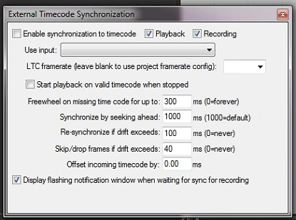

At any rate, thanks for the other tips. I did see some settings with regards to things like "freewheel" (I think) and others that seemed to be relevant to what you're saying (see attached). However, I couldn't find any description of them in the Reaper manual, and I would just be purely guessing if I were to change something from the default.
Try setting 'skip/drop frames' and 're-synchronize if drift exceeds' to 0. That should allow the audio stream to drift out of sync rather than trying to force them together, which in the case of VSTs shouldn't be an issue. If you're trying to sync a recording (or the pre-rendered version of the MIDI tracks) it is liable to go astray. But for realtime synthesis allowing it to drift should prevent the glitching.

OK...silly question...but the box [Enable synchronization to timecode] is unchecked (please don't tell me it was that simple :D).
Also, all the options in milliseconds are going to have some effect. you can start by tweaking each on alone, and see what effect it has, then go from there.
Does your manual talk about any of these options in detail and their effect?
Yeah...I woulds start with these two.

Ha! Yes that was a silly question. I wouldn't think it would chase at all if that box weren't checked. Like I said, it's chasing like a dream; it's just that the audio playback is not perfect.
Unfortunately, no, the menu does not address these things. It totally passes the buck! This is what it says:
Complete the other settings and close the dialog box. You should consult the documentation of your
external device for further information.
What's funny is that, when I first started trying to sync it up, Reaper was chasing, but when the sync tone started on the tape, Reaper would start playing back at around 35 minutes into the project. I saw the "Offset incoming timecode" setting, but then I saw that it was in milliseconds. I thought, "surely not." But yes ... I had to enter "-1,985,000" or something like that in that box (the equivalent of -35 minutes expressed in milliseconds), and then Reaper would start playback near the beginning of the project. Seems as though they could also include minutes and seconds boxes!

See...in my DAW, the sync section settings are one thing...that's where I can fine-tune stuff if needed for any sync issues...
...but then AFA the timeline settings for song start position and timeline offset...those are in my project settings and are all in SPMTE code.
Also...you should give the DAW more time then you would think was needed before song start.
Like if you cut it real close, and say....you want the code and the song to start at "0"...the DAW, as fast as it is, will not react quick enough, and then the audio is out before it starts, since the tape takes time to settle in...so it's all playing catch-up, at least initially, and then you get audio glitches.
So have timeline code that starts at say "00:00:10:00"....but have the actual song/audio start at like 00:00:15:00 (those are just examples.
Make sure that your timeline time and your song offset time are not fighting each other.
It's easier for the DAW to "jump" from the 00:00:10:00 to the 00:00:15:00 position where the song begins...than starting both at the exact same time like 00:00:10:00.
Pre-roll is good. :)
That way....the tape is rolling for a few seconds before the DAW needs to start.
Yes I've made sure to give Reaper plenty of runway. I figured 35 minutes was a little extensive, though (:)), so I offset it so that it starts about 10 or 15 seconds into the project.
