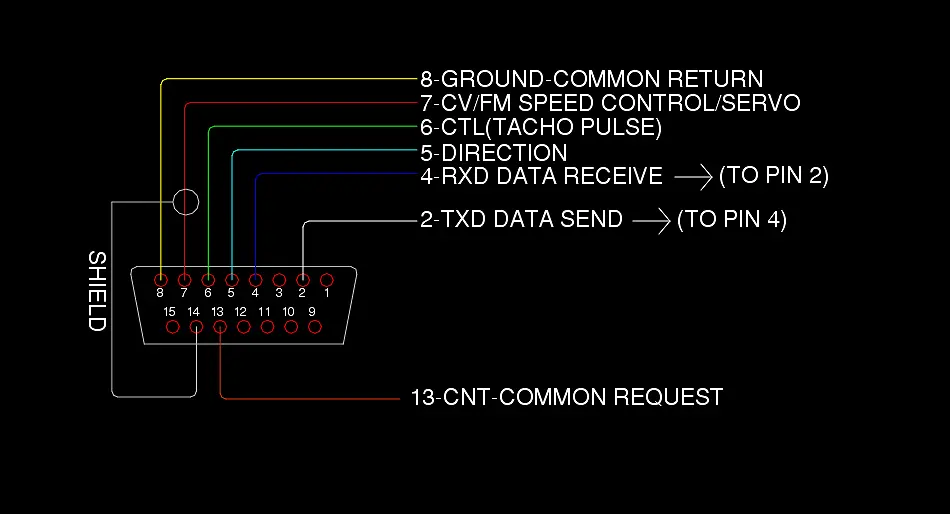

Are you sure the serial data lines are on the correct pins? Remember that they need to swap over from one end of the cable to the other.
According to my notes (which I hope are correct) you need to have pin 2 on one end connecting to pin 4 on the other, and vice-versa. Pin 5 is the direction signal, pin 6 is tach. Pin 7 is the servo (this is vitally important and missing from the ATS-500 manual), pin 8 is Common Return (GND), pin 13 is Common Request and pin 14 is END (these two are also undocumented in the ATS manual).
If you've got connections between every single pin that should work, as long as you remember that the TX and RX pins need to be swapped at one end.

Okay, I've not been in a position to try it for a while, but yes. The EXT light is supposed to go solid when the machine is being externally controlled - e.g. when I put it into CHASE mode via the ATS-500, the EXT light will switch from blinking to solid.
If it were me, I'd suspect the serial link. First, make sure that both machines are set to the same baud rate etc, since the TSR-8 has a set of DIP switches to change the comms protocol. I would assume the MIDIIZER has similar. I'd stick with 9600 bps unless you have a good reason not to.
After that, re-check the serial lines on the cable, and also the ground connections.
I'm attaching an old diagram that someone found way back when. Good luck!
