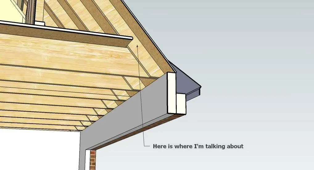

Hi Robn. I couldn't post a pic or link to my server on the HR email/message thingy. Here is one of the issues I was referring to. There are others as well. But don't worry, we'll get this figured out yet.:D BTW, sometimes I don't have time to compress and resize these jpgs so when I upload them direct from my computer, the width compromises the thread width. Sorry. I just don't have time today to do that and upload to my server etc etc.:o:(

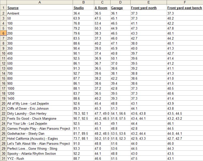

Sound Testing
OK, I did some sound tests.....
Testing was done with Sony SSF5000 floorstanding speakers, 3-way, 150W, 8" woofer, 3 1/4" midrange, 1" tweeter. Speakers were positioned approximately 14" off the floor on a cardboard box, about 15" from the north interior wall, facing south down the length of the studio. I chose 17 test tones at 10 sec duration, then some pieces of various songs. I chose songs that cut across various spectrums and featured different instruments, hopefully you know most of them.
I didn't test in all the locations I listed earlier because I felt the results would either be irrelevant or redundant. For instance, I didn't test at the HVAC vents in the bedrooms because the sound thru the wall was all I heard.....I got up right on the vent and listened with 1 ear while closing the other ear, and I didn't hear anything coming thru the vents. For the outdoor tests, I didn't test on the west driveway because the sound was clearly being heard out the north side, ie. when I was on the west side the sound was predominant in my left ear. On the east side I tested next to the wall that makes up the east wall of the garage.
Here are the test results (readings are peak):
Here are the music clips:
"All Of My Love" - Led Zeppelin - Track is middle synth solo and strings
"Cliffs Of Dover" - Eric Johnson - Track is right after the intro
"Dirty Laundry" - Don Henley - 2 Readings - 1st is intro, 2nd reading is first stanza of vocals...I also have the Steve Lukather guitar solo (2nd solo) but it didn't peak above the vocal start.
"Feels So Good" - Chuck Mangione - Track is the sax and guitar solos from the extended version, 2 Readings - 1st is sax solo, 2nd is Grant Geissman guitar solo
"For Your Life" - Led Zeppelin - Track is intro
"Games People Play" - Alan Parsons Project - Track is close to the beginning of the song, chosen for Alan Parsons great snare treatment, also has guitar solo but it didn't peak above intro......AP is my 2nd favorite group
"Godwhacker" - Steely Dan - 2 readings, 1st is intro to get kick drum, 2nd reading is when Fagen starts singing 1st verse. Steely Dan is #1 group, seen them in concert twice, bought 1st album in '72 and have loved them ever since
"Hotel California (live acoustic" - Eagles - 2 Readings, 1st is to get congo, 2nd is guitar intros
"Let's Talk About Me" - Alan Parsons Project - intro, chosen to show volume variances
"Perfect Love....Gone Wrong" - Sting (live) - intro and 1st verse, chosen for stand-up bass line
"Spooky" - Atlanta Rhythm Section - track is middle guitar solo
"YYZ - Rush - track from start and runs 2:12

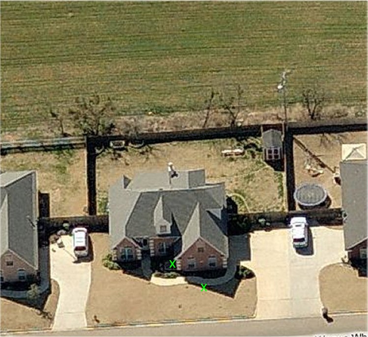

Meter placement:
Studio - approximately 3' from speakers and in the middle, about ear height sitting in a chair
"A" Room - about 8" from north wall at middle of wall. This is the room next to the studio, so the speakers in the studio were pointed right at me
Garage - middle, about 3' off floor
Front yard north - directly underneath sealed studio window, about 9' from north wall and 3' from ground
Front yard east bench - about 5' off ground, just outside east garage exterior wall....Rick, this put me almost right underneath that fake dormer in the front of the house.
Here is a pic of the locations:
General observations - as I suspected, the garage was the worst location....the outside positions were worse than I thought they would be also.......I couldn't hear much of the vocals, but the low freq was heard fairly easily. I was surprised that the level wasn't stronger in the bedroom though. As I mentioned earlier, I couldn't really hear anything in the HVAC vents......
Hope this helps somewhat.........
:eek::eek::eek::eek::D WOW! WOW! and WOW!:D:D:D
Robn. In all the years I've been a member, and of all the times I've suggested people do this, YOU are the first one to actually do it, and do it RIGHT!! Congradulations SIR!:D Even your chart is magnificent!!;);) Kudos to ya!! Hip hooray!! Hip hip hooray! Hip hip HOORAY!!
OK!! Now we have something to work with. Tell ya what. I haven't heard back from Rod yet, and I may not. He is always a very in demand guy.:) Sooooo, heres what we'll do. I'm going to run this across the bow of some very acoustically "in tune"people cause like I said, I'm no expert on the science side of this stuff. BTW, before I do, tell me something. What "weight" setting did you have on the SPL meter? I completely forgot to tell you to use the "C"...uh, that is, I THINK I forgot to tell you...my memory sucks.:D

But now that we have some concrete data. The problem now is ...(in my non expert opinion) to:
1. Interpret the data in terms of existing transmission loss
2. Determine what your maximum SPL goal is at each location.
2. Extrapolate what TL you need to achieve those goals.
4. Determine the actual construction strategy to reach this Transmission Loss.
Not an easy task, even for a pro.:confused::D First off, trying to determine the maximum SPL goal at each location to insure the "fear inducers" arn't annoyed or you feel comfortable enough to "let er rip"(:D) is the most difficult. Naturally, you don't want ANYBODY to hear a thing! However, lets put it this way..if you needed 60db of isolation between you and each FI's, and the maximum TL you can realistically achieve was only 45db...well, I think you get my drift.:D..ie...it ain't gonna happen.:( Thats not to say this is what you really need. Only the worst case scenario. Ok, I'm outta time.

A strange anomaly at 450Hz in garage
I'd bet its a "membrane resonance" issue in the floor, or some "coincedence dip" thing in the floor panels. Rod says with any given assembly, there are certain frequencys that will pass through like "a hot knife through butter"! Seems thats whats happening. Problem....how to estabilish the fact...and then do something about it.;) Rods solution....MASS, MASS, and more MASS.....oh, did I mention more Mass?:)

maybe you have covered this already dude, just notice rafters are sarked with 12mm sterling board and if this cant breathe you could end up with moisture and or warping problems.

Potentially dude, the holes in the soffit allow air to travel into and exit the roof space, when you fill with wool and then clad with gyproc etc you block that off.
Easiest way around is to make sledges with 45 x 38 or similair battons and 4mm ply, you dont have to make them the full width of the space between rafters which are probably set at 600mm centres. fit them behind wool.
Scuse the crap sketch:o
Oh and the sledges need to go from just above soffit to slightly above your new ceiling level.
