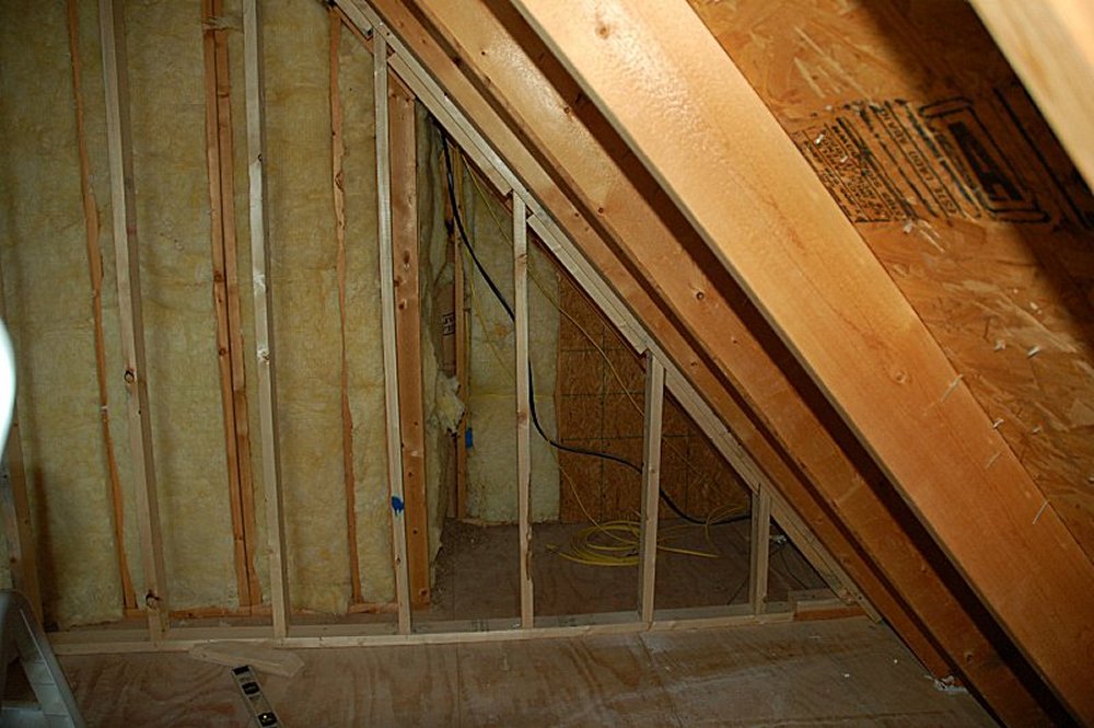

I was probably talking about the hole into the attic that I would need to be able to fit my baffle box thru......yeah, there's stairs.......I think I understand where your confusion lies.....the "attic" is not really on the 2nd floor.....we have a 30' ceiling in the living room, and the "attic" is above that......on the same level as the HVAC I took pictures of, just a little further east.......the attic access "panel" is in the hallway on the second floor......the HVAC unit for the first floor is on the same level as the studio, the HVAC unit for the 2nd floor is 1 level above, in the "attic"

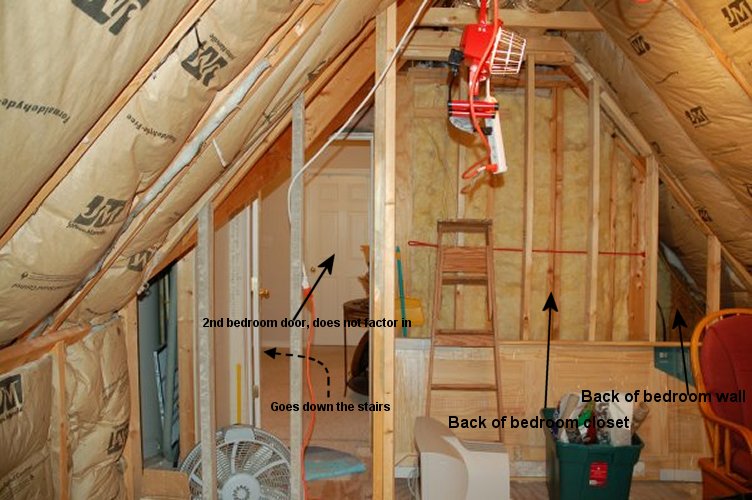

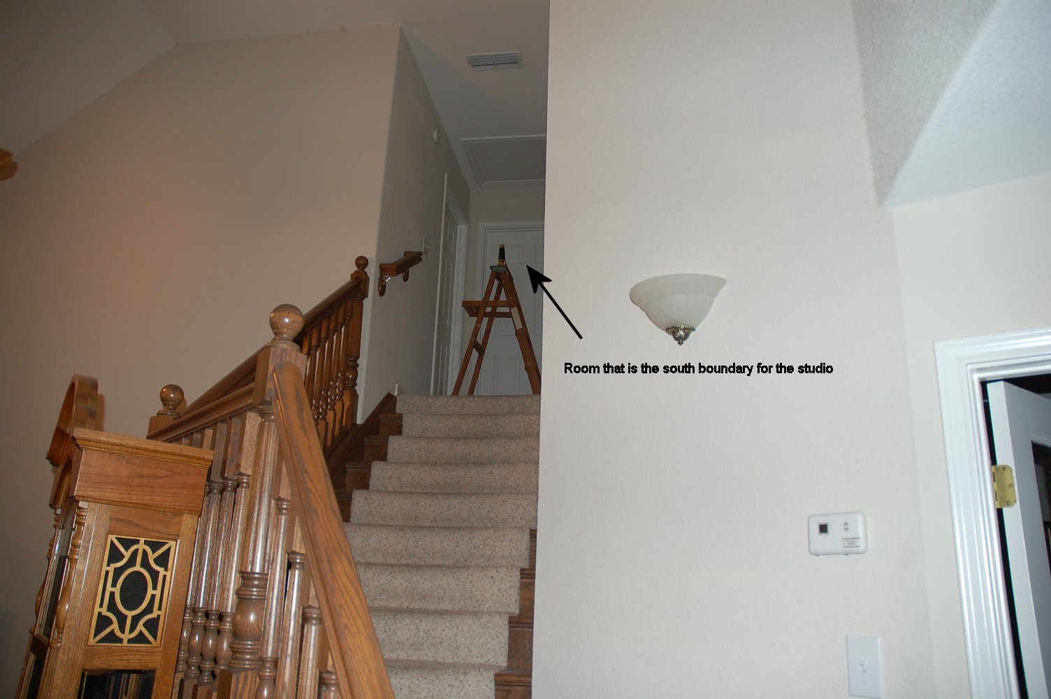

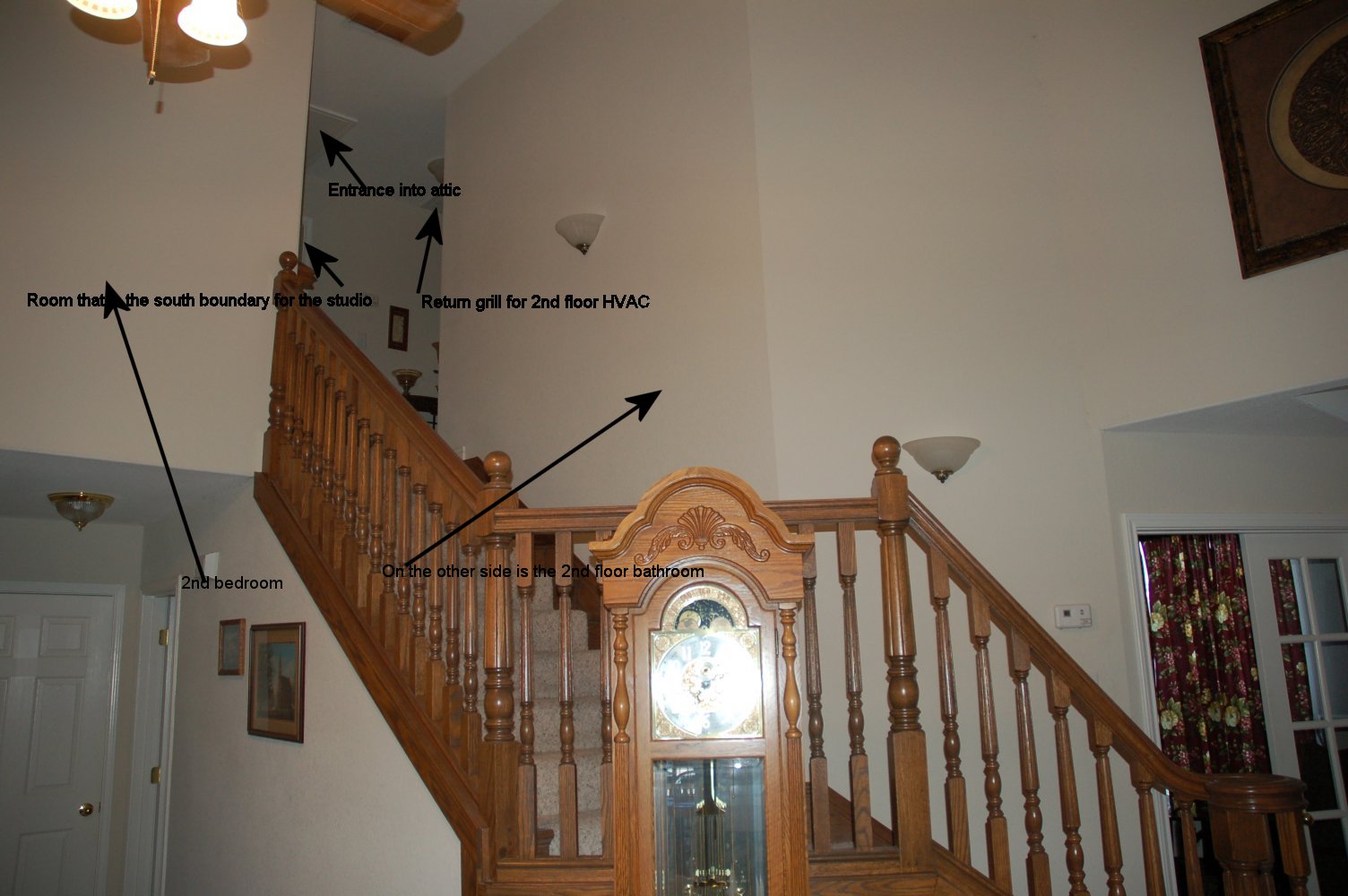

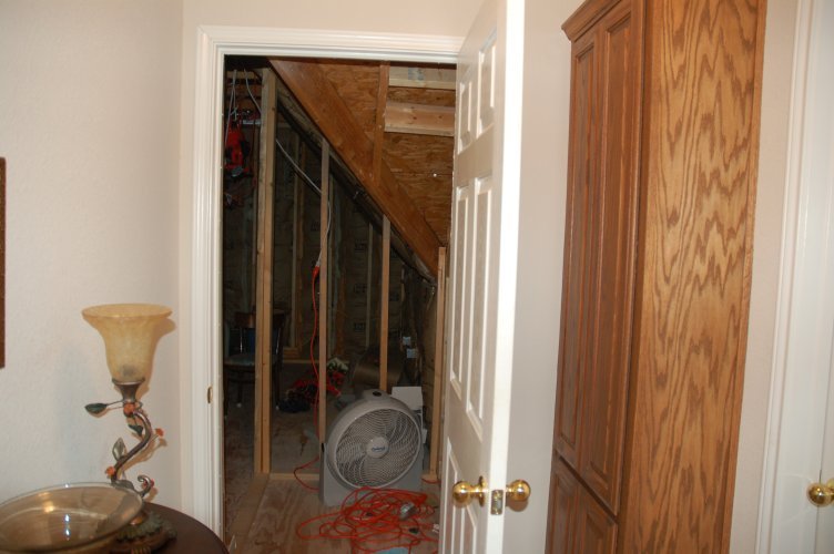

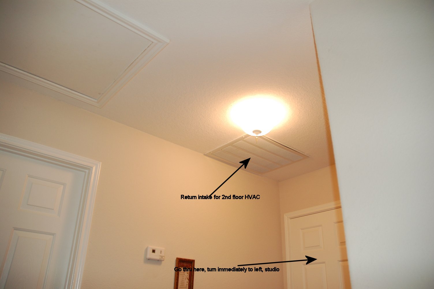

From the living room on the first floor:
This is leading up to the studio.....the ladder is underneath the panel into the attic:
This is from the 2nd floor hallway...you can't see one of the bedrooms, but the door on the left is the bedroom that borders my south studio wall....the door to the right leads into the area where the studio is.....after you go thru that door, immediately to the left is the studio where the entrance will be....
Hope that helps.....catch ya later!!!
But not as much fun......
I guess so. But I never thought gambling was fun...maybe because I could never afford to loose money.:D
Ok, NOW it's clear as day!!! Almost.:D All I need is a couple of more tidbits of info to put the puzzle together.

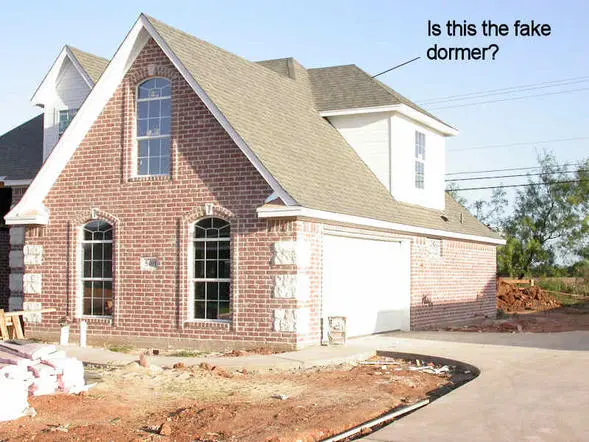

Robn, looking directly at your rear wall, from inside the studio, there is another wall right behind it. Is that wall in the same plane as the wall with the hall door to your studio? (I assume it is). I also assume this wall is the north wall of the adjacent room with the dormer, as I see insulation in that wall, and it must meet the west dormer wall, with the window in it, no? At least thats what I've extrapolated from the pictures. All along, I thought the "bedroom" was this adjacent room to the studio. Now I see it isn't, but what IS this room with the dormer for?
And one other thing You built a wall parallel with this dormer room northwall. I can't see in the pictures, but it appears you terminated this new wall at a point where you plan on framing a wall for the actual studio door, no? If so, that would explain a lot of things. Can you take a pic of that wall termination and the gap between the new wall and the hall door wall? Thanks

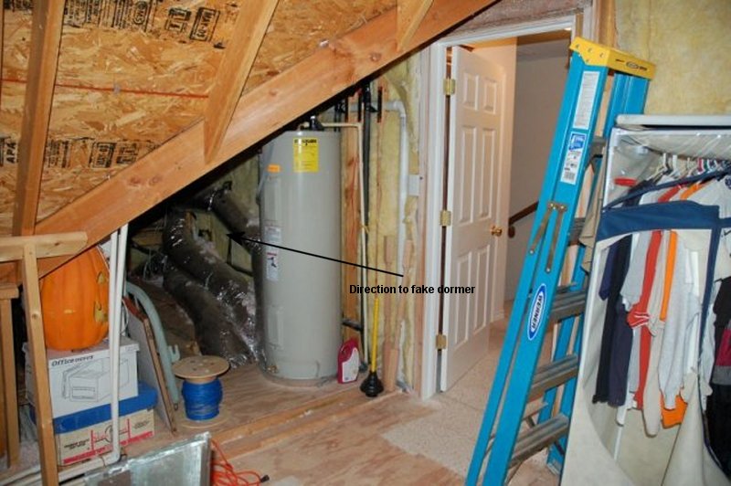

Yes it is....the hall doorway is on the same plane as the closet in the bedroom....if you are looking at the south wall in the studio, you are looking at the back of the closet....the area to the right (looking at the south wall from inside the studio) is the back of the bedroom wall.....
The dormer is a fake dormer......there is no bedroom behind it......and it is well east of the bedroom and studio.....
A few more pics to hopefully clarify the house layout....
Looking south:
Looking southeast:
A closer look at the south studio wall / back of bedroom closet/wall:
This is a look at the back of the house.....from the backyard and looking northeast:
Looking straight north from the upstairs hallway, looking into the studio area:
A modified pic you've already looked at:
Hope this helps

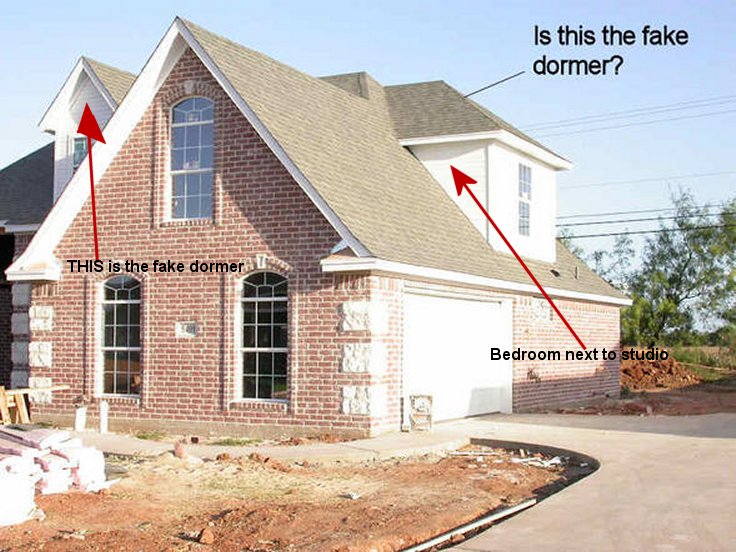

Hi Robn. I'm a little confused. Isn't the bedroom closet opening wall inline with this north dormer wall or something close? And is this the dormer that is fake or is this a real dormer which is part of the bedroom?
That one is part of the bedroom, the bedroom that borders the studio....
Here's the pic:
The fake dormer really doesn't factor into any of this.....

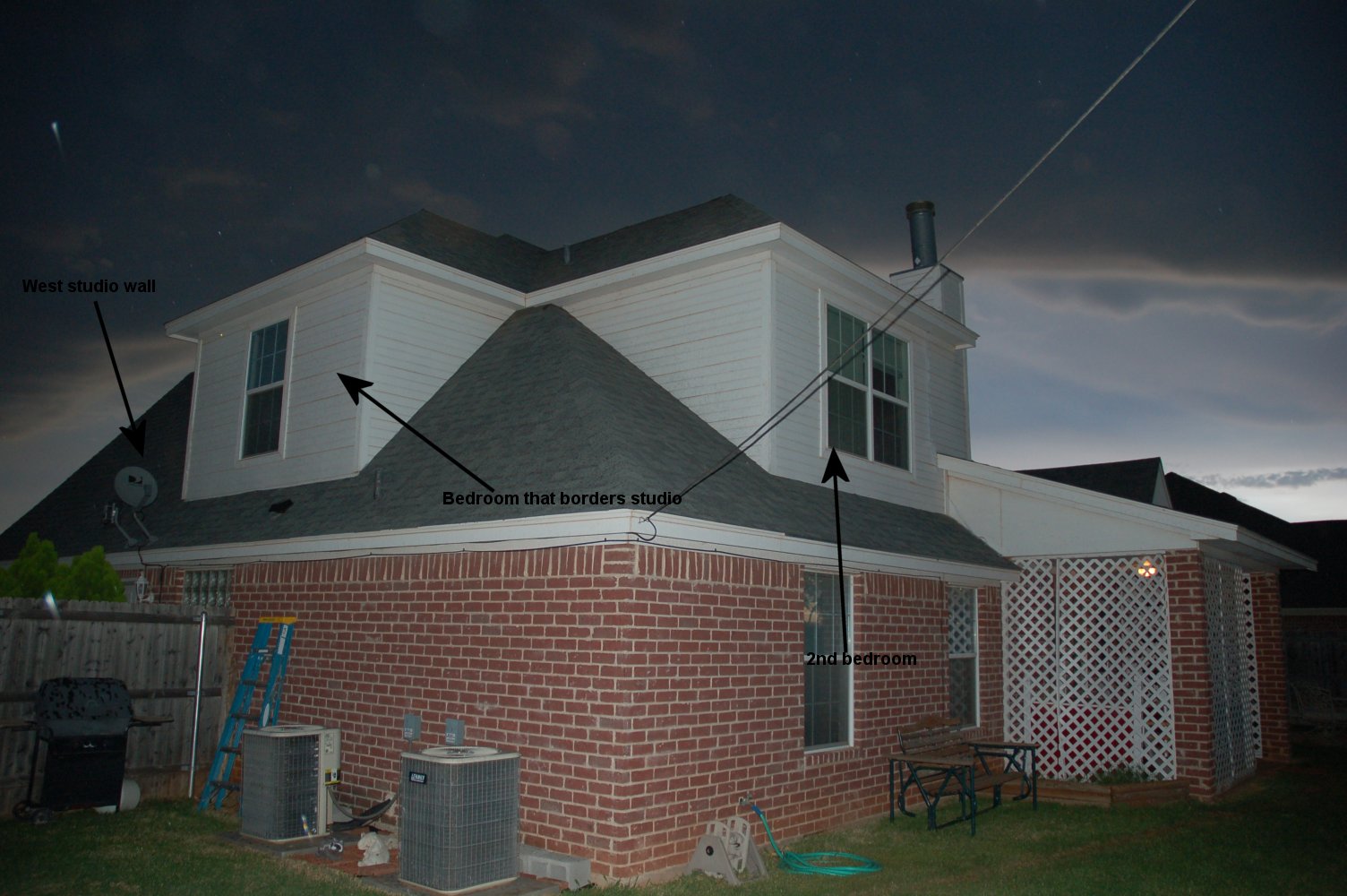

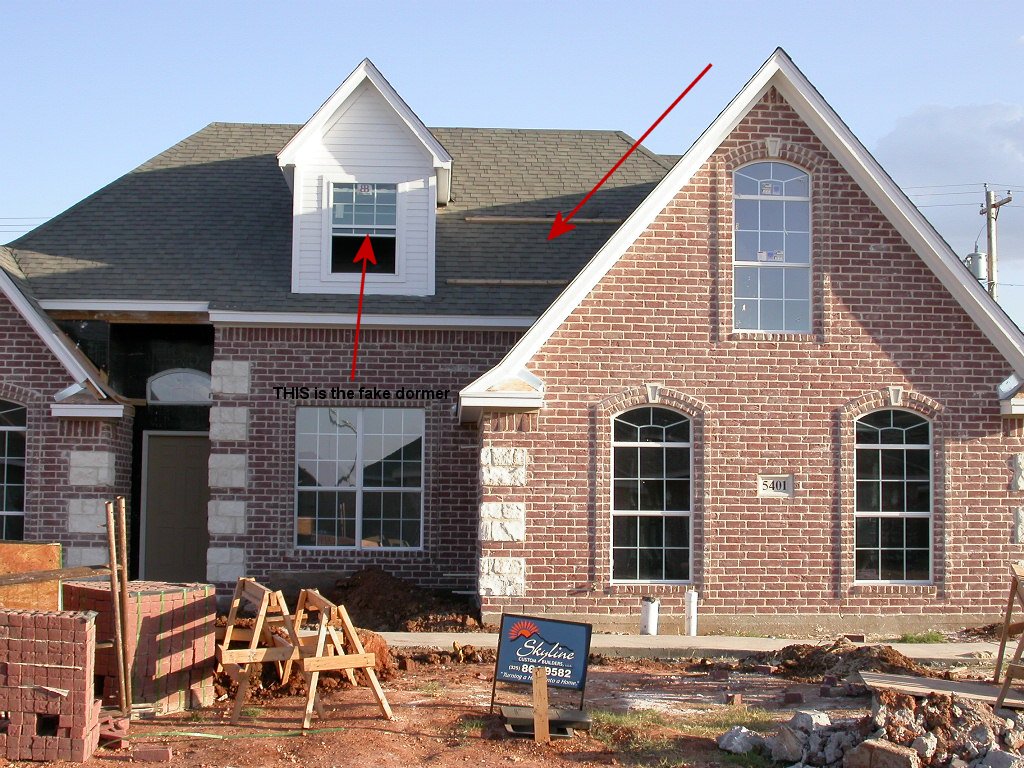

A front view.....see the arrow with no text? Behind that roofline is the passageway that leads to the water heater and into the studio if you kept going west......
The fake dormer has no back opening......the back of it is the roof
Here's you a birdseye view:
Hasn't got a thing to do with the studio, but the birdseye view just looks weird to me now.....this is what that left side (southeast) corner of the yard looks like now:
(Taken from the back bedroom 2nd floor window during a rain/storm)........that was about a month ago......it's got more shrubs, bamboo trees, statues now.......my Spring/Summer Project
Hi again Robn. That has got to be the wierdest roof I've ever seen.:D I bet the guy who framed that had nightmares.:p Anyway, thanks. NOW, I know whats happening, although most of it doesn't have anything to do with this. I was just curious. Ok, well back to work on this. One thing these pics did do was help me eliminate one idea I had. I won't go there though. Not worth the time. I'll be back as soon as I can with the rest of my suggestions.
