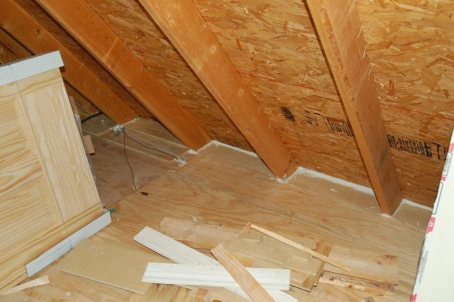

If you post a pic of where your flooring meets the rafters I can see what you have and I will post a more detailed sketch of what you need to acheive.
Very nice looking house by the way.
Well, this is about the best pic I've got......I caulked around the rafters so there's no hole there....

I cant see any reason why that wont work bud, the pipe would hold the insulation away enough for air to move, dont bother with the bays at each end where your gable ladders are, the timbers run across the way on them, nobody vents those bays.
If you do go with the pipe idea, bore the hole through the floor 10 mm bigger than diameter of the the pipe, flooring also expands and contracts, if you make it tight it will eventually squeek on the plastic pipe and you wont be able to get to it , drive ya nuts, DONT CAULK IT.:D

BTW, I did find a better pic of the floor....it's from 3 years ago when I started this:

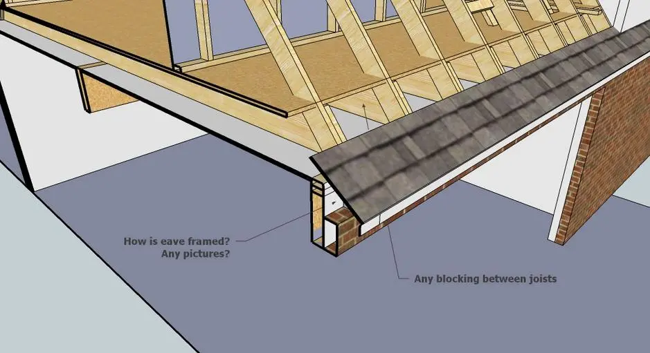

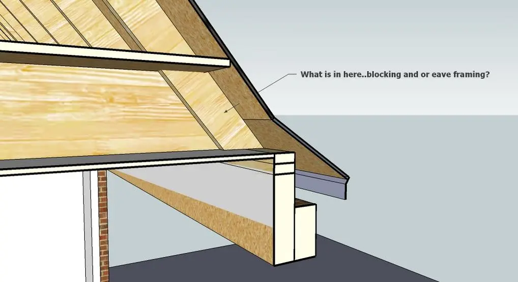

Lets examine this idea. Give me a day to draw it up so I can see just what you are dealing with. I really haven't had time to give it some thought. HOWEVER, something occured to me in the middle of the night.:D
At one time, John Sayers told about a studio he built that HAD to have a three leaf exterior envelope by virtue of the fact the building was shiethed with old board and battens. There were many "flanking paths, but he solved the problem by installing drywall in the stud cavitys between the studs. The concept was a "vented" third leaf. Now, that MAY be an answer here as well.
However, that remains to be seen. What I'm really wondering about is:
1. What the eave framing is like and or is there blocking that blocks off the eave in the first place.
2. How ANY type of venting between the soffets and your ceiling/attic/duct space could vent HEAT from that area as you don't have any vents at the ridge. Heat rises. Maybe I'm missing something here. And yes I understand about the moisture thing. However, HOW can it be prevented simply by having vents at the soffets up to the attic space if air in the attic doesn't move upward via a ridge vent.:confused:

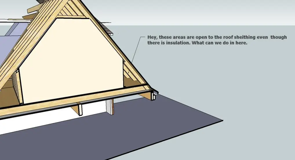

PS, sorry to post pics that arn't compressed and resized. No time.
It just occured to me.
It would appear that you COULD drill some holes at the floor to vent the soffits into these areas, and run PVC from these areas up to the "attic" space? But you still don't have a vent at the ridge or gabled end.:confused::confused:
