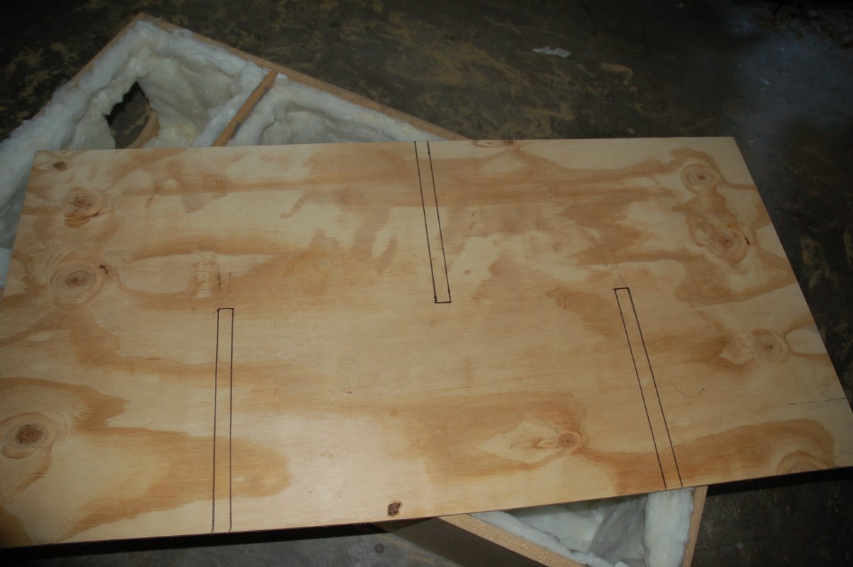

I'm in the middle of building one of my HVAC Baffle boxes......
:eek: Already? Hmmm, what did you decide to build? What happened to "hold youir horses"?:p I guess you ARE impatient.:D How are you going to check these with a sound meter? :confused:

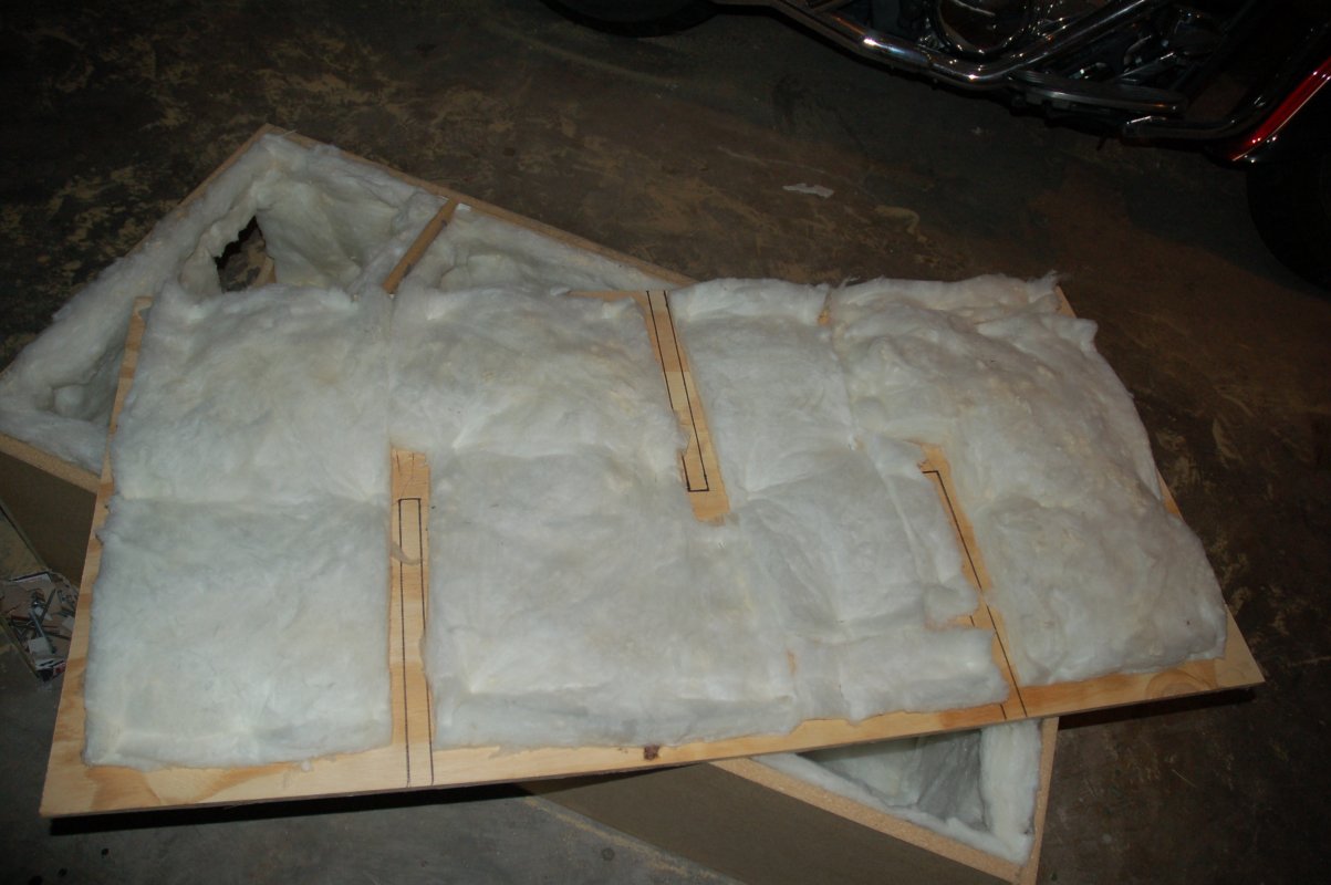

I'm using Johns Manville R-13 ComfortTherm to line it
Can't you find duct liner? I think they sell it at most HVAC places. At 3 1/2" thick, these must really have big air paths..you are'nt forceing the air THROUGH this stuff are you?:confused:

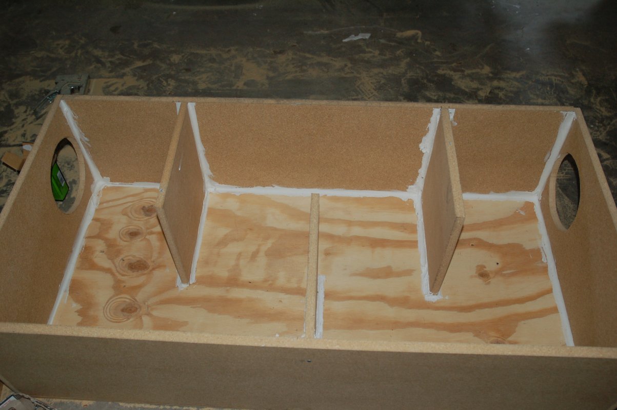

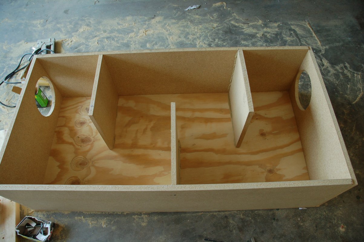

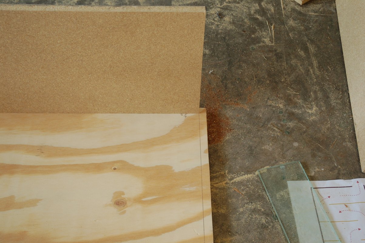

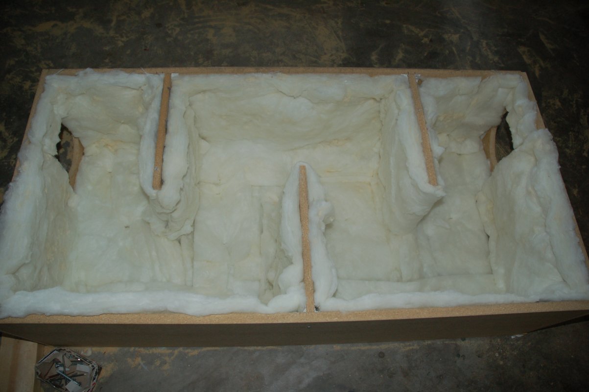

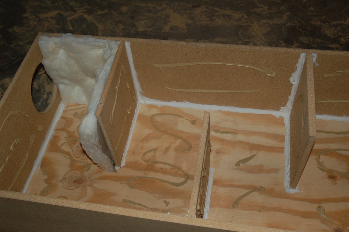

As to the project.......the way I "tested" faced versus unfaced was extremely unscientific.......I tested with the intro to Alan Parson's "Days Are Numbers" (AP is my 2nd favorite group) since it's pretty consistent....I sent the output thru my computer's Logitech left speaker.....I put a big piece of faced insulation 6" in front of speaker and tested on the other side with the sound meter, using the average and peak db. Then I tried same unfaced and compared the difference......the unfaced was 1 db quieter. How's THAT for unscientific!!!!
As it turned out, it didn't matter anyway really......when I started lining the box (48" X 24" X 12") I quickly realized that 3 1/2" would take up too much area and really choke the airflow.......what I ended up doing is taking the insulation and tearing it in half......that's how I lined the box....

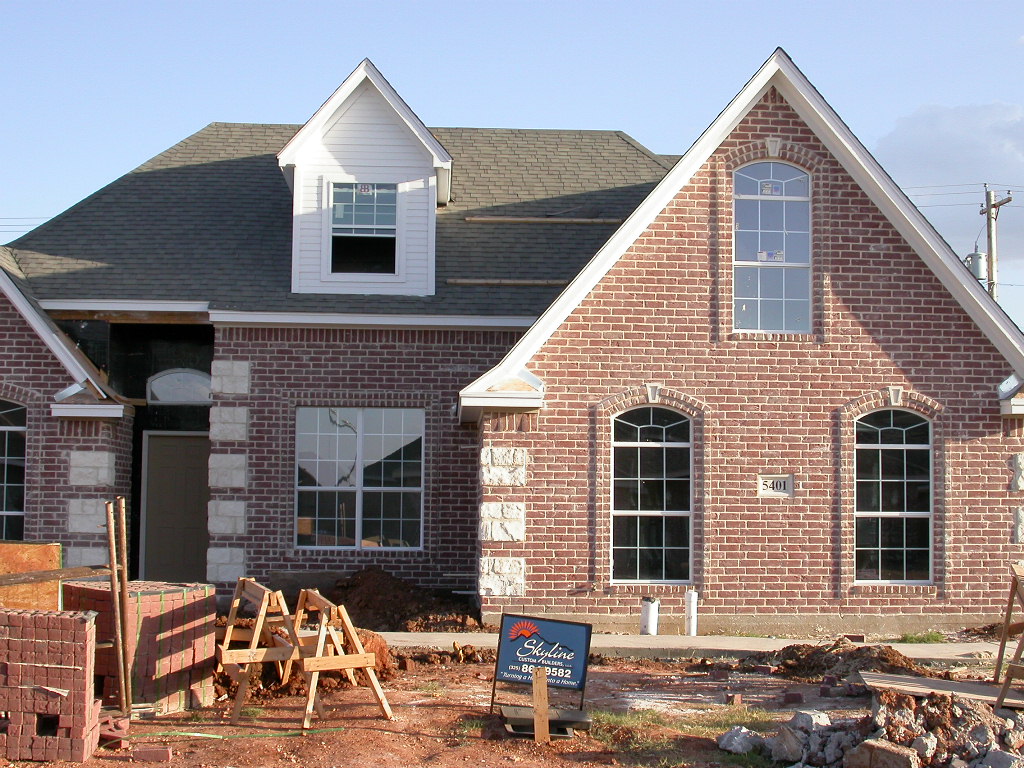

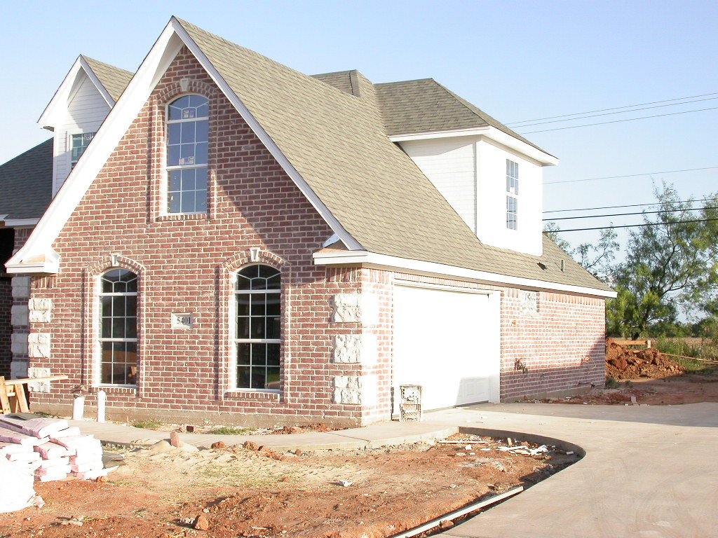

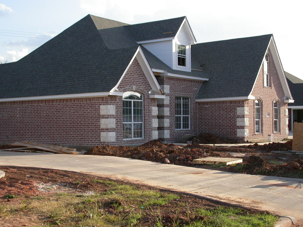

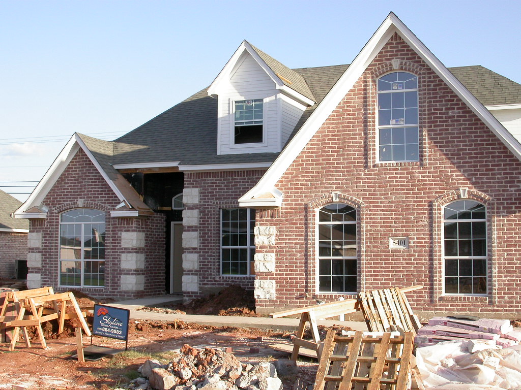

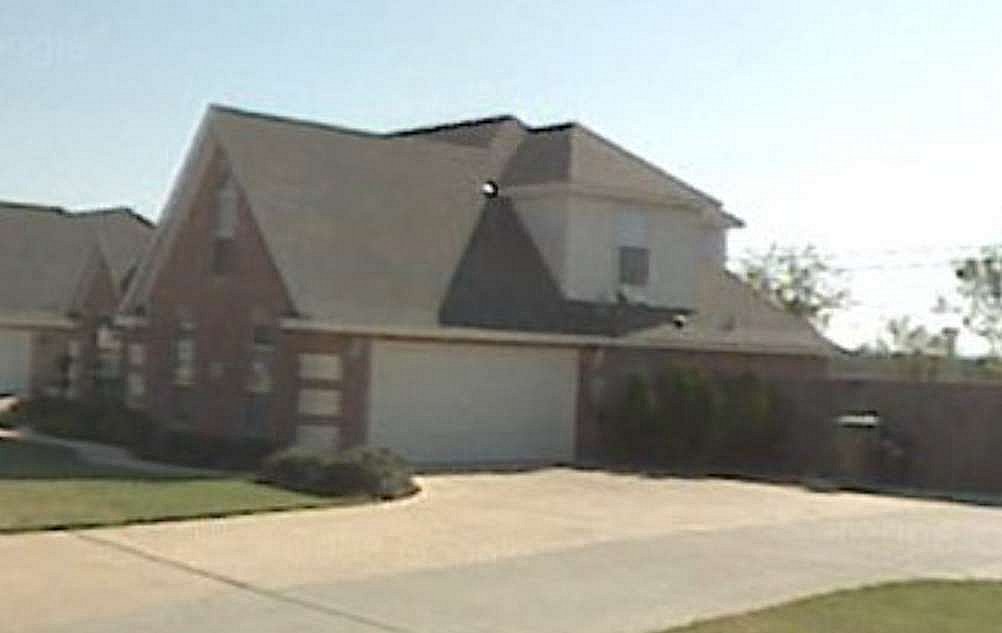

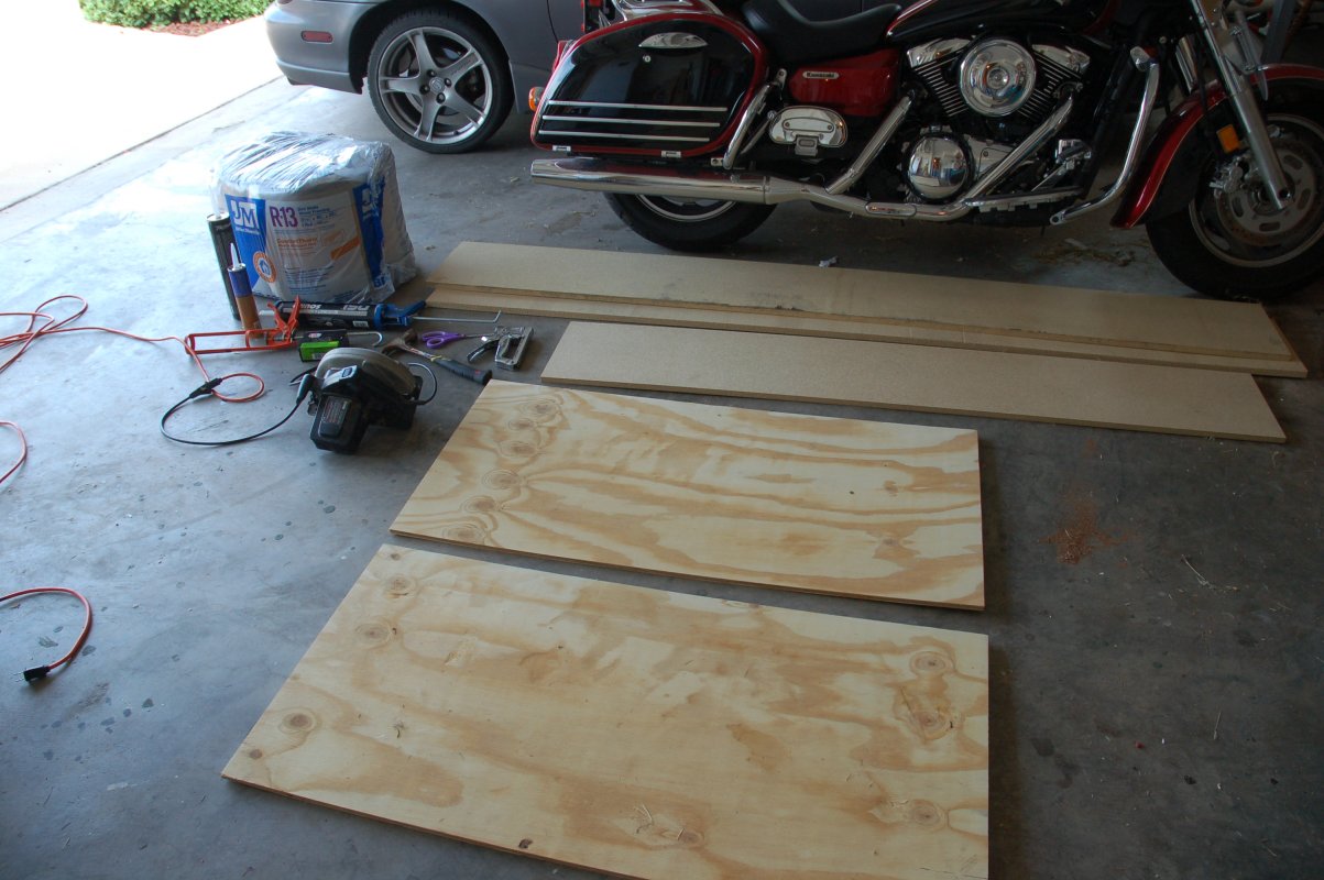

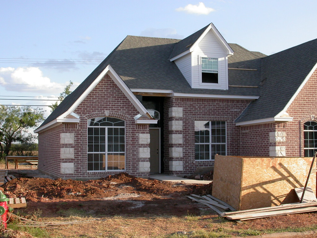

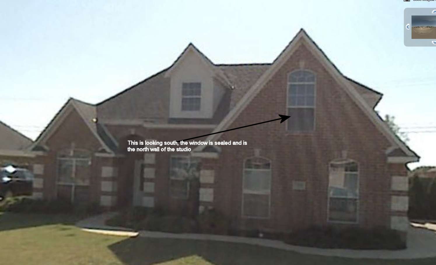

Here are a few pics:
By the looks of the framing, something is going on that I can't figure out, although its not important for anything but my "mind exercises"
This one made me smile....you sound so detail-oriented, I'm kinda like that myself.....here are a few pics of my house.....the first 2 I got off Google Earth street view, the others are from 6 years ago when the house was being built:

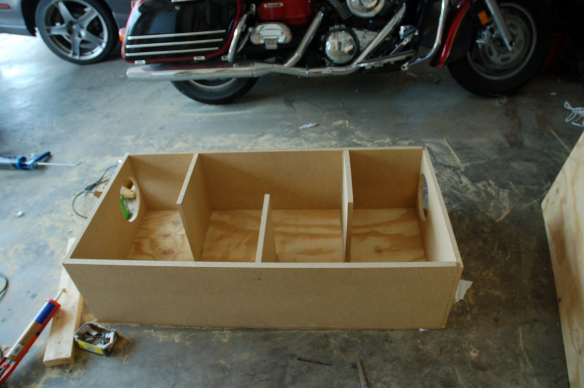

Alright Robn. HEY! Your baffle box looks GREAT!:eek::cool: I thought you might build it out of 2x6 like that first picture.:rolleyes: One suggestion though if you haven't closed it up yet. I WOULD take the time to find some duct liner. Works MUCH better than a thin layer of batt insulation. Its the DENSITY that counts.
And your construction tells me something about you.:cool::D Do you have a table saw? How bout a compound chop saw. If not, they're cheap. I just bought a Hitachi for $90. Cheap. Works great too. If you decide to build the rear wall like I showed, you'll need one...and some compound miter skill too!!:D

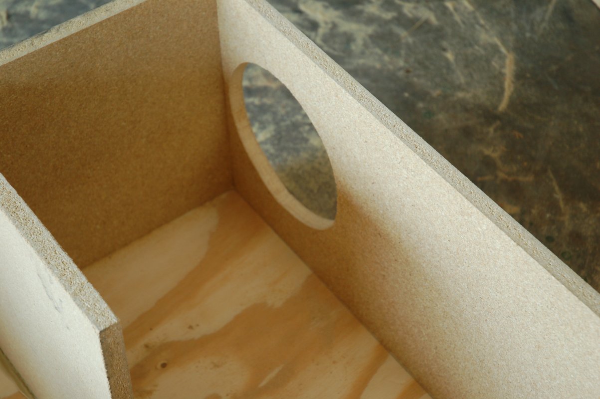

Yeah, I already put a big bead of acoustic caulk on it and closed the box up.....BUT I may build another one tonight for the supply duct and if I do, I'll look around for some duct liner.

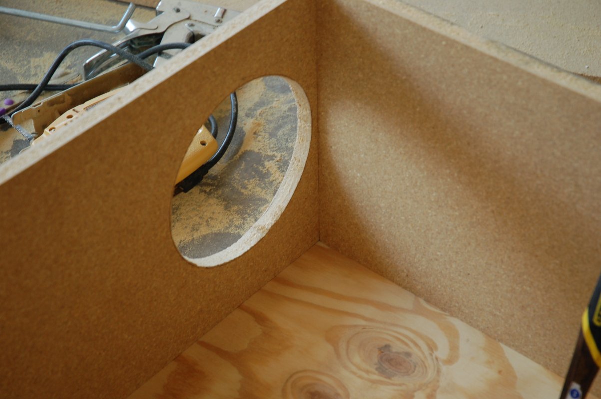

I cut the holes in the end with a standard jig-saw.....my construction skills are fairly sucky but I do the best I can. As to location, it's going in the attic, as far away from the studio room as possible.

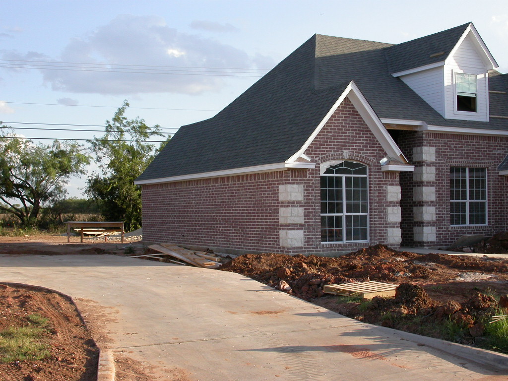

Thanks for the comments on the house.......6 years ago construction costs were cheaper, and it didn't cost a fortune.......but the house payment could drop some and not hurt my feelings any. The house plans are from one I found on the Internet.....my builder had never built one like it before so it was "interesting" during the construction.

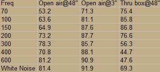

Did some rudimentary sound tests on my baffle box tonight......somewhat unexpected results, but then what do I know? :eek:
Sound meter - CEM DT-8850 using A Weighting
Distance of test (box) - 48"
Tone wav files created using Sine Frequency
The box actually amplifies low freq but does a good job in the mid to highs.

In studios I have built in the past with ducted air con, I have found that the larger the ducting and the less restriction usually means lower air con noise due to the slower air flow through the duct and grills.
It could be that the Baffle box is a bit too restrictive, either slow down the air flow or make the openings bigger.
At one studio we put in a ducted system with 10" duct and grills, we had too much air noise even with the fan at the lowest speed, we upped the duct size to 12" (would have liked it bigger but no room) and the largest grill panels I could find and the noise come right down.
At a later studio where we had a baffle box, the duct was 12" in and out and the box stood 6' tall by 4' wide and 16" deep and the air went from the bottom to the top and turned down to the bottom again, 12' of baffle but with low restriction (low noise).
You can also reduce the noise (and slow the flow a little) by turning the duct back onto itself then back again like a large S shape.
If you talk to Air con people (good ones) they can help you with this stuff.
Cheers
Alan.

Thanks for the reply.......here is a pic of my baffle box just in case you missed it earlier:
The return ducting has an 8" inner diameter.....the holes in my baffle box are 7 1/4 per the HVAC guy's instructions.
I hear what you're saying about the box being restrictive......but I couldn't build it any bigger or it wouldn't fit thru my opening into the attic :D And hey, this is West Texas and I ain't just about to build it in the attic......we've already had 26 days of 100+ weather this year!
