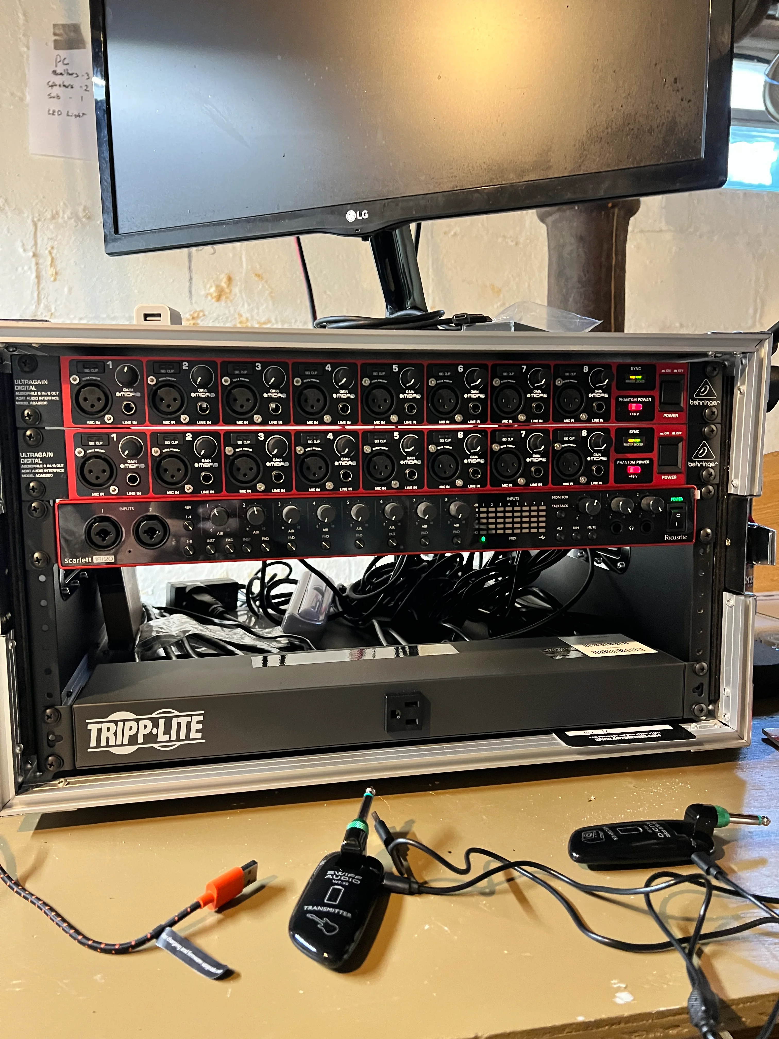

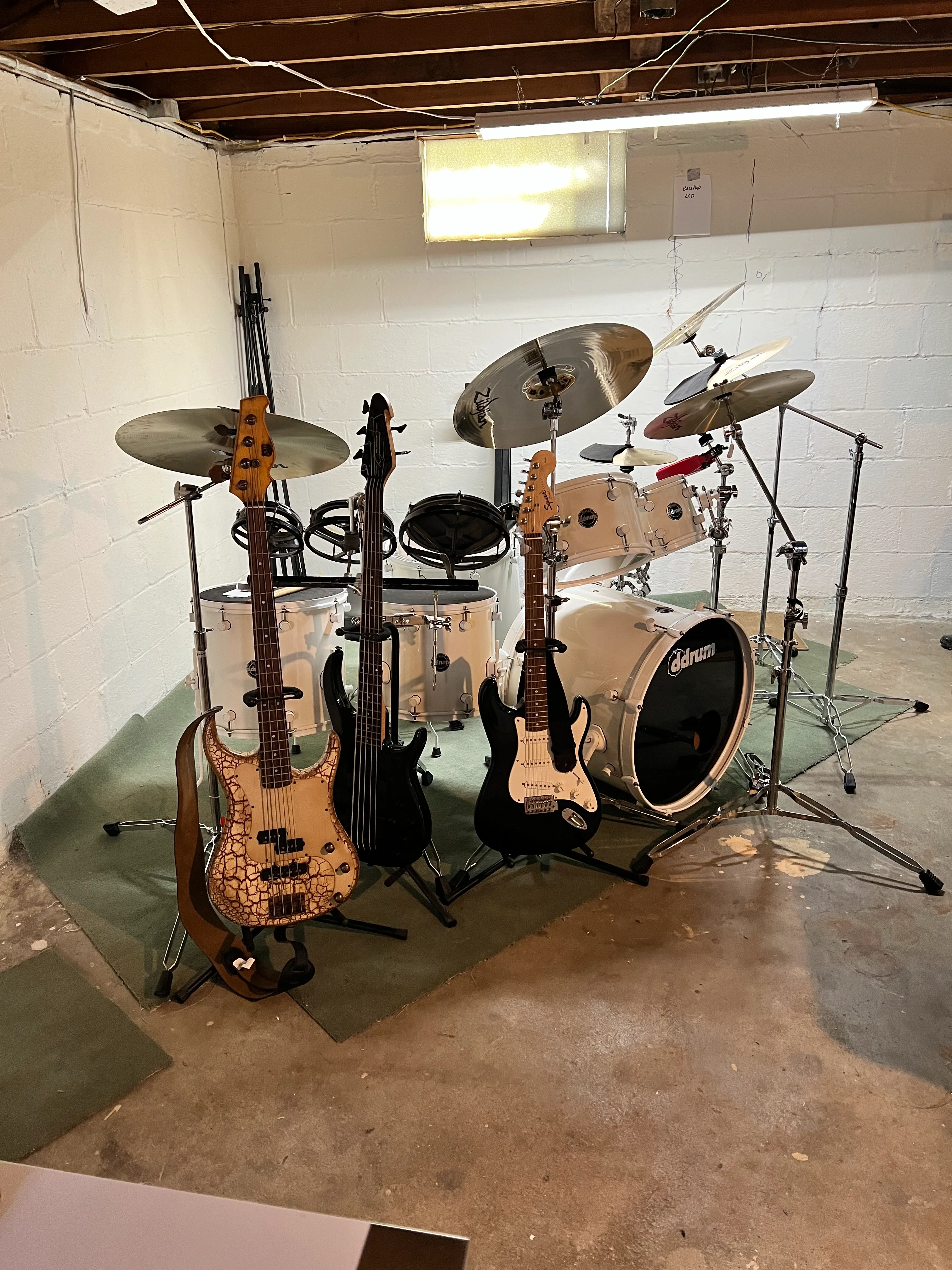

Good afternoon everyone,
I just to make sure how important room treatment is for my situation.
First up I have 3 midi controller/keyboards which I'm sure will be recorded within my DAW
Second 2 Bass and a 6 string would be close mic'd with the option to Direct Box these
Third my drums which are close mic'd, having 2 drum mics to account for every drum and several CAD gxl1200 mics clipped on podcast boom arms dropped from the ceiling joists to account for each cymbal, these too would be fairly close mic'd. I'm told even with so many mics it is recommended that I still need an overhead mic.
I have a Scarlett 18i20 3rd gen audio interface, and 2 Behringer Ultragain Pro 8 ADA8200 mic preamps to connect everything, soon midi interface and voice processor(because I can't sing lol) added to my rack.
I have a pair of Yamaha HS5 powered studio monitors and a Yamaha HS8 Powered sub, the monitors a a perfect 45* from my chair, perfect sweet spot.
so how much value should I place on acoustic treatment?

Personally - you have the kit, so get it set up how you want it and record some stuff. Then critically listen to anything recorded with mics and assess if it needed deadening, 'uncolouring', fixing etc etc.
Then if you determine you have parallel wall flutters, or unpleasant reverb, or boomy bass, you can fix it. Soundproofing needs advance planning or it's too late. Sound treatment can be done to taste.

Agreed. Listening is the true test. You can make assumptions about what you "think" will happen, but "doing" is the ultimate test. 3 hard corner aren't usually the best place. It would be pretty easy to build or buy a couple of panels to dampen reflections.
A simple clap test usually points out issues pretty quickly for me.

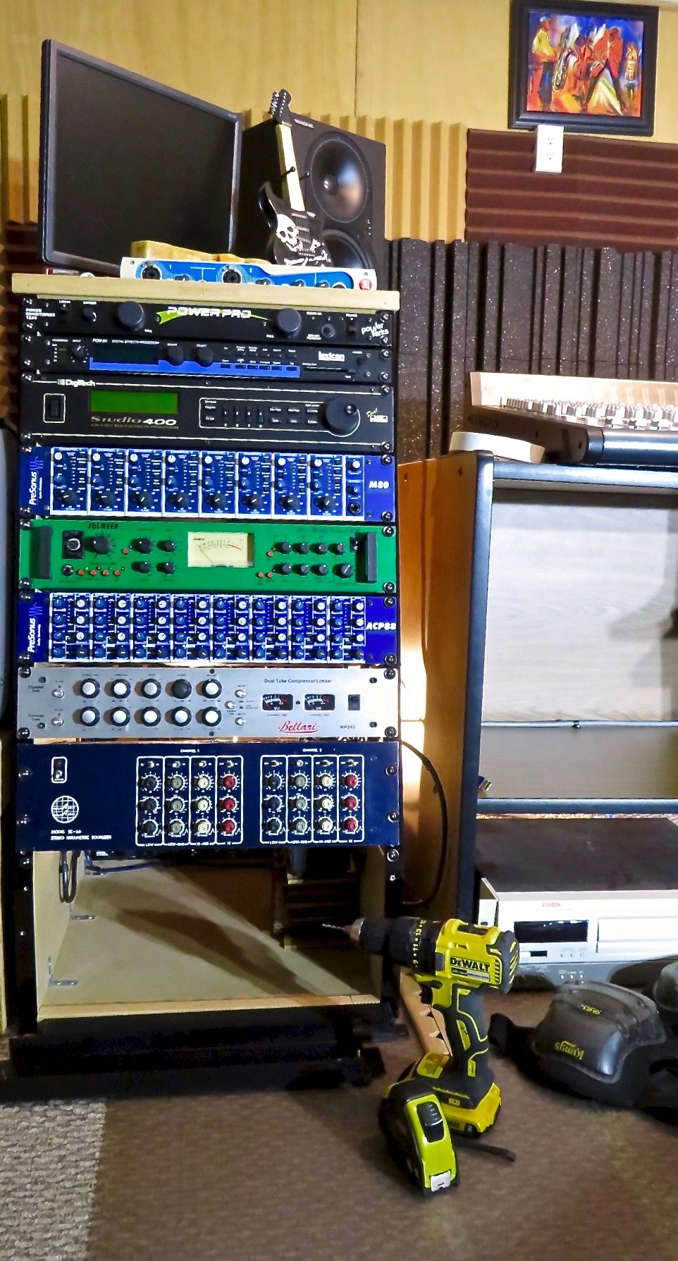

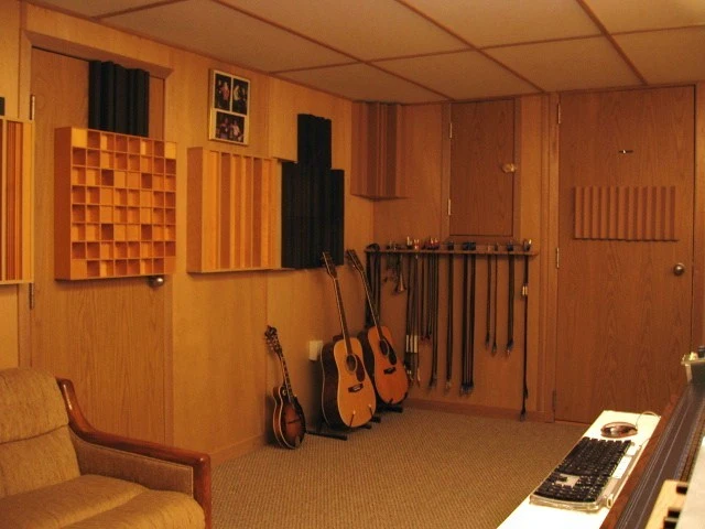

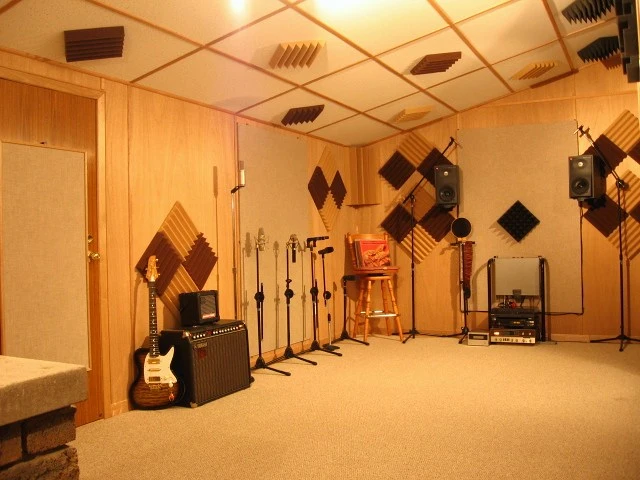

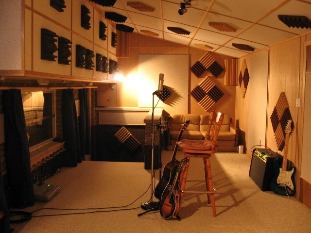

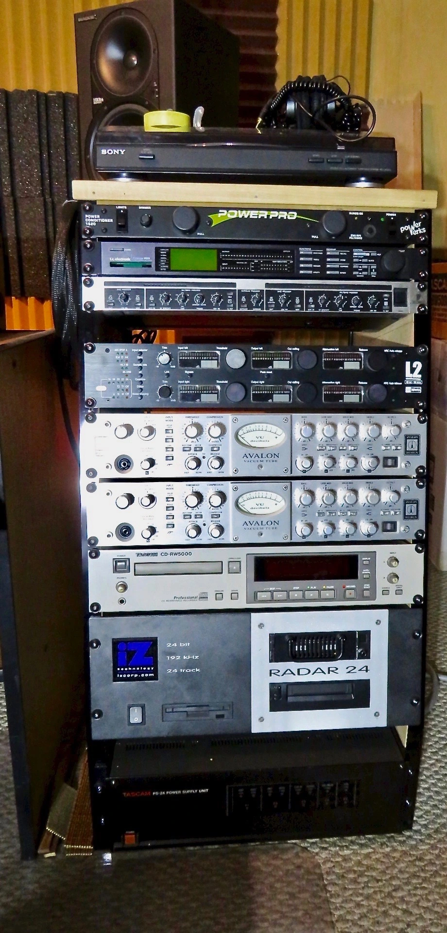

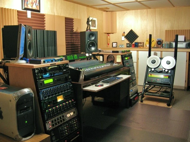

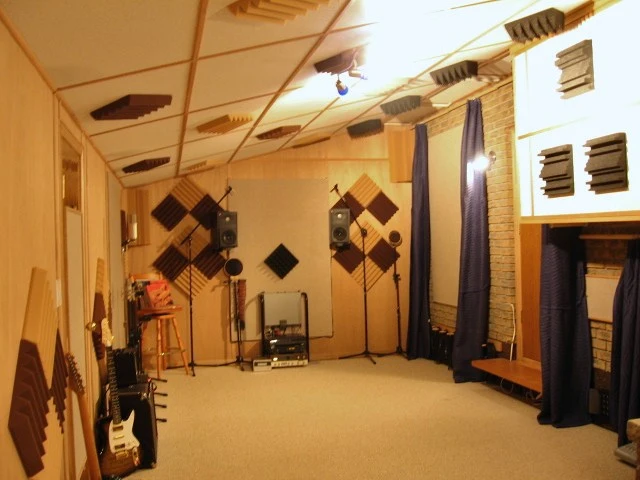

Here are a couple videos of my studio build from 2000. Some older pics with a few new ones showing gear upgrades. Perhaps it may be of help. Good luck with your build.
Control Room:
Live Room:
