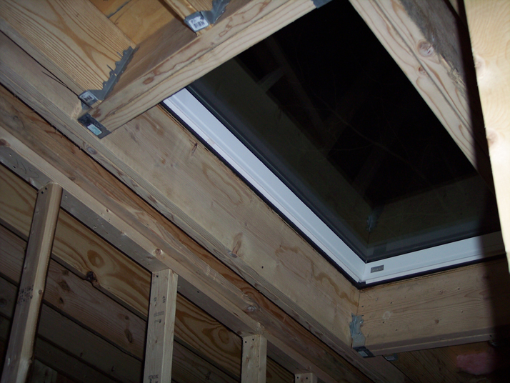

So the last three days were mostly about the roughing out the electric. Along with that, my skylight was installed in the back hallway, the roof over the bathroom/hallway was also shingles...so the entire roof is now 100% done. Also the siding has been underway, with the fascia/soffit work, and hopefully in the next week or so, in-between the holidays, the bulk of the siding will be completed.

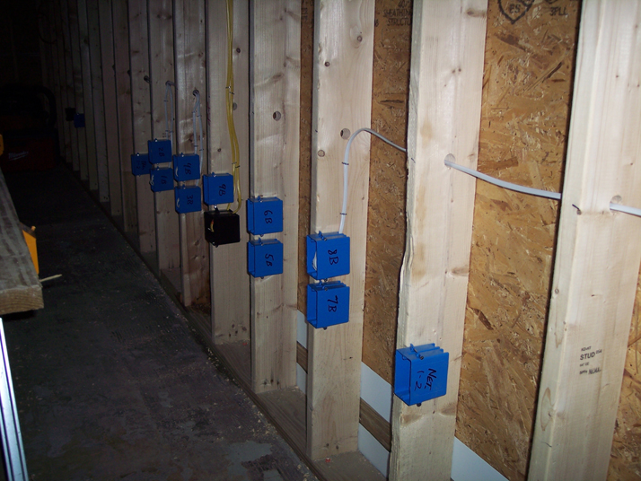

I also started my wiring of the audio power distribution...I still have some more to do (so does the electrician), but now waiting on my contractor to fur out the old wall to a 6" stud wall, since the old wall was only done with 4" studs. Once that's ready (he should be doing that tomorrow) the rest of the power lines will be run.
In the picture, the blue boxes are for my stuff...the black ones are the electrician's power layout. He also hung a bunch of lights, and ran some extra power to the 4 beams that will be exposed...so that at some point I can add some track lighting, or whatever, without having to worry about running lines.

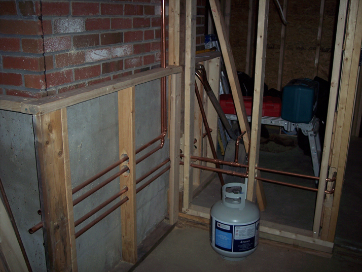

Other than that some of my plumbing has been roughed out for the bathroom and my baseboard heat...and I should have the shower base on Monday, so after that the plumber will come back and get that installed.

The skylight has nothing to do with the studio...it's in the hallway, next to the bathroom.

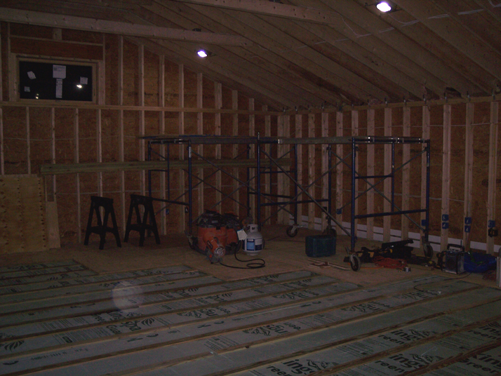

DAY 61

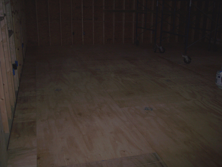

Today the sub-floor installation was completed. It came very well...and it's solid. With both screws and glue holding down the sub-floor plywood...it's like a rock.
When the hardwood flooring goes down, it's only going to get even harder...the flooring I picked out is more than 3X harder than oak.
I jokingly kept telling the installer I wanted it to be like a basketball court...and I think it will be.
Tonight I finished adding the two layer of foam backer rod into the 1/2" gap we left between the sub-floor and the walls, so it's completely decoupled around the perimeter, but of course, everything shares the common cement slab, though I don't expect for too much transfer via the slab.
My hardwood flooring is now arriving in a couple of days, on Tuesday...and it will sit in a pile for at least a month or more before it's time to install. There will also be the rubberized underlayment between the sub-floor and the hardwood flooring...so that will add another decoupling treatment, while simultaneously giving the finished floor a nice thick dead sound...none of that loud "clack" you get with a lot of wood/vinyl floors.
Picture is a bit dark...the temporary lights don't provide enough when it's nighttime, even with camera flash.
