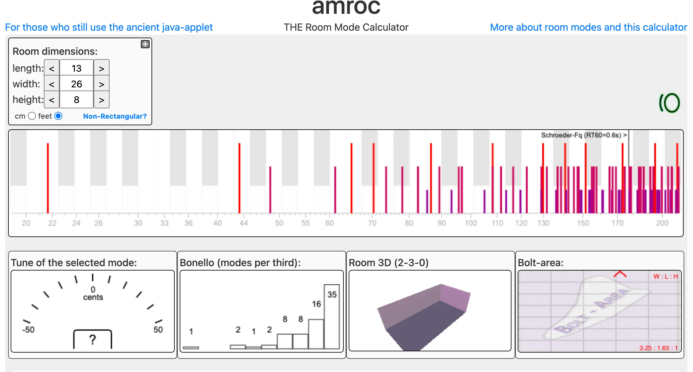

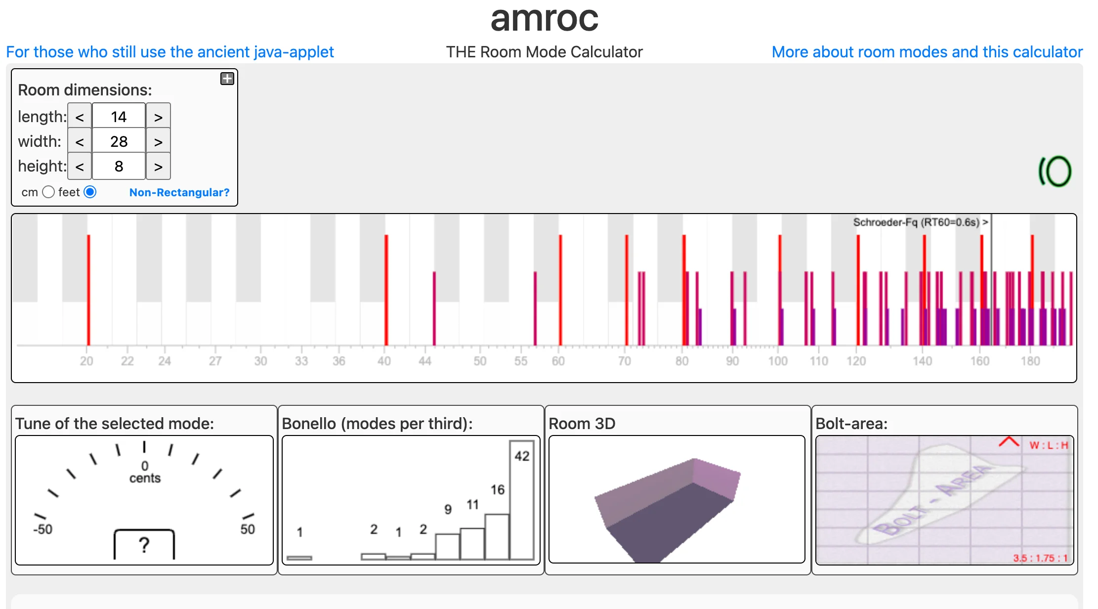

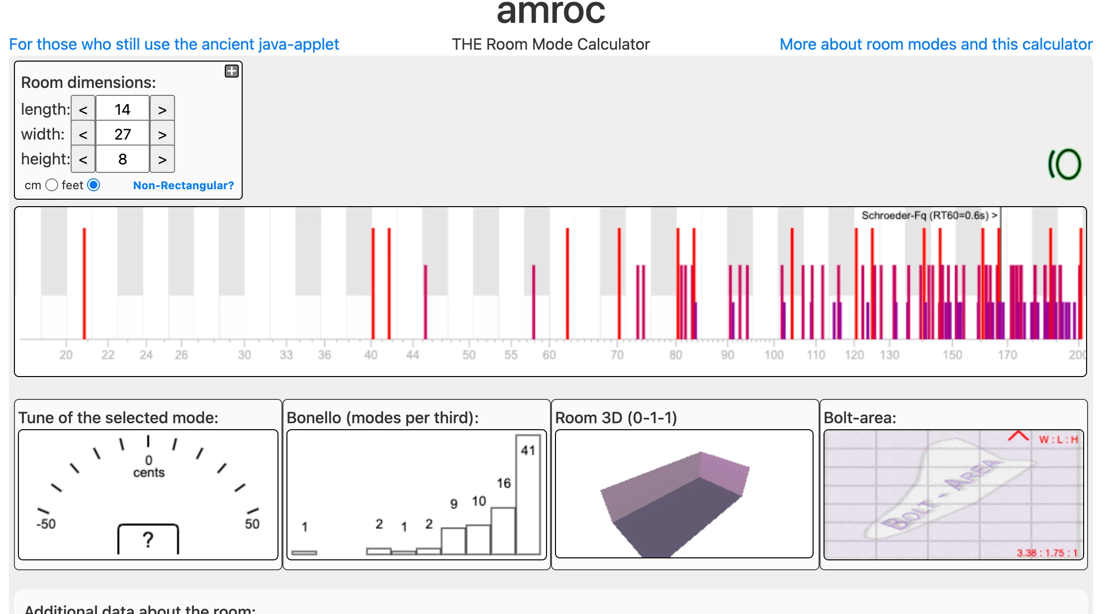

Let me ask you, why 14х28 is better, than 14x27, or 13x26 ? What kind of criteria do you evaluate to get the right choice? To my opinion, "a good room size" corresponds to these, which ensure a maximum number of stereo system position (with the point of control listening) among all possible points, where FR has minimum deviations in LF range. And this issue relates to the same low frequency sources and stereo distance between them, which can be varied too. To get these "acoustical room dimensions" you need to simulate the issue by REW, or CaraCAD or any good simulator. Of course, it may to use EQ or DSP for this aim for any set of room dimensions, however no need to say, that such a set is "good".
Unfortunately, these data are not very informative. The room's response to low frequencies is determined not only (and not so much) by the modal distribution, but also by other things: comb filtering, absorption, and the position of the source-listener system. The coincidence of modes or deep dips in the frequency response itself is not a death sentence.
