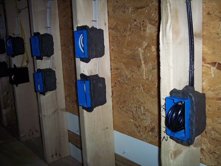

I've also completed running all my network lines and phone line, 4 of each, two per each of the long walls, which is more than enough. I could have gone with just two of each, but I figured a couple extra lines are easy to run now. I only need to tack down the lines in a few spots, and today I hope to run my TV line, which shouldn't be too involved.

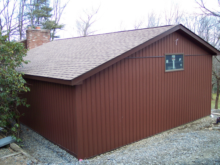

The big thing for today was that about 90% of the siding is now finished. The only thing left is the areas around the front/rear doors, which have to wait for the doors to be installed...and also the 4th, missing window needs to be installed and then the siding completed around and past the window to the end of the wall...about 10' worth.

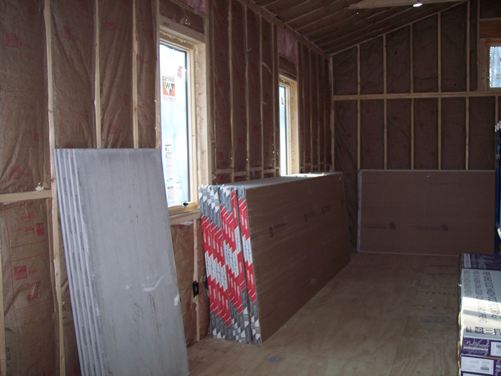

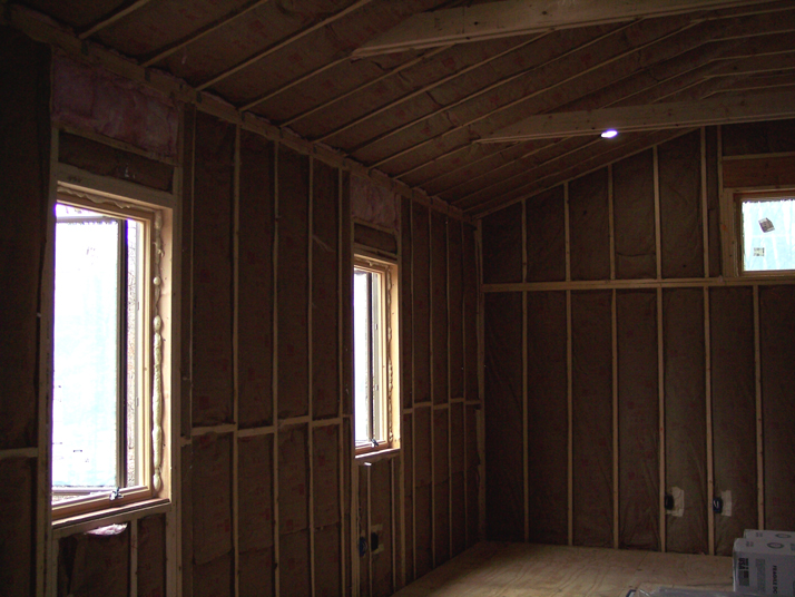

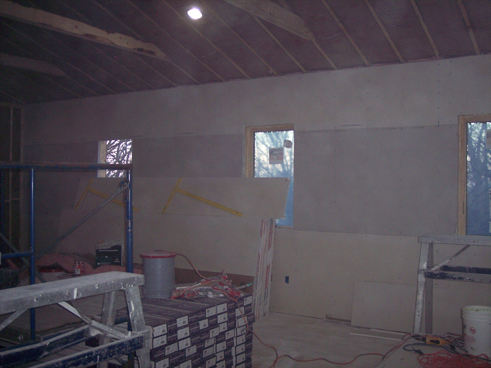

I was told the insulation sub-contractor would be here toward the end of this coming week...and then following that will be the drywall. We met with the drywall sub a couple of days ago, so he did all his measuring, and I'm expecting the drywall to be done by the end of the month or sooner. Also my HVAC guy should be back as soon as the drywall is done...and by then the electric and plumbing should be done too...so I think end of the month the construction will be about 90% finished, with only the doors to be installed and the foyer/bathroom floor tiled.
