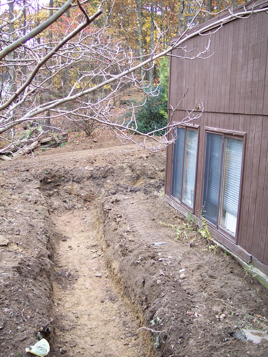

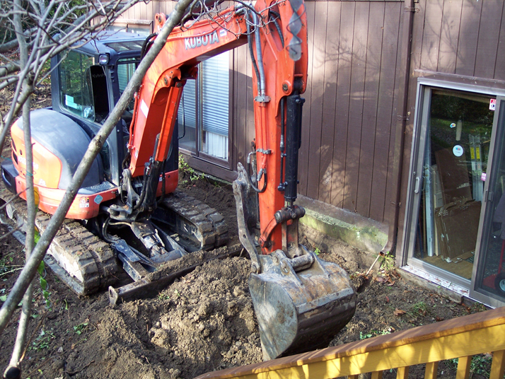

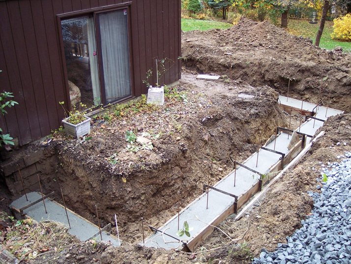

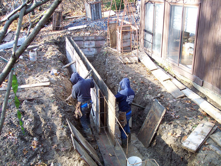

In my case, I needed a permit, but I also needed to get an area variance, because I was beyond the minimum side set-backs to my neighbor's property, even though the neighbor was OK with it. So I had to apply for a permit, have it denied...then apply for the variance, have it approved...then reapply for the permit w/approved variance.

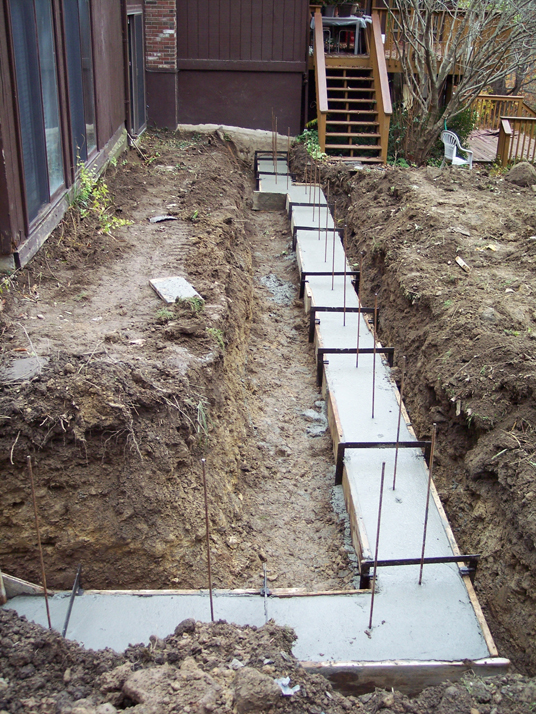

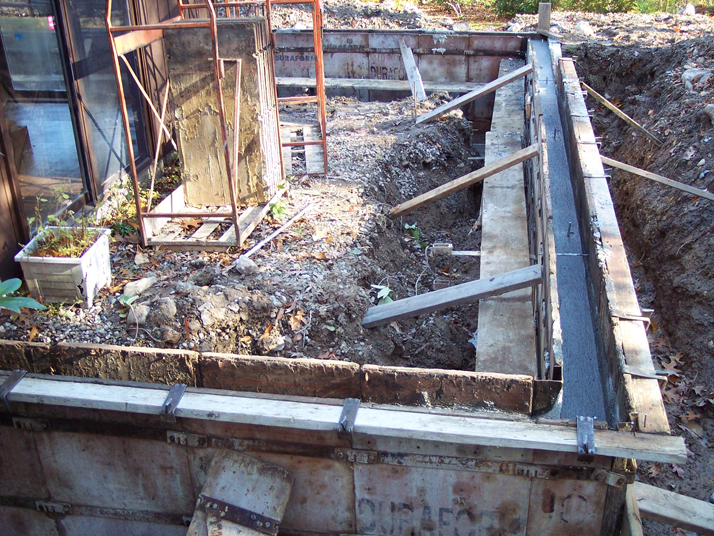

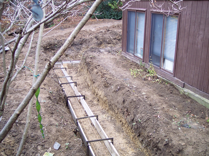

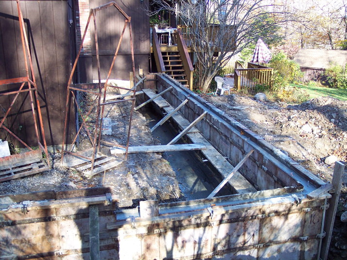

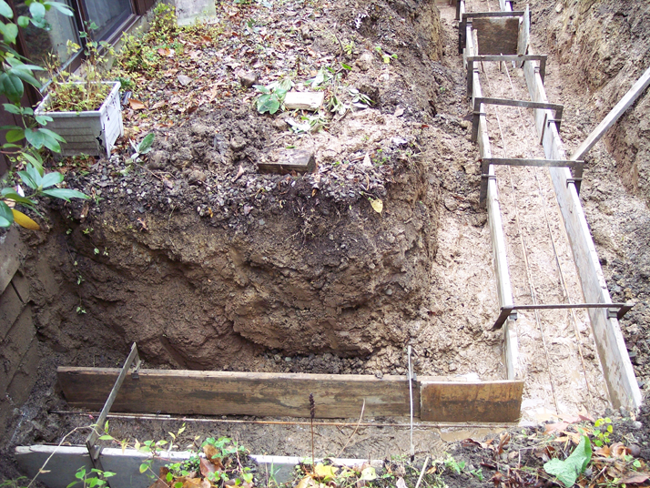

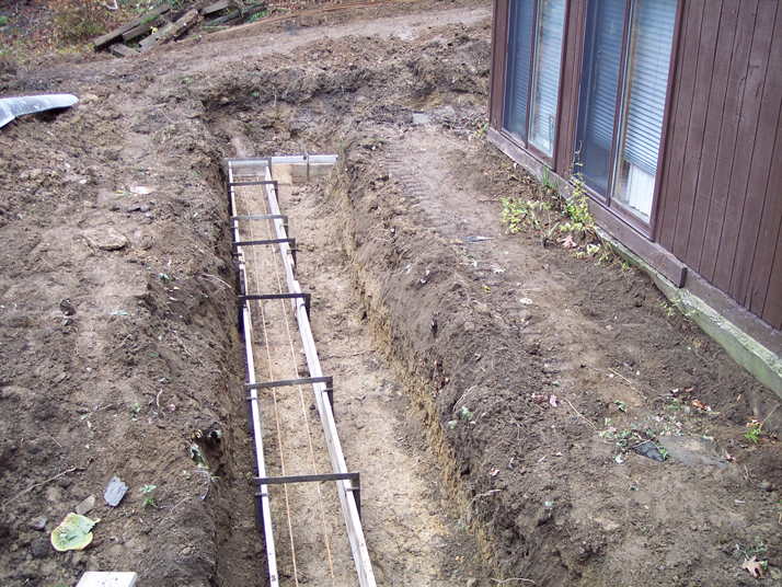

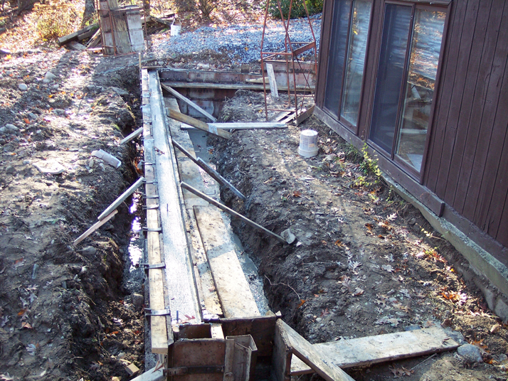

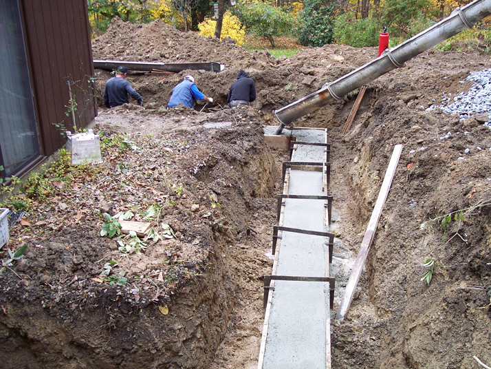

After they do the footings...the inspector has to come by and approve. Then they will put up the outer foundation wall, and again inspection follows...then finally the slab, and again inspection (I believe). After that there is the framing, and inspection...then the electric and inspection...and then the insulation and inspection...and then I think there is a final inspection before the Certificate of Occupancy is given.
So yeah, a lot of steps...but once I got past the variance, the rest is now pretty much straightforward, considering that I also had an architect do certified drawings and engineering specs, and my contractor is fully licensed...so the inspector coming by will be formality at most, and they all know each other, so probably little chance that there will be something not up top code, etc...but if anything comes up, the contractor will remedy as needed.
