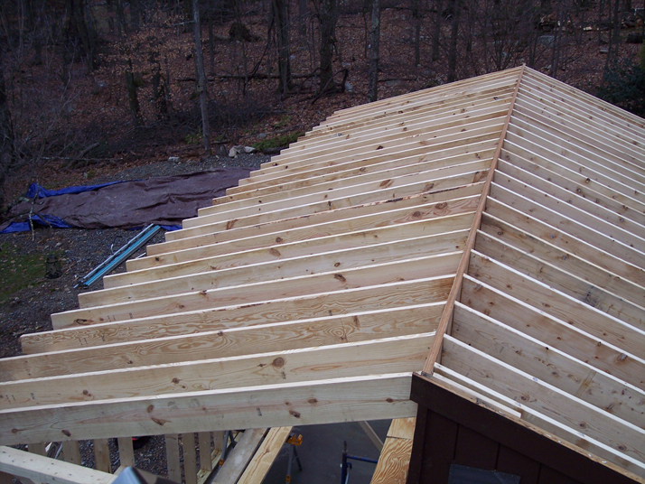

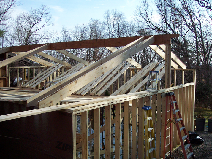

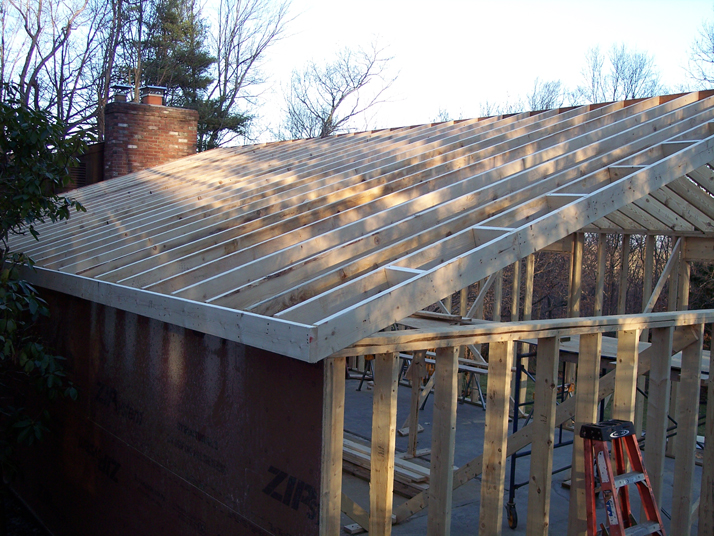

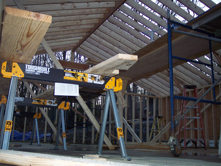

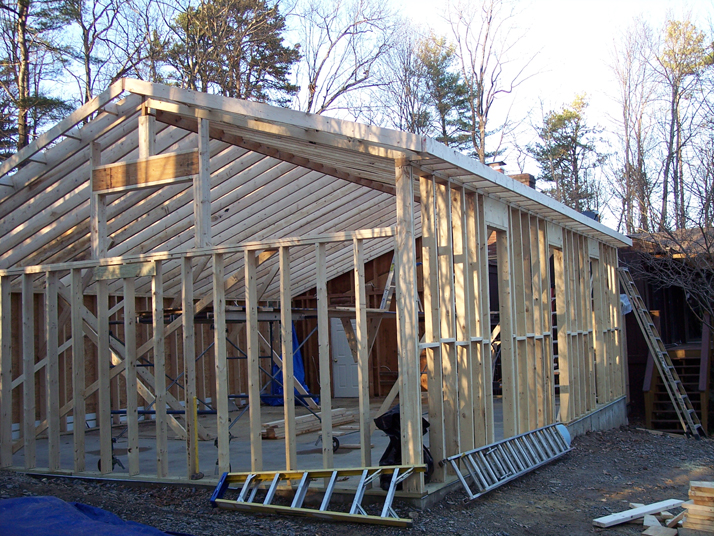

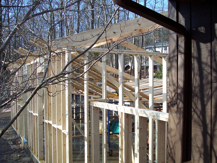

Cost wise, could  you simply drywall the outer structure the internal face, and get the things completely signed off. Then consider the internal inner room once the paperwork is complete? My inner room had no requirement for permissions or standards because there's no requirement here to detail internal mods if they are not considered structural? The internal room would seem to be quite a large span, so the ceiling timber work will need to be substantial. If you have the height, I'd still go for this if you  need isolation, but I suspect that  adding the  mass to the single structure on  the inside would approach the figures the two wall  construction would.
