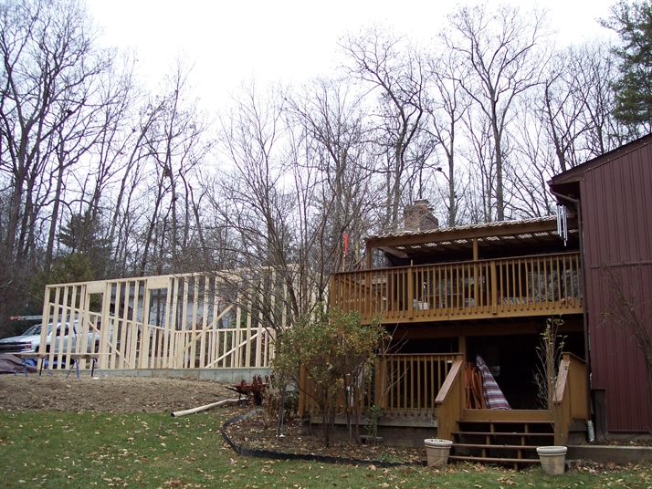

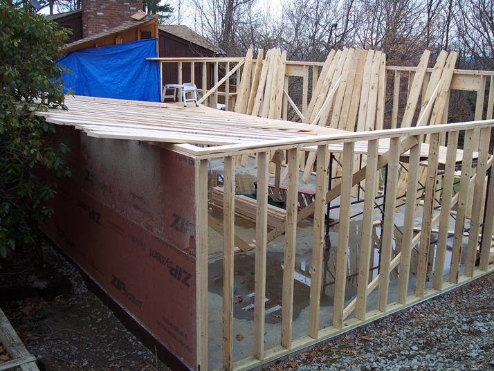

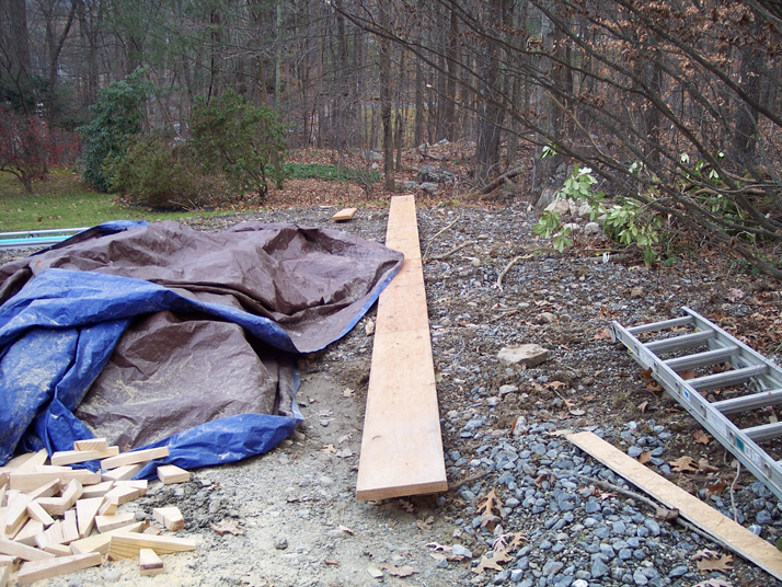

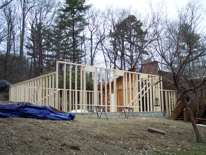

Yesterday with the rain, they only got some outer sheeting put up (those are coated "Zip" panels), and set up the scaffolding for the big roof raising. Today the rafters were all cut and prepared and the last picture shows the big 34' 2"x14" LVL ridge beam that will be hoisted up to support the rafters and roof.
The plan is to do that tomorrow, but right now they are calling for rain all day, so it might not happen until Monday.
