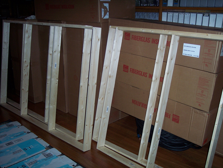

It's mostly used for when people don't want to use any wooden framing...and it works pretty good, but there's a longer drying time, and with 50-60 panels, it would take a lot of room to lay it all out. I am keeping that in the back of my mind as an option if my own approach doesn't work.
What I'm going to do is simply make a smaller wood frame that will slide into the actual panel frame with just enough space so I can pull the cloth in, and that inner frame will allow me to keep a tight pull on the cloth until it's stapled down. Then I remove that smaller frame and drop in the insulation panel...and I move to the next one.

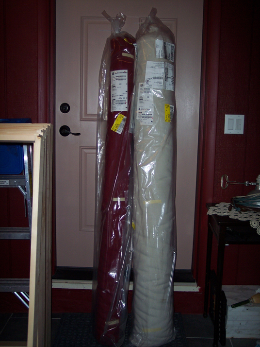

Of course...I will try it with just the insulation and see if I can pull-n-tuck the cloth and get it stapled, while keeping a crisp shape to everything...it might not be as big a deal. The acoustic cloth I'm getting is really good quality, made from polyester and the weave has no stretch to it...so it shouldn't be a fight to get it tacked nicely.
