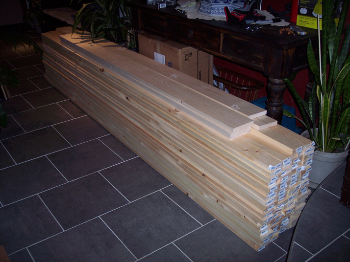

(71) 1" x 3" x 8' common pine planks
(9) 1" x 4" x 8' common pine planks
(4) 1" x 4" x 6' common pine planks

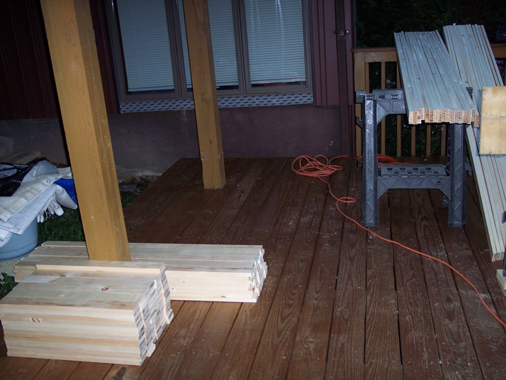

Hope to start building this weekend and coming week....and I will do some photo documentation as I go along.
