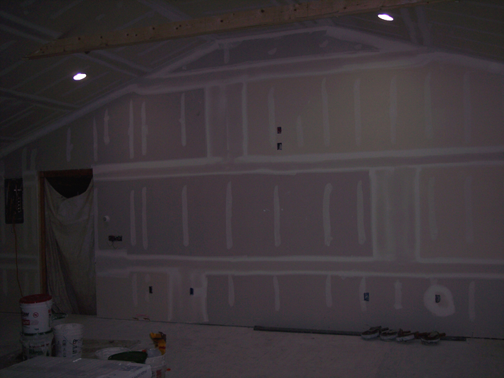

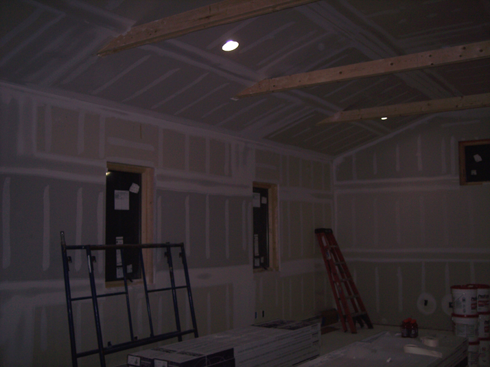

DAY 85
OK...it's been several days now without an update...but it doesn't mean nothing has been going on. :)
Yesterday the drywall tape-n-mud process began...and it should take a few days to complete. They basically do 3 passes...but they have to wait for each layer to dry before they do the next one, so it's down to how fast it dries. Then the final step is the sanding.
So for the drying to take place...this past weekend my baseboard heat was installed and hooked up to my furnace. Not the new studio has heat, along with the foyer and new bathroom. The plumbers spent about 4 hours on Sunday cutting the new lines into the existing system...also adding a 3rd zone (studio).
Today also my last window was finally installed, and I expect the back door will be installed in the next day or two, and they will then finish that siding around the back door. My front door came in wrong...so it's been reordered, and I should get that in a couple of weeks...in the meantime, I hoping to see the tile work kick in as soon as the drywall work is finished....unless my contractor decides to first paint the walls, and save the tile for last.
So I'm thinking maybe 2-3 weeks it will be done...with only the hardwood flooring left to do (2-3 days work), and some finish trim around windows and the baseboard, plus the 4 large "beams" that run across the room. I'm hoping that end of Feb, all that will be finished...which gives my two months to do my gear move and installation, and final touches, etc...and I hope May 1 it will ALL be done!
those pictures look like what I see when I wear sunglasses indoors :D
It's the crappy LED lights the electrician put in temporarily...they're low-wattage, and give off that ugly blue/gray light, and since the room is large, my camera flash isn't bright enough to fill the room.
It's better when I take them during the day, and then I get the additional sunlight in the room.
