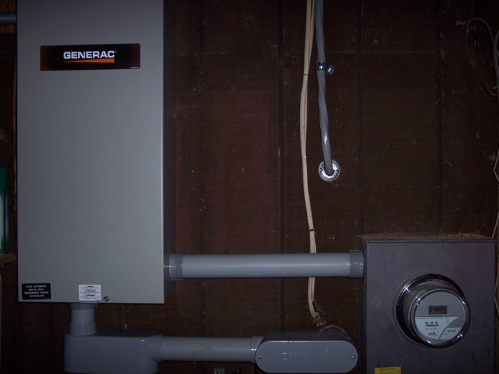

The other big job was the replacement of my house generator transfer switch. I had installed a permanent house generator several years back, and at the time, the transfer switches were somewhat limiting, where I had to select only a certain number of circuits to assign to the generator, since the transfer switch had individual breakers. During the construction, the electrician and I talked about the generator, with me saying how I wish I could add the studio, or part of it...and he suggested we replace the transfer switch with a whole-house....meaning, rather than having individual breakers, the new transfer switch would be tied directly to off the electric meter, being the first in line...and then my house breaker panel, and the new studio sub-panel would both become sub-panels.
I always figured I would need to replace everything, including the generator...but as it turned out...I didn't, and so we replaced the transfer switch only.
I still have to consider how many things I can power up during an outage, since my generator has its limit (15kW)...but at least I don't have to be stuck only with specific circuits tied to it. At some point, if I want to go to a bigger generator (like 22kW), the new transfer switch would not need to be replaced, only a heavier wiring harness to accommodate the added kW.
So it all came out really well, and now all my house and studio circuits have access to the backup generator...which is great.

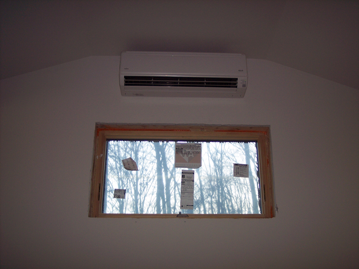

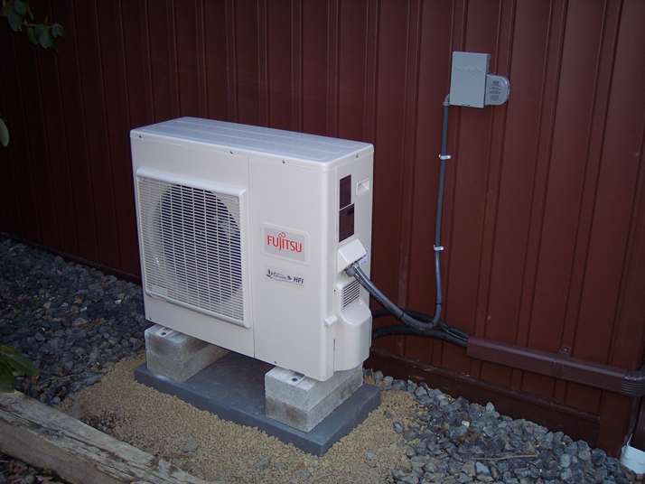

Today they installed the mini-split AC/heat pump unit. I don't know why they call it a "mini" split...the unit is pretty damn big! :D
It's a 2.5 ton compressor (put that on your guitar tracks ;) )...it's quiet as a mouse, both the outside unit and the inside unit.
I can't wait to see how this cools when the weather gets hot...but I'm expecting it's going to do a great job, since it's a bit oversized for the space, but I wanted to make sure it could keep things nice and cool in the dead of summer when I have a good deal of my audio gear on. In my old space, the central AC was pretty adequate (much smaller room), but on the real hot/humid days, if I had my console and tape deck on (the big heat generators) the room would get warm after a couple of hours if I was in there during the mid afternoon...so I always avoided that, or I avoided using the console and tape deck during the hot part of the day.
This new AC unit and new room will not have that problem.
Today I had it on heat, and it certainly kicks out a good deal of it. It will be really nice when I get the two ceiling fans installed...they will move the air around the room quite well. The AC unit also has a dehumidifier mode...so you can suck out the moisture without running the cooling...so it will be a great climate controller for the new studio.
