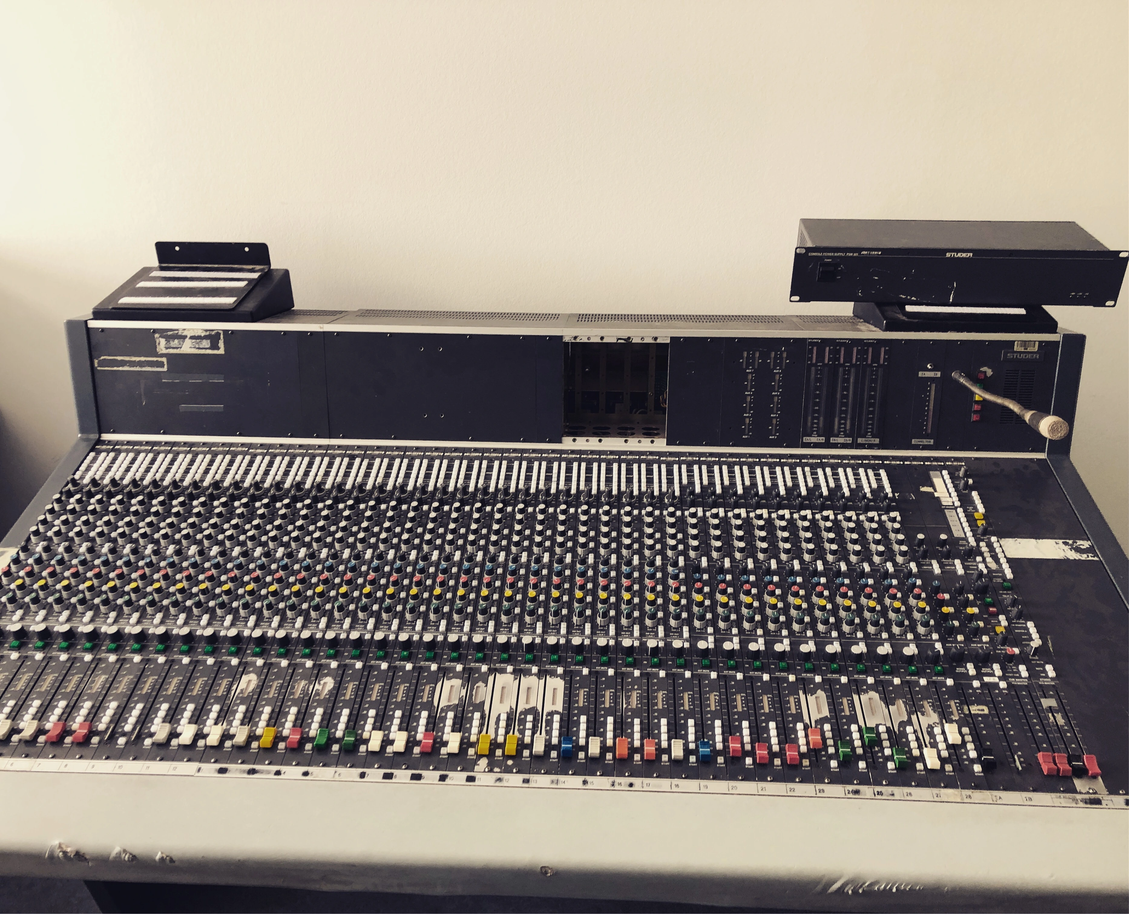

Oh I saw that one for sale...it looked a bit had...but it’s okay?
It looks kind of used, but this is all visual, just some missing colour.
And it didn’t come with a manual, correct?
No manual, but as you know, you can find it on the internet.
No mono group modules but 30
![EEK! :eek: :eek:](/images/smilies/eek.gif)
of the mono input modules, and 10 of the stereo input modules too, yes?
No groups, but perhaps I will try to find some, or try to build some in the future ![Big Grin :D :D](/images/smilies/biggrin.gif)
and yes, a insane number of mic inputs

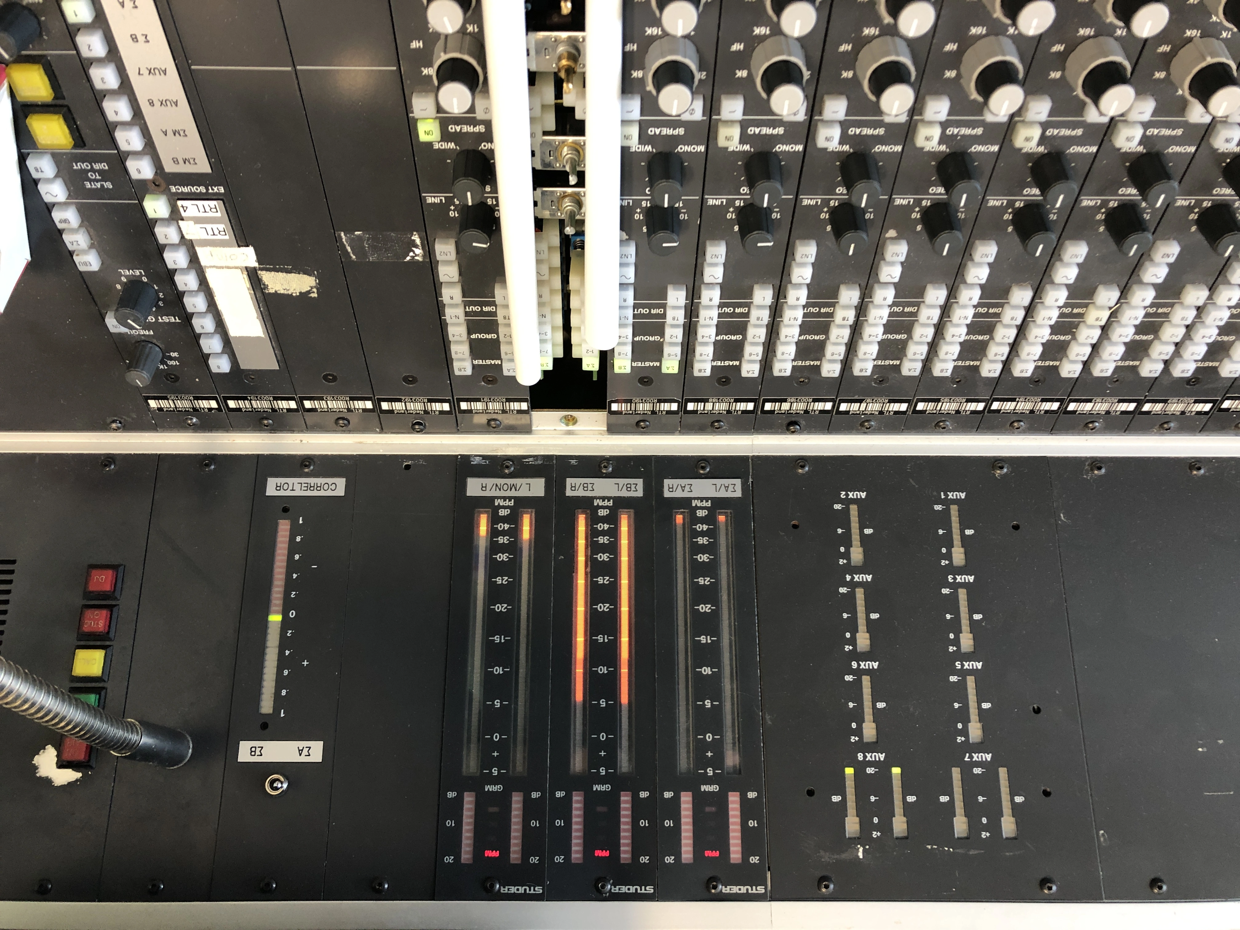

What meter modules are loaded?
Sum A, B, Monitor Plasma with gain reduction and Aux led meters, and correlator
And it looks like yours wasn’t outfitted with the integrated patchbay?
No internal patchbay, but i think from what i read it would be limited in use for me...

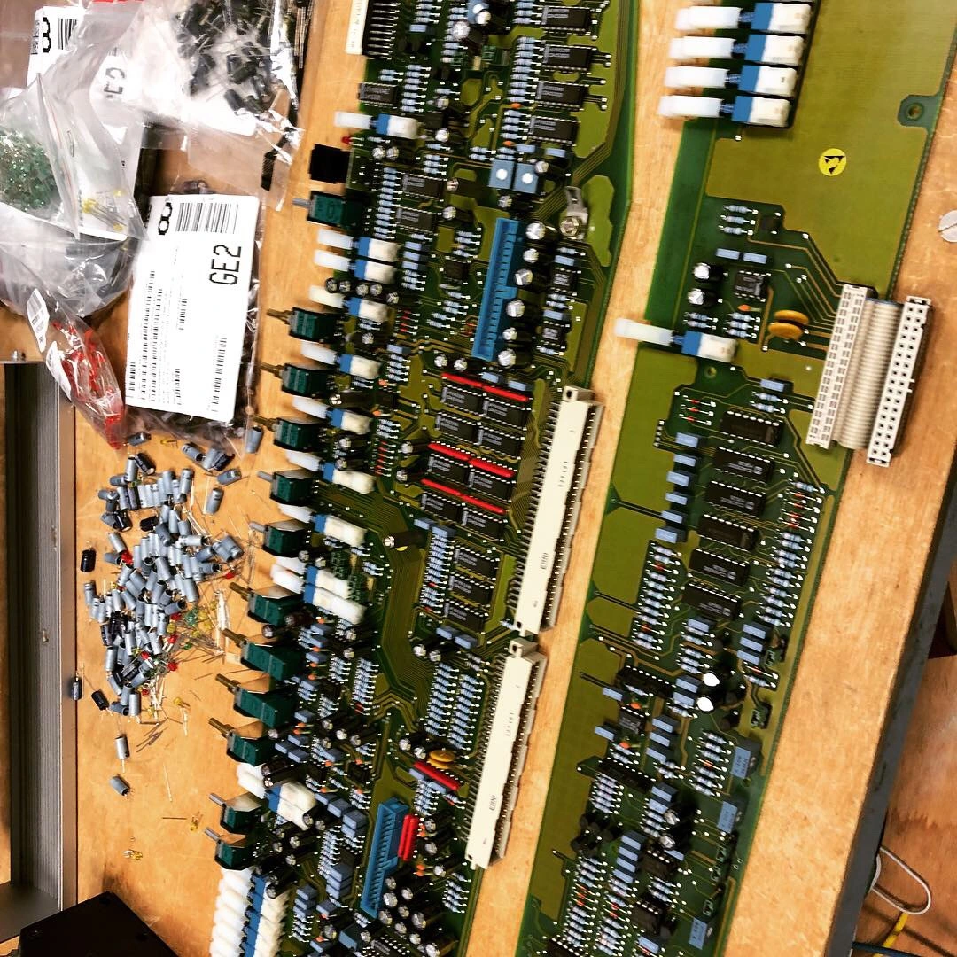

there are two of them. but they generate a high amount of line noises, so i will replace them at some point.

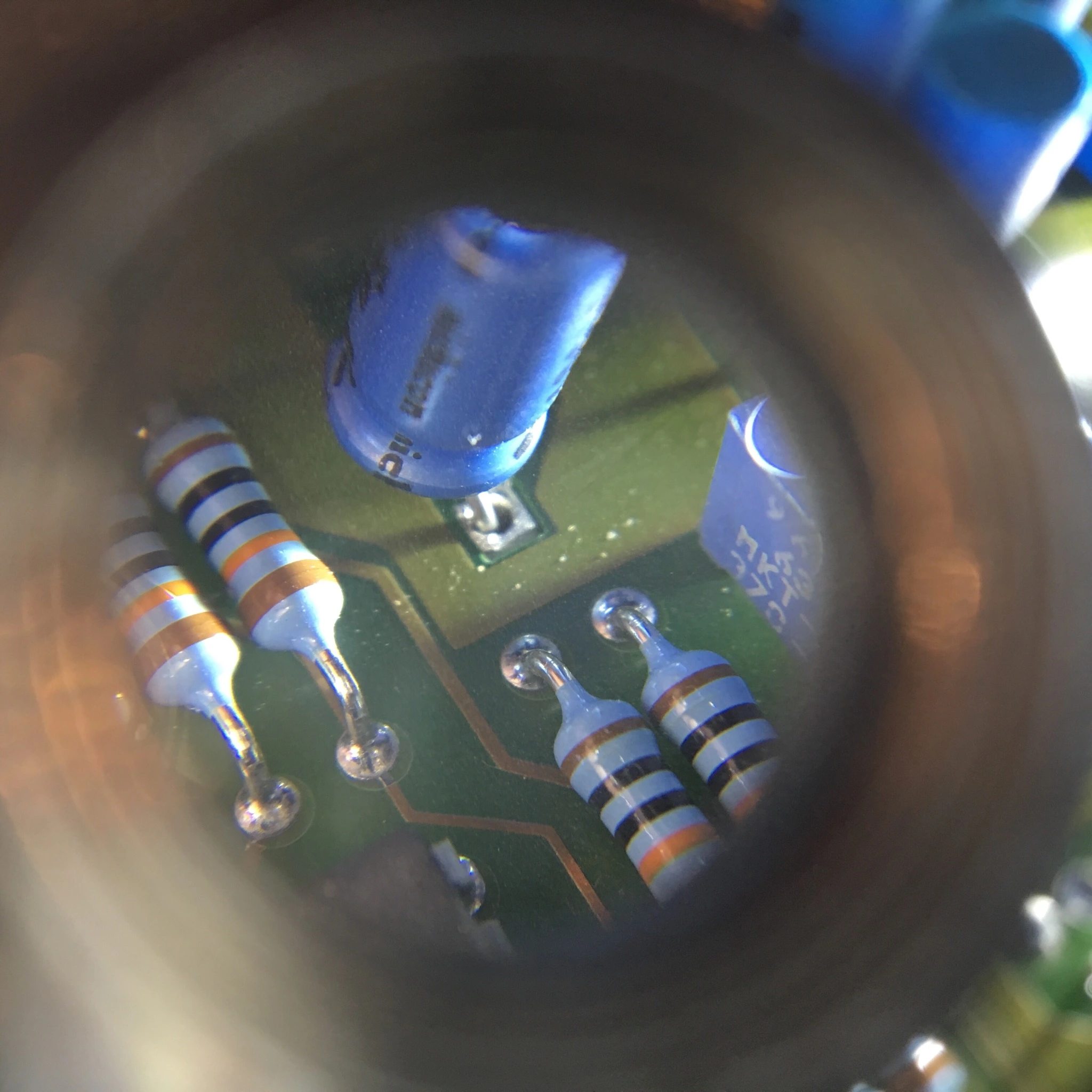

I’m curious why you increased the voltage rating. From what I see the voltage rating of all the caps is very appropriate. I was schooled that going too high above what is called for by the power rail is not necessarily beneficial and potentially detrimental. A good safety margin is wise, but that’s what I was seeing as far as what Studer specified. What are you seeing?
A colleague here at university (member of the digital signal processing group, i work at the chair of communications engineering btw) who had done some testing recommended this. Higher voltages reduce distortions. so i didn't compared them a b with same and higher specs, just chose one step higher...
Every coupling cap, or literally every electrolytic cap?
I think it would be sufficient to just search for the coupling caps, i don't know if or how much of a different this makes, but i bypassed/will bypass every electrolytic cap. Yes, thats another 3500 caps

One of my stereo input modules was recapped last year by the previous owner with Nichicon KA 105C caps...I can’t hear any difference between it and a stock module.
I don’t plan on doing any recapping for some time even though the console came with all the caps to do the whole console...the aforementioned Nichicon 105C parts..KA series are “audio-grade” for what that’s worth. Your post does make me curious...might pull some sample stock caps and measure to be sure.
The same colleague was at an intership at Studer during studies in 2002, one of the enineers at studer told them the Phillips electrolytics weren't the best caps, and they replaced them somewhat around 2000. I don't know the exact sell date, and i did not remove every module so far, but the ones i saw seem to be produced 1997 for the stereo and 2002 for the mono inputs, so no more light blue phillips any more on the latter. (ALL inputs are transformer coupled btw)

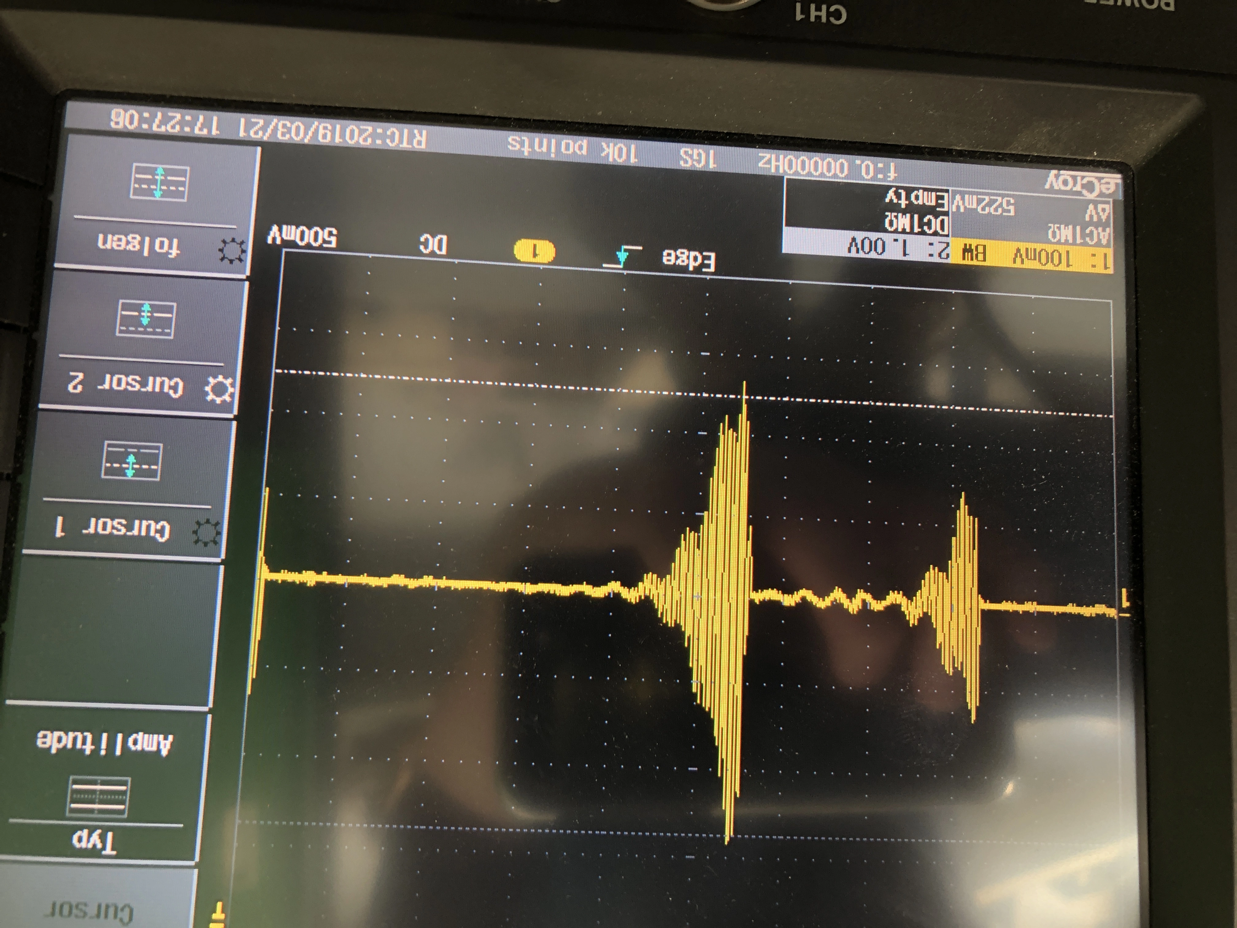

At some point i will capture some measurements as well, since we have the equipment
