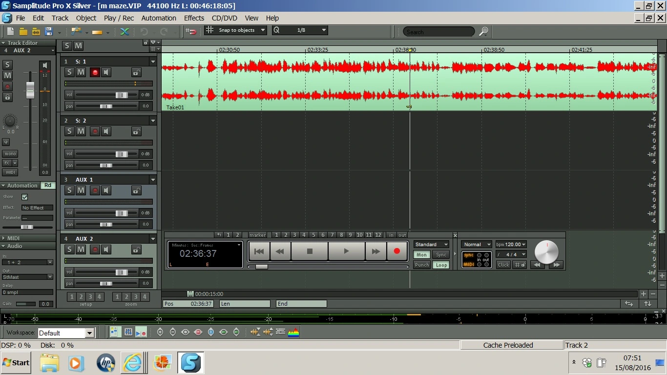

Most DAWs default to a two track recording "stereo" if you will although you can usually set them up for multiple mono.
Attached is a stereo recording (BBC R4 rip) and you can see that each track is slightly different, two voices, two mics in different points in space.
If I were to modify that recording, EQ, compression, di-da, the DAW would treat it as a single entity and apply the modification equally to both channels.
If it were two MONO tracks (which would work equally well for stereo playback) FX would happen only on a track by track basis.
The top multitrackers and mixing men here will surely give further insights?
