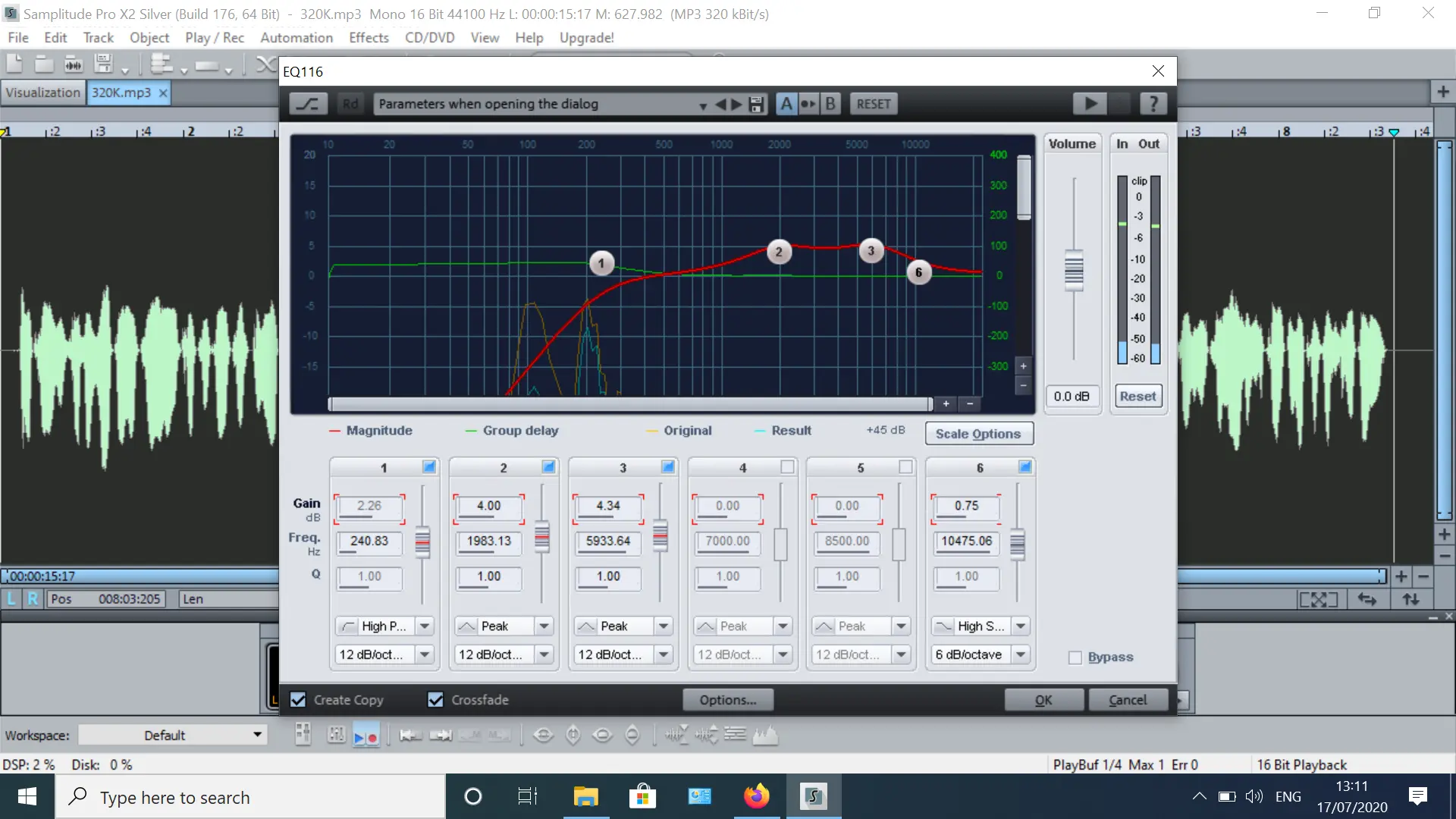

I have taken the liberty of modifying your clip. I found it very 'muddy'.
I have applied a quite severe bass cut (HPF) and (for me) a little upper boost. Now, as I think I have told you, I am clinically deaf so my modifications will probably be a bit extreme compared to other tastes. I still cannot make out what you are saying but at least it is clearer!
You can make these corrections on the mixer and IF it sends them out via USB then you don't need the 2i2. But, if you find you do need the EQ etc on the mixer than you need to keep it. You cannot do this, in real time with that Focusrite interface.

Pardon no, I meant ATTACH an MP3 as I have done.
Laugh?: "It is wicked to mock the afflicted" Heh! No matter but yes, I am deaf and have the digital aids to prove it (but I only wear them for conversations and that not a lot)
I have modified the '320k' sample and shown the EQ curve I used. Samplitude SE8 has a pretty crude parametric in it but then I am not making records for EMI!
Your friend said the mixer track was "boxy" ? May have been too much compression. I understand that can make things a bit duller? I suggest you use just a hint of compression to stop you going over the top. For the clips you have posted so far you need none!

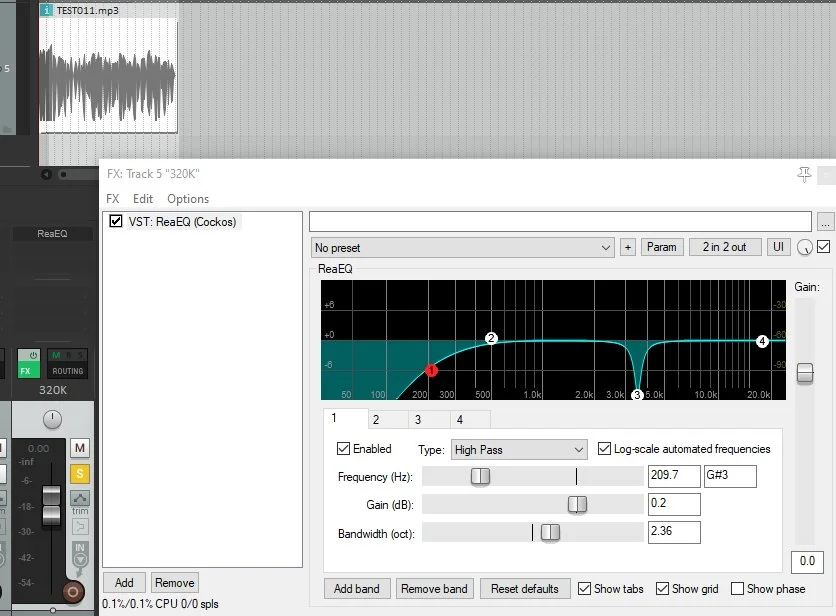

After listening to your various files, plus the modification that Dave posted, I think Dave is on the right track. You have a particularly strong resonance around 100 - 150 Hz. That is giving the voice a very "boomy" sound. A roll-off starting at around 400 Hz will remove that bass from the voice. You can play with the amount of bass reduction, but you should make sure that what you are using to monitor the sound is giving you an accurate information. If your speakers or headphones are not reproducing the low bass, you may not hear the effect.
I also noticed a fair amount of sibiliance, which seems to be very common in the French language. A narrow peak reduction at around 3500 Hz helped minimize this.
Attached it an adjusted file of Test11, similar to what Dave posted but not quite as extreme in bass roll-off.
View attachment Twinky Test11 Mod.mp3

Ooo! I like that Rich! You have sucked out "the boom".

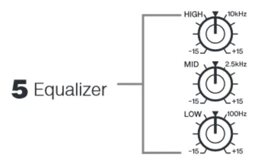

I'm not exactly sure to what 2H and 10H is referring. If you are using the MG10XU tone controls, I would engage the HPF which will drop down at 80Hz. The low tone control is a low shelf type centered at 100 Hz, and I would roll that down to -5 or -7 to start. You could go down further, depending on your taste. It will depend a bit on the slope of the shelf. I don't find anything in the specifications as to the slope of the shelf, but the HPF is specified at 12dB/Octave at 80Hz.
I would be a bit careful adding in the Mid band frequency. 2.5KHz is close enough to the 3.5kHz sibilance peak. It may accentuate the "s" sounds. You can add a bit at 10k to add some "sparkle".

Twinky, you appear to be using the Yahama MG10XU.
On that mixer, there are three tone controls, High, Mid and Low, plus a Hi Pass Filter (HPF). When the knob is centered on the each tone control it is in the zero position, as in not doing anything. Turning each knob will adjust the sound from -15dB cut to +15dB boost. There are numbers on the knob, showing -15 and +15. Each division is about 3dB
When you said the knob was at 2H or 10H, are you talking about 2:00 on the clock face and 10:00 on the clock face? 2H would be a boost of about 5-6dB which would make it sound very boomy. If you moved it to 10:00 on the clock face, that would be about a 5-6dB drop in the response. That's much closer to the response you want to make it clearer for the listener.
