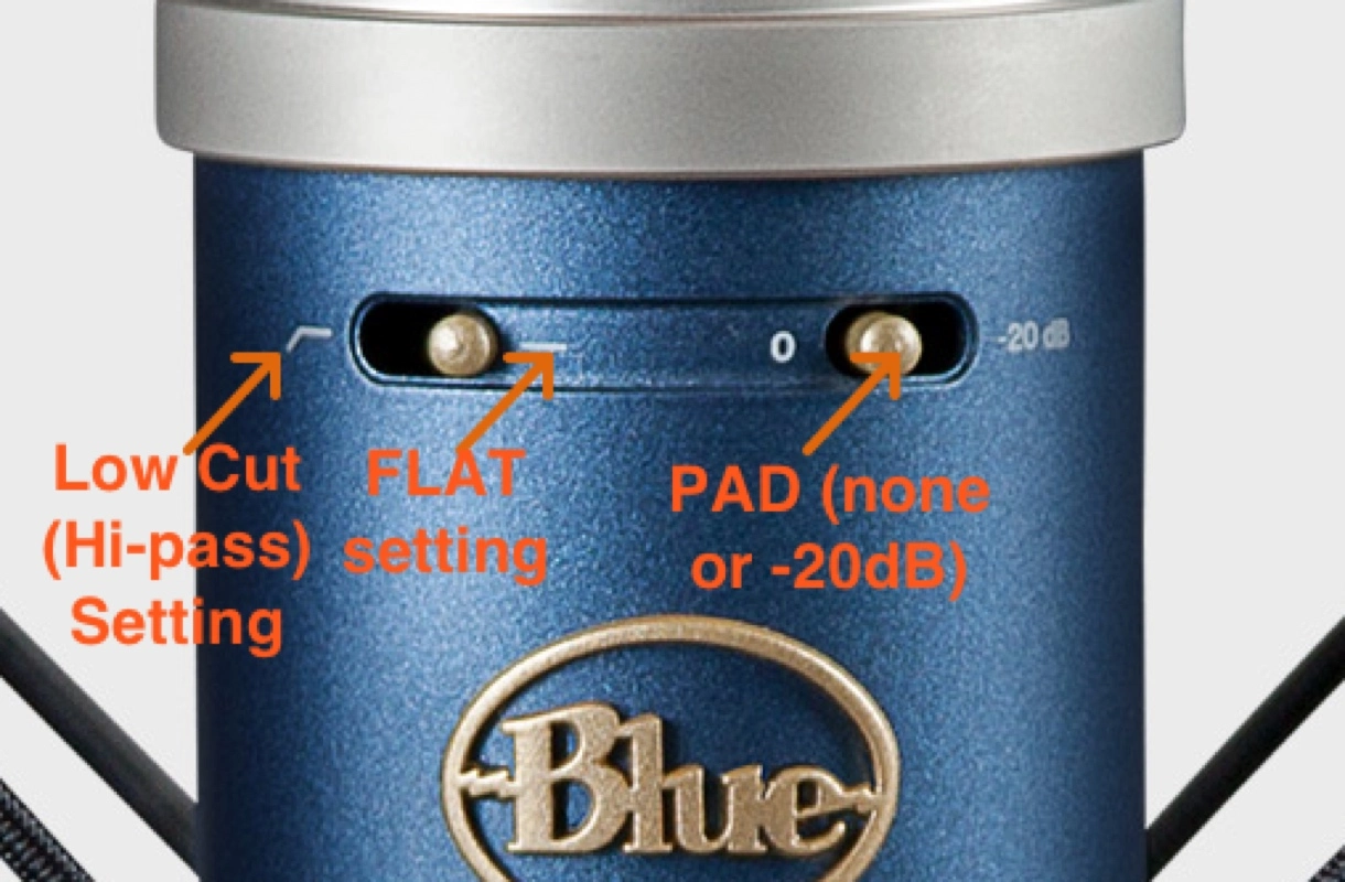

So which one did I have on the blue bird sl? The low cut (the horizontal bar?) and on the yamaha it says high pass but I guess it's the same as the low cut if they're the same.
And the down curve on the left, what is the name please on the blue bird sl?
Horizontal bar is *no* cut. The "down curve" is the setting for the high-pass (low cut) filter.
Blue - Bluebird SL

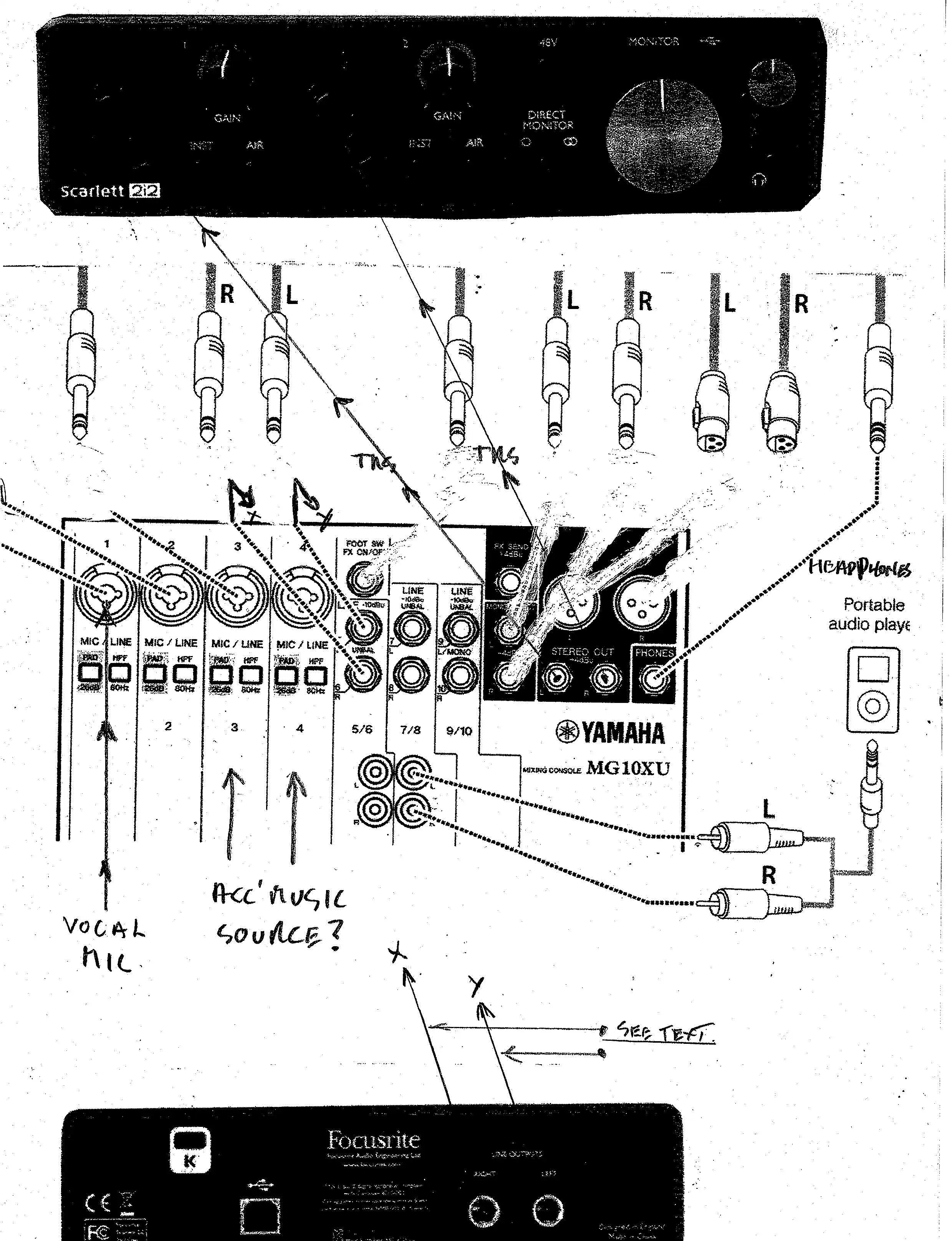

2) I have attached a diagram I did for a soprano here who had similar problems. I hop you can follow it?
The mic (or mics) go into the first one or two mic inputs on the mixer. You then set gain, bass cut, compression etc in the mixer channel and you can monitor all this via headphones on the mixer. Levels will also be shown on the LED meters on the mixer and you can use the master output control to adjust this. Note, you won't want a lot! -10dB blipping to 0db (VU) will probably be enough.
The Main Outputs of the mixer are carried to the inputs of the 2i2 by two (yes, you need two even for ONE mic!) jack to jack cables. These cable need to be 'stereo' like you find on headphones but of the larger 6.5mm type. They are properly called "balanced Tip, Ring, Sleeve" cables. They can be almost as long as you like.
Settings on the interface: As said above, keep the level out of the mixer quite low. Advance the gain controls on the 2i2 and, for 'normal' recording you would aim for a signal around -20dB fs on the DAW. I understand you will need a bit higher than that for streaming but keep the gain of the 2i2 low, maybe even at minimum, because there will be plenty of drive available from the mixer and you do not want to clip the F'rites inputs.
Keep coming back if you still have questions. I am retired and have plenty of time.

Why the jack cables?
Because the microphone will be plugged in XLR on the mixing desk? And so to send the signal from the mixer to the soundboard or the opposite, I don't know, you have to plug in the jack cables? And thanks to that, the sound card will be better on the table?
All I understand is that the scarlett has a better sound card okay.
I saw that it was possible and clean to have just a mixer (like the yamaha you mentioned) with the SM58.
But it's true that I have a scarlett so I might as well take advantage of it and it will be better!
Speaking generally you need a microphone preamplifier and then analog to digital converter, to get microphone input into a computer.
All-in-one-interfaces have both of these built in and, often, also have inputs to let you bypass mic preamplifier, for plugging in 'louder' devices...keyboards, digital music players, etc.
With these interfaces, and mixers, XLR generally means microphone input and 1/4" plug generally means line-level input (or instrument level).
Generally microphone inputs have a gain knob where line inputs do not. (just for a clue...)
In your current set up the Focusrite serves as mic preamp and converter.
In a mixer-based setup the mixer would effectively replace mic preamp, but continue to use the focusrite converter.
For that reason we want to plug into a line-level input on the focusrite.
The path is microphone > XLR cable > Mixer mic input ---- Mixer line level output > 1/4" cable > focusrite line input.
If you choose a mixer which has eq and compression, this will give you the same set up as you had before but with that additional functionality in the analog domain.
I.E. your voice can be made to sound louder (decreased dynamic range) and clearer (careful eq) before it gets to the computer.
PS. I'm making heavy generalisations for simplicity here.
Always read labels + manuals for certainty. :)

TISINO 6.35mm Jack TRS to TRS Stereo Cable, Heavy Duty: Amazon.co.uk: Electronics
They ^ are the cables you need. Later I shall draw you a simpler diagram and see if I can put some French in it!

I'd really like the sound of the blue bird sl "flat setting".
Even if yes, there is only the high pass but it may be possible by making adjustments on the mixing desk.

I thought of that Mark but we is having trouble getting mixer to interface! * Twicky, surely you have a phone? Even my ancient nokia 201 delivers quite passable sound quality from the headphone socket. My Sony 10 smartphone is even better.
You sort out the music you want on the PC and then zap it to the phone via Bluetooth or you can take the Micro SD card out of the phone, put it in a USB 'reader' and dump the music that way. If the phone does internet, email it to yourself.
Now, The Bad News!! You will need ANOTHER cable ("sacre bleu!" he say) This time 3.5mm stereo jack to two 6.5mm MONO jacks (another handy cable would be 3.5mm stereo jack to RCA phono plugs, 2 off)
You have to face it I think, this audio game IS complicated and hard for some people to get their head around (le tete) and you will end up with a serpents nest of cables. My son is a brilliant musician. Main instrument guitar (rock, jazz, classical) but is several handed and well versed in theory...but! He is always asking his old dad for help with electronic/audio concepts that I find second nature. By the way, I can no longer play guitar for toffee!
Going to get on with you diagram.

You mean this?
