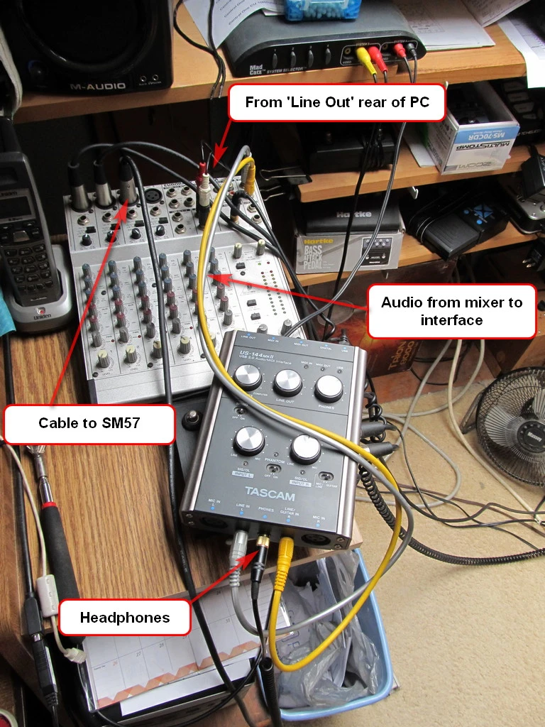

Quickly setup with SM57, Tascam US-144mkII, old Behringer MX 802A mixer, and Audacity to record. Mp3 played back from MS Audio player through PC line out. Attached mp3 clip. Did not tweak levels after recording.
(The Metz Catz video distribution box is how I select where I route where the PC line out audio goes to. Cheap is the key word. :D)

Ah yes ok, the volume is different from mine, there's no photo ahahah
That's a lot of boxes!
It sounds cool and the music on the side, great!

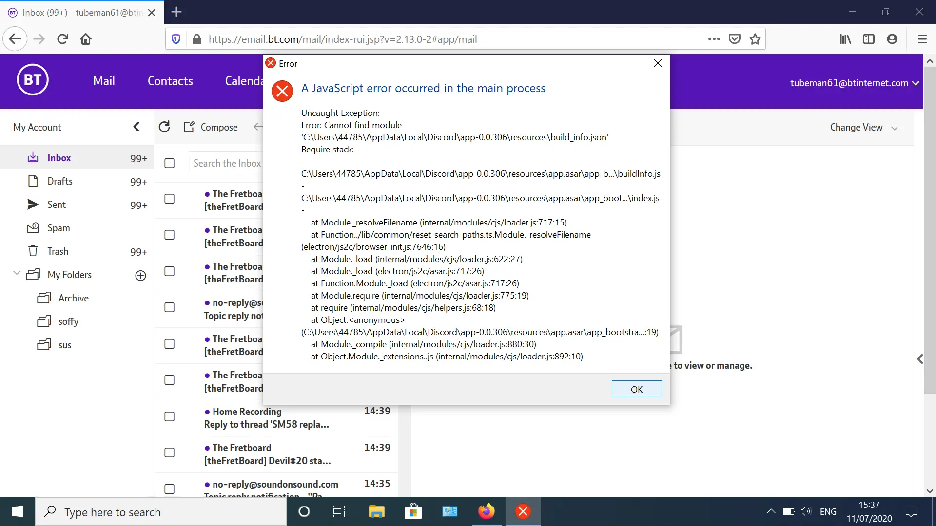

I thought I would install Discord and have a look. Would not install, two angry red crosses.
Then when I next booted up this laptop, got the attached. Related?
All Greek to me.

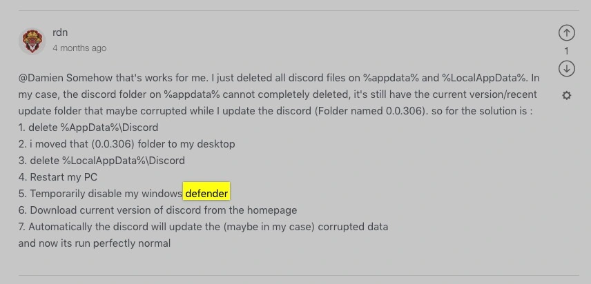

Found a couple of threads suggesting delete 'Discord' folder from localappdata and appdata (path shown in error) then reinstall Discord.
Hopefully that sorts it.

From what I can gather it's more likely to be overly-aggresive AV software or something like that.
