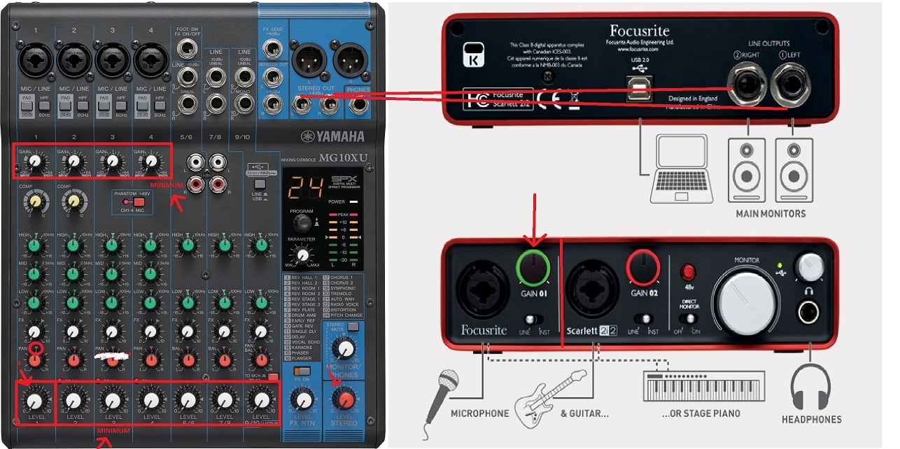

No, not XLR cables. TRS jack to jack cables as per my drawing from the mixer's Main Outputs to the line inputs on the 2i2.

Would it be possible if it's not too much to ask to surround the inputs of the mixing desk to put the TRS cables? On the drawing you made, I didn't quite understand.
Oh yea? But then I do what you told me? I connect to the foscurite and I put the gain of the foscurite at minimum (0)?

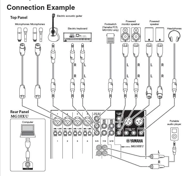

What TRS cables to inputs are you speaking of? You have TRS cables to connect the mixer 'Stereo Out' to the left and right inputs 2i2. The other cable to connect the PC Line out to an input to the mixer is not/shouldn't be a TRS cable.
Typical connections are shown in the users guide which you should have looked at by now. The 'Electric Keyboard' would be typical of a stereo input connection as shown in the users guide.

The jacks you want are in the extreme right of the mixer, in the Blue area and underneath the male XLR outputs. Now, setup will be a bit protracted but easy once you have got it. The mixer first.
Turn all the channel level controls to minimum.(white caps) Set the Mix out control (Stereo Level 23 on the crappy user sheet) to 4. Plug a microphone into channel 1 and set the Level 1 (white cap) to 4. Talk at the mic then set the mic gain to get the LED meters to give about '0'. Set ch 1 Pan to centre if you want the mic in both channels.

'Electric Keyboard' has nothing to do with connecting the mixer to the 2i2. 'Electric Keyboard' was in reference to the connection of the PC audio outputs or any other stereo input connection.
Look back at the picture I posted of my mixer and interface and see if you can follow the cable connections, they are kind of similar..

Like That ? :
I think it's good !

No. The mixer goes into the FRONT jacks of the 2i2 and the microphone into channel 1 of the mixer.
Ah ok where we put the XLR plugs on the foscurite very well ok :)
