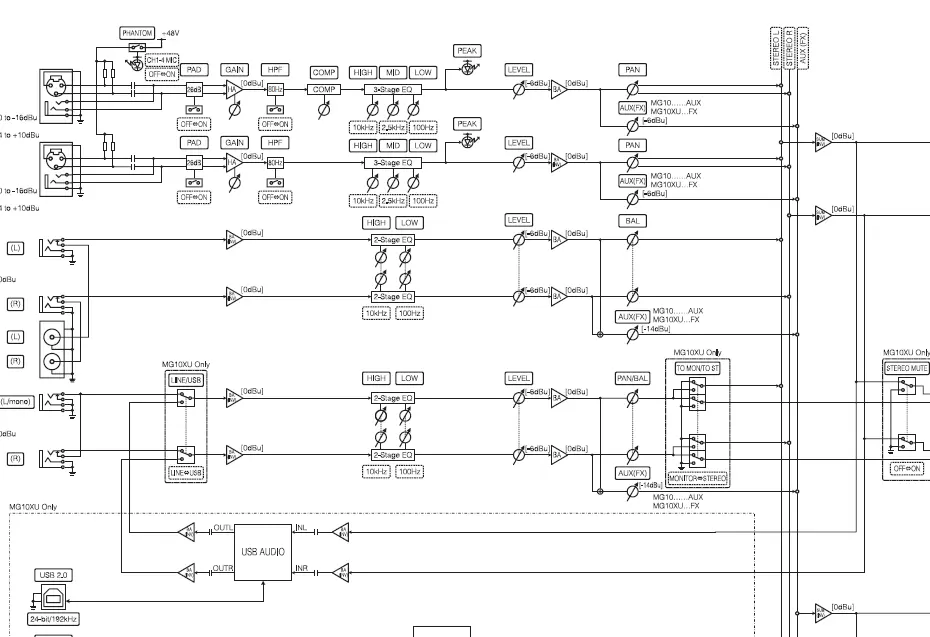

My worry is that the USB feed will be pre-EQ and other functions. I have tried to contact Yamaha support but you have to fill in a form and they want ser Nos and DOP! I have lodged a question with Sweetwater.
USB feed is taken off the main stereo bus, so EQ and effects get sent out via USB. Yamaha was nice enough to include a block diagram in their tech specs guide.

WHERE TF did you find that! Obliged.

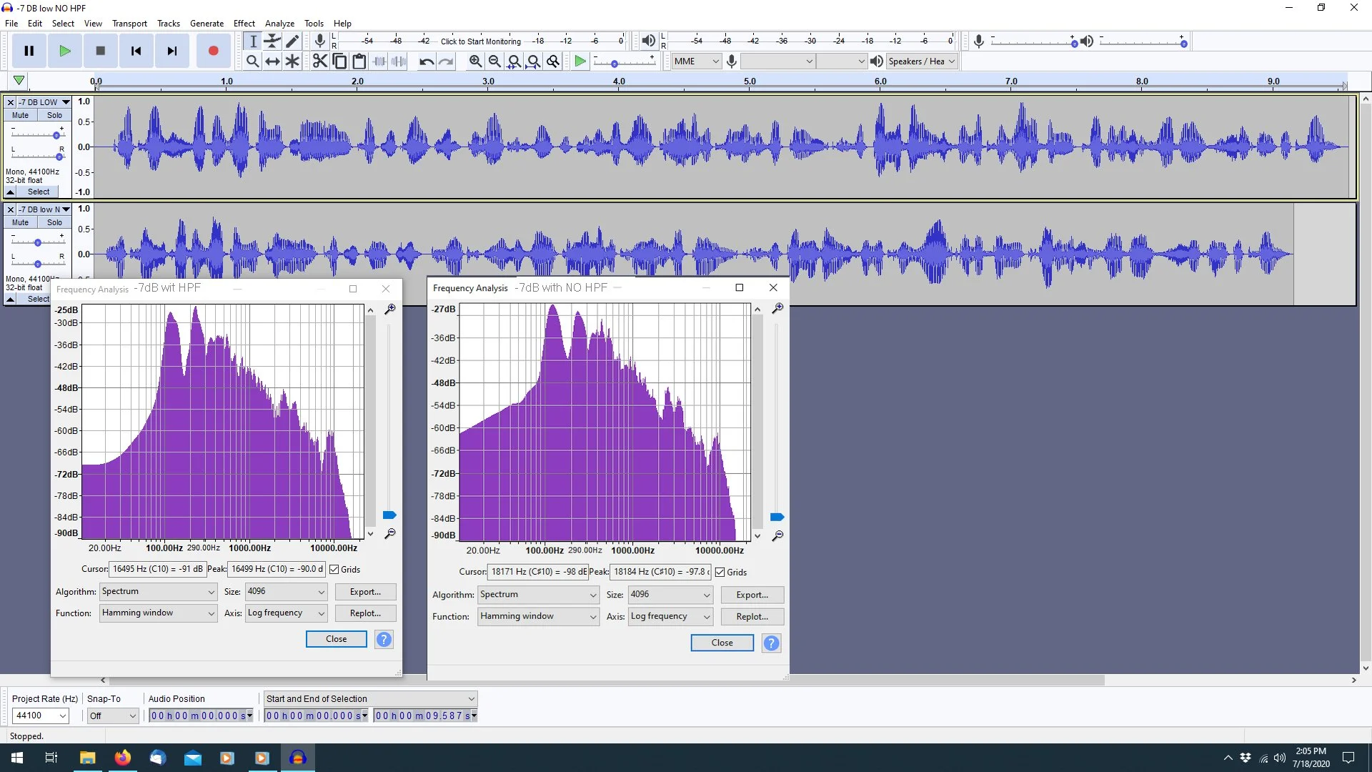

I listened to your various files, and I think the -7dB with HPF file is definitely the best for clarity. You could probably go up to -5dB but I wouldn't go any higher than that. The HPF isn't giving a major change in the sound, but it is getting rid of a lot of stuff below 70-80 Hz which isn't really needed in a voice. It would be best to get those very low frequencies out so they don't affect anything else down the line.
There are two big peaks at about 120Hz and 230Hz which are the ones giving it the really deep, heavy sound. Compared to the files at 0dB, those peaks are indeed attenuated by about 6-7dB.
Attached is the spectrum analysis of the two -7dB files.

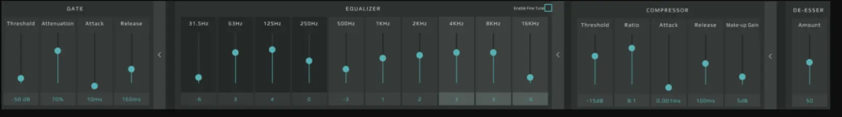

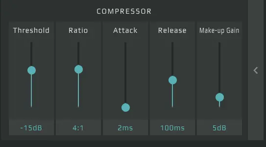

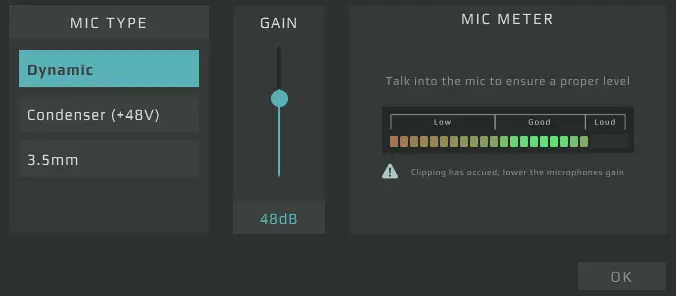

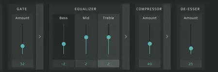

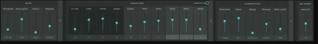

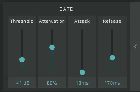

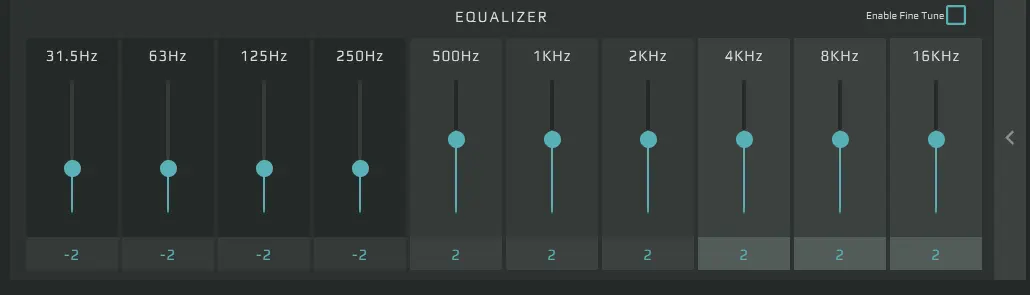

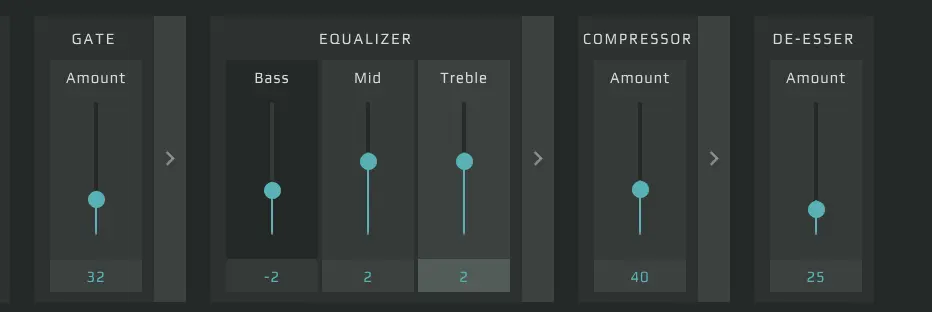

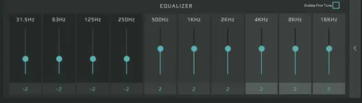

Hello,
It was really long, but I finally received my GOXLR mixing desk!
Here is a recording, feel free to tell me if it's correct or if I have to change some things?
Or is it better than the old mixing desk?
I'm not convinced when I record, I touched some settings and I shouldn't have because yesterday it was better
Here are my settings on the GOXLR518af22ce6393bdf017a197a889afd95.webpa90e07f196d72f598f0e80c492df4d73.webp875dd96734e45b1d3c29e49a4072861c.webp58a50fd223b74e0ae46d30114ce49cd1.webp3c502380fa4a0279b329827531a38478.webp
Sounds fine to me. Level is higher than normal tracking, peaking to -6dBfs but that is I think where 'Podders' want to be? The noise floor is a commendable -58dBfs.
I would have liked a more 'measured' clip of longer duration (and in English!) and with some 20 second silences but overall...got there.

I took the configuration of a guy who has the same microphone to try and I like it, what do you think, is it better ?
I stop sending messages with my recordings, at this point, it's spam. :)8ead2b415e281d7d10b36d533a670a1b.webp

Hey! 'I' had to struggle with French 60 odd years ago in high school! The few words on there were fine. My son lives in France and get regularly teased about his accent but since none of THEM can play rock guitar, keys, Bach on classical, drums and clarinet NEARLY as well as he, they don't push their luck. He is both useful and cheap!
The level has actually gone up to -5dBfs! Does not mattter mon ami. If you were recording a track to mix down with several others then yes, neg 5 is too hot and you would want it around -20 with peaks to -8 absolute max.
But that is not what you are doing, you want a track to go out fairly loudly and that is what the compression is for.
To sum up...
Level is fine (for your purpose)
Noise level is fine.
Voice and sound quality is fine IMHO.
You have. 'as we say 'ere "Cracked it!"
