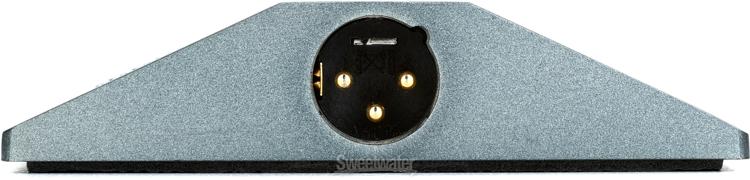

I've used lots of mics on a cajon. The dullest response came from dynamic mics like the RE-20 and MD421. The best, full range response was with condensers, such as an AKG Perception 400 large diaphram. But the solution I've just discovered that is the easiest to use with best results is a boundary condenser mic called the Shure Beta91a. It looks like this:
I place this inside the cajon on the bottom, facing the front where the player taps the instrument. It requires phantom power from the recording device. Here is a sound sample recorded directly into a Zoom H6. I had the mic's mid-cut switch enabled as this produces a tighter, less boxy recording. In post, I applied light compression of 2.2:1 and used a hi-pass of 75Hz. This solution produces great results. AND there is no mic/mic stand that is so easy for the percussionist to accidentally hit or knock over as they're playing -- particular since players often tilt the cajon backward as they play.
