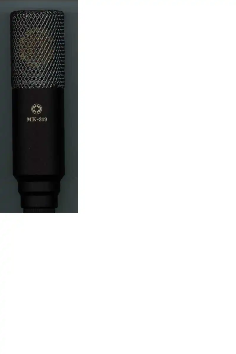

Pic available?
Say Demto,
Any chance you could post of pic of your MK-319 with its new grille? I'd like to see the diamond-shaped screen you used.
Michael
I dont have a digital camera. What ive managed to do is lift the lid on my scanner,
put the mic in the scanner and 'scan' it.
The actual picture looks small on the page but if I open Imaging in windows and
locate the jpeg I can then get a bigger image. Its the best I can do and I hope it
comes out OK at your end. Demto
Michael
I couldnt attach the image as the file is too big. I dont know much about
computers but I will figure it out. Keep watching. Demto
mk 319 mods windshield picture
Michael
Hopefully this time the jpeg will attach.
Resolution is not too good, but best I can do. See my previous posts on this.
Windshield made from 2 seperate circles of steel mesh fitted tightly
together.
Did buy a sheet of finer mesh but it turned out to be made of aluminium.
I was'nt sure it would work plus it dented easily so I decided not to use it.
For the future, do you know if aluminium would be OK as far as RF and
hum rejection are concerned.
Great MK-319 grille!
Damn Demto, that's a beautiful MK-319 grille.
Did you leave some of the original metalwork in place in order to hold the screen? From the picture it looks like there is some black metal there at the sides of the screen.
That's a very open-looking screen, I'll bet it sounds great.
re: Aluminiun, sure...that's a very conductive material but pretty difficult to solder to. It would be fine for shielding purposes if you could make sure the seams have good closure and are well grounded to the case.

MK319 mods
Michael
Thanks for your kind words.
There is'nt any supporting metal for the new windscreen, its all mesh.
The picture does have shadows that can look like supports.
The screen is made from 2 tubes of mesh, each with top 'caps'.
One tube is a firm push fit inside the other with butted seams opposite each other. Seams and top caps are tack soldered in about six places.
Fitted to the mic with the original fixing screws plus washers with a flat filed on them.

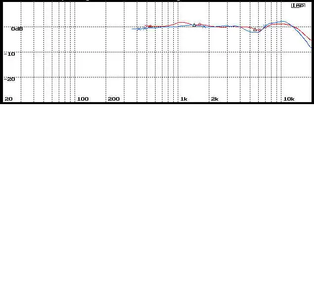

I 've done a new frequency plot of the mic's response.
The response is now a little flatter than before at the top end.
The blue trace is the mic without the new windshield and the red trace is with new windshield. See jpeg attached.

Demto,
Do you mean the blue trace shows the stock MK-319 windscreen?
The new response is really smooth at the top. Just a touch of HF boost, a good mic for digital recording.

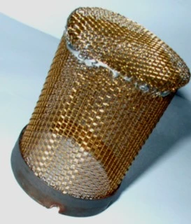

Attached is my first attempt to roll a new MK-319 screen. This one is a single rectangle of bronze window screen rolled twice to form a double layer cylinder. There's a copper band at the bottom to which the screen is soldered. The copper band attaches to the mic body with the original screws. The day I did this I only had a low-wattage soldering iron so the solder flow was not too good. Flux and high heat is needed for this work.

The blue trace is the mic after all the previous mods, boost discs removed, body
dampened and electronics updated etc.
The red trace shows what difference the new headshell makes in the response when compared to this.
