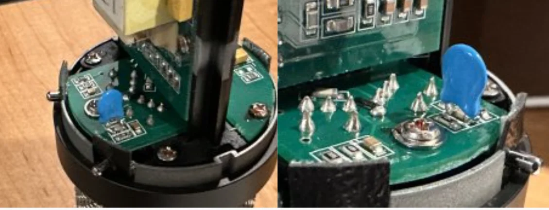

add this a year later- Sept 2026-
I just added the cap to a P420 the other day.
Was it 5 min fun solder job? no.... actually it was 5 minutes of intense fear of holding a 620F solder tip hoping not to destroy a perfectly fine ,brand new, mic with Surace Mount, so incredibly tiny!! whats truly amazing is a person didn't "mess up" the mic. I did the add-on cap to the existing cap, as in the video below. Instead of removing and installing one capacitor. Its the Black P420. 220 add a 471...pico farad.
Results:
Pre Mod and Post Mod, is noticeable but for me the mic was ok Stock too. The point is King Korg of DIY fame did a lot of work to determine the graph-and freq to match the U87ai. So taking his word and experience you just copy and use the numbers he used. (kind of like AKG copying the U87ai circuit).
If you don't have a high freq issue to begin with maybe its not massive change but ok its noticeable on a dry raw track and it the point is to MATCH the U87ai SOUND not make it better than a U87ai, under a microscope as they say. The video above both U87 and AKG sounds processed a bit. imo. It sounds better than my U87ai sound and dry non processed mic. I was really underwhelmed with the U87ai (circuit #6 (which is supposedly one of the best U87ai circuit revisions).....so whatever, to each their own ears.:listeningmusic:
It just sounded so plain and normal the price didn't get me any "magic, rainbow, beatlesEMI sound suddenly".
The DIY-
I did the same blue cap, Amazon $5 for 10qty. as the video below .
Listening to the P420 and the U87ai in my own tracks,....the U87ai for me is not a preferred sound and the P420 matches it closely imo....
in mixes and in videos it is what it is, U87ai sound is a classic standard so I can accept this is the "industry standard LDC".
Accepting King Korg and all the YouTube's on this work shows AKGP420 is close as the video above says "maybe a little clearer" than the U87ai. High sensitivity mic, its not a warm sounding mic King Korg was tweaking to match the U87ai.....not improve it to sound better than a U87ai..
adding 470 pico farad to the existing 220 pico farad. was my choice fter seeing how tiny Surface Mount is.
I don't think the soldering DIY is impossible but its not easy at all, imo. Its not as easy as soldering XLR jacks on a mic cable.
Yes, once its done, ok...5 minutes..if all goes well and everything is setup and works.
Surface Mount is incredibly tiny..omg :eek:
If a Guitar Cable is Entry level or 1 of 10 being harder, this DIY would be 5-7 imo due to tiny size and possibility of ruining a good mic.

I have to say, I’ve really come to love the sound of my own modified P220 as well. The original voicing had a pretty aggressive top end to my ears, and the difference after the mod was actually quite noticeable.
Also, if anyone unfortunately damages the solder pad during the modification, it may still be possible to recover it. There’s a good example in the discussion around page 30 of that thread — you can simply stack another capacitor on the nearby capacitor to achieve the desired value.
For example, if you originally have 220 pF and want to add roughly 470 pF, you can use a single 680 pF capacitor instead. It’s a pretty simple workaround if the original pad is damaged.😊
Is this kind of thing not just EQ, but tweaking the curve inside the mic preamp rather than externally?
The "stacking" is a good term, that's the method I used. It looked easier to do imo.
Shown in the picture, the blue-cap is "stacked on the 220pf.
220pf is still on the board, the "stacked-added" 470pf is in parallel= 690pf.
If a person wants to go back to the original they can remove the added cap, though I don't see what the point would be to remove it.
The lower video Blue Grass dude used the "stacked " method. Many others removed the 220pf and installed a 670~ pf, that looked much harder to do...as its so tiny a part!
