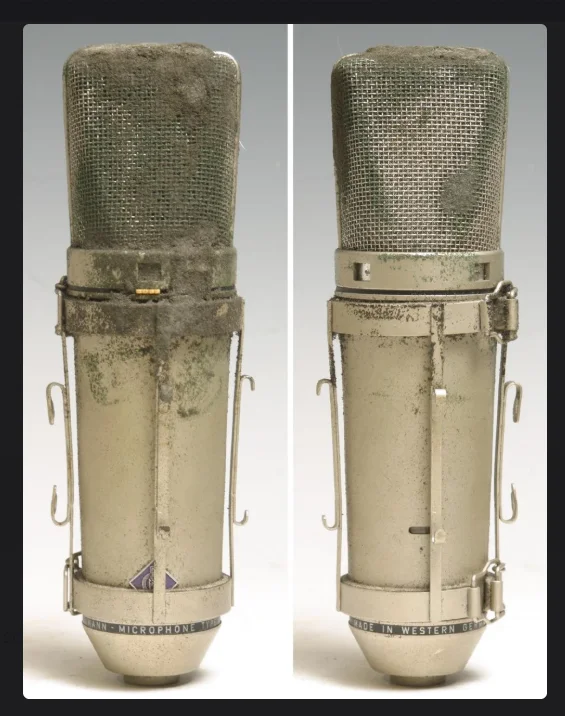

What does anyone think about adding Foam Screens?
Some say no way....rot can cause problems as this picture shows.
I think it depends on the type of foam used. Open foam vs closed cell foam, the basic material used to make the foam, that all makes a difference.
Good polyturethane is pretty robust. Polyethylene is cheap. I've had some that tore apart in under a year. If the material breaks down, it can leave particles that get on the diaphragm. Reticulated foam is the highest grade, but most expensive.
Unfortunately, very few companies tell what the cover is made from. The two with my 20 years old Studio Projects mics are still good. Some covers I got for my pencil mics ripped apart quickly and went in the trash. I put some foam in a box to hold a recorder and it's still going after years. Some of the packing foam I've received will crumble if you just rub it.
What you don't want to do is leave the cover over the mic in storage. Put them in a separate box, and check it before you put it on.
Neumann wants $70, China- $9 is unknown what it is....Shure $15, AKG , Senn (probably made in China) seems similar, maybe a solid "middle" price with quality or is it brand-name placebo again?
...I could see having some foam to protect the capsule from human and bumps and hits, and dust but the rot of the foam is a concern.
Disposing of it routinely not a big cash hit preferred.
