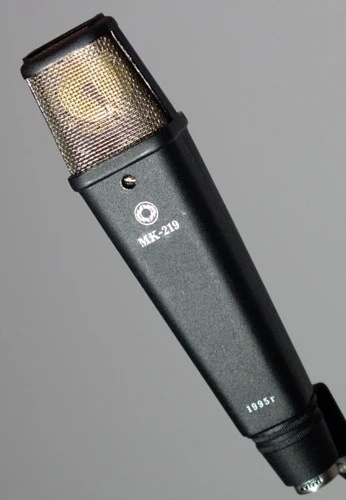

Oktava Capsule HF Boost discs
Removing the discs by uncrewing them and the center conductor is safer than trying to bite away at the plastic with cutters in my opinion.
When installed, the perforated HF resonators on the Oktava large diaphragm capsule boost 3.5dB @ 10kHz and contribute to a notch in the 3kHz to 5kHz range. Removing the discs does two things:
1.) Flattens high frequency response above 3kHz and allows a more gentle rolloff above 10kHz.
2.) Improves transient response and HF phase acuracy - I haven't quantified this with impulse test equipment but the result is clearly audible. For example the spoken sentence "she sells sea shells by the she shore" sounds more like "she shells she shells by the she shore" when recorded by an unmodified Oktava large diagragm capsule when compared to a mic with the HF boost disc removed. The HF boost discs impart HF delays that are audible as time-smeared treble response.
Similarly, the HF content-rich spoken letter "F" sounds much more smeared with the HF discs in place compared to when they are removed. The noise content of the letter "F" sound is exagerated with the HF boost disc installed.
The slotted grille / 2 layer wire mesh design of the unmodified MK-219 also contributes to the notch in the 3kHz-5kHz range and HF smearing do to reflections within the headgrille. Modifying the head grille and capsule as shown in the photo at the link below provides much clearer and more accurate HF response.

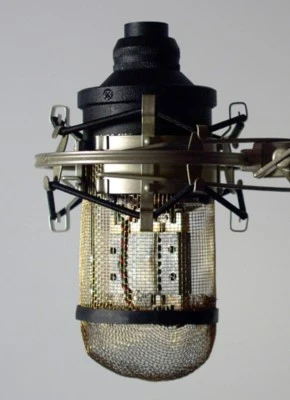

MK-319 Bottle Mod
A couple of years ago I was on a DIY Bottle Mic bender. I got obsessed with the idea that mic bodies and capsule housings contribute to HF phase problems and smear detail etc.
So I started looking for ways to clear up HF transient response in the Oktavas. The strategy is simple - get the capsule out in the open air as much as possible and keep reflective surfaces as small and as far away as possible.
In practice, this has meant removing the HF boost discs, removing all but one layer of wire mesh, and yes, hacking the capsule housing to make it more open and further removed from the mic body.

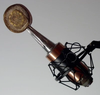

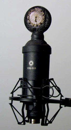

Oktava / "Dorsey Mod" Bottle
One mod leads to another when you're on a bottle mic bender.
I like to work with bronze window screen - easy and cheap to get at your local hardware store.
The link below is to a pic of an Omni-modified MK-319 capsule sitting in a lollipop-style capsule housing suspended well above a "bottle" body. The body contains the "Dorsey" mod, a Shoeps-inspired FET headamp and FET balanced output stage.
I love this thing as a room mic - big and clear with great transient response.

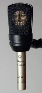

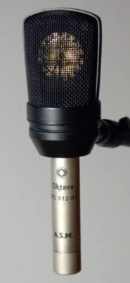

Big Head, Little Body
The large diaphragm lomo M1 capsule for the MC-012 body inspired me to DIY my own version.
The idea of a large capsule being underbiased by the small diaphragm-design FET amp in the MC-012 to produce a unique sound intrigued me.
I took one of the better MXL capsule and head assemblies and fit a mounting collar to it that could screw on and off the MC-012 body. I actually used the stock MC-012 -10dB collar rewired for flat gain as the mounting attachment between the MXL capsule head and the MC-012 body. The MXL grille is now also single layer wire mesh instead of two-layer.
I like the small diaphragm / large diaphragm flexibility of this mod and the body now sports a Dave Royer-inspired 5840 subminiture tube mod also.
